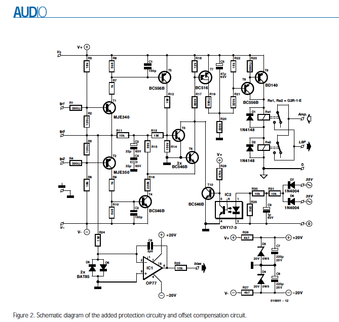

Just for curiosity:
I thought the Crescendo Millenium used conventional relays. Is this wrong?
