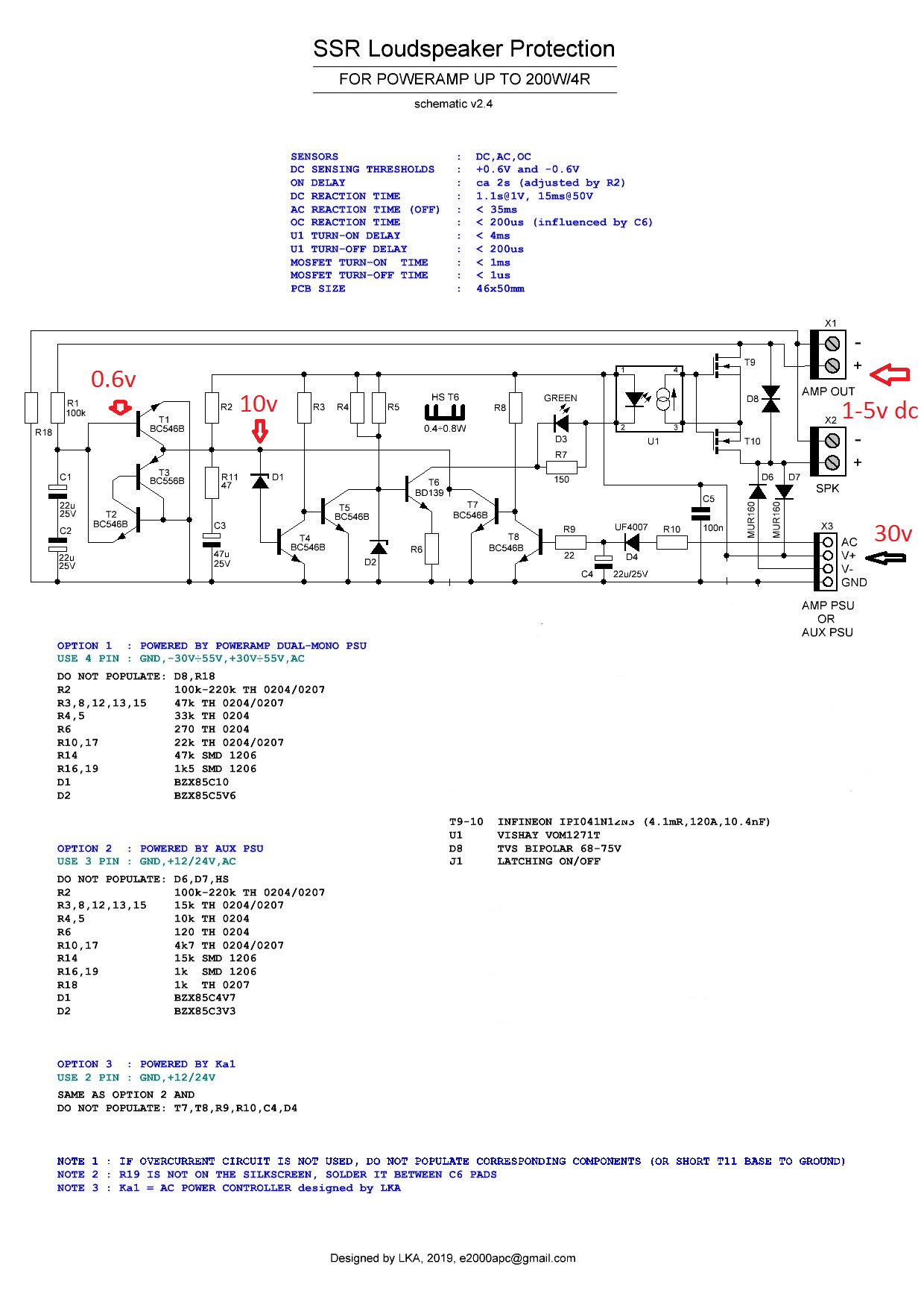

A friend of mine tried this modified circuit (just he leave the overcurrent circuit unpopulated.
The turn on delay function well but the dc detection isn't working,whatever is the value of dc present.
The green led D3(in series)with another led instead of optocoupler remain always on.
Circuit isn't functional even in simulation.
I will post his own pcb later.
Please help.:)

My SSR works great. Both channels are powered by single +24V auxiliary psu. Check this video. DC thresholds ca -0.5V and +0.6V
YouTube
I guess, you have "ground problem". X1- and X3GND have to be connected in some way.

I'm lost... I'm unable to understand what an AC protection can be, so that I don't know where to connect the AC pin to my test amplifier (heavily unbalance in LTSpice).
I understand DC, OC, but not AC. Sorry about that.
It could be the reason why the circuit doesn't work in my simulations. I assumed that the circuit is powered by the amplifier dual mono PSU.
Sorry for the very dumb question.
AC detector, not protection. It tracks AC voltage on the transformer secondary winding (it doesn't matter which one, AC1 or AC2, not CT). When AC is lost, SSR is switched off in very short time and the delay circuit capacitor is also discharged.
