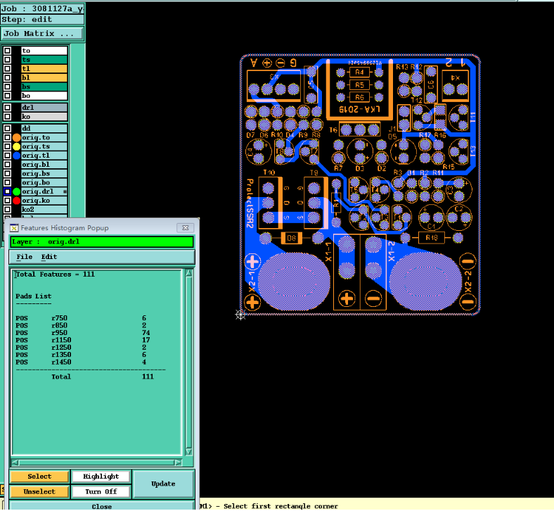

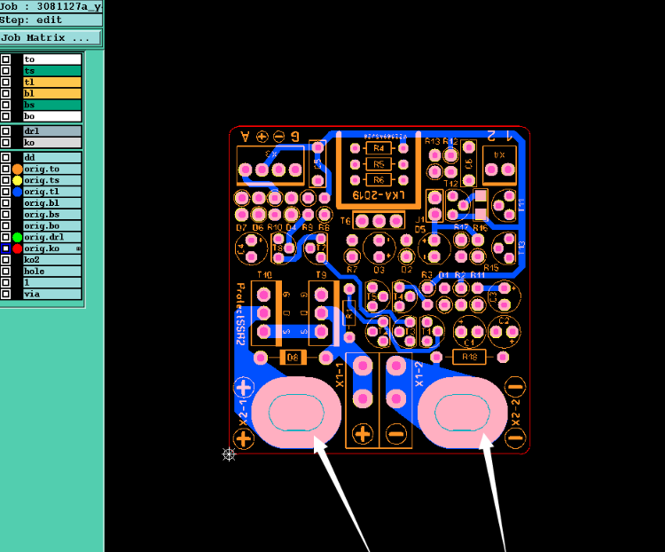

Sorry to bother you, but there is an issue that we want to confirm with you before proceeding.
1) As shown below, all drill hole sizes in your files are perfect integers.
We wonder that if your files is production files can be used for production directly without any compensation/optimization, in other word, is other supplier produced this PCB for you with this files before?? Yes or NO??
2) As shown below, should we cut out 2 indicated slots in KO layer from PCB? Yes or NO??
I have received this mail from the GLCPCB.
Please LKA can you help?

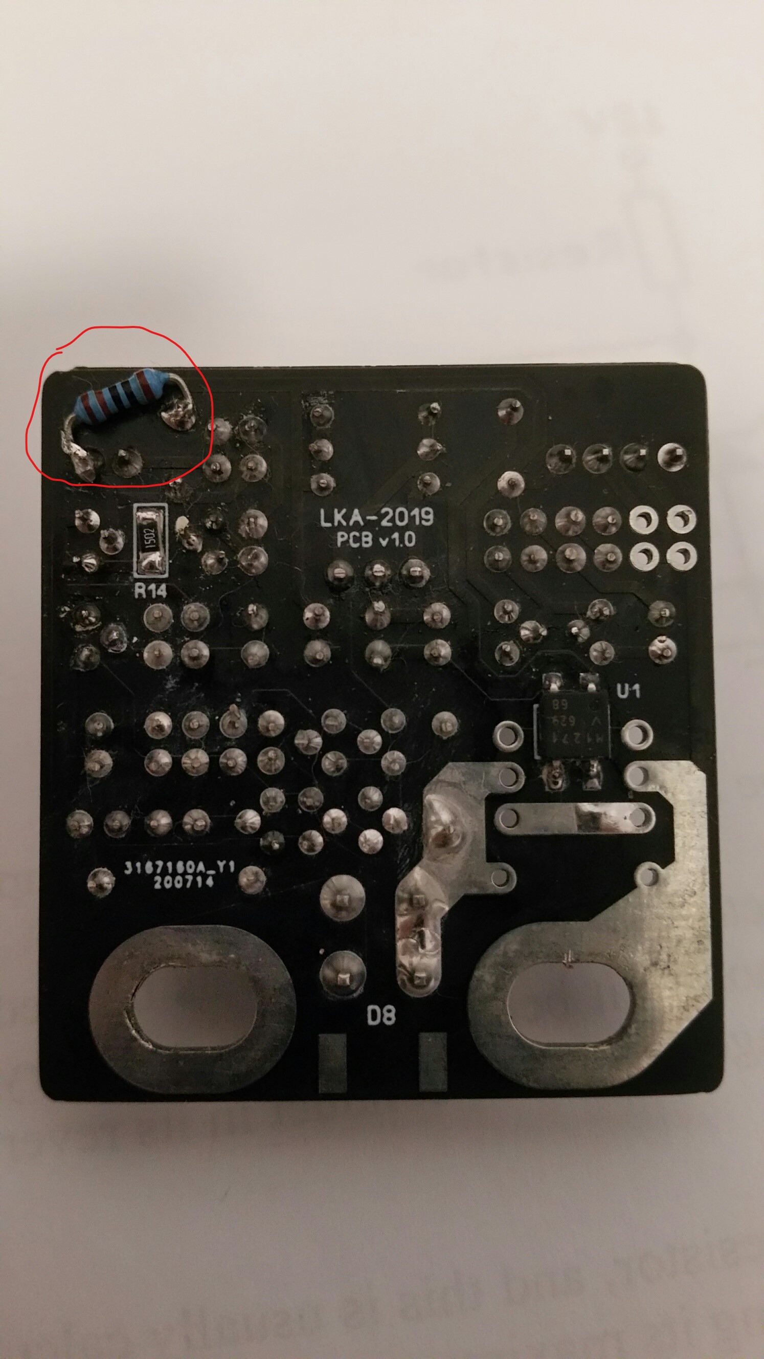

For some reason I could not fit the surface mount resistor on the back of the PCB so I soldered in a through hole resistor instead. See photo.
I will double up on my Mosfets to reduce the RSD for a certain amp that I am building that doesn't have a high damping factor. Boards are not tested yet.
I think the design is great and very big thanks to LKA but my preference would be for the boards to be a little larger as they are tiny.

The pcb is intentionally so small. Usually there is little space around the output terminals. (at least in my amplifiers).
The board has two smd resistors, I forgot them to add as TH components in the design process and I was lazy to redesign the pcb.
