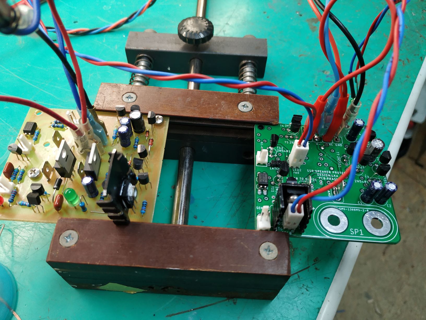

SSR board problem
Recently I assembled two boards for speaker protection ,first one from post #95 posted by Prasi and this work as it should .Then I was ordered some boards from JLCPCB using gerbers from post #100. I assembled one board and I have 2 problems. First there is no turn on delay ,the board start immediately. Second problem is greater and more important ,the board power up and works
about minute or two ,then goes to protect mode. Sometimes the green led flicker sometimes not. Turning board off and on again helps for some seconds, then board go to protection again. Components are as in schematics except D7
and D8 ,they are UF4007 not MUR160.All components are from Mouser or
Farnell so no fakes .Can anybody helps me to solve this problem?

sorry for late response, I was in the night shift, no net on the job.
Supply voltage is +- 38VDC ,the component value is same as in schematic in post #100 except D7,D8 are UF4007 not MUR160 and mosfet is SQJ974EP (dual, 100V ,30A per leg, Rds 0,0255 ohm),R2 is 150k.

Did you check the pcb layout ? Was it correct ?
gerbers as per above design. Not tested.

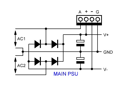

From Post 100,
https://www.diyaudio.com/forums/solid-state/318946-ssr-speaker-protection-10.html#post5776638
Did anyone ever build Prasi's through hole protect board?

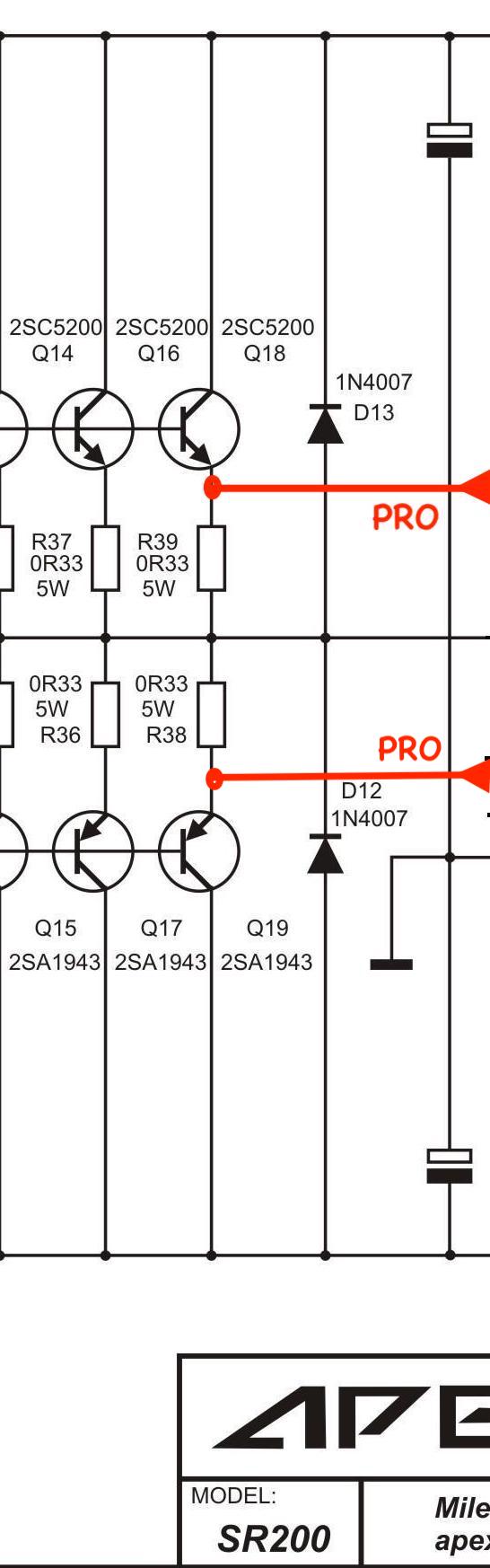

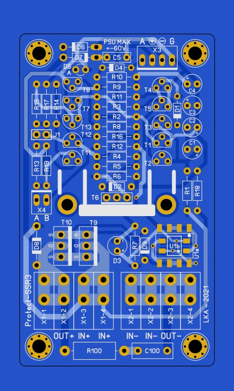

LKA i will use your Protection with Apex SR200 with 65V-70V PS.Hi, for 65V PS you should use 150V mosfet like IPI051N15N5. Change R4 to 22k-27k. T6 will dissipate 0.9W
i will use IPI051N15N5AKSA1 Mosfet. Please could you confirm that R4 is the only change and also, could you suggest a heatsink for T6 who will fit on your PCB.
The APEX SR200 use RE=0.33R so Ith=1V/0.33R=3Ap, do i need RS2? i will use RS1=100R.Choose RS1=100R (current limiter for IR led)
PC817 has forward voltage approx 1V. If RE=0.22R then Ith=1V/0.22R=4.5Ap
If you need higher current threshold, add RS2 (voltage divider).
RS2=100R Ith=9Ap, etc
I do not recommend going for more than 50V power supply (SSR2). The protection is designed for max 200W/4R. I have a new PCB layout (SSR3), a larger heatsink (PSU up to 60V), three options for the optodriver (VOM1271, ASSR-621, Si8752). A prototype PCB is on the way, as soon as I verify the functionality, I can publish it.
