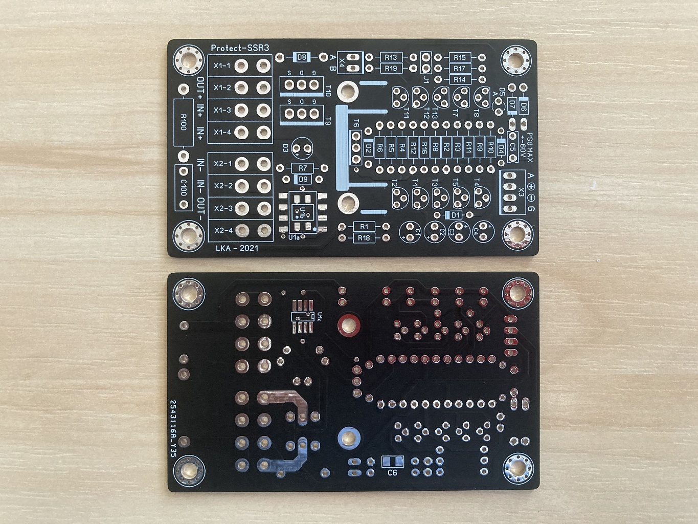

Thanks LKA,will wait for this new version.I do not recommend going for more than 50V power supply (SSR2). The protection is designed for max 200W/4R. I have a new PCB layout (SSR3), a larger heatsink (PSU up to 60V), three options for the optodriver (VOM1271, ASSR-621, Si8752). A prototype PCB is on the way, as soon as I verify the functionality, I can publish it.

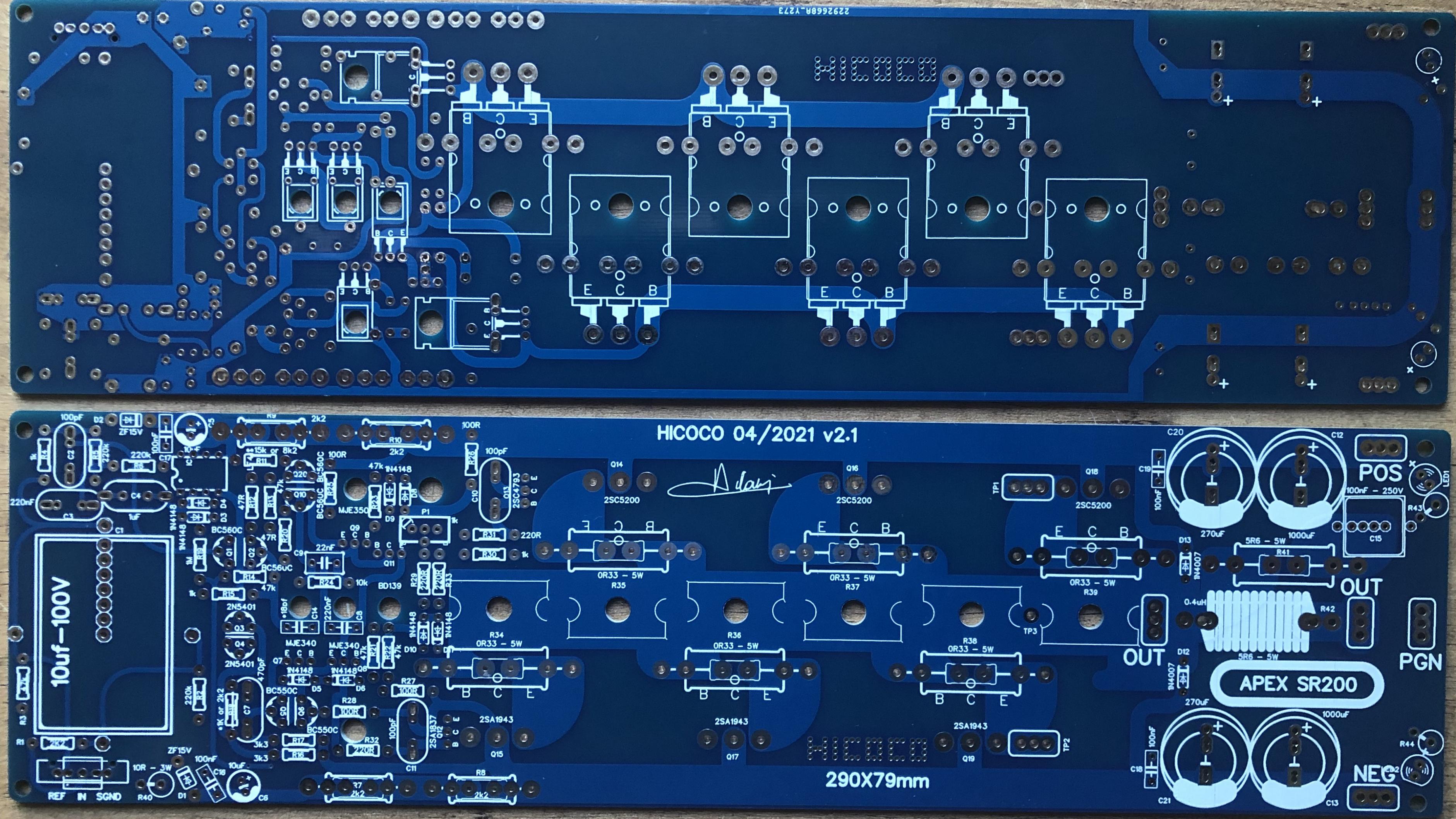

I have all the SR200's Transistors soldered in the bottom side of my board, see pic.I do not recommend going for more than 50V power supply (SSR2). The protection is designed for max 200W/4R. I have a new PCB layout (SSR3), a larger heatsink (PSU up to 60V), three options for the optodriver (VOM1271, ASSR-621, Si8752). A prototype PCB is on the way, as soon as I verify the functionality, I can publish it.
LKA do you think that could be a possibility or an option to have T6 who could be soldered on the bottom side with a hole on the board to be able to fix it on the main heatsink ? thanks

That SSR3 board is a very neat piece of design - it reminds me of the discrete ladder volume control.
I look forward to it's check/completion and possible GB or list on the diyA shop.

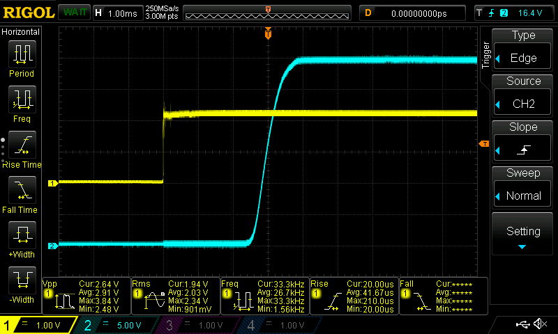

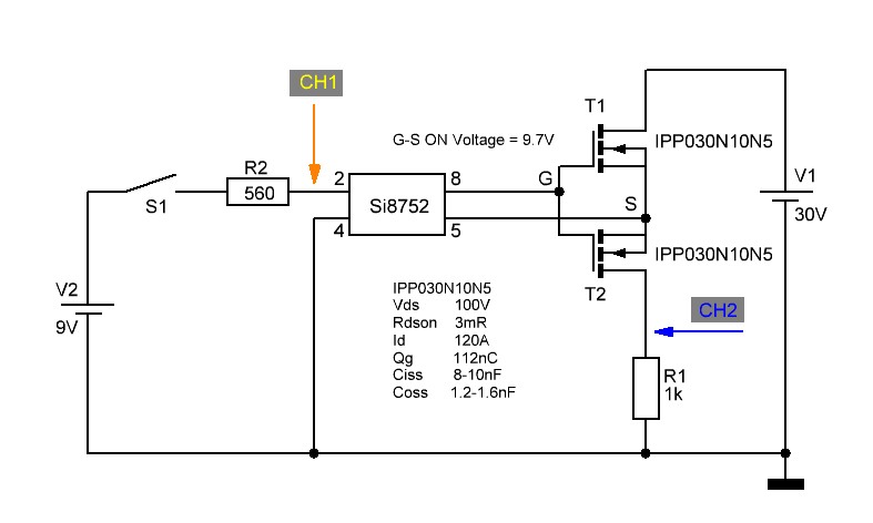

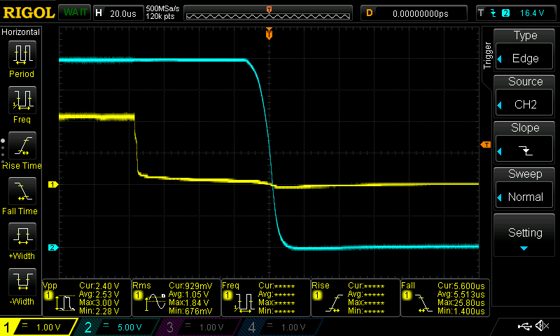

Si8752 input side current If=12mA ((9V-2.2V)/560R)
Si8752 driver side voltage VG(ON)=9.7V
Si8752 driver side impedance RG=200k-300k (datasheet page 9, If=10mA)
FET total gate cap 2x10nF
approx
turn-on delay 2.5msec
turn-on time 1msec
turn-off delay 60usec
turn-off time 20usec
approx
turn-on time 1msec
