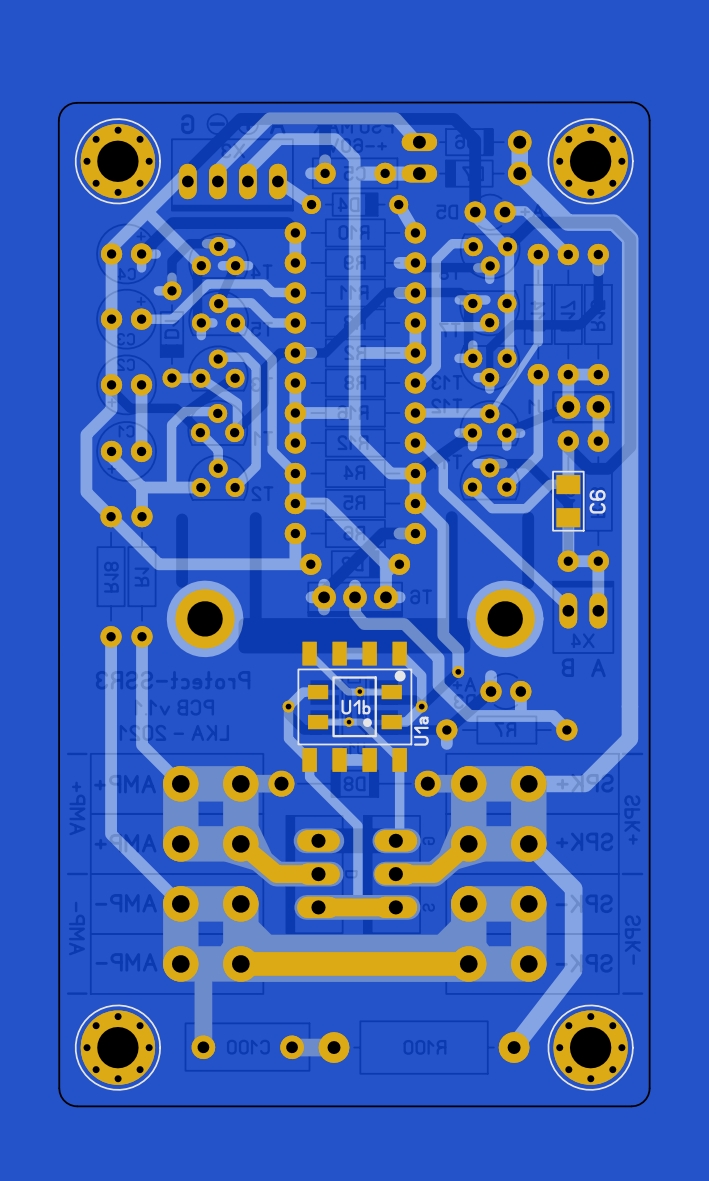

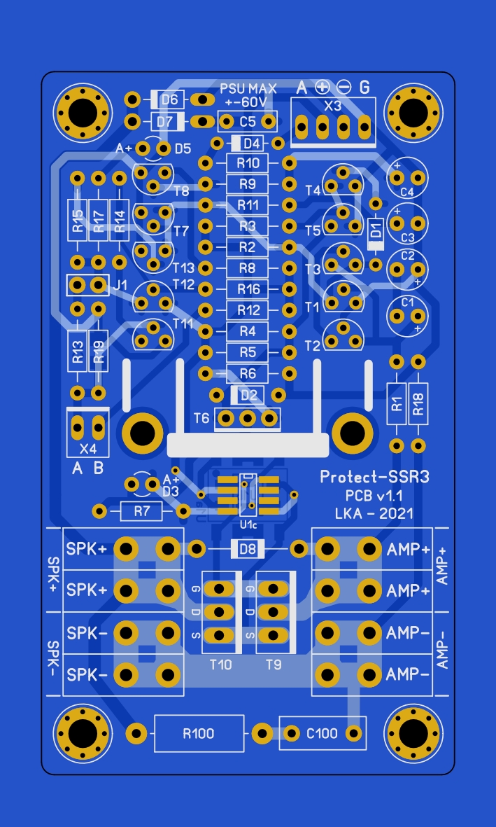

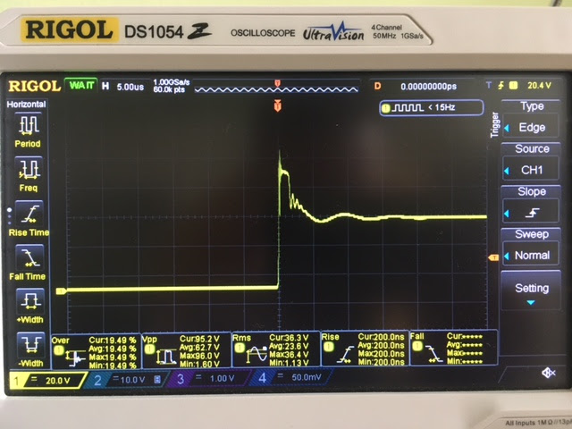

The protection schematic from post 295 will not protect the speakers in all cases. Specifically, in the most dangerous cases for speakers, the protection with MOS-FET's will also break and will then burn the speakers.
Why? Simple! A short-circuited transistor will cause a very high current through the speakers. This current will charge the coil from the woofer filter with energy. When the relay opens, the energy in the coil will cause a very large overvoltage at the terminals of the MOS-FETs and the transistors will short-circuit. The transient voltage suppressor diode present at the terminals of the transistors will limit the voltage but if the energy is high it will also enter a short circuit because this is how it is designed to work.
0.18J is 0.18W for 1sec or 180W for 1msec
Did you notice the D6, D7 clamping diodes as well ?
My recommendation for max safety
- power the SSR3 by the poweramp psu
- apply diodes D6,D7,D8
- use current or VI limiter (SOA protection)
- immediately switch-off the SSR when short circuit happens
