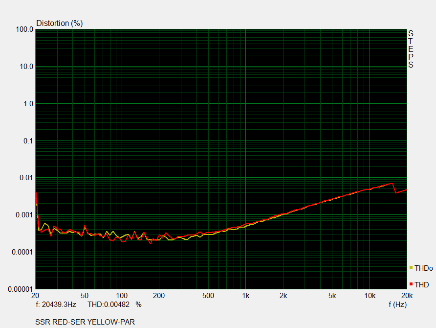

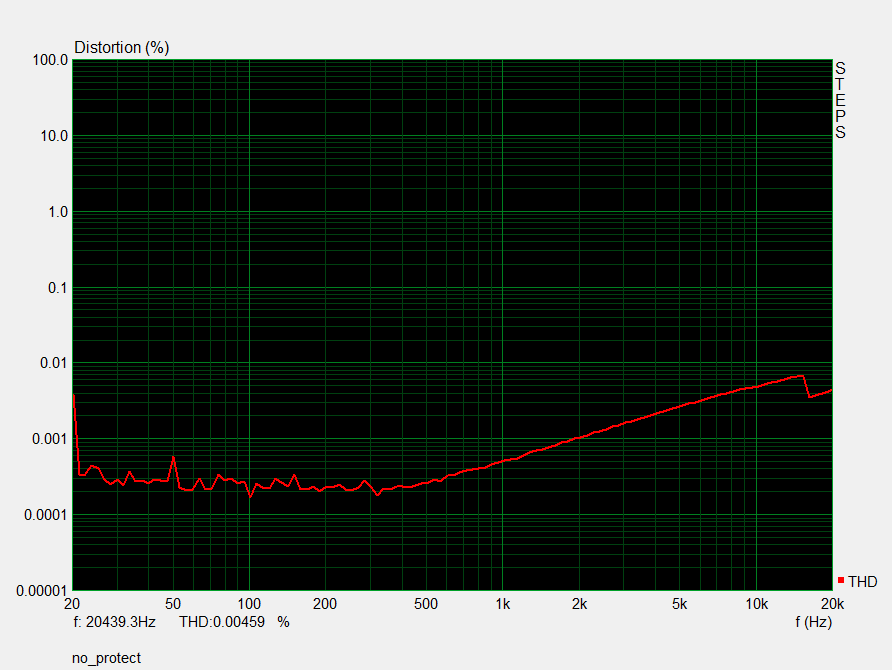

The SSR such as you mention use triacs and are unsuitable for use as a speaker relay because they would generate massive non linear distortion around the zero crossing point.
SSR's made using two power FET's and a floating photovoltaic coupler are the way to go and many have used these successfully. I would never go back to mechanical relays now.
This long thread has all the details:
Output Relays

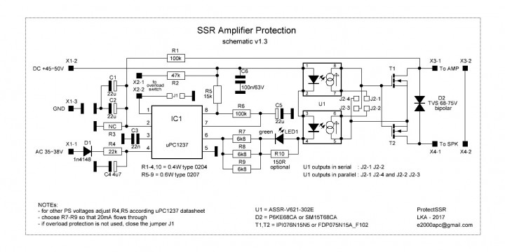

Hi LKA,
I had the issue that the SSR was not directly switching of when mains were disconnected. The AC was taken before an active rectifier.
When disconnecting the cable to the AC connection, shut down was working correctly. When leavinig it connected (as ment) shut down took couple of seconds. Maybe the active rectifier using mosfet's with internal protection diode are causing this?
EIther way, I solved it with adding an additional load for the AC connection : A 10k resistor connected to GND after the 1N4148.
