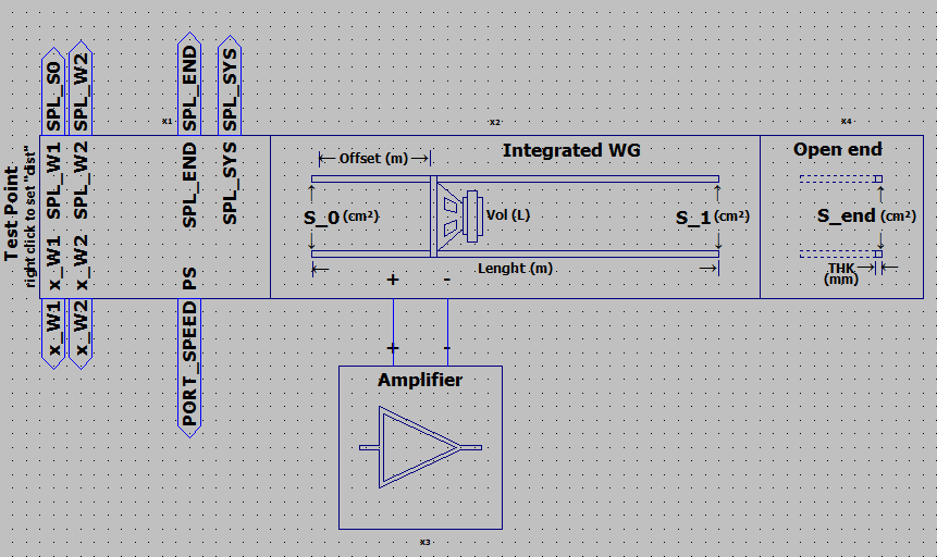

In SpicyTL 1.5 there is a sheet named SpicyWG. The integrated segment can simulate a speaker mounted in a waveguide. You can add blocks to the opening side to simulate more complex designs (tip: if you set offset equal to lenght, S_1 is the TL's area at the point where the loudspeaker is mounted). A new release will allow even more complex designs to be simulated.

- From my initial 'toying', Am I right to assume SpicyWG is modeled after a half wave resonator? (I ask because it seems to be sort of immune to line lengths but around half wave)
- Also I'm on the impression that at this moment, as it is, SpicyWG only responds to sections added after it but not to its beginning, Right?
- Also I tried having it with an offset about 0.01m,so, It should behave as a normal 1/4 resonator but I'm still digesting the results
- I Found this new 'air_load' module and It made me smile!. Can it be used, for instance, to model the effect of having a speaker close the the floor?, Ripole speaker proximity?...

Ciao Drakonis,
at the moment no blocks can be added at the initial opening because the air load must be taken into account. In SpicyTL, where the air load is always proportional to Sd, the air load is modelled directly in the loudspeaker block. In SpicyWG the air load depends on the area of the opening, but to simulate more complex models dedicated blocks are needed: the air_load block and the front_loaded_speaker block, which I forgot in the download folder and which are not yet complete and working, are a first draft of it.
As you noticed, if you set the offset equal to zero you are designing a simple TL with the loudspeaker mounted at the beginnin of a tube.

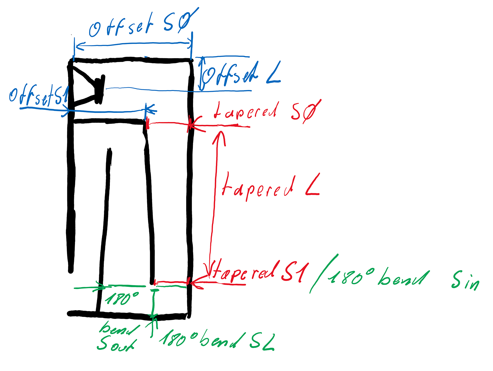

Hi Andrea.
Thank you for your great work. That's exactly what I need for my new project. Especially now, when the prices for construction timber are extremely high and you have to think hard about experimental setups.
I'm struggling a bit with transferring the design data to the Spice model. I have attached a sketch. Have I interpreted it correctly? And how is the total length calculated. Is it enough to add all the "L" values?
The fiber blocks are not working and offset / bends are missing. I've tried to fix this by myself but this is too complex for me. Are you working on this?
Thank you

Thank you very much Andreas,
I guess you had a problem with the "tapered_fiber" block: it's a block I'm working on and it's not actually in the folder. Again, I accidentally left the symbol in the download folder.
In the design you posted the speaker is mounted at the beginning of the line so there is no offset. The exact model starts with the driver and continues with a straight (or tapered) segment to the first 90 fold. The rest seems to be correct.

Hi Andrea
Thank you for your fast response.
The length of the straight starts at the rear of the baffle, right?
A last question about the 90 degree bend. It has only one parameter for the area. In my case, the input are is much larger than the output area. Should I use the input or the output size?
