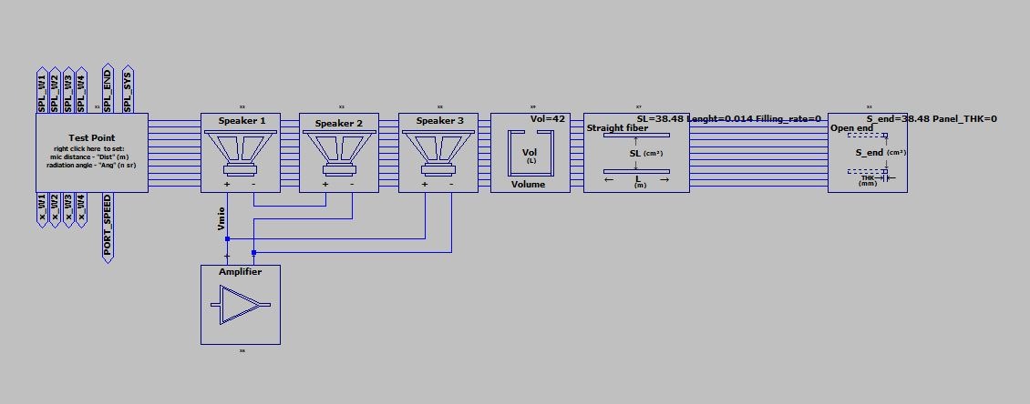

BASS REFLEX MODEL, is this correct?
I know that there is now the Port model, but I'm asking if the following model would be OK for a bass reflex of 42L (with a reflex tube of 7cm diameter long 14 cm), with 3 drivers (two in series and one in parallel to the ampli).

I think it could work. Have you tried comparing that model with the port block?BASS REFLEX MODEL, is this correct?
The volume block is a lumped parameter model and contains no information on the surface area exposed to the damping panel. I would rather try with two empty TL sections.It seems Andrea is not around to answer to all our questions and unfortunately the model is too way complex to be used without training...
