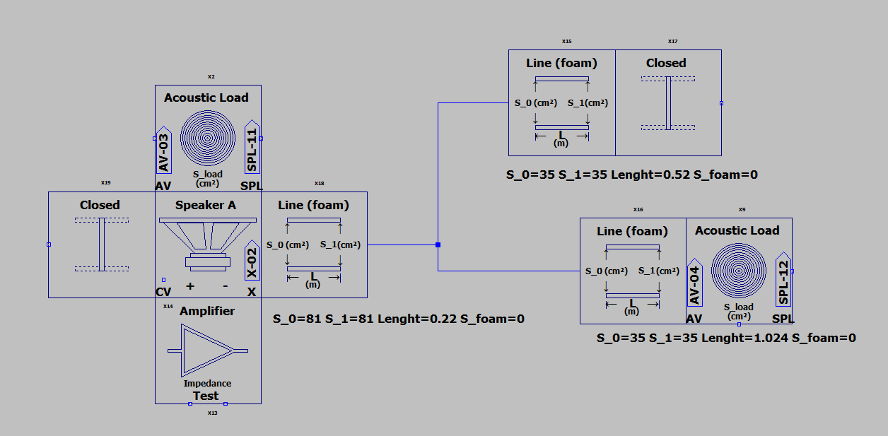

Well, the impedance of the speaker should be covered in the equivalent circuit, which is why I put the high pass tweeter side in..eventually being able to work all the way back to an amplifier. (Did I mention scope creep).
The baffles have not been included, since right now I am really just at the point of understanding what the system is doing. And...I am having some issues using the CLOSED section to
Sorry - the last part got cut off.

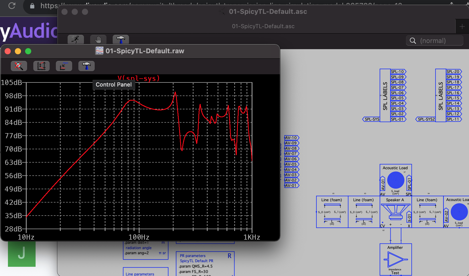

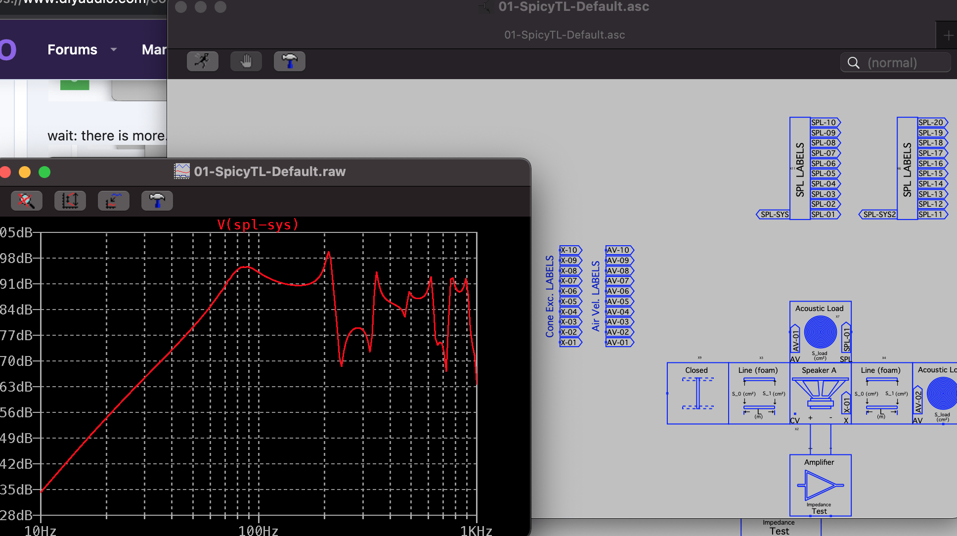

I am finding the the CLOSED circuit does not appear to actually do anything.
simple line with closed end:

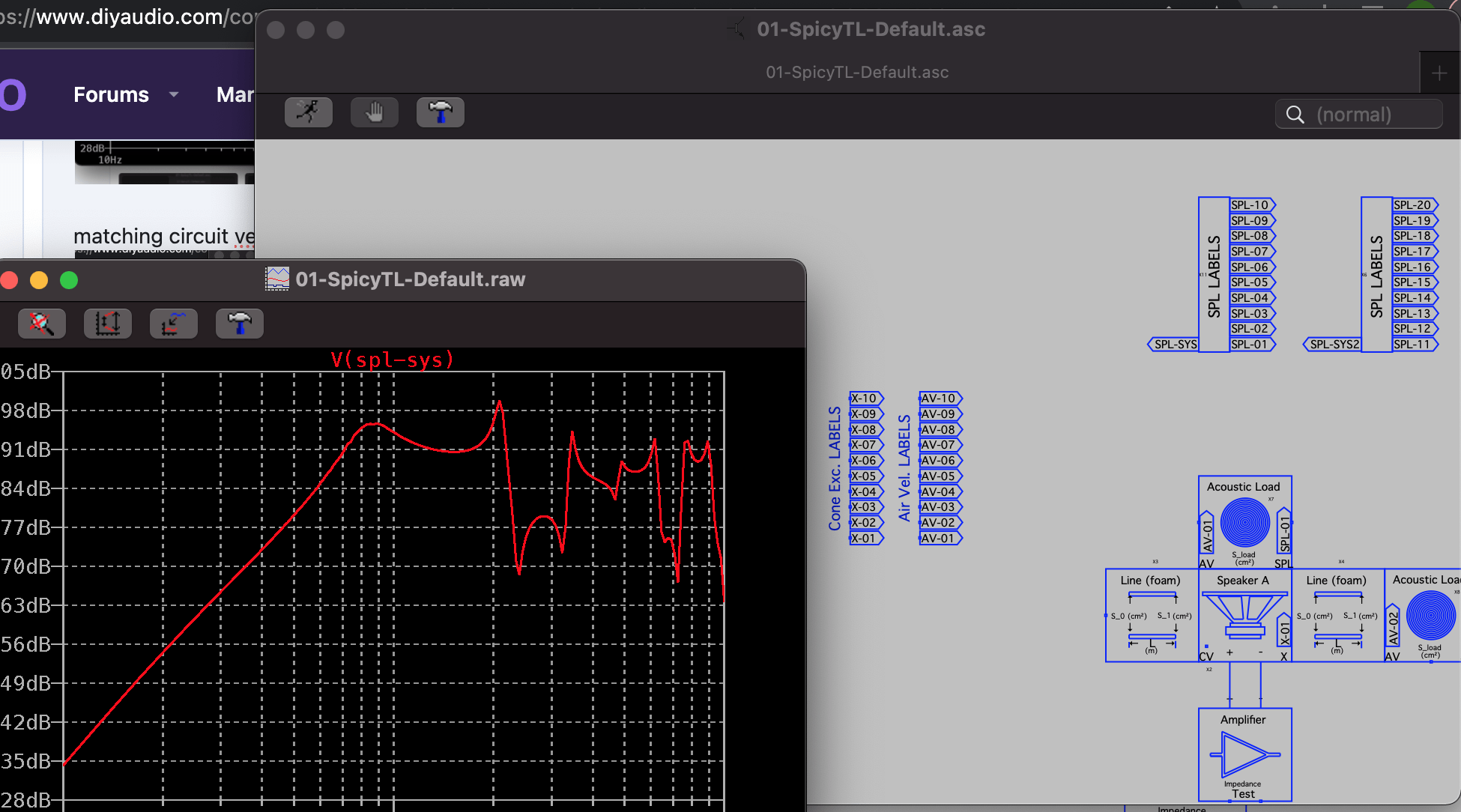

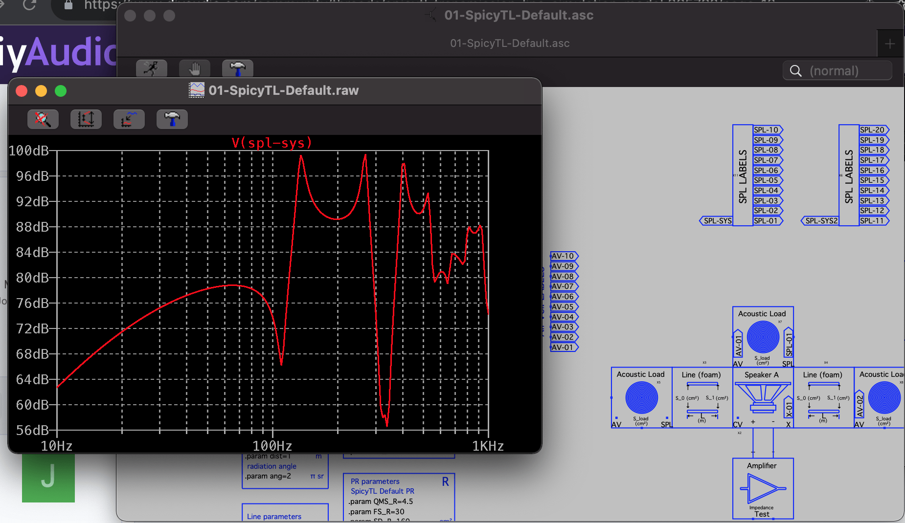

here is the line with the closed end removed:

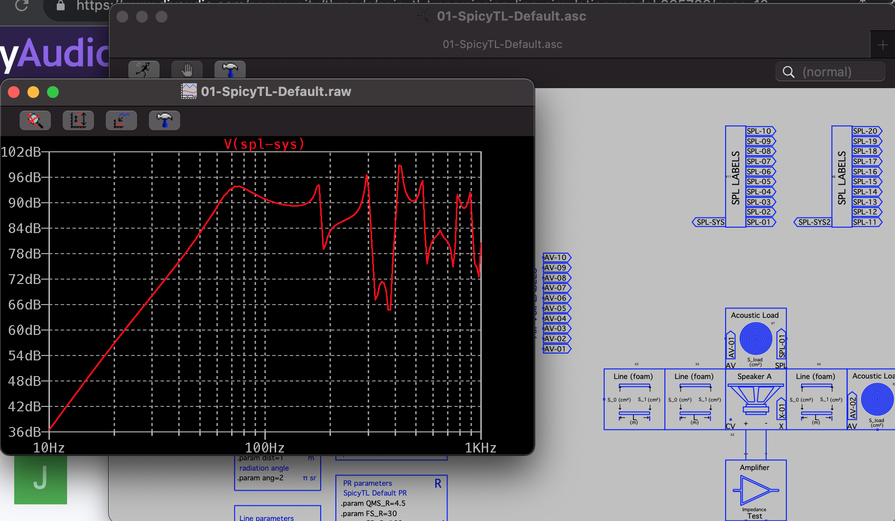

here, i made the end left segment a 1cm2 by 20cm hole (which should act closed to these frequencies, right?:

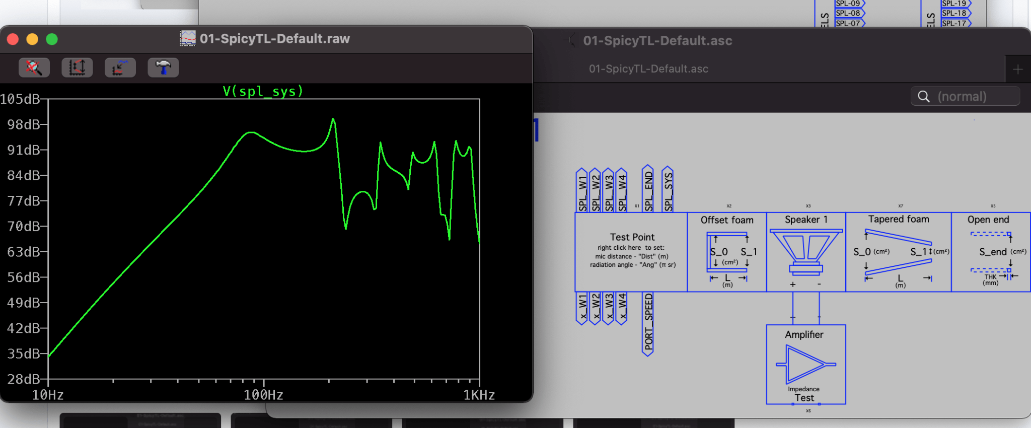

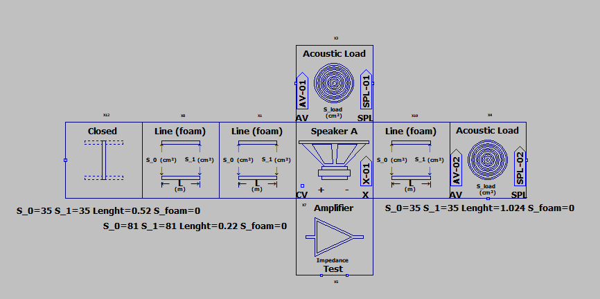

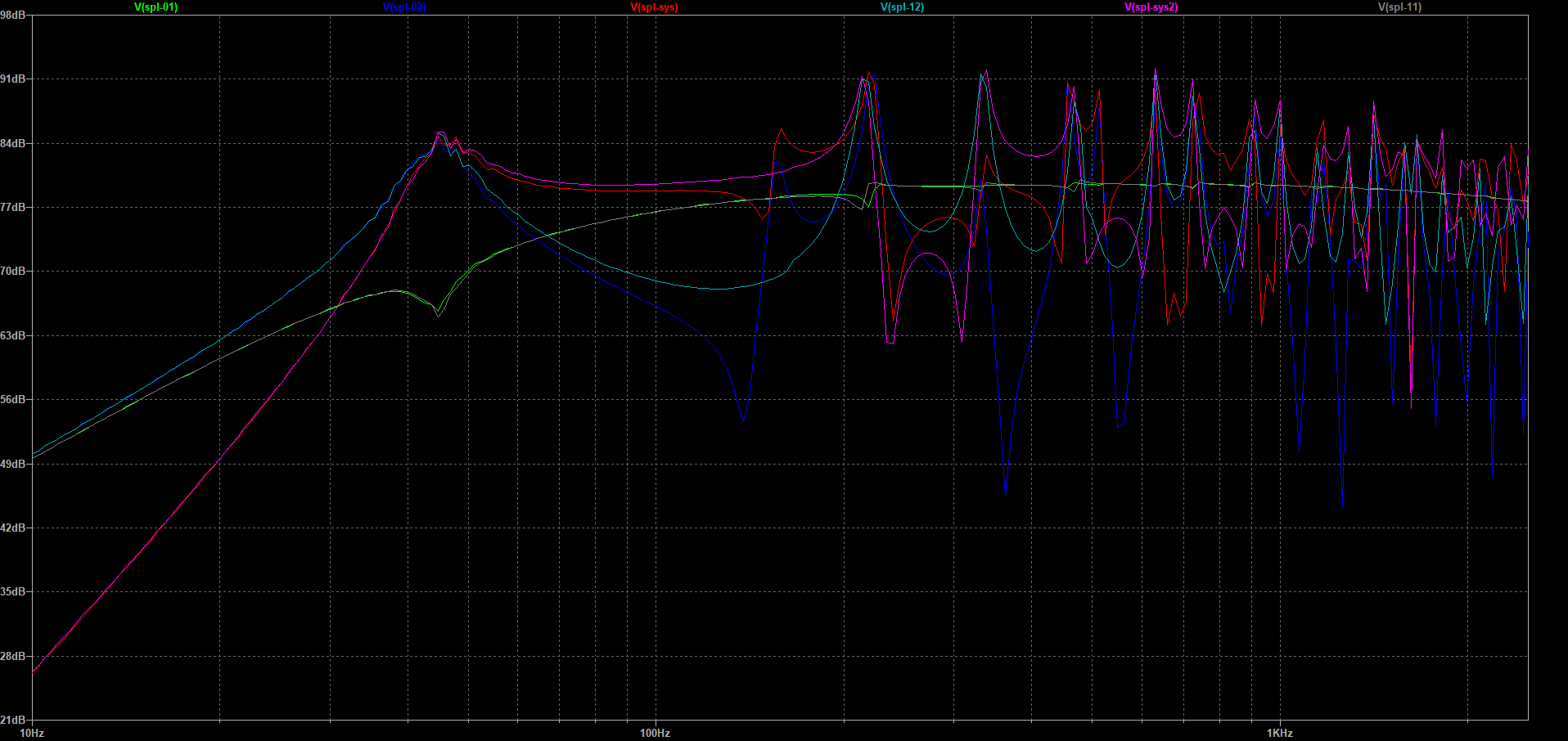

wait: there is more...version 1.7, with closed end:

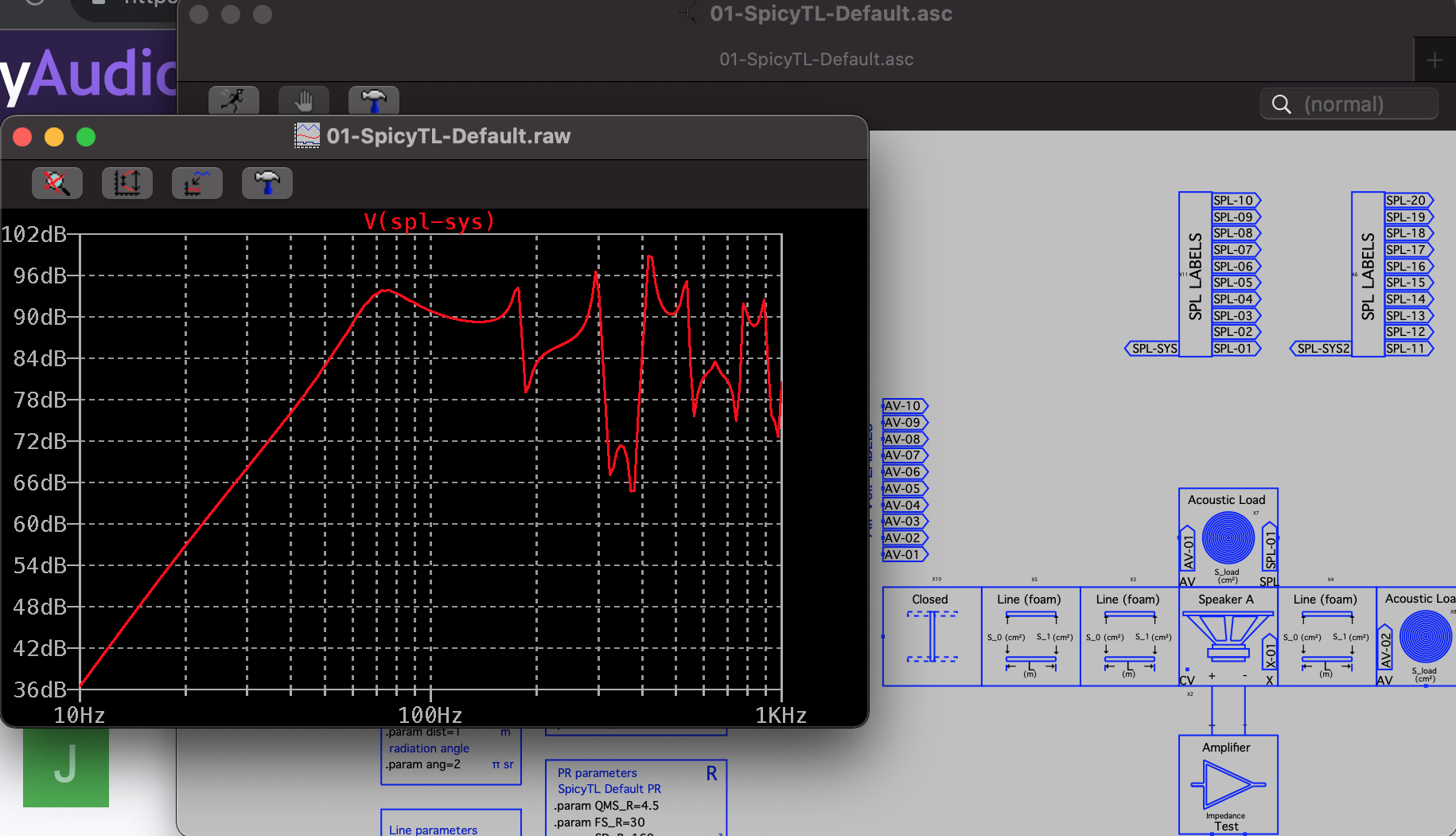

matching circuit verson 2.0.2:
Sweet, right? ...but without the closed section...same:
So it LOOKS like all the line segments are by defaulted ended UNLESS attached to another line segment? Does the CLOSED circuit do anything, or can we just assume all line are closed unless they have a load attached?
Jeff, it may seem like nonsense, but the equivalent electrical circuit of a "closed end" is acoustically an open circuit. The end of a segment (if not loaded in any way) then automatically behaves as a closed end. The structure of SpictTL2.0 made the "offset" block superfluous, so I created the "closed" block because, especially when placed between two segments, it helps to understand graphically how the design is structured.

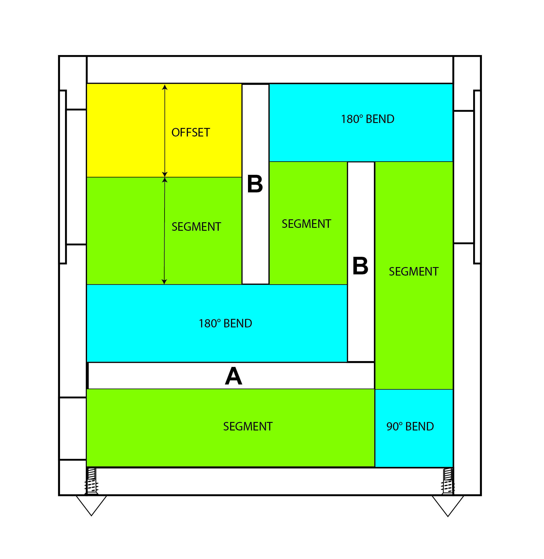

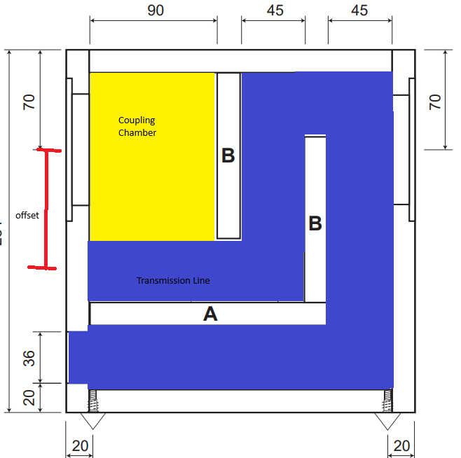

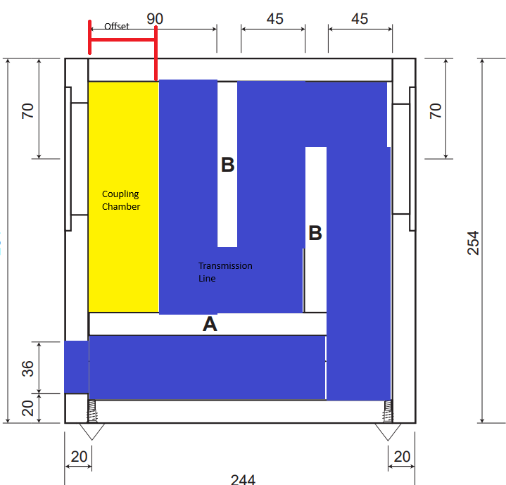

Hi Andrea,
Thank you for the response!
Thank you for the clarification on the advantages of using a Line over a Volume, I had my suspicion that was the case, and will continue using Line. I still get different results depending on how I structure it.
When you describe the offset for the coupling chamber as a " small mounting offset along the line, usually made inevitable by the shape we intend to give the speaker, in which direction do you mean and what do you consider the chamber and tube. Is the offset towards the face of the speaker or along the line?

Hi Andrea,
For 'offset', we mean the distance between the speaker axis and the beginning of the TL, therefore you should reason as shown in the attached figure.
