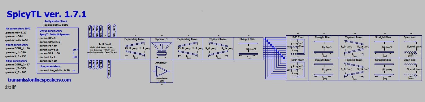

hi.
I thought of doing it like in the attached image.
in the first section (expanding foam) I inserted S_0=0 S_1=615. and in the second section to the right of the speaker (expanding foam) I inserted S_0=615 S_1=1200.
however when I launch the simulation it gives me a series of errors and no output signal.
hi.
Unfortunately, it’s not that simple. Each wire carries very specific information, and the internal architecture of SpicyTL doesn’t allow for that kind of connection (which is instead possible with version 2.0). The good news is that, if the two parallel segments are identical, you can model them as a single duct (doubling the area of the segment, of course).

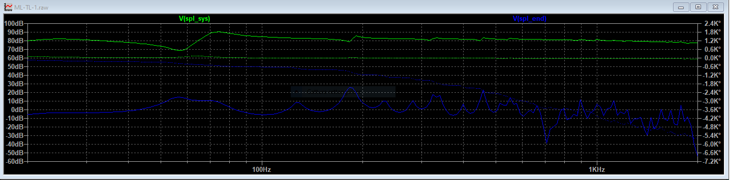

I tried with another computer.
same diagram as the one above but without foam.
it comes out as in the attached photo. I did not carefully check if the parameters entered are perfectly accurate. I wanted to quickly try what came out.
how do you interpret the graph?

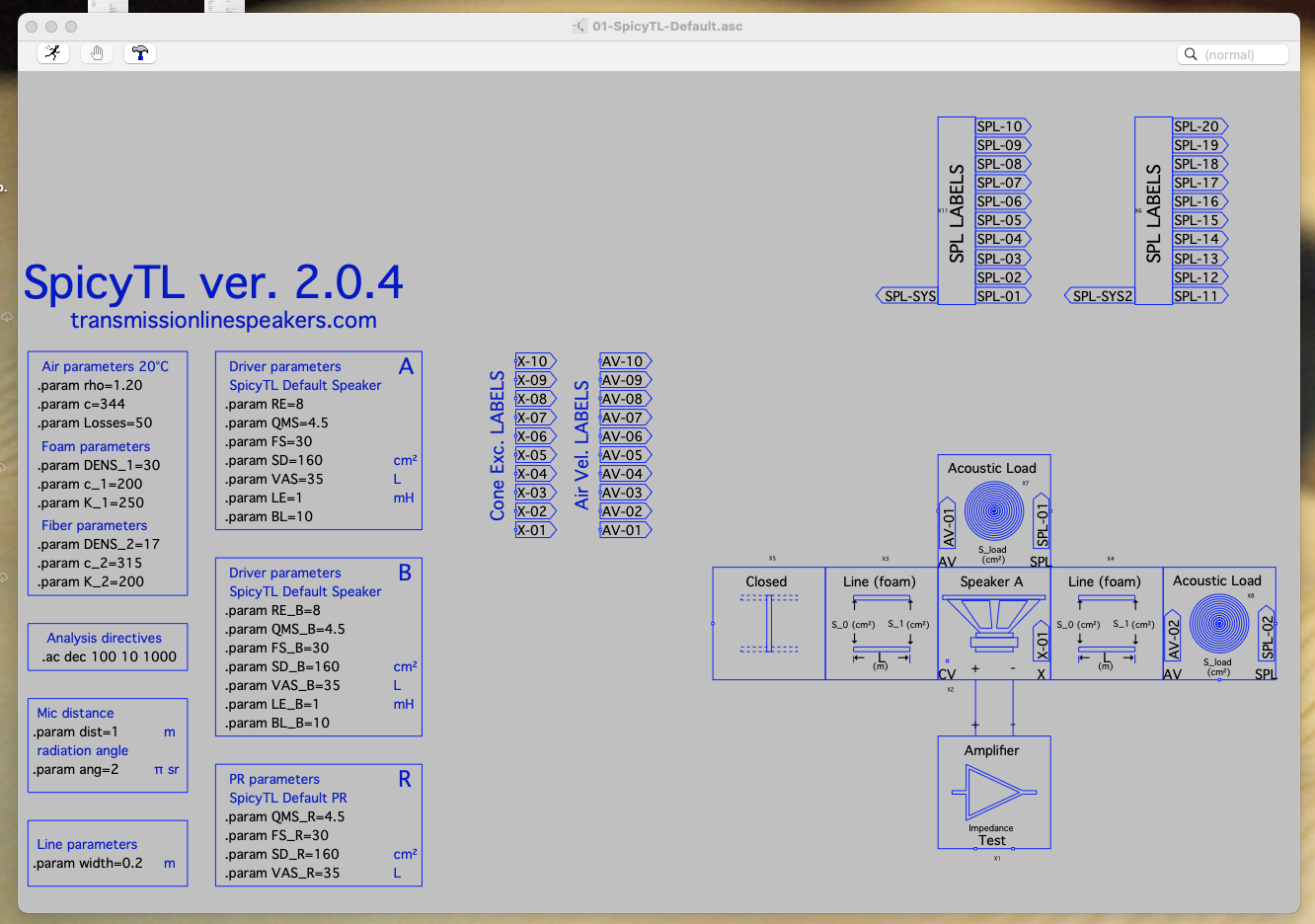

I installed the latest version of LTspice and SpicyTL ver. 2.0.4 on the Mac but seem to be missing most of the menu bar at the top ?
Any pointers appreciated. See attached screen shot.

HR looks simpler to use.
If the TL is starting from the back of the driver, then use the Nd function and fill out S1-S2 and L12.
If you want to move the driver down the line, then use the OD function and fill out S1-S2, L12, S2-S3, and L23. Go to the Loud Speaker Wizard to slide the driver up or down the line until you get the response you want.
