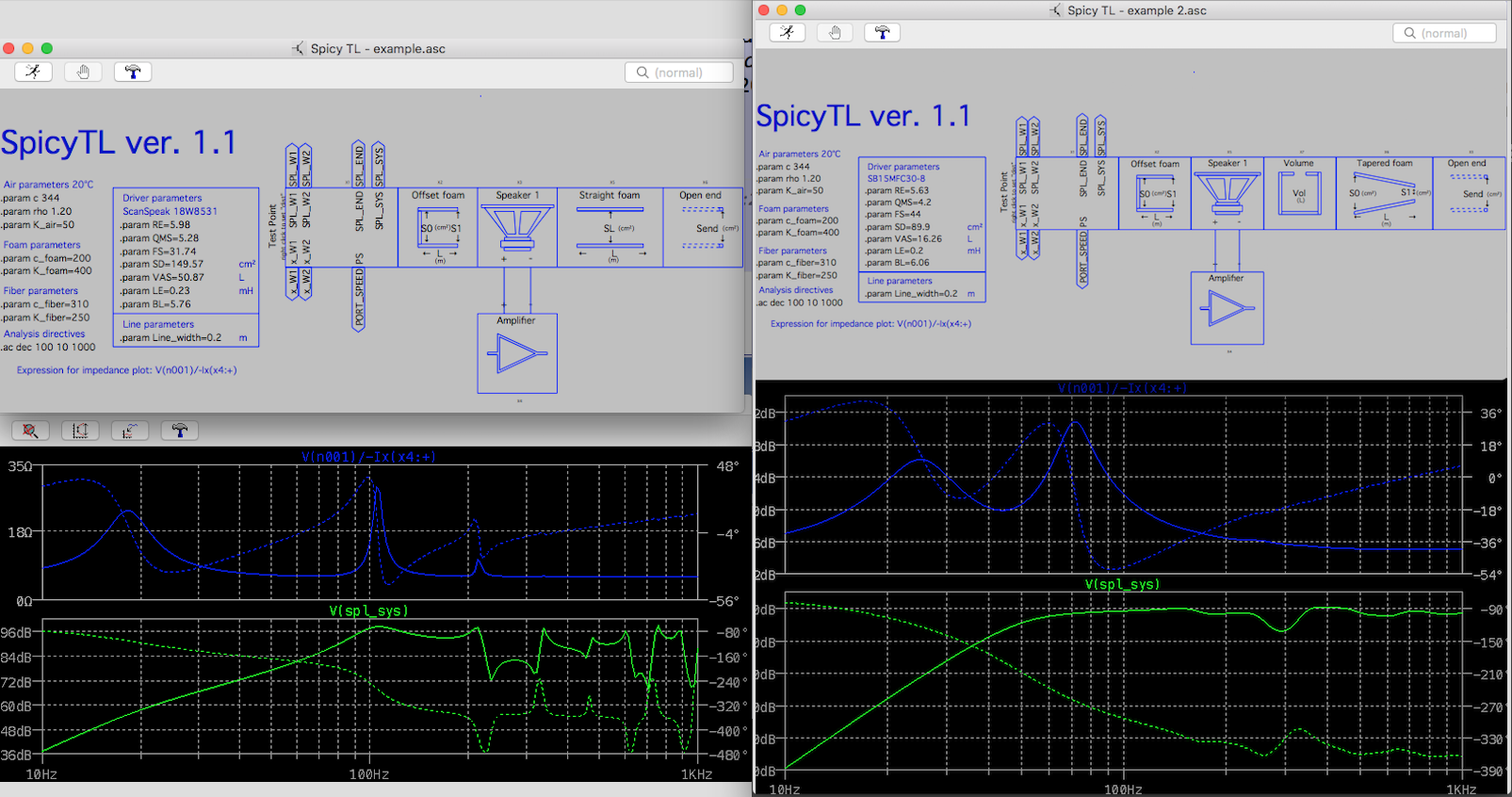

I am new to SpicyTL and I'm trying to run the default model as a starting point. The name of the model is "01-SpicyTL-Default". It seems that the model has meaningful params entered to run without further edits. At least this is my assumption. But when I hit run I see no graph for the frequency response, just an empty grid. I am on LTSpice version 24.0.12 (x64). What am I doing wrong?
Hi Buddy,I am new to SpicyTL and I'm trying to run the default model as a starting point. The name of the model is "01-SpicyTL-Default". It seems that the model has meaningful params entered to run without further edits. At least this is my assumption. But when I hit run I see no graph for the frequency response, just an empty grid. I am on LTSpice version 24.0.12 (x64). What am I doing wrong?
I’ve just updated the plot settings in SpicyTL to enable the automatic display of the frequency response and impedance curves. Please download the latest version of the software and try again. This should resolve the issue you’re experiencing.
