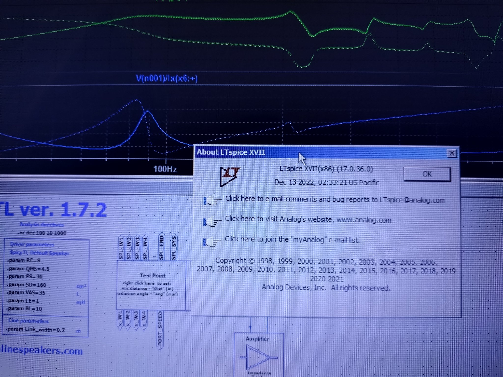

@slocum What is the minimum version number of LTSpice that the simulation will run on? The latest version of LTspice doesn't want to run on my windows and I get errors when opening the default .asc schematic with an old version of LTSpice.

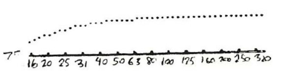

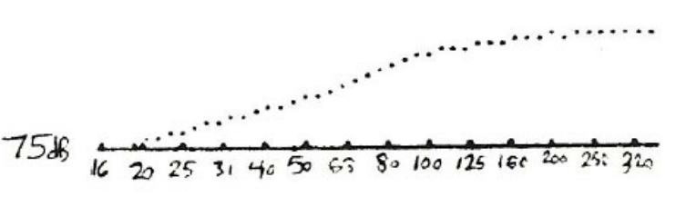

The important question I wanted to ask. Till this day I was using Hornresp to perform TL simulations. However Hornresp does not seem to simulate the speaker performance at the low frequency and simulates only the 1/4 effects of the transmission line. From what I see SpicyTL does not simulate this low frequency extension effect either. Is that correct?
Let me explain what I have in mind. The first graph below shows the frequency roll-off of some speaker. This roll-off depends on speaker's T-S parameters Qts, Mmd, BL. The first example shows a poorly chosen speaker as the roll-off starts already at 100Hz.
We can improve the low frequency response of the speaker mounted in TL enclosure by selecting another speaker with the above parameters more suitable for TL type of enclosure. When I modify the above T-S parameters the frequency characteristic should be extended to the lower frequency end as it is shown in the second graph. However when I alter Qts, Mmd, BL in Hornresp the frequency characteristic does not change. Can SpicyTL simulate this effect?
Hornresp does simulate the low-frequency performance of transmission line enclosures, including the effects of the driver's T-S parameters and the enclosure design. If the modified T-S parameters do not result in visible changes, it is likely that there is an issue with the TL configuration or the simulation settings. Hornresp and SpicyTL cannot ignore these effects unless there is a problem with your inputs.

@polcad Which version of Windows are you running? And what are the versions of LTSpice that you have tried? It could be helpful to know those sorts of details.
@witwald Win7 Home. The latest LTSpice does not want to run on it.
I have installed LTSpice 4.21f and the latest SpicyTL "default" schematic opens, but during loading I get error messages "Unknown symbol syntax: V".
I do not know what it refers to. The loaded schematic is readable but with some messed up symbol in the middle. I know it is a bit ancient version but I normally use linux.

I can confidently say that SpicyTL worksheets maintain compatibility with LTspice XVII, but it’s plausible they won’t work with version IV, which is really quite old.
LTspice XVII should run without issues on Windows 7 (both the 32-bit and 64-bit editions).

These latest versions LTSpice on my Win 7 32 bit didn't want to work, but here's a version that works for me with the latest SpicyTL.
