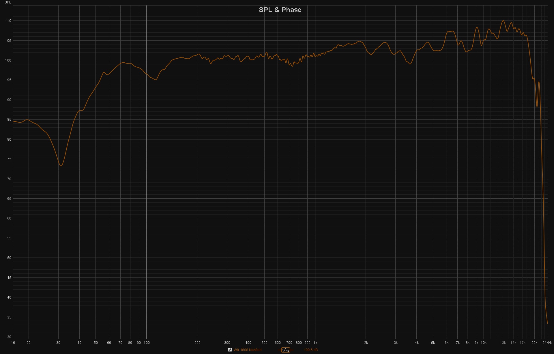

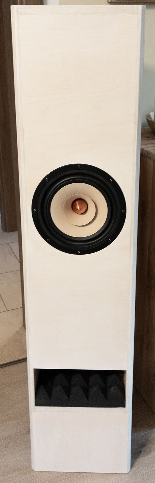

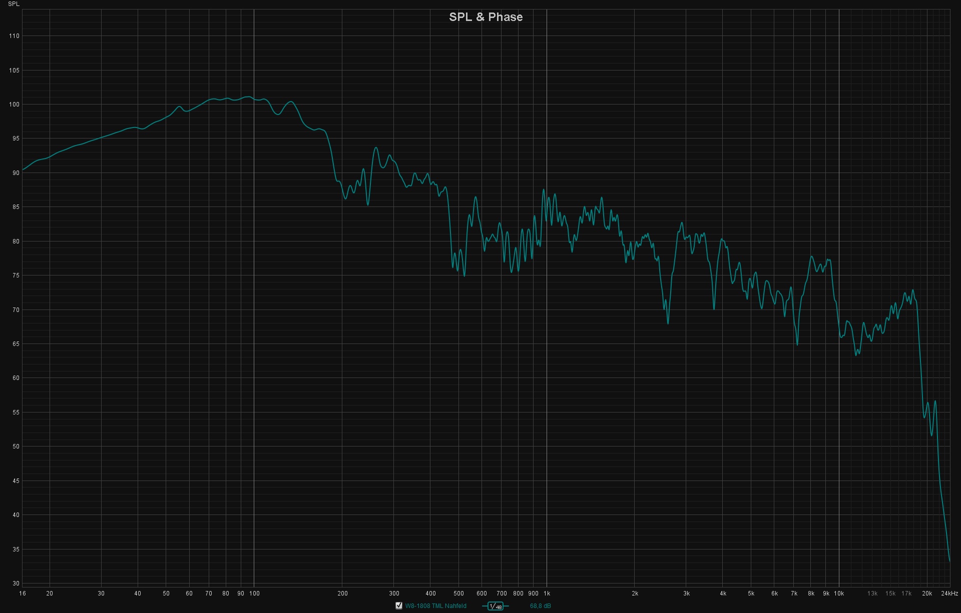

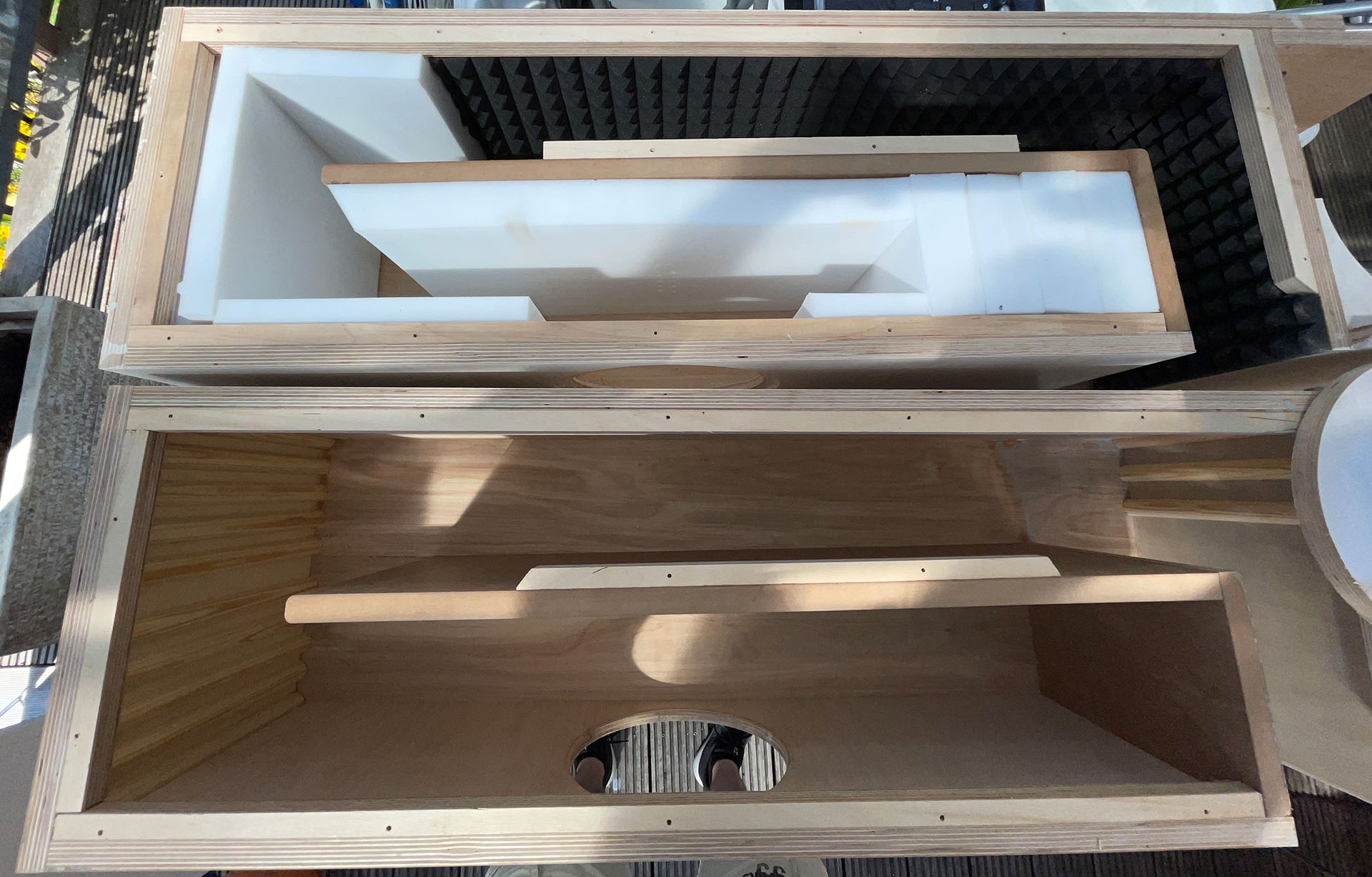

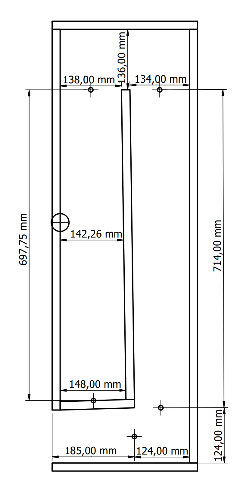

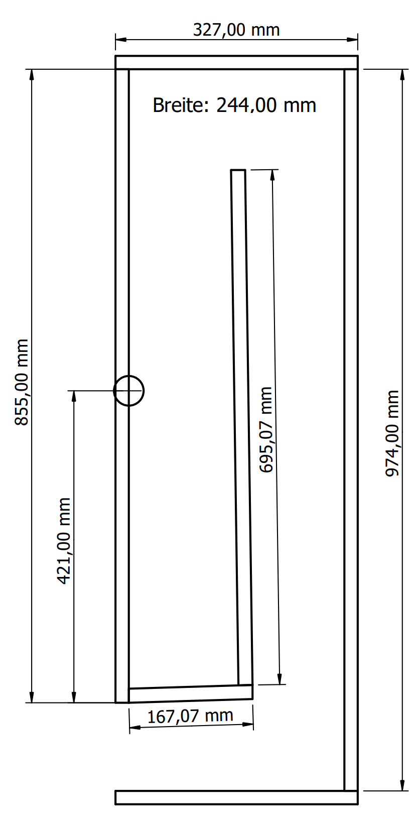

Hey
I build a speaker case for the Tang Band W8-1808. For my first one, the result sounds superb for my ears. Agile, everytime on the point but never tensed. A perfect speaker for my KT88 tube amp. 😀
The simulation was helpful. But in the end, every damping material is different and it took a lot time to find the best setup. I started with the calculation of a low tunes 1/3 line and used my improved excel sheet to calculate the details for the construction.
I've used 30 and 40mm basotec foam and black PUR foam with the pyramid structure.
The speaker has only an impendance correction zobel network (8 Ohm / 4,7µF) but no FR corection. I'm using a miniDSP to mitigate some serious acoustic challenges in my living room. And the miniDSP can do the FR linearization better than any passive parts. Only a few carefull adjustments are required with the PEQ.
I've added the nearfield measurements from the end of the line and from the speaker center. I combined it with RWE to the full response.

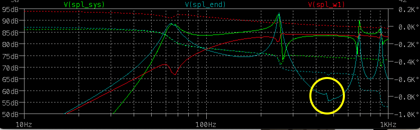

I've been trying to adjust the upper extent of frequencies displayed on the graph, and it just seems to keep resetting to 1KHz, is there a way to edit the frequency range plotted?
Many thanks,
Elliott Dyson
Hi Elliot,Hi Andrea,
Many thanks,
Elliott Dyson
you can edit the frequency range in the "Analysis Directives" in the main sheet:
.ac dec 100 10 1000
where 10 is the start frequency and 1000 is the stop frequency.
Having said that, remember that SpicyTL is only able to simulate TL behavior at low frequencies and in general it is not recommended to go beyond 1000 Hz.

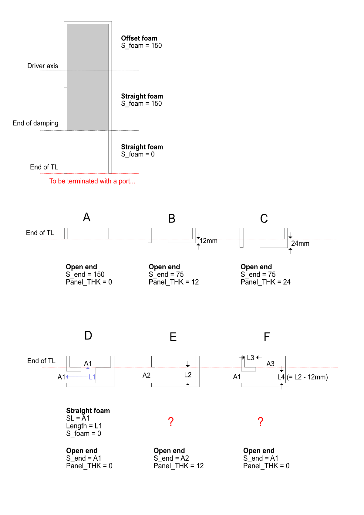

Hi Andrea,
Brilliant simulator!
I am modeling a TABAQ for ScanSpeak 10F/8414G10. I see that the open end/port configuration affects the overall output drastically in this MLTL design, so I'd like to model it correctly. However, I am not quite sure about how to model front-facing ports. Would you mind commenting on the following options? I will probably need to use option F in the attached drawing, but I also show others in order to understand SpicyTL better.
In the attached drawing, I show (1) the TL enclosure, (2) three straight open-end options A, B, C, and (3) three front-facing open-end options D, E, F.
The cross-section of the TL is a straight 150cm2 and the panel thickness is 12mm.
I think I got the straight ones A, B, C correct.
I attempted modeling option D as shown. The port has a constant cross-sectional area of A1. Is it OK?
For options E and F, how would you model the section between "End of TL" and "Open end"?
I get pretty good results (attached) with modelling option F as follows:
Straight foam (for the 18cm2, 3cm long port under L3)
SL = 18cm2 (port cross section area)
Length = 0.03m (Length of L3 port shelf)
S_foam =0
Open end
S_end = 18cm2
Panel_THK = 0
But I think this is ignoring the volume under the area A3 (which is 150cm2 minus the area occupied by the port shelf L3).
Thanks a lot.

TABAQ is a straight line and the last part has a smaller cross section. You can in fact put the cabinet on some feet letting the last part pointing down.
In my TABAQ the last part is made like a fold, slottet port if you like. There is no need to simulate the bend.

Hi Bjohannesen,
Thanks for your comment. I studied your TABAQ papers in detail 🙂 Let me also thank you at this opportunity for sharing them.
I built the speaker now from foam core board as a prototype before committing to wood, and the bass is indeed surprising.
The reason I wanted to simulate the port is the wiggle(?) the port introduces in the midrange (shown with the yellow circle in the attachment). Bob Brines fixes that wiggle by altering the driver offset by a few millimetres. Since he was bothered about the wiggle enough to move the driver around, I wondered if altering the port geometry instead of the driver offset would help.
But after simulating and building the foam core speakers, I too realised that that's a small detail to worry about at the simulation stage.

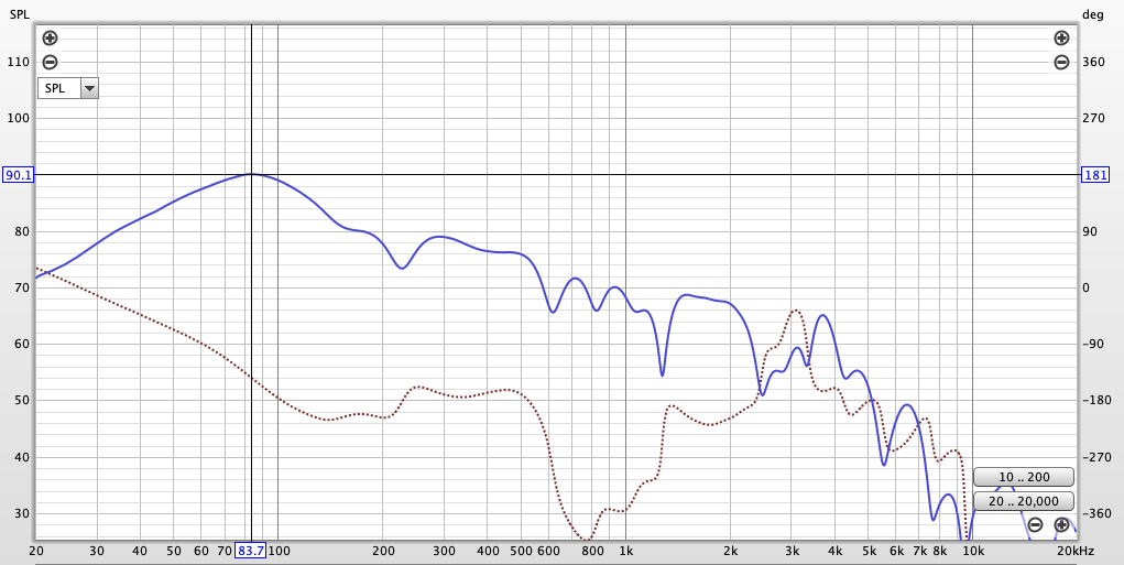

I did measure it (attached). The wiggle is not there. Measurement is at the mouth of the port. Stuffing is 17kg/m3 Knauf glasswool leftover from a house renovation (it's much nicer to work with than rockwool).
The port output peak frequency is much higher than modeled, ~84Hz vs 65Hz (the screenshot I've sent in my previous post is not for the speakers I built). I thought the foam core cabinet or the port might be leaking. The values are consistent across both speakers though. I also did an impedance measurement of the speakers with DATS, they were identical as well. So I think this may be something inherent in a foam core build. Foam core build has other issues for me as well, it's too transparent for mids even with two layers (10mm thickness in total). But I consider this proof of concept as successful, I just wanted to see the bass performance.
With respect to subwoofers, I can see that. I prefer the bass from these TABAQs to the dipole woofers I have in development (well, probably not anymore 😉). TABAQ's bass sounds more integrated with the full rangers. I'm really excited about the wooden cabinets that I'll build which may perform down to mid-60 Hz as simulated. The foam cores and the dipole woofers are in the second attachment (my wife is away at the moment, as you can tell 🙂).

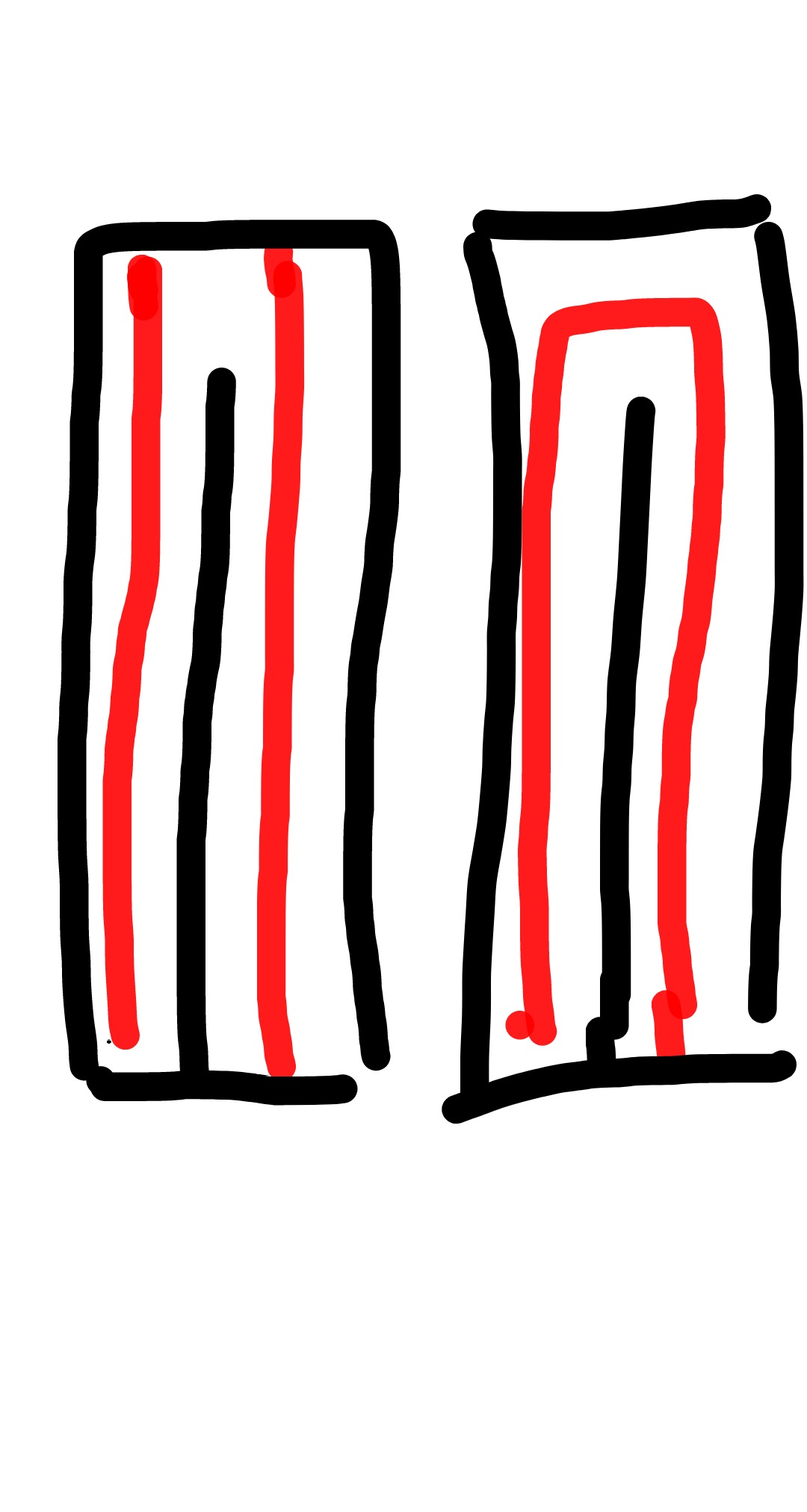

Sorry for the rubbish drawing. I've seen tl sketches measuring both ways but which is correct? As an example would a 1 metre tall box with just one bend like the drawing be a 2 metre line like the drawing on the left? I would you take the measurements through the centre and add the horizontal
measurement like the drawing on the right?
It's a good approximation, but to get best accuracy you'll have to use this for determining corner bends.
Thank you I will read the link.It's a good approximation, but to get best accuracy you'll have to use this for determining corner bends.
