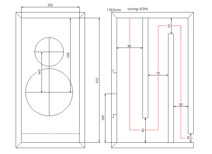

How big(area in crossection) is your line? I run rs100-8 in offset 42/80cm entries to 3” sched 40 pipes(45.6cm2) at 122cm total. I give up few cm on the end offsetting the exit a bit upstream.. These are fully stuffed, however that is very very open and teased. Another version (pic) i played around with for fun was an Mtm is two seperate 3” pipes that converge as a single and exit with the short stub at the end. Same length essentially but with some bends and bringing the exit closer to the drivers.
Just wondering if you prefer a size?
Here you can see a design I made last year with the RS100-4. The c/s area was near 50cm2.

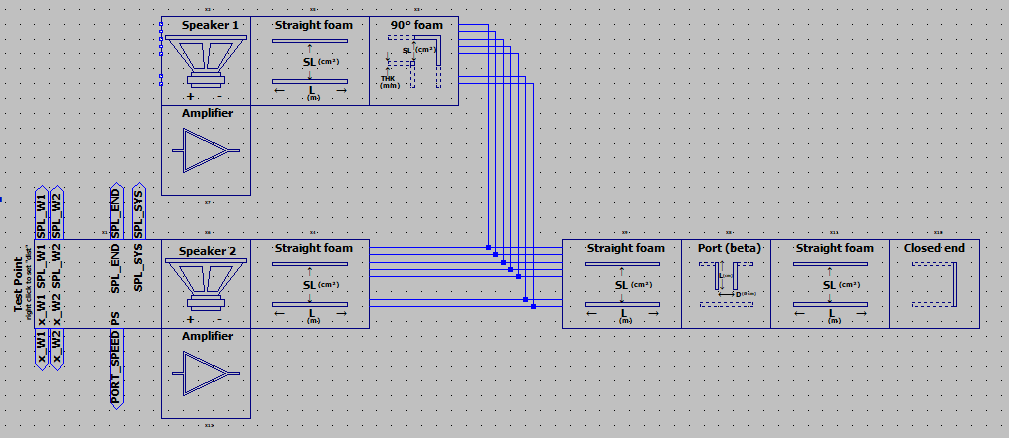

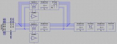

I think you can simulate your set-up with SpicyTL. Acoustically it should work as in the figure.

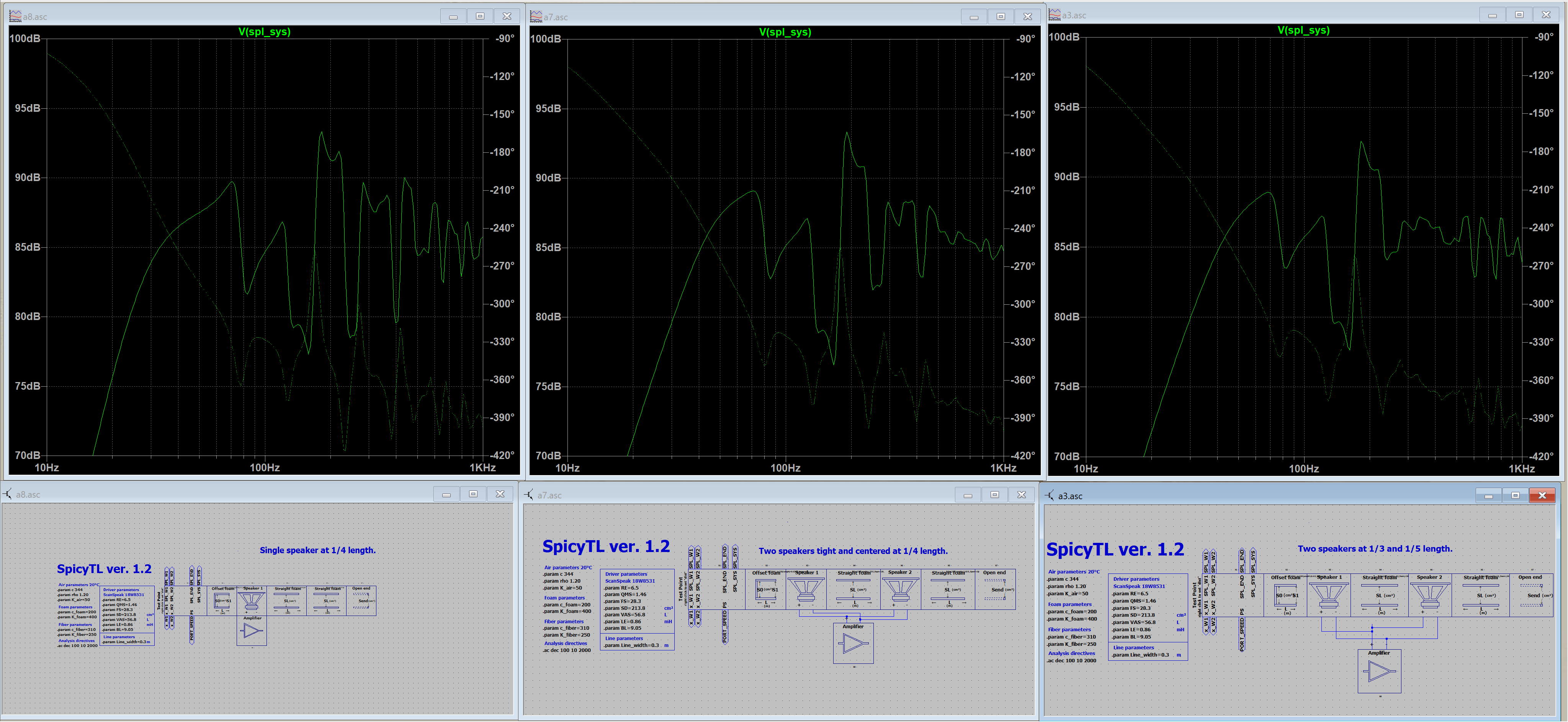

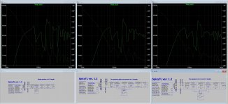

Andrea, Thanks for sharing this. There has been some chatter between folks curious about using two speakers in a TL. I think much of it started in the thread "An improved Transmission Line alignment". It mainly boils down to this: Is it better to place the speakers at the 1/4 point as close together as possible or to place them at 1/3 and 1/5 the line length in an attempt to cancel out the first two odd harmonics" (Not sure if the terminology is right)
Your model allows playing around and investigating this question. I am showing 3 models here, one speaker at 1/4 length, two speakers tight and centered on 1/4 length, two speakers at 1/3 and 1/5 length.
The two speaker models are powered at 1.415V and the single is at 2.83V. Everything else is the same between them. Foam depth was picked to easily see the changes but filter out the worst "noise". Speakers are RS225, line length is 300CM, line area is 230CM^2.
My observations. The single speaker at 1/4 placement does really well at the low end and is 5db over the other two at 30HZ. Otherwise the single speaker response is rougher than the other two models. The dual 1/4 placement and the 1/3 1/5 placement speakers are very similar and while the 1/3 1/5 is consistently better it might make sense for building ease and proximity of the two speakers to just place them close at the 1/4 point.
