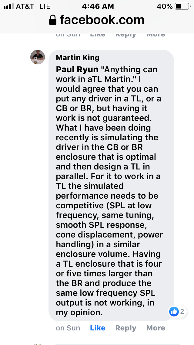

Why dont you ask Martin (today) what he thinks... but dont ask him in a way gives him the impression youre questioning his papers, etc. you have to avoid that human characteristic if defense. With any success or confidence in your motoves, you might find Martin has (and continues) to loosen up the reins on some of his rigid topics of 13-20 years ago.
Not putting words in the mans mouth, but he had renigged a lot of ‘exact’ expresions of many things now that he is recognized as authority on the subject(s) instead of having to disprove others and fight uphill with only a limited choice of approaches to do so and be affective.
That means ‘diversity, ‘alternate approaches’ and more ideas are becoming relevant and even experimented by him as he approaches retired. His most recent work on ducts, stubs and damping them in vsrois amounts and locations in a TL. Even as a compound version. With a bass reflex opposing a qW pipe, with similar size and tuning. To which we shared a few messages and ideas which, ended up with us both buying the sane book on the subject. (And a funny coincidence as we were both working on the same type of thing at the time, as personal projects. of course, he had the missing piece i needed to make mine function best... the old mans still got it! I predict a return to the TL and version 2.0 is a MLTL morph with a similar compounded pipe or bass reflex using the opposite side of the cone. Or scattered stubs at harmonics intervals(folding).

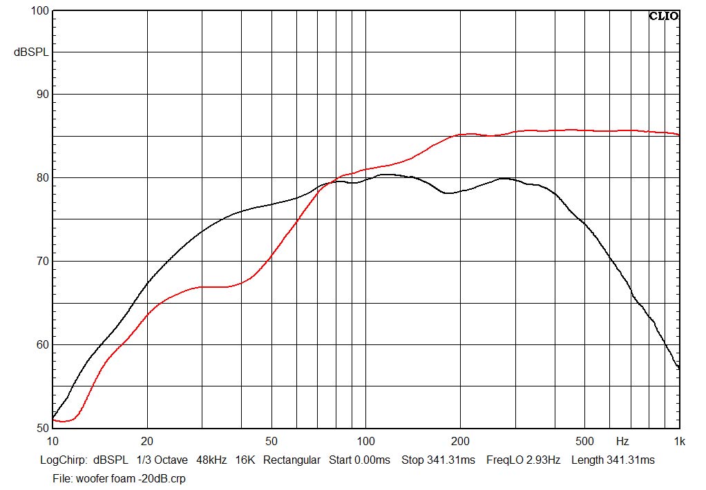

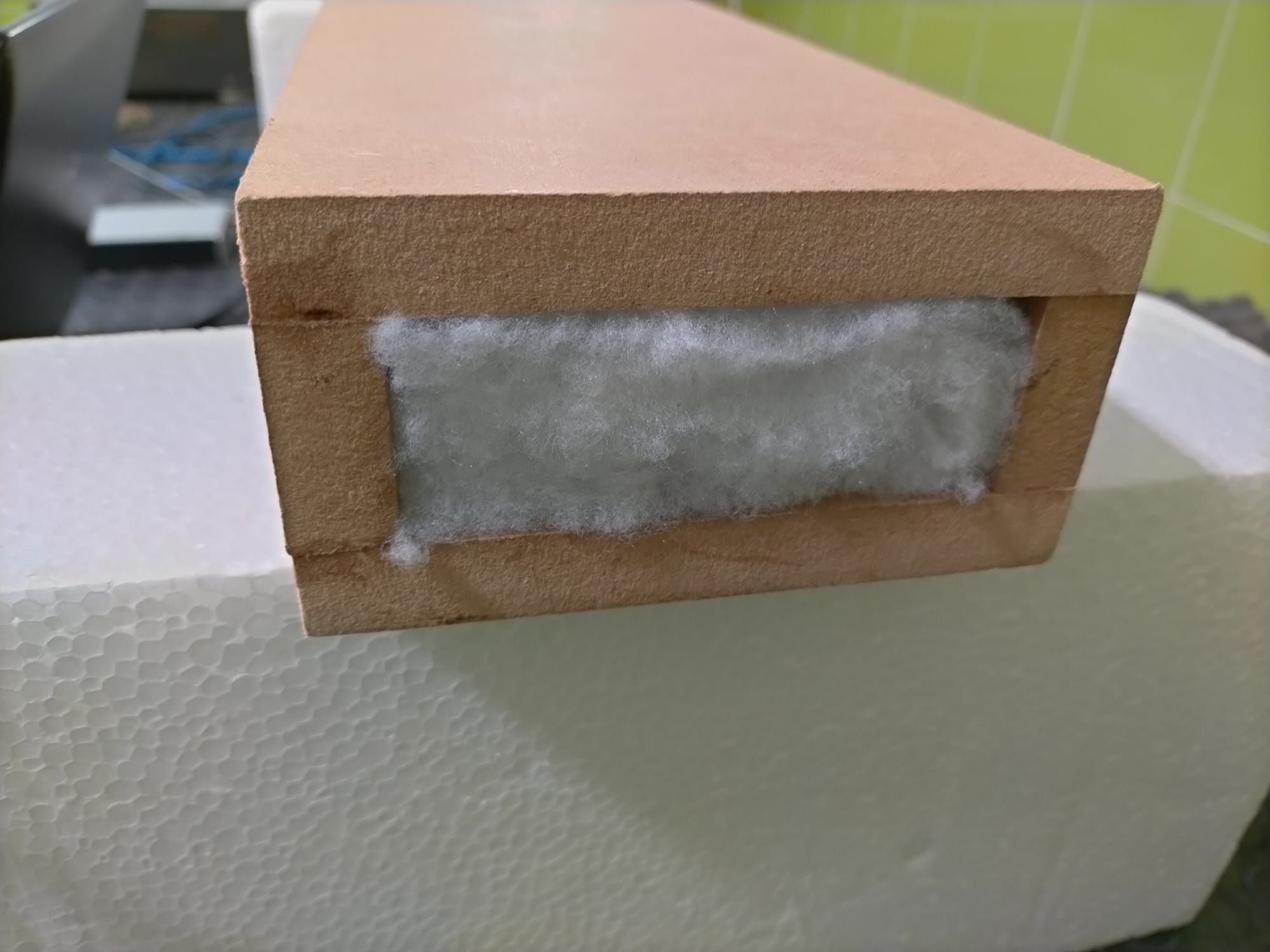

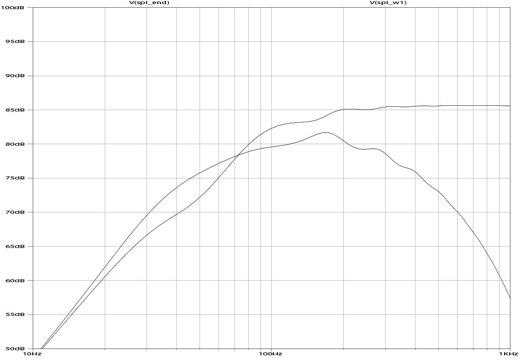

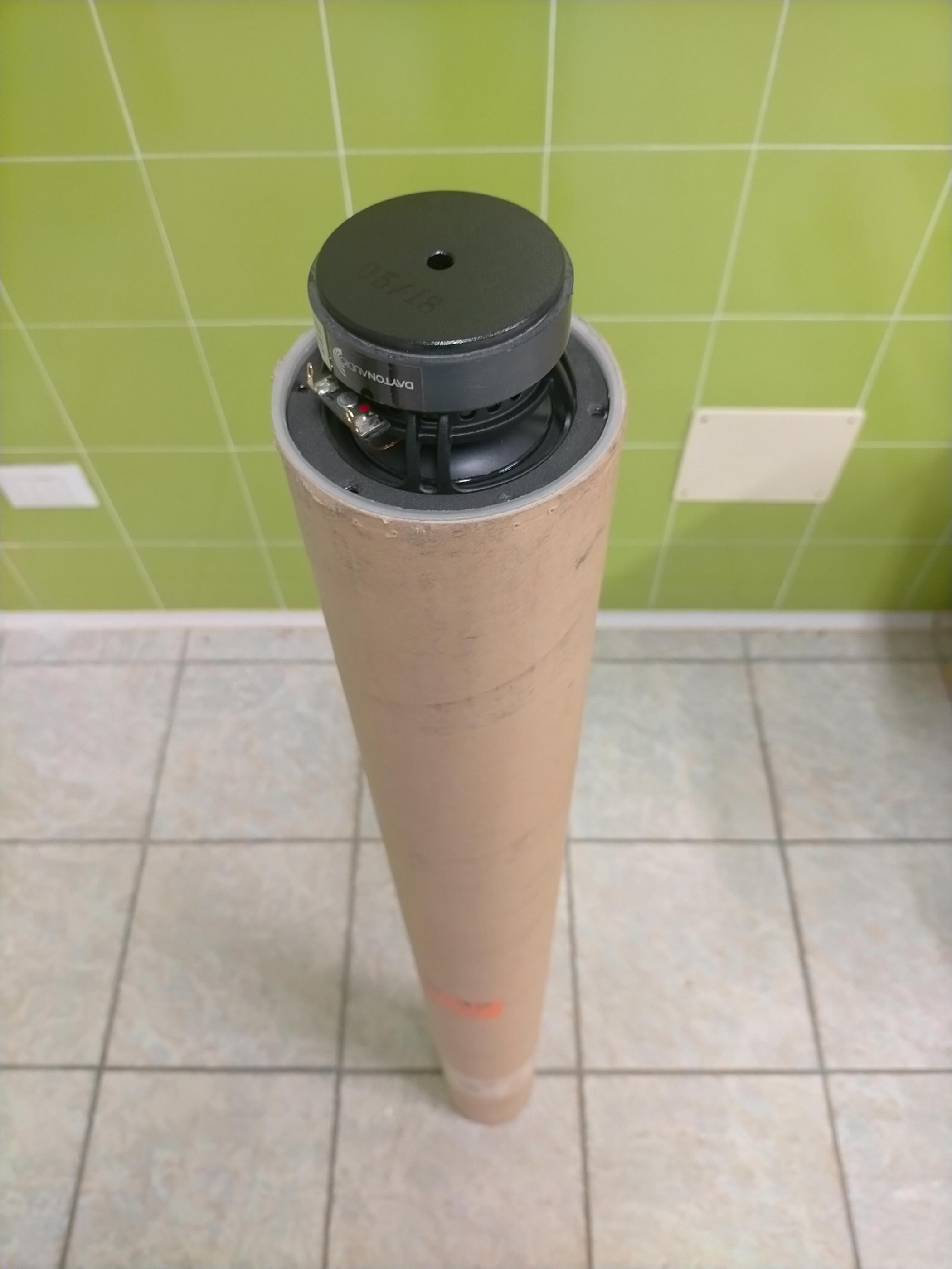

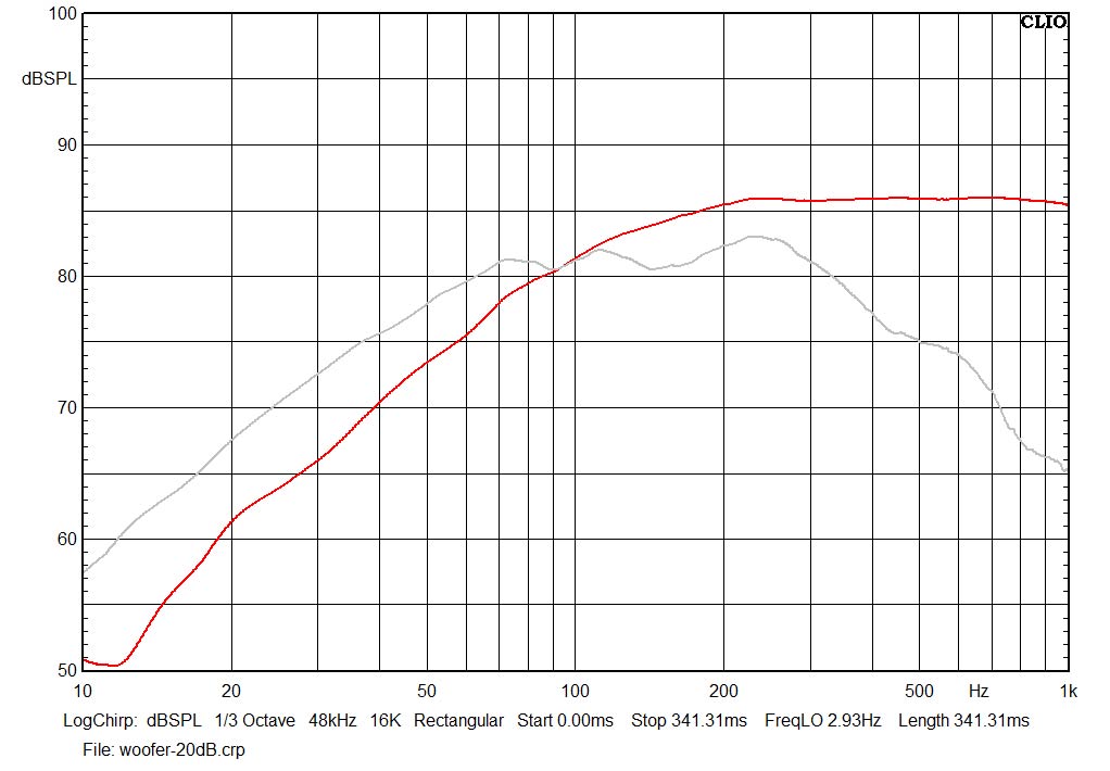

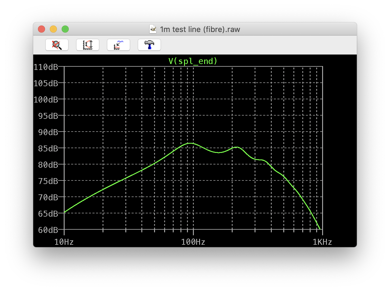

Today I did some testing on the _fiber model focusing particularly on the port output level.
I used my smallest test line: 1m length, SL=SD (35 cm2), RS100-4 driver, 100% filling with 60g of uncompressed Dacron (17kg/m3).
As I expected, the correspondence between measurement and simulation is almost perfect. The parameters used are those currently entered in SpicyTL as default values. I left the full graph, but given the size of the driver, anything below 50 Hz is not significant.
Thanks to the report of cs I also added a second parameter to the model which helps to better define the high frequency roll-off. This may come in handy when modeling the response with different damping materials. It was useful to further improve the response of the _foam models that were showing a slightly steeper roll-off than measurement.

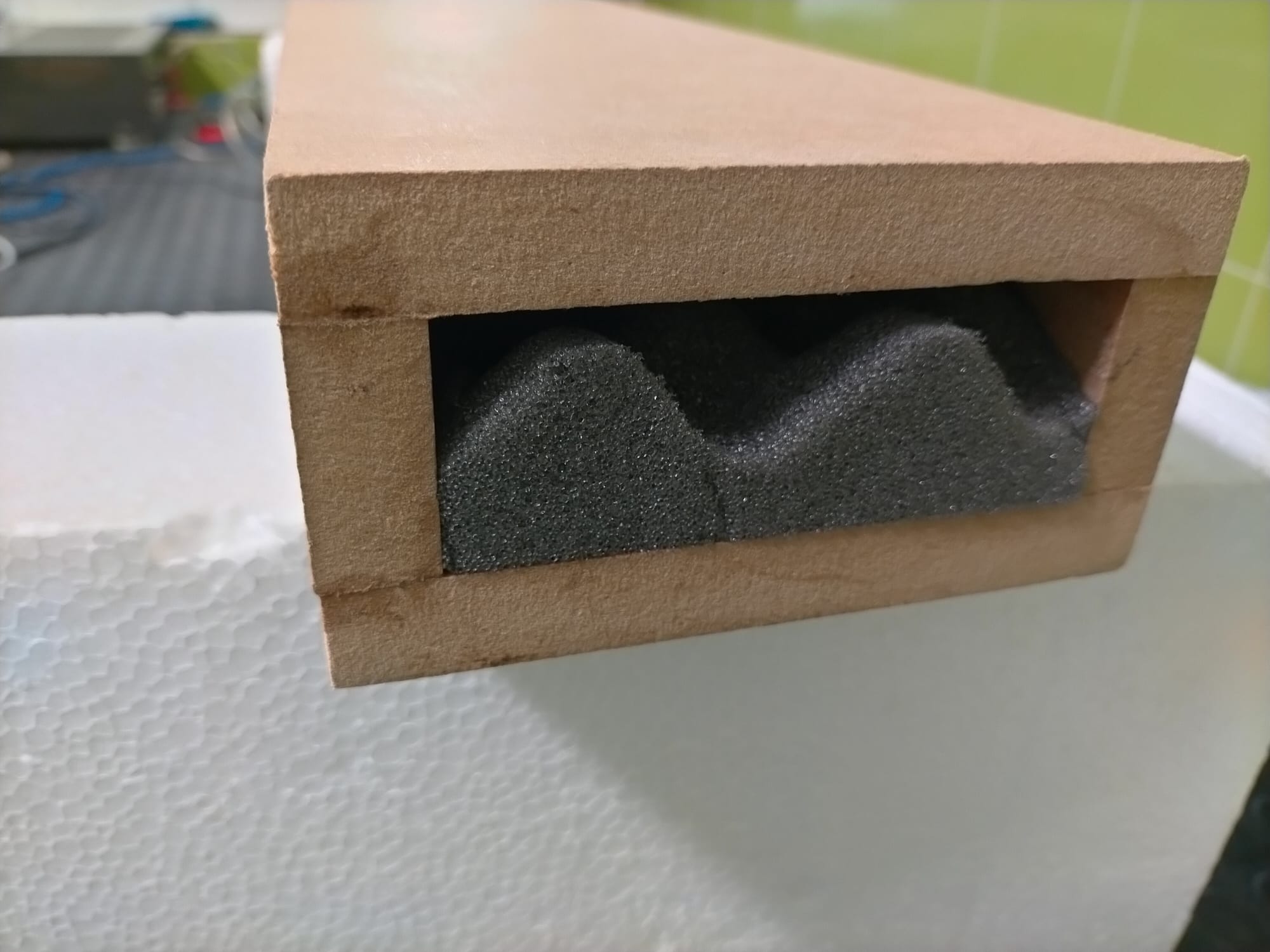

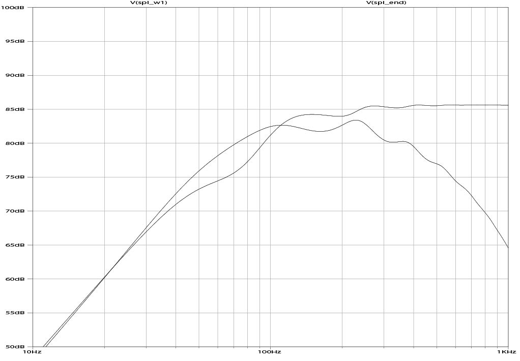

This is the simulation with 50 g of foam. The average sheet height is 2.5 cm which results in about 70% fill. Using the straight_foam block I simply set S_foam to 25 cm2 (the TL is 10 cm wide).

The line c/s equals Sd and the line volume is 3 times Vas. I think this is quite typical for a test line.

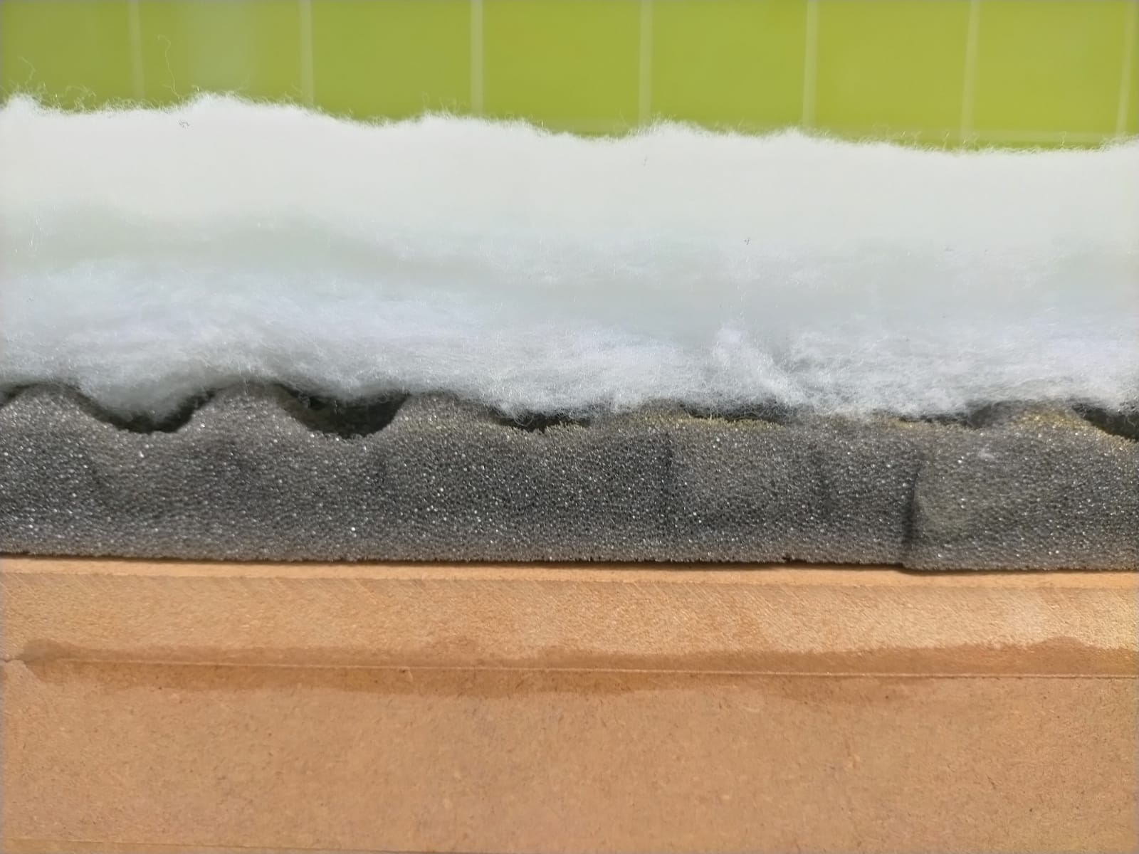

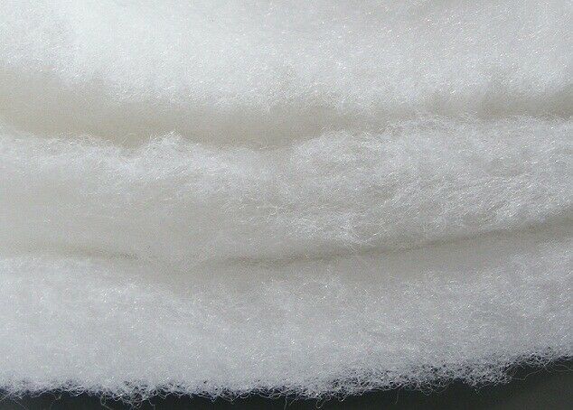

The Dacron I used is very fluffy. Take a look at the picture of the material outside the TL.
That is rarely enuff… and Sd is mostly irrelevant.
That looks far from teased sufficiently.
Small Packet post is cheap. And i have lots of acoutastuff. How many grams do you think would be adequate?
dave

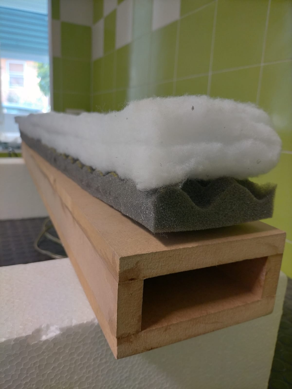

60 g of dacron and 50 g of foam. I confirm that Dacron can be pressed at will.
I'll send you my address via pm. To fill the entire TL would need 3.5 L of material.

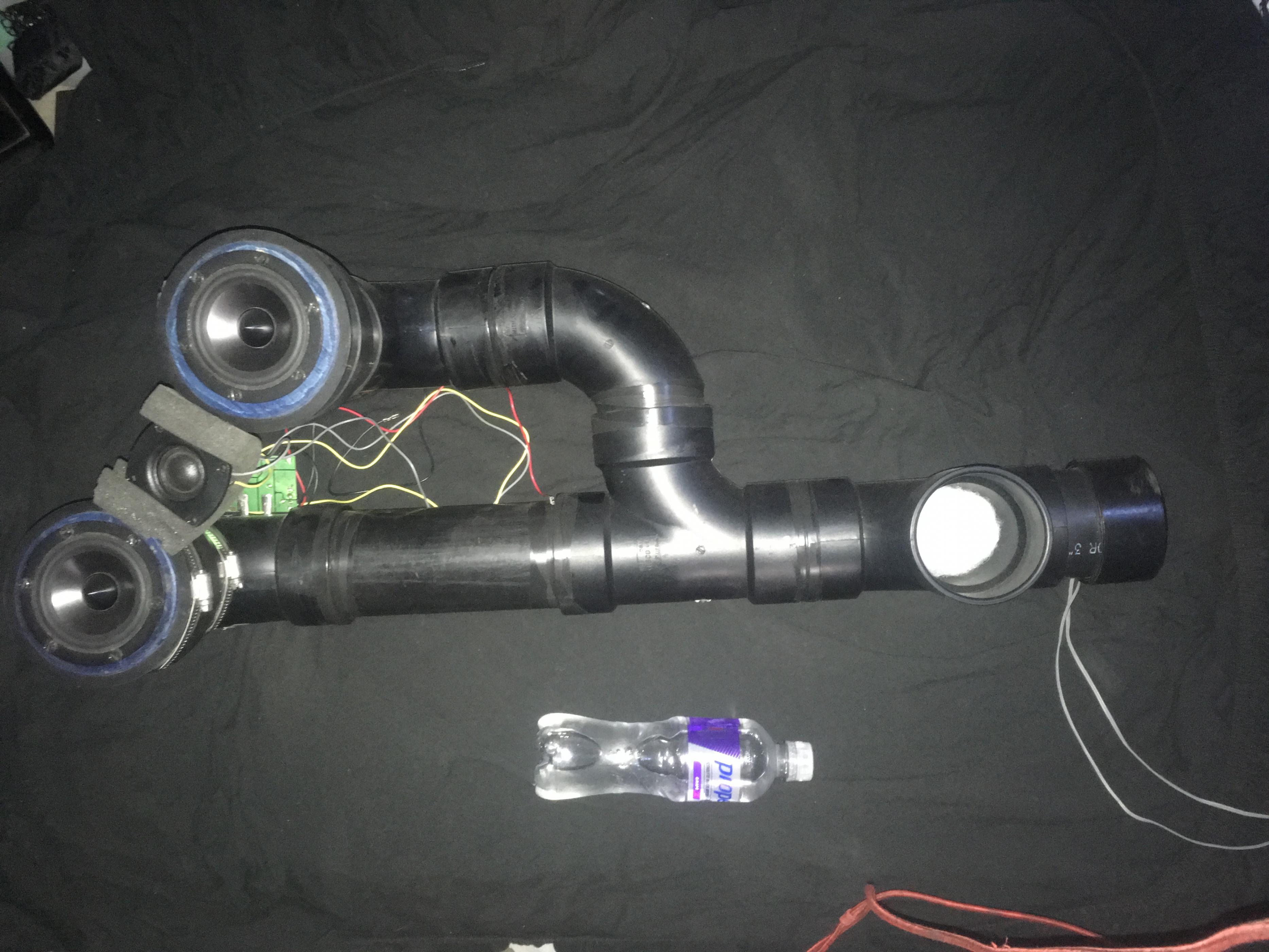

How big(area in crossection) is your line? I run rs100-8 in offset 42/80cm entries to 3” sched 40 pipes(45.6cm2) at 122cm total. I give up few cm on the end offsetting the exit a bit upstream.. These are fully stuffed, however that is very very open and teased. Another version (pic) i played around with for fun was an Mtm is two seperate 3” pipes that converge as a single and exit with the short stub at the end. Same length essentially but with some bends and bringing the exit closer to the drivers.
Just wondering if you prefer a size?
