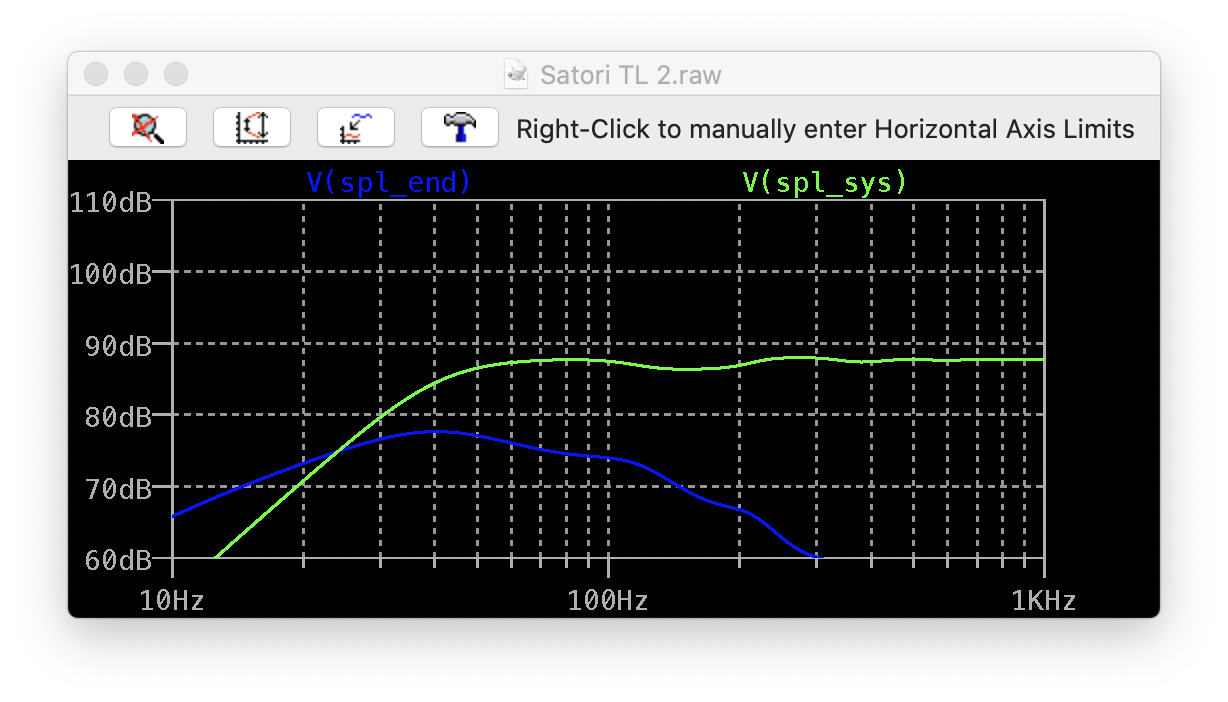

OK, some results using the straight fibre line SpicyTL model:
My original drawing has a folded line section which has a fairly uniform taper from 1.36Sd down to 0.53Sd at the port. To model this, I approximated the taper with a cascade of 7 straight line sections with diminishing cross-sections. The first two had the stuffing density at 100%, the next two at 50%, and the final three at 0%. Fiddling with the global K_fiber parameter until the results looked sensible (K_fiber=500) gave the following plot:
This looks fairly close to the MJK prediction, although the weak port resonance at around 900Hz is missing, giving less HF ripple. The port tuning is also slightly low (40 rather than 45Hz) but that is probably due to the taper approximation.

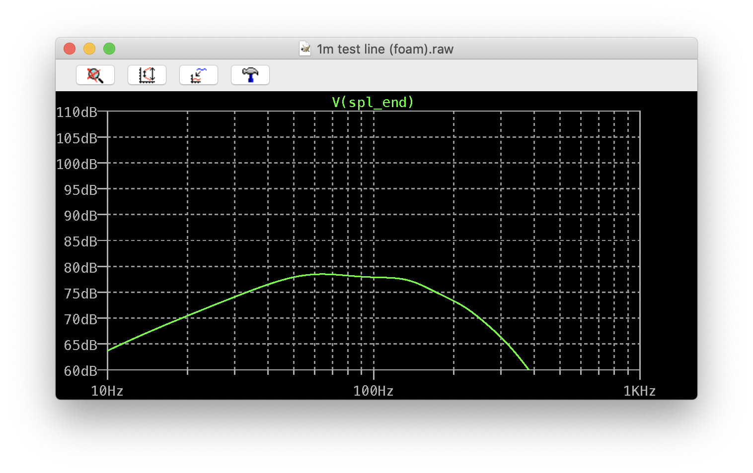

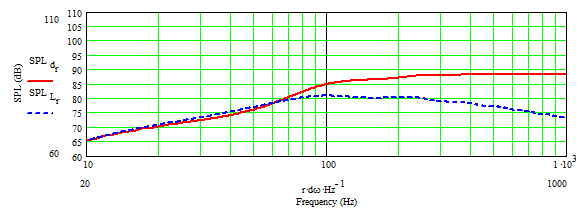

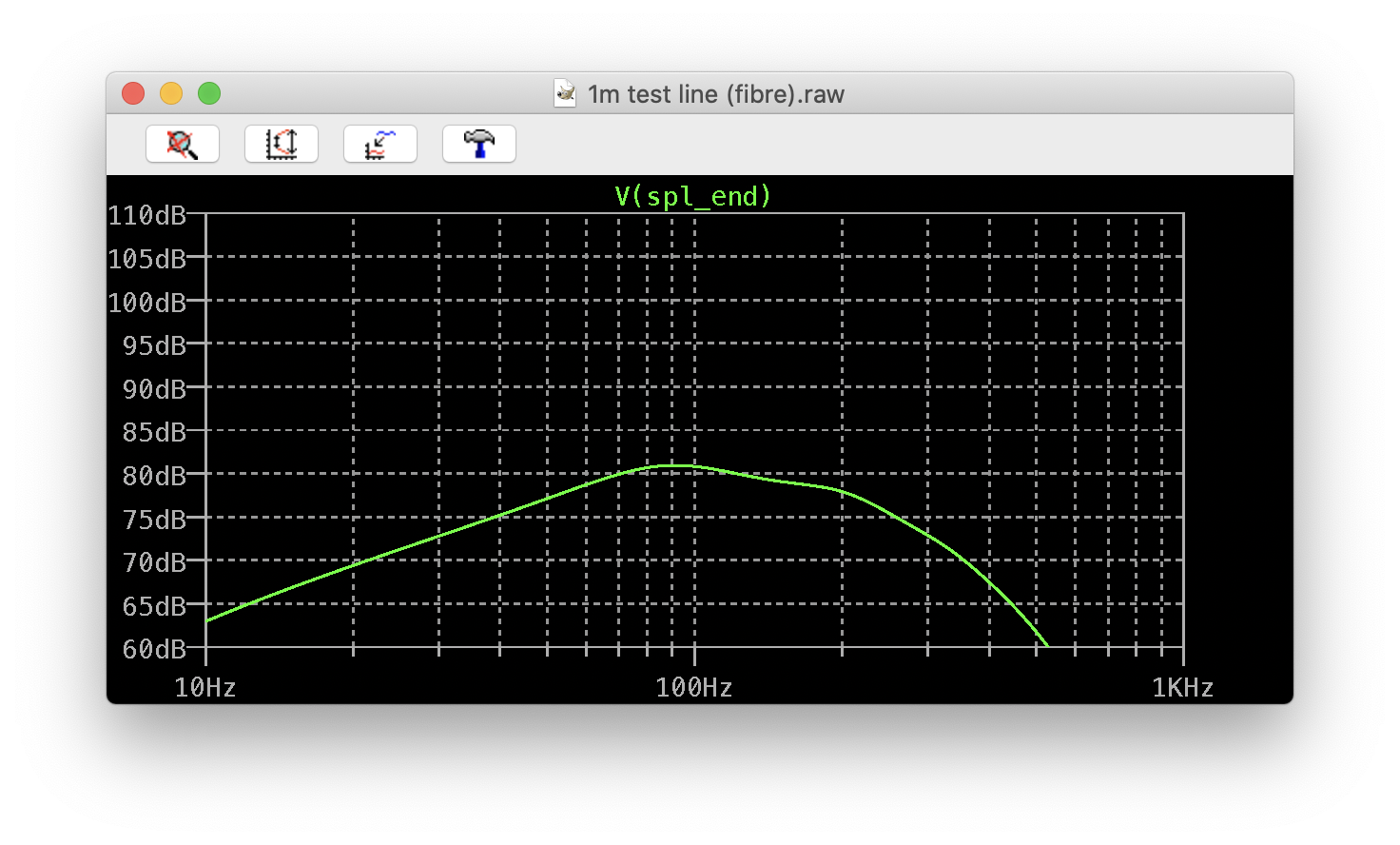

I thought I would try and get a better handle on the difference between foam and fibre using a simple test line, so I set up a 1m long line in the MJK software, fully filled with fibre at 1lb/cu.ft.
The driver is the MW16P-8 with 1W input power (giving 88dB at 1m) and the line cross-section is 119cm^2 (=Sd). Driver offset is zero.
I then set up the same model in SpicyTL and adjusted the K_fiber parameter such that the low frequency port level was the same as the MJK model (81dB). K_fiber needed to be set to 500. Finally, the foam line was used, with the fill factor set to 100%.
Here's the MJK output (the dashed blue line is the port output):
Here's the SpicyTL fibre line output:
Here's the SpicyTL foam line output:
It can be seen that the foam line gives the same low frequency level as the fibre, but the SpicyTL model rolls-off far more than it should with both materials.

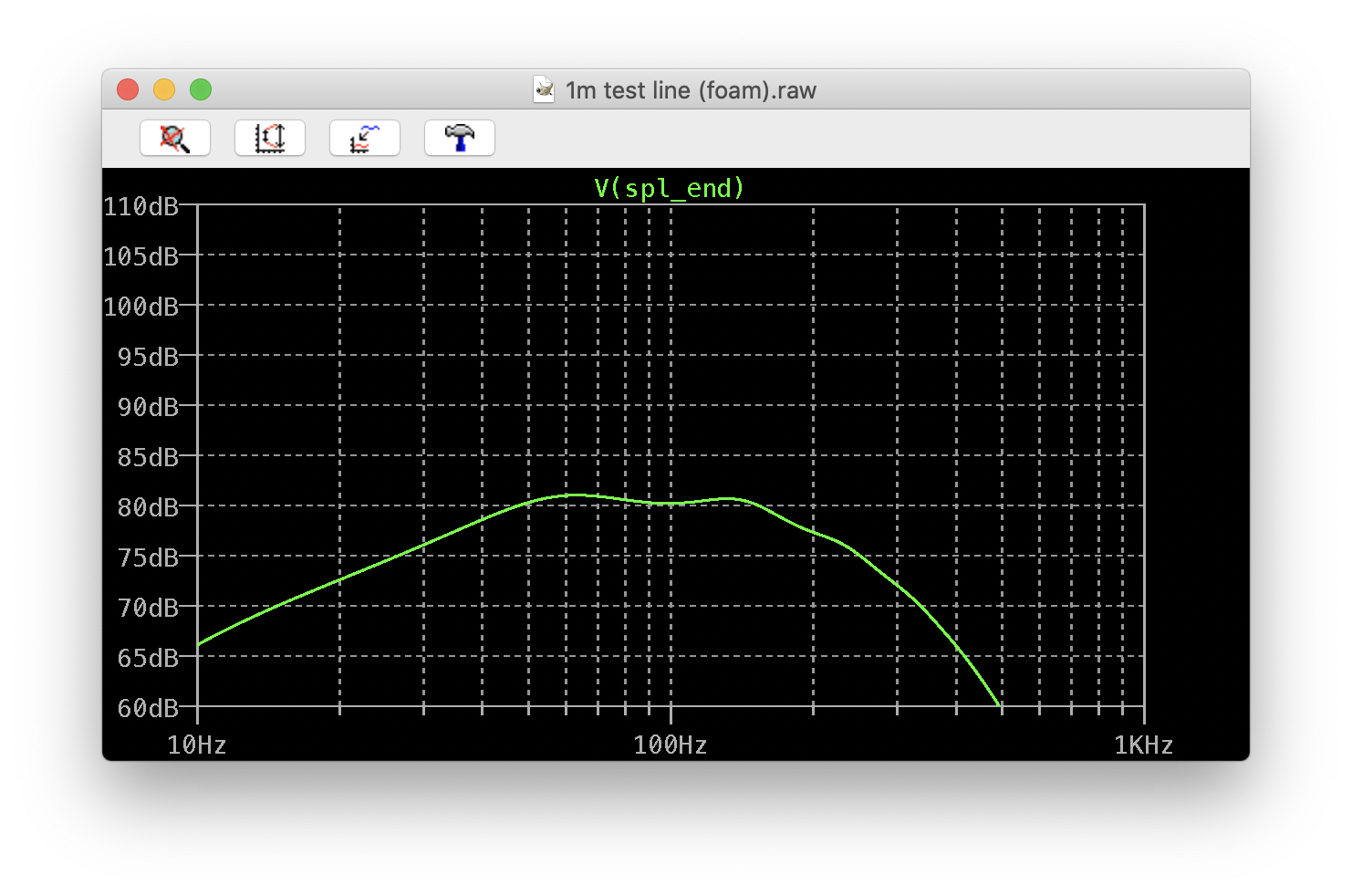

On edit:
There was an error in the foam line parameters, now corrected:
Low frequency level for the foam line about 3dB lower than the fibre, but both still showing more roll-off than MJK.
What happens to the port output if you set k_fiber to 250?
500 is definitely too high, and that is what determines the steep roll off.
