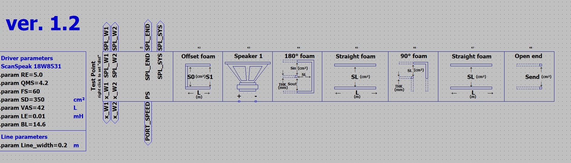

5. Finally, can LTspice's more advanced capabilities, such as parameter sweeping and Monte Carlo analysis, be used with SpicyTL?
Sure, you can use all the powerful features of LTspice.
More, with a good knowledge of electroacoustics and some familiarity with the software you can model virtually any design.

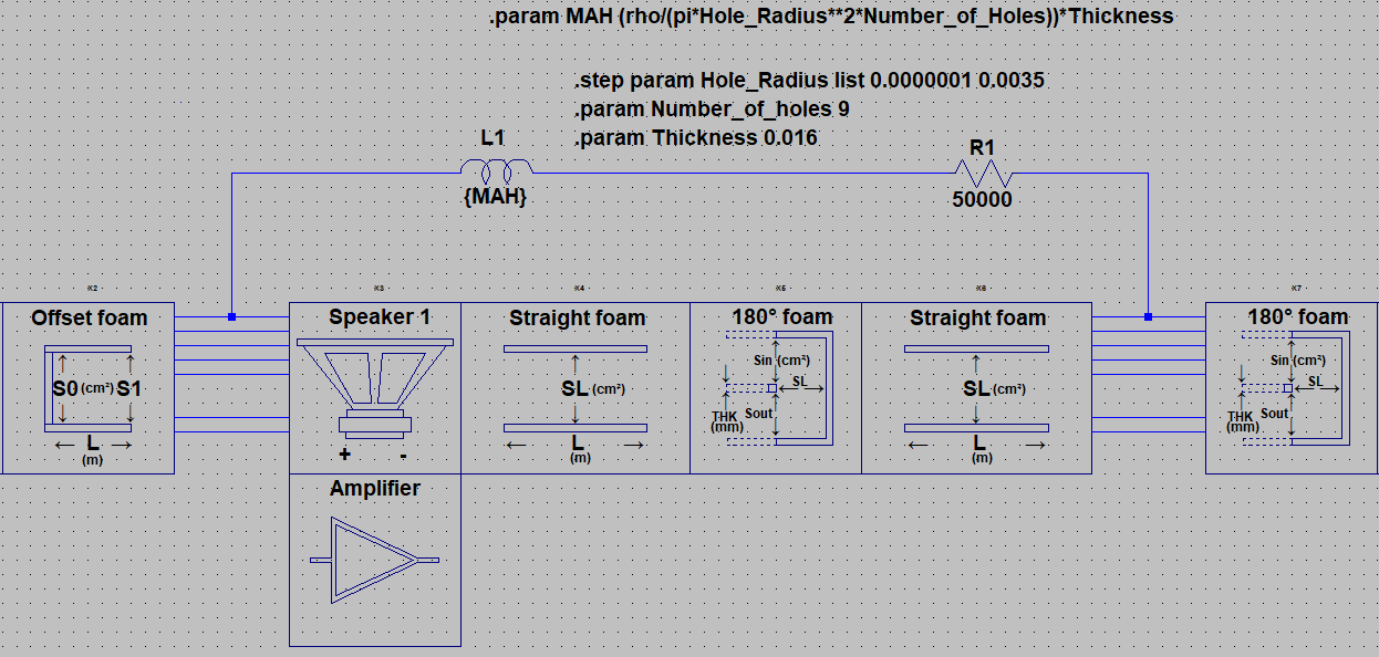

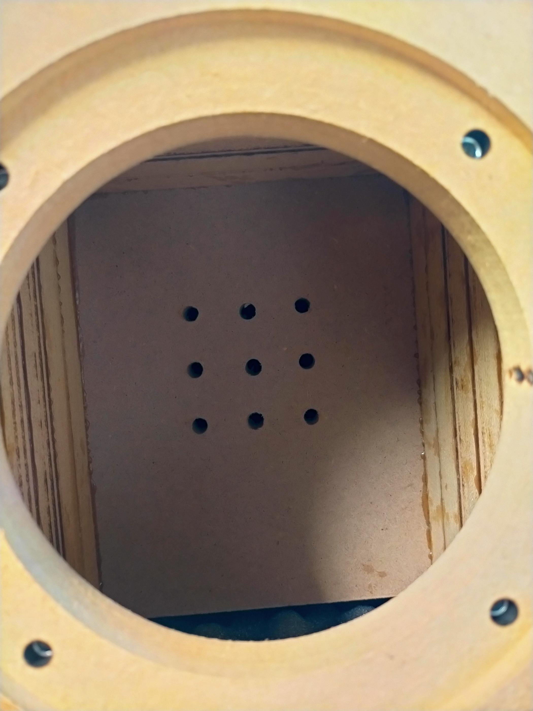

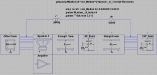

For example the configuration in Fig. 13 shows the effect of a few holes (foto 2) drilled in the first internal divider panel of the TL.
The idea was to slightly reduce the ripple in the response by offloading some of the pressure generated by the driver to an area close to 1/3 of the length of the TL. Something we could call "virtual offset driver".
In figure 14a you can see the measurement with and without holes and in figure 14b the relative simulation implemented with the command .step param

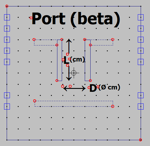

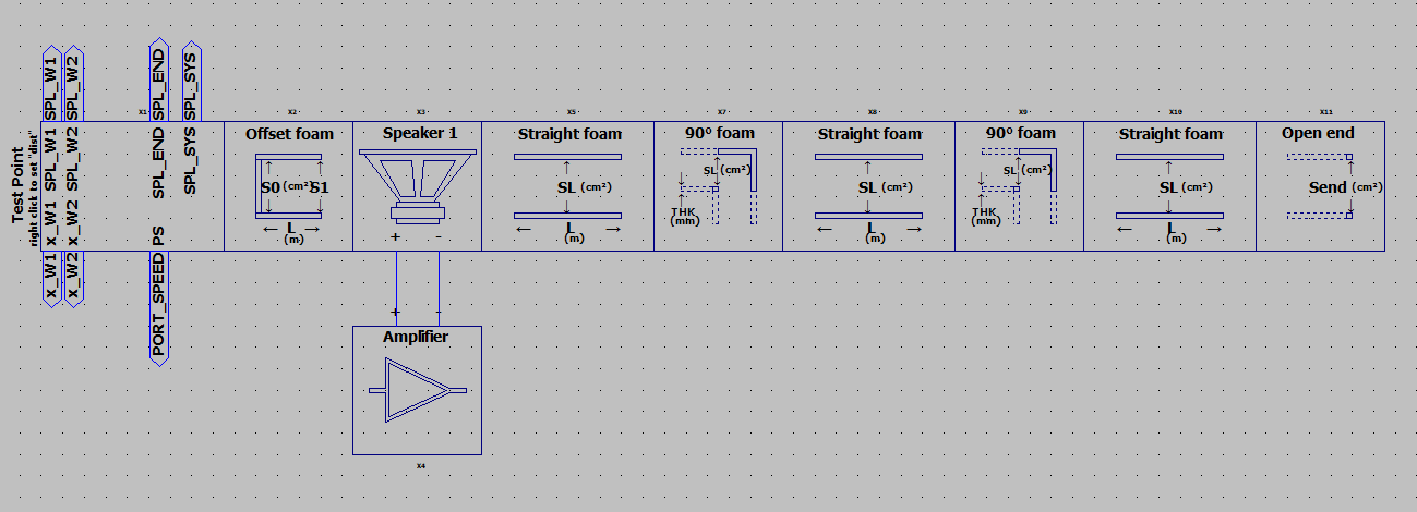

One question; would it be difficult to modify the modelling to include the option of a mass loaded TL? In other words, to add the option of terminating the line with a vent, rather than a simple open end.
Hi Cogitech,
the port block is now ready and I'm going to add it to SpicyTL very soon. This will be very useful to simulate bass reflex speakers (taking into account reflections on the longer side) or TL's with offset port.
Reflecting on your request I realized that you can simulate an MLTL by simply adding a TL section of the desired value (area and length) to the end of the TL. You can for example use the straight_foam block. Don't forget to terminate the port with the open_end block.

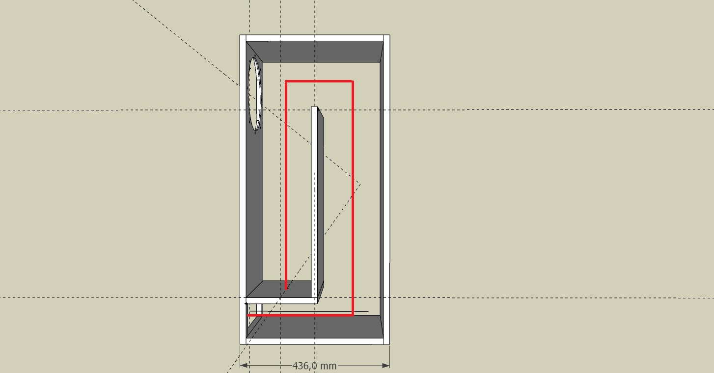

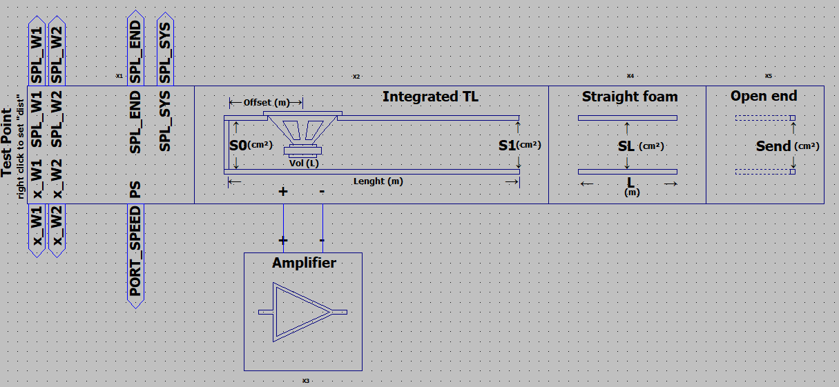

Hi deepboy,
since it is not possible to insert the driver in the development of a fold, yours is a good approximation.
However, I think it would be better to take into account the exact length of the offset and neglect the first 90° bend (whose volume is anyway altered by the presence of the driver).
I would do this:

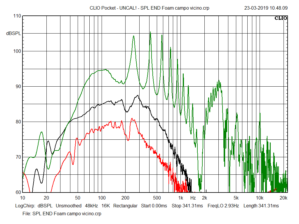

Can you provide the evidence? A plot of attenuation vs frequency for the two approaches.
Some years ago, I built some TL speakers from IPL Acoustics, which used foam lining. The coupling chamber was fully lined, and the transmission line had foam on two sides. I did some measurements using a spectrum analyser, and they were terrible. There were huge amounts of response ripple, which were subjectively very obvious as booms and suckouts.
Only by filling the coupling chamber with long fibre wool (in addition to the foam) did the results become tolerable, but still quite bad really. This is why I am sceptical. My experience of the foam TLs is exactly as I would expect intuitively. Namely, that a lot of the rear radiation just flows down the middle of the line largely unattenuated.
In this graph you see the unsmoothed near-field frequency response of the opening of my first test line (section: 50 cm2; length: 1m). The driver used is a Dayton Audio RS100-4. Empty line response in green, foam in black (50% filling, 14 kg/m3 total density) and fibre in red (fully filled, 16 kg/m3).
My approach to the transmission line is to maximise its potential by exploiting the low frequency contribution provided by the opening. By optimising the TL geometry, the ripple can be kept within reasonable limits.
Another approach is to overdamp the TL by filling it completely with absorbent material (in this case probably fibre is the best choice), obtaining a behaviour very similar to that of a closed box, but with better control of internal resonances. This is a viable option, but it would be a shame not to take advantage of the rear radiation of the cone, and the other properties of a well-dimensioned TL, especially if you intend to build small to medium-sized loudspeakers.

OK thanks for that.
Your plot seems to show the attenuation from the fibre is ~7dB more than the foam up to 100Hz, increasing to 10dB by 500Hz. Doesn't that make the fibre more effective as an absorber?
My particular interest is for my current TL project using a Satori driver. I tend to target the port output to be only weakly resonant (for best transient response), which means it only augments the driver by a few dB max.

Sure looks like the red curve provides gretare attenuation and is only a level shift from the black line… something you can likely move quite close together by adjusting the densities of the foam (more) & the fibre (less).
Stuffing a line until it is aperiodic is a very useful technique at flattening the impedance curves. Particularily useful with midTLs, bass drivers with highish Q, or just the smoothest, slowest bass roll-off you can get.
The line is only 50% filled with foam while it is completely filled with fibre. Even under these conditions the low-pass slope is steeper with foam. What is striking is the lower amount of ripple in the foam filled TL with a low frequency contribution of 7 dB more at 100 Hz.
dave
If you reduce the fibre content to reach the foam output level you will end up with an unacceptable amount of mid-frequency ripple.
