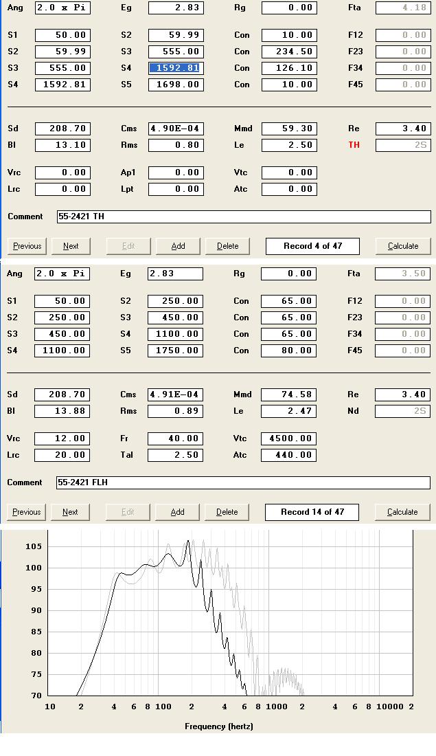

The problem is there are no "apples to apples" comparisons, because a driver that works well in tapped horn, doesn't necessarily work well in a front loaded horn, that may not work well in.....
However, as a general rule, a front loaded horn may be as much as 12db down from low to high frequency of it's pass band. As a front loaded horn goes from a 1/4 wave to 1/2 wave, it's efficiency really gains. You have to work REALLY hard in designing a FLH to flatten out the response. As an overly simplistic analogy, a tapped horn "can, but doesn't necessarily have to" split that passband, hack off the gains in the upper half, and add it to the lower half. Meaning that a TH (same driver same overall cabinet volume) can have a flat response, while a front loaded can have a rising response. This is oversimplifying, and only for single cabinets... As you stack horns of each type, things change. Both "can" achieve many db over a ported or sealed cabinet, in the order of 6-9db or so. However even that is subject to how good the design is.
so, the reason you haven't got an answer to this question... is that generalities just don't cut it on FLH vs TH vs whatever else... you have to take design A and compare it directly to design B, and decide which one best suits the needs that you have.
Here is a comparison on a dual mcm cabinet. Now the mcm driver is a better FLH driver than a TH driver (my opinion) however in the exact same size (209 liters) I can approximate similar response. If I'd played with the sims a little more, I could have gotten them to almost exactly overlap.
so... My personal opinion is that an answer to this question really isn't possible.

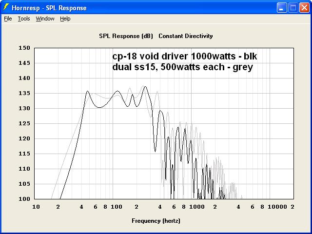

just for giggles, I ran a quick sim of the void18 in the cp18 cabinet vs a pair of the ss15's, equal power. A pair of ss15's is 20% larger in pack space volume.
