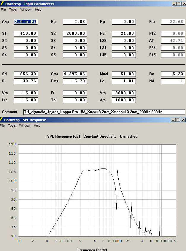

Hi guys,
How about a small midrange horn with the Kapp Pro-15A?

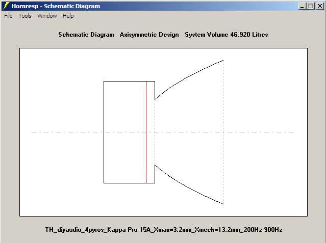

Hi 4pyros,
Post #126/127: It's a front loaded horn (FLH) with a small back chamber, and about a 2:1 compression ratio. Just an idea I'm throwing out, maybe the experts have something to say about that in combination with the SS15 and the high frequency horn you have been talking about. It is not very big @ 47 L_net.
I cannot believe, that you have not taken the two or three hours it would take to get a basic grip on Hornresp, come on: "You can do it!" 🙂
