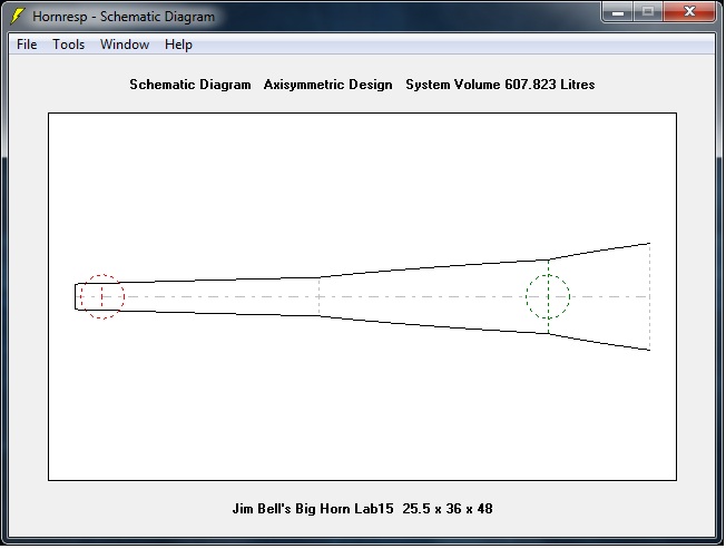

For myself I have been working on a HT enclosure, but the horn path is too long for this. This PA model has 425cm total horn length, and a L45 of 75cm, so with the fold of the stadium or the fury box you would have to add some folds. Wood1y has a nice fold w/ measurements that could be adapted (also needs more folds/depth):
http://www.diyaudio.com/forums/subwoofers/170749-15-tapped-horn-rcf.html
The layout of jbell's Stadium horn is so efficient, that I doubt, that this box can be squeezed into the same external size, even if the net internal volume is about the same. Anyhow, from my HT work I arrived at the fold I'm attaching. It's modified for the horn's path length, but not the sectional areas, nor the mouth size. (In other words it needs much more work, you've been there.) For PA use people are probably not interested in tuning out peaks, so there could be one more loop (or wiggle?) through the now empty area.
I have always liked your LAB12 fold (that may be the way to go), and TD's DTS-20 with or without the bifurcation.
Well, not much, but a start.

I have no issues with a TH-mini clone, THAM-115, or any of the other designs with the speaker toward the 'bottom' of the cabinet. In fact I took martinson's design, and stretched it into this: http://www.diyaudio.com/forums/subwoofers/127908-jbells-set-four-tapped-horns-23.html#post2148260
What I have found through MANY different designs, is that multiple parallel surfaces, and multiple path lengths that are the same distance (like my 2' cube) seem to accentuate the peaks/valleys of a tapped horn. Oblique angles and multiple different lengths of pathway seem to smooth the peaks/valleys. One of the things sometimes overlooked in TH folding is the angled baffles, etc... and how they affect the overall tuning/sound of the cabinet. My 2x2x4 cabinet in the above link was almost a complete disaster due to all of the 24" and 48" long paths, and all of the parallel surfaces. A shallow reflector, and a 45 degree reflector saved it.
This is the reason I like my single sheet design so much. Try and find 2 paths that are the same distance, and try to find parallel walls... And it accomplishes it without a bunch of added reflectors. Now there is (my opinion) a place for a parallel reflecting surface, and depending on dimensions, it belongs in different places. A theory (not mine) is that it is beneficial to break up the wave that is heading back down the horn path somewhat. In my single sheet design it's in the upper back corner. In scotts furysub it's in the upper front. In my big cabinet (stadium horn) well, there are no reflectors, but I would assume the upper back serves this purpose. The stadium horn has a slight dip in the 80hz area that a carefully tuned reflector could remove I'm sure.
The reason I post all of this? Hornresp gets you close, but then you have to tune from there. Driver middle of cabinet, or bottom, or somewhere else... You have to be willing to tune.

Jim; The more I read and learn the more I know I dont know. I would like to sim something thats in my head, need to get it out. What is the learning curve on the simulation software? Andy
The more I learn, the more I don't know either.... I kinda wish the mods could sticky your last post, it's very true.
The big box (stadiumhorn) was the real start of my learning curve, after being lead down the garden path so to speak on a published FLH design that didn't live up. You can see -- I'm still learning.
The only thing I can do to help you out, is to hopefully get you to a place where you are comfortable in punching in the numbers you see in some of these threads into hornresp, and then having the faith that the numbers you see -- will actually happen. Once you get there, line up a few different tried and true designs that you can find on this forum, or others -- plug them into hornresp and see how they compare apples to apples. Once you find the apple that suits you best -- go with it. I really don't think you want to risk this to an untried design, that may or may not work.

Hi 4pyros,
It's a lot of fun learning about these modelling programs. Without Hornresp and AkAbak I would not even try to work on something like a tapped horn. Here are some links:
Lilmike's tutorial on the AVS forum may be helpful:
Simple Tapped Horn Tutorial using Hornresp - AVS Forum
Once you get comfortable with Hornresp you can use the Export feature to get an AkAbak script, and you are on your way.....
