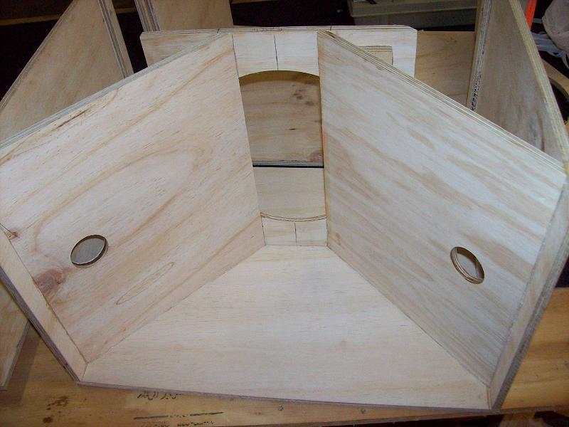

I don't really have a thread on any of my tops. They are just dime-a-dozen kind of design... They key on these is to find the right driver to make a horn/ported cabinet work. Once you find the driver, you have to play with hornresp for awhile to get a nice flat response in 4pi. (tops don't sit on the ground, so response curves tested that way are bogus in my mind)
Here's the best pic to show how my tops are built. The horn 'plates' are 13" long, and 45 degree angles on each end. It was designed to use partsexpress 15x22 metal speaker grills. I just bolt a 12" dayton waveguide to the metal grill and use a 16ohm selenium crossed at 2k. It uses an eminence beta 12a-2, and ports are tuned to 95hz. (sorry, not a fan of the cheap eminence compression driver....)
If you don't choose to use your kappa 15's in a typical 15" pa cabinet, and want more details, I'll dig up my cut sheet and some hornresp data on the tops. If you want to build an all eminence top with the kappa -- http://www.parts-express.com/pdf/290-422c.pdf Use the small vented box. Eminence HF option looks to be the 1" 2005 driver with the 395 horn and cross at 1.5k.

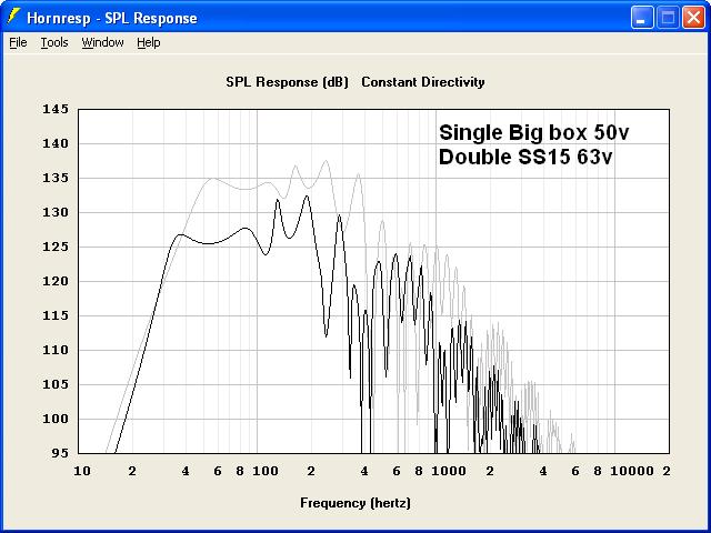

Since the big box is twice as efficient, wouldn't the truck space be about the same?

Big box is more efficient down low, 102db@40hz, vs 98.5@40hz for the ss15. HOWEVER, the ss15 is louder from 50hz on up vs the big box watt for watt. The big box is 2.5 times the volume vs the ss15, and three times the weight. In pairs, the ss15 gets flat to 40. Big box is limited to 50volts input, ss15 to 63volts.
SO... a pair of ss15 will absolutely SMOKE a single big box. The thing the big box does that the ss15 can't even consider, is it digs below 40hz....
I still love the big box for some permanent installs, but the more of the ss15 I build, the happier I am with it as an overall good design.
