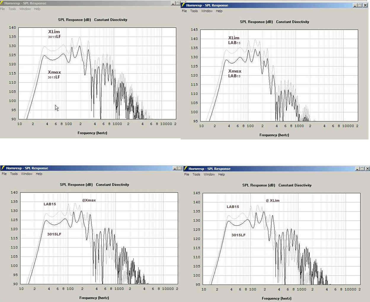

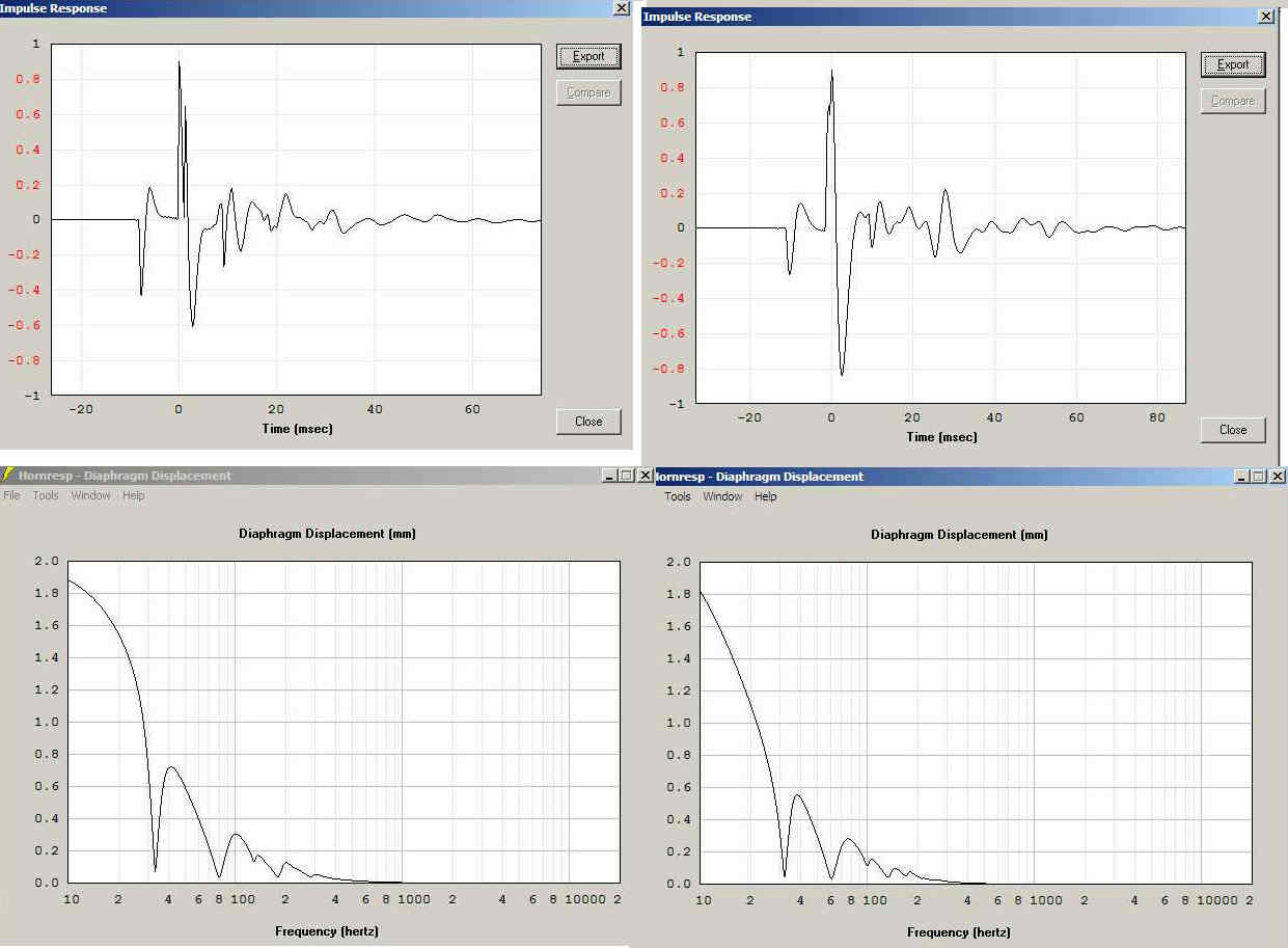

Comparison between 3015LF and LAB15
Hi again,
Here is a comparison between the jbell Stadium Horn and a model of a LAB15 tapped horn. I used the Par flare for both models, as it supposedly more closely reflects what we build. Both models end up with about 607-608 Liter internal volume. I used Ang=2.0 x Pi and Eg=2.83. As modern high powered amplifiers are generally pretty stiff in their voltage output, I think the small difference in Re between the drivers doesn't matter.

From Hornresp:
jbell's Stadium horn w/ 3015LF reaches:
- Xmax w/ 180W/8Ohm @ 41Hz Eg=37.95V
- Xlim w/ 560W/8Ohm @ 41Hz Eg=66.93V
tb46 model horn w/ LAB15 reaches:
- Xmax w/ 450W/8Ohm @ 38Hz Eg=60.00V
- Xlim w/ 1570W/8Ohm @ 38Hz Eg=112.07V
In other words the 3015LF would struggle @ its rated power limits while the LAB15 still has excursion to spare. Obviously there would be a premium price attached to the LAB15 and amplifier combination, but when you are looking for low frequency extension and high output it looks like a promising driver.
Let me know what I got wrong 🙂.
P.S.: Had to break the picture up into three parts, just stick 'em on top of each other.
