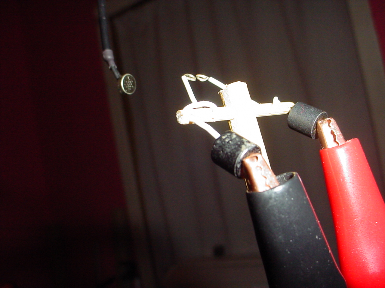

Perhaps the electrodes are burning and I need a higher melting point metal or one less prone to oxidize?
The discharge is a thermal event so maybe arranging a way to cool the gap would help. A fan? The air compression will be affected by the heat I think.
I'm using a sheet of copper clad and discharging directly into the clad. I'll be playing some more with it but not for a couple of weeks. I have some travel coming up.

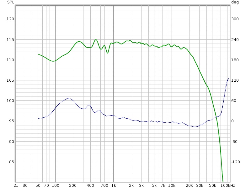

Good tuning of the spark gap along with large sets of averaged sparks can extend the BW below 500Hz. I didn't use a ground plane for this measurement. At 1000 averages the reflections from the tripod are clearly visible on the impulse response.
The closest reflection is 2 feet away, and comes back at 3.4ms. Some of the variation is surely room modes and some of it is also possibly comb filtering from the residual decay of my sparker repeating at 129ms.
If only someone could show me what I'm doing wrong so I can do the same thing but with a resulting calibration curve that resembles the datasheet.

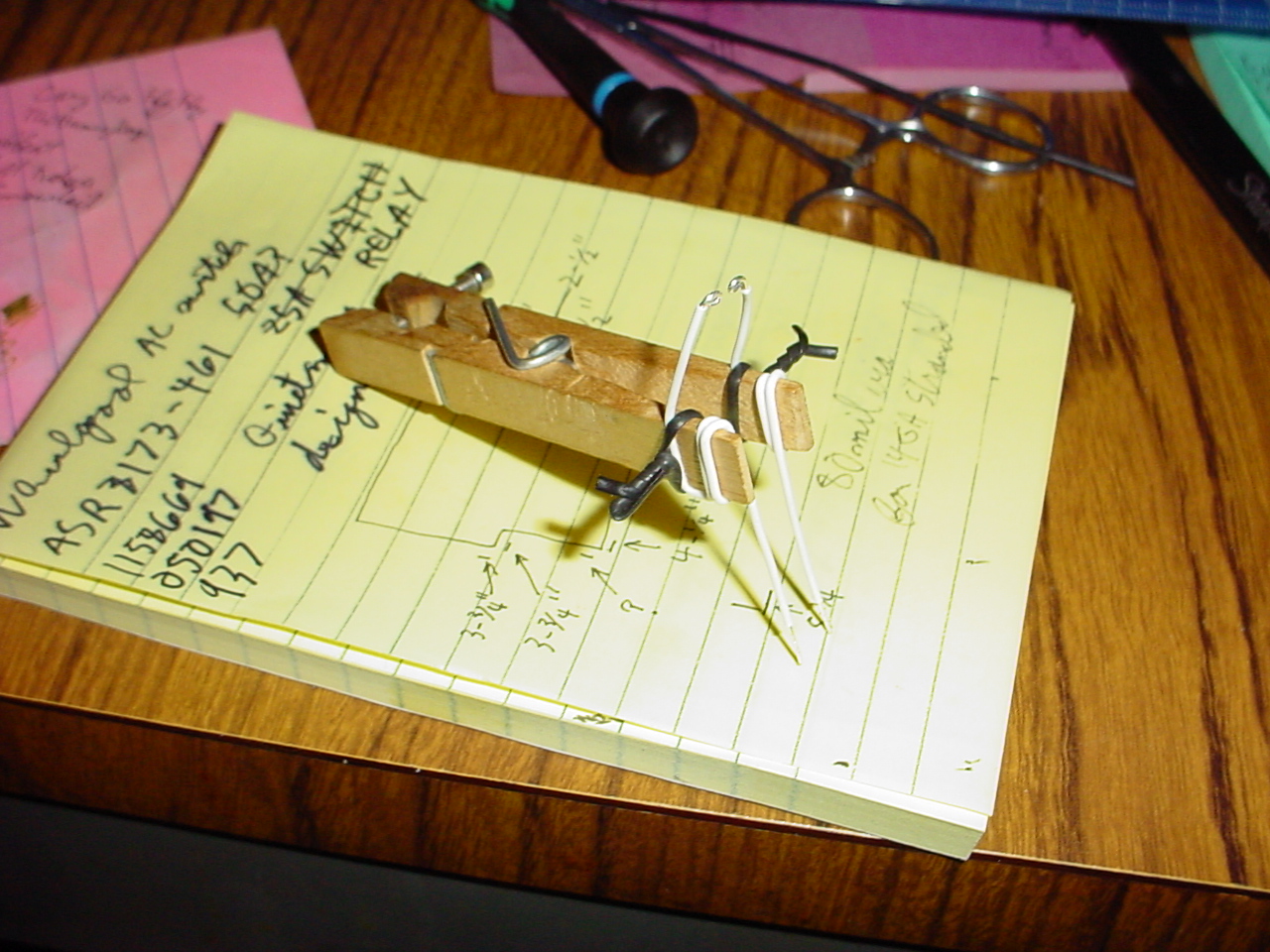

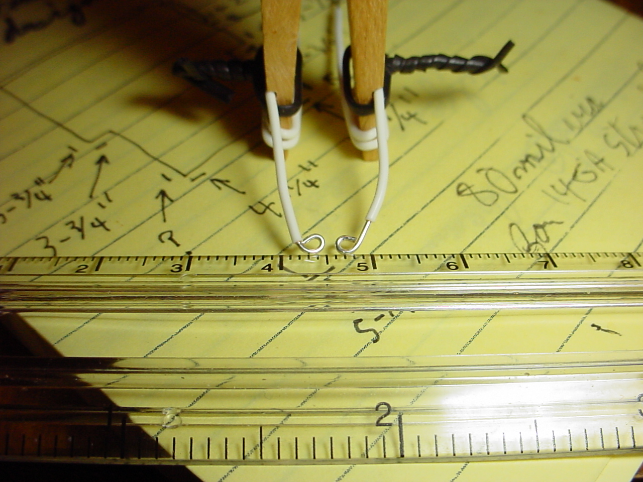

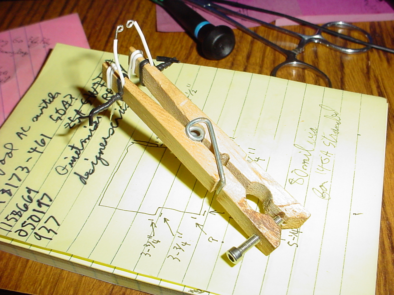

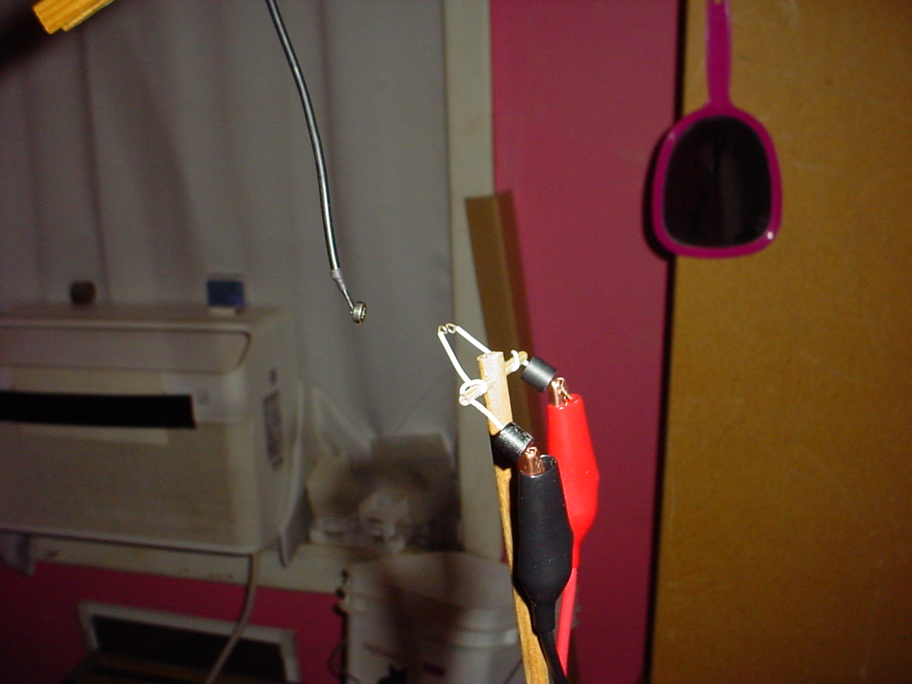

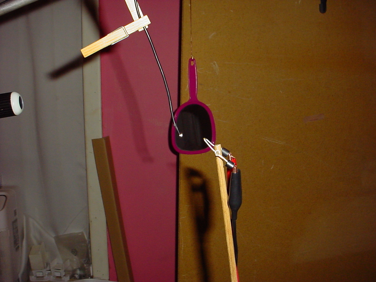

I was trying to think of a mechanism to allow me to precisely control the gap size. I was thinking about pantograph mechanisms I could slap together with sticks. In the end a clothespin was most handy. I use a lot of clothespins and alligator clips.
The spark and screw are equal distances from the fulcrum so with the 0.5mm thread pitch of an M3 screw, I get 0.5mm per turn of movement. I can zero the distance using the continuity tester on the DMM. It might take some swipes between the electrodes with a piece of paper to remove the carbon though.
I am not the least bit confident in it's accuracy but it will allow me to set and maintain a specific spark gap, which has been an enormous issue.

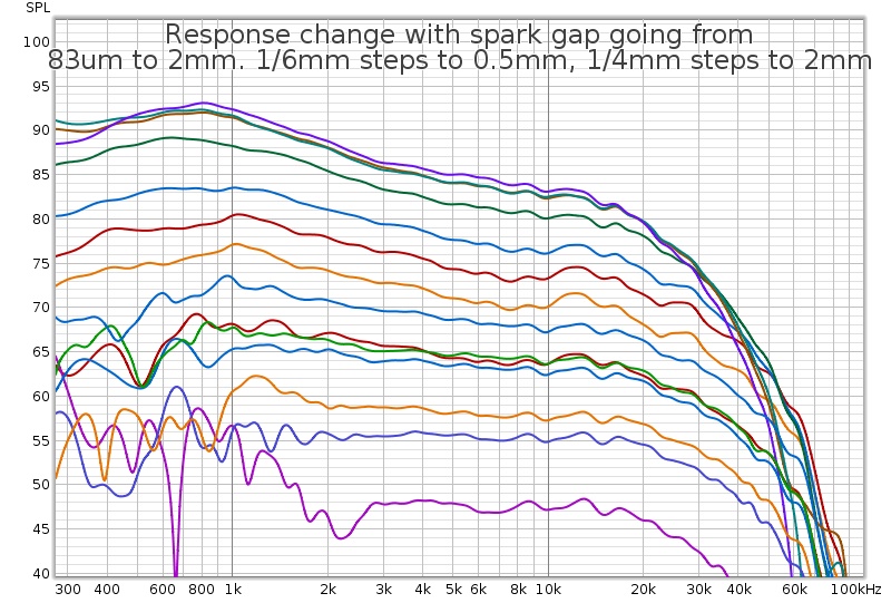

I did a set of reponses going up to 0.5mm in 83um increments, and from 0.25mm to 2mm in 0.25mm increments. You can see how the spectrum changes as the gap increases, notably the midrange rise anomaly that appears above 0.25mm gap.

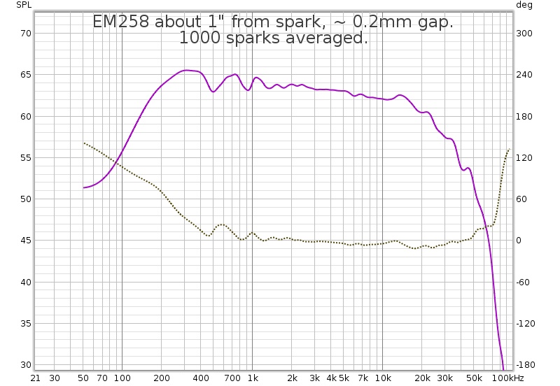

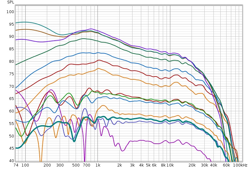

I decided to do a longer test at 167um gap based on the last chart. The new bold trace is 1000 averages at 167um gap. I might try for 83um (1/6th turn of the screw) if the noise floor is willing.
The carbon proves unlikely to remove, but I am satisfied with suspending a piece of aluminum foil between the electrodes and opening the gap until it falls out in order to zero the gap. This aluminum foil is 0.001" thick or 25um, as is standard. Receipt paper is actually even thinner. I was delighted though at seeing the spark jumping a 25um gap.

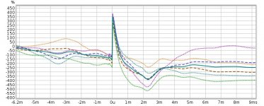

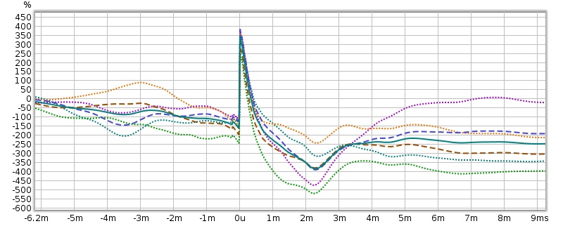

When 4 250 spark sets are averaged to 2 500 spark sets and then one 1000 spark set, the step response converges on an N-wave of period 3ms, which corresponds to a 333Hz BW.
I don't have any 333Hz filters in my signal chain and the EM258 datasheet shows flat response to 60Hz.
Dotted lines are 250 sparks each, dashed lines are 500 sparks each and the solid line is all 1000 sparks.
I think this is a big clue as to where to set the FFT windows, on either side of the step response N-wave is probably a good bet.
As to where this 333Hz time constant comes from I can only guess it has something to do with stored charge at the Jfet gate.
There is some slight RF demodulation apparent before the arrival of the acoustic wave. This could actually be used to determine absolute phase in the same way as recording the spark current would as 1audio proposed.

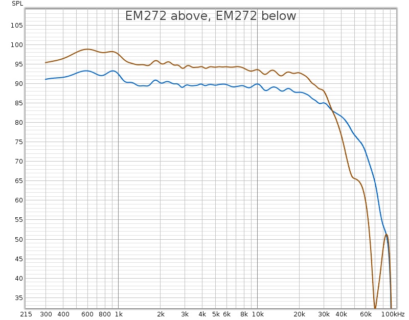

Things are looking better after all the changes though. I followed Scott's advice and set the mic 26" away from a 4mm spark gap. I tested the EM258 and the EM252 (new version of the EM271 with higher max SPL).
Most of the ripples are in the same place for both mics so since they are very different capsule sizes (10mm vs 6mm), I think the differences must be related to reflections from the tripod and spark gap assembly.
I guess the question is when do I stop trusting the datasheet and start trusting my own measurements?

I ran my old data and it was easy in Python. Matlab or Octave would also work. A one sample delay is pi radians at fs/2 and a straight line to DC (bin 0). The SNR will matter but 60dB looked like no problem. I don't have multiple pulses saved from years ago so I can't try shifting and averaging them. I used only a 480 point FFT since it gives exact bin answers for 96K sampling, I think interpolating or sample rate converting the data just adds mess for no benefit.
Yes, I noticed after looking through them that even a single spark does not differ much from the averaged example, except in the low frequencies. That made me feel kind of dumb. But even if averaging only succeeds in unburying the room modes, maybe it can be useful for room calibration of some sort.

It is a given that the clothespin is causing some sort of response aberration, and that is something I can check.
