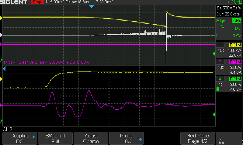

I think I have figured out where the current is coming from. its a very short peak. The coil is around 7K Ohms of resistance which would limit the current but there is a fair amount of energy stored in the stray capacitance in the HV circuit and very little inductance when it discharges which would explain the high peak current I think. More to explore tomorrow.
I'll try recording a number of discharges in various ways and see what I learn.

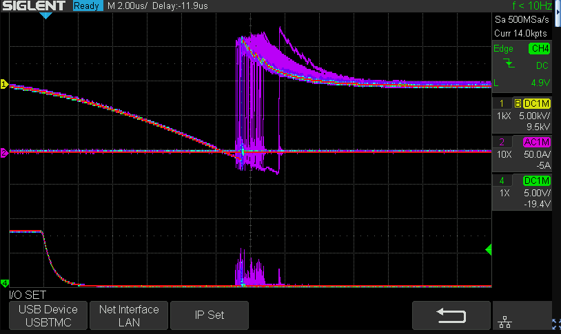

You can see from the screencap that the HV starts at the same place and climbs at the same rate (15 KV in around 15 uS) with the overlapping curve. But the breakdown has about 2 uS jitter. For audio measurements 2 uS jitter will not be an issue. I have read that using a laser to trigger the spark would get the lowest jitter and that makes sense.
The spark appears to have 48A peak to peak. If I can find a small cap good for 30 KV (10 pF or so) I can test the current vs cap hypothesis.
The scope still periodically locks up from the EMI but at least it recovers.

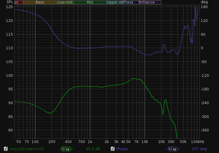

One lingering question- what software to extract a frequency response from the spark? Can we get real phase info from it? (reference channel vs. measured channel) Fundamentally it should be possible to get a real response curve from basics, independent of a seperate calibration I hope.
For all the final work I use REW beta. There is simply nothing else with the same windowing features and useability. The windowing is crucial to get a good result.
I used Audacity or Wavosaur to do the lowpass filtering. Since my EM172 has considerable infrasonic response, a highpass is needed to get good FFTs. I recorded tens or hundreds of doublets and used Audacity to remove the DC component from them all. The order in which you apply filtering and remove DC is very important to not cause drift.
For recording I used Sox on linux. I was able to get it to trigger on each spark, apply some basic culling, and fill a directory with time-aligned doublet recordings. I would open them all in Audacity, manually cull any duds, apply the filters and DC removal, mix them all together and then open in REW. I could batch open the files in REW, time align them all and then let REW combine them, but that did not seem to be necessary as they were sufficiently time aligned to begin with.
Getting rid of the infrasonic noise is problematic. If you remove the DC component (not with a highpass filter but with a sample average), then FFT windowing will actually cause a DC offset which can cause problems. So there is some progress to be made in preprocessing.

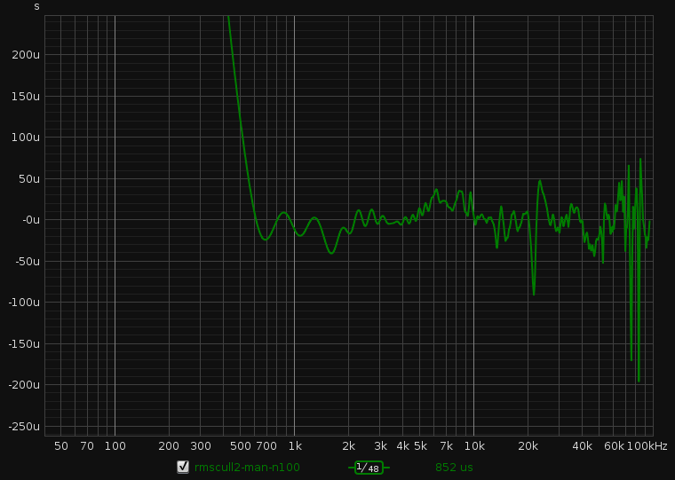

You mean absolute phase? Since the group delay of the doublet is flat, we just shift it to zero and that gives us absolute phase. I suppose that assumes that a portion of the mic response has a flat curve. That's what I have been doing, but maybe not what you want as a reference.
Since the doublet does not arrive any sooner than the speed of sound allows, doesn't it make sense to set the earliest group delay as T=0?
A reference mic will still have positioning error, maybe even enough that the group delay estimation would actually be more accurate, given a 192KHz recording?

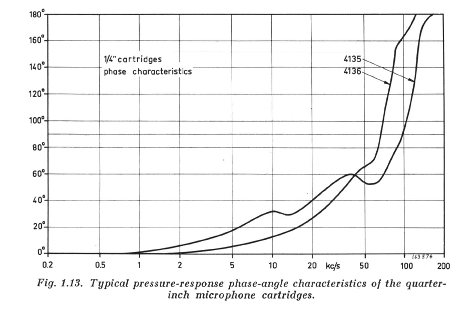

Its probably some underlying confusion on my part about the intrinsic phase response of the microphone and its acoustic-electrical delay. I read an article on measuring the acoustic center of precision microphones which only added to my confusion- apparently the center is a few MM in front of the diaphragm and moves with frequency. That leads to: the sound comes out electrically before the pressure wave arrives??. In any case it would be helpful to know the microphone phase response. The B&K curves below show the phase from an electrostatic actuator but I would like to know if it holds acoustically.
I just realized I need to update my correction files for the B&K's with the phase info, at least the generalized info in the plots.

A pressure wave cannot begin without the movement of the earliest molecules forward. If this movement is converted to pressure by an obstruction (IE the mic capsule), then the group delay can be lower at that frequency. That's my understanding.
