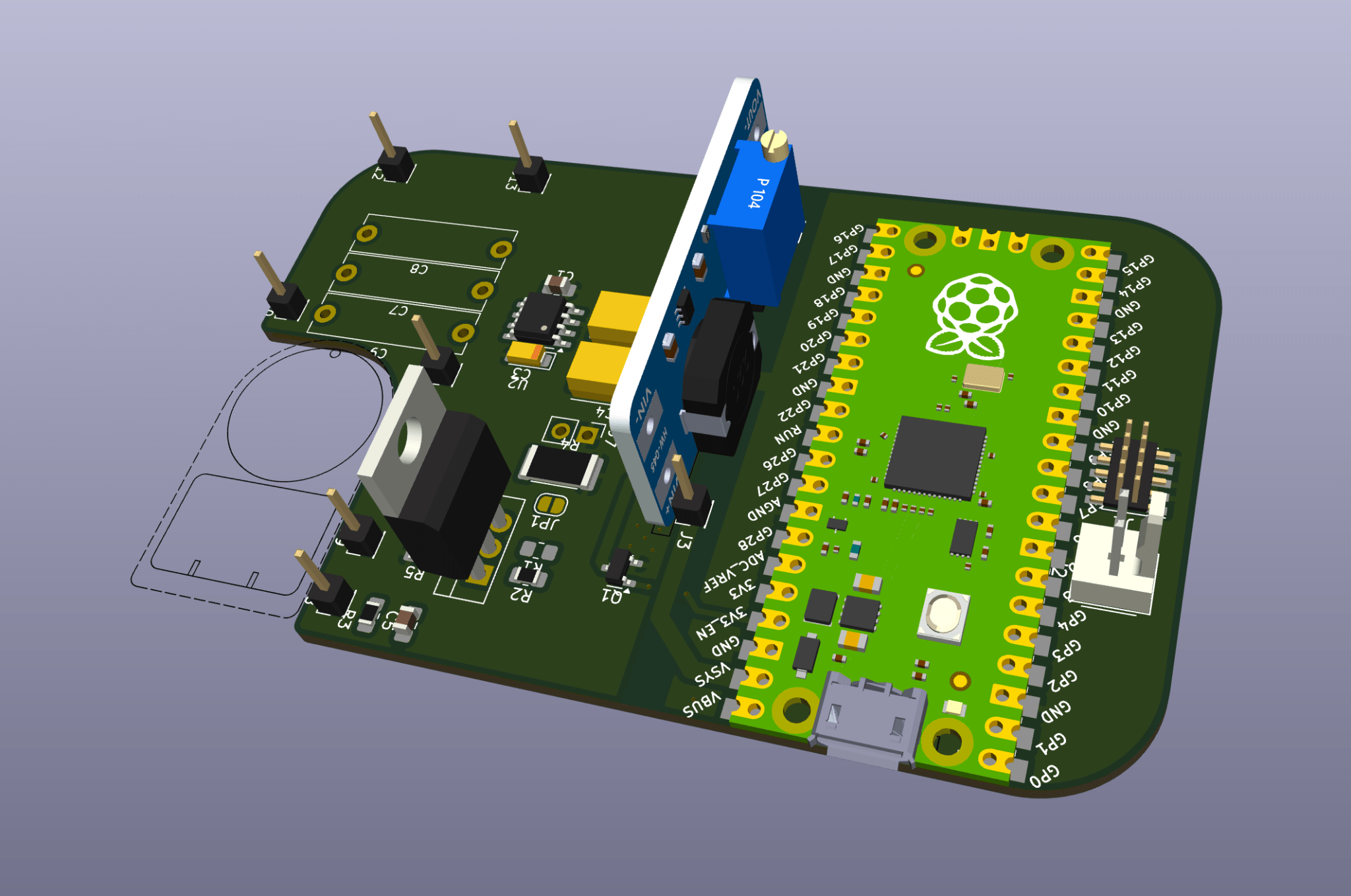

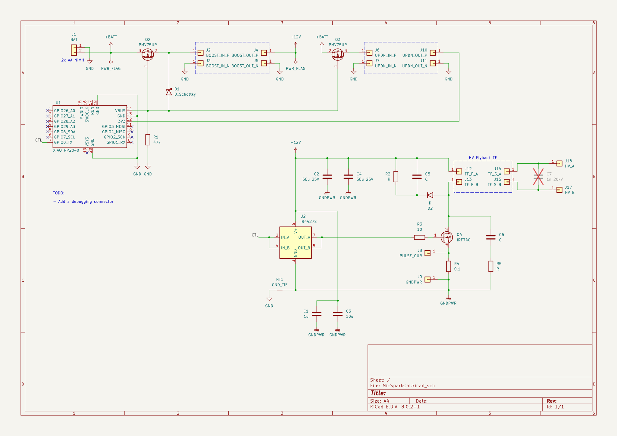

Asking, because I'm tentatively looking into this topic. Last weekend I slapped together a puny spark generator using a microcontroller, a MOSFET, and a tiny flyback transformer. That's quite a low energy setup, but one thing I don't expect to be an issue is the impulse consistency; unless I am underestimating the required precision.
I'm working on a second revision, which is going to be more proper (better MOSFET driving, higher supply voltages, clamp and snubber networks; likely packed into a tin can, except for the spark gap). The schematic is incomplete, but this is how it looks at the moment. I expect keeping such a small device (aiming for under about 90x55 mm board) tethered to a power adapter to be a nuisance, therefor included provisioning for running it off batteries.
I was going to use something like chamfered M3 bolts to form an adjustable spark gap, but not sure whether such contraption is good enough of would create to much reflections already.

It's a bit too early for me to talk about EMI in my setup, but I believe I'm prepared to contain it quite well. The circuitry is going to be battery powered and encased in a small tin can (similar to those Altoids cans). The exact construction of the spark gap is to be defined.

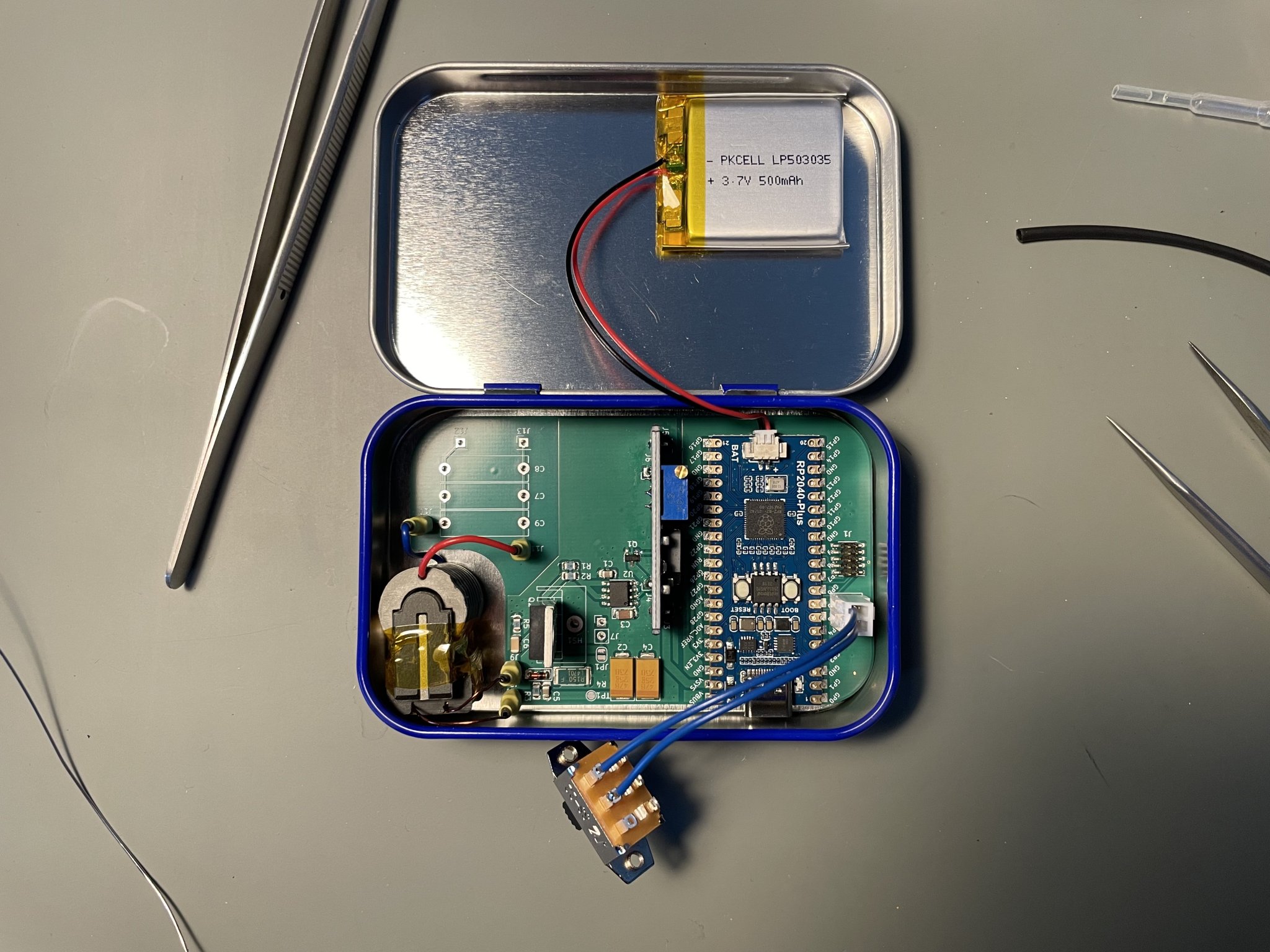

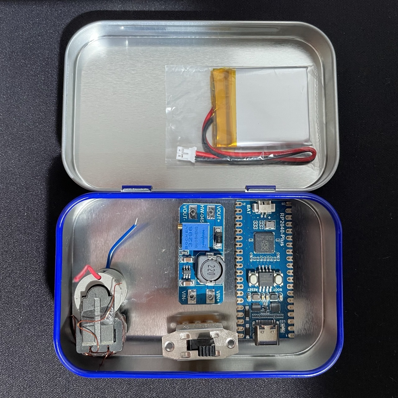

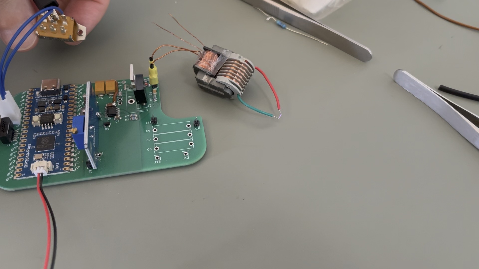

This weekend I've assembled and tinkered with what I thought will be my spark generator. After some experimentation, I figured that it's quite capable of lighting arcs with repetitive activation (100–10000 Hz), but single individual sparks are not it's strong side. I don't completely understand what goes wrong with single activations, but it doesn't produce a spark at all. Hm, maybe I should try two activations in a quick succession. Perhaps, that can give the inductor some extra swing 🤷 If that doesn't help, I might check a different transformer (e.g. a motorcycle ignition coil) or a different driving scheme (forward architecture, possibly full-bridge), but the latter would require a complete circuit redesign.

How many joules is it? My sparker has I think 330nF and is charging to I think 180V. That's 5.35mJ. Yours will depend on the energy stored in the (I assume unknown) primary inductance of your transformer and resonances/snubbers will subtract from this (did you try removing the snubber?). Your sparker may need ions to build up in the air before it becomes conductive enough to arc. Just like GDTs, the striking voltage is higher for a short pulse.
The total primary inductance is measured as 90 uH, the leakage 15 uH, so the magnetizing is something like 75 uH. I pump about 2.5 A of peak current in it in every pulse, so the energy (LI^2)/2 must be something like 234 uJ. An order of magnitude (and a bit) less than in your set-up.
I can't pump more in this inductor, because it pretty much saturates at 2.5 A. Will probably need to find (or make) a better one.

And... you discharge that capacitor to the primary of an ignition coil, I suppose? Because 180 V wouldn't be enough to make a suitable spark (if any at all), would it?
And, by the way, double pulsing helps. With double pulsing I see a small, but well noticeable discharge over a gap of up to 2–3 mm max. Yay.
Perhaps, some pre-ionization (without a discharge) on the first pulse could explain this behavior. Thanks for mentioning this 🙂
Yes, the capacitor is discharged into the primary. Car ignition coils use a flyback circuit like what you are using but I've never gotten them to produce good sparks consistently (never say never). Grill sparkers tend to use SIDACs after a transformer charging circuit. You could probably improvise this into a flyback converter for a capacitive discharge stage. You can also look up the "blokker" spark ignition circuit for model combustion engines.
