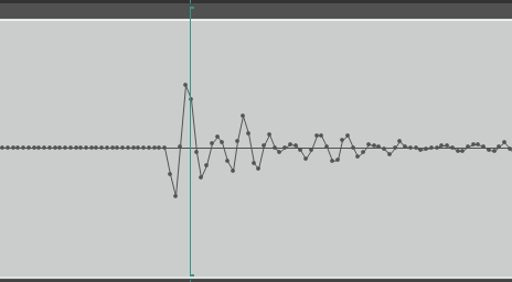

Here is a link to my latest unequalized file: WeTransfer Its too big to send via e-mail.
This is a clip from Reaper using its internal EQ set as a low pass filter starting at 100 Hz. It looks almost the same if I start at 2 KHz.
I'm not sure this is helping. Please advise.
Spectrum tells more, the literature I found was talking about the problems going to 0 Hz.. BTW I got my Scarlett 2i2 to work with Audacity/WASAPI.

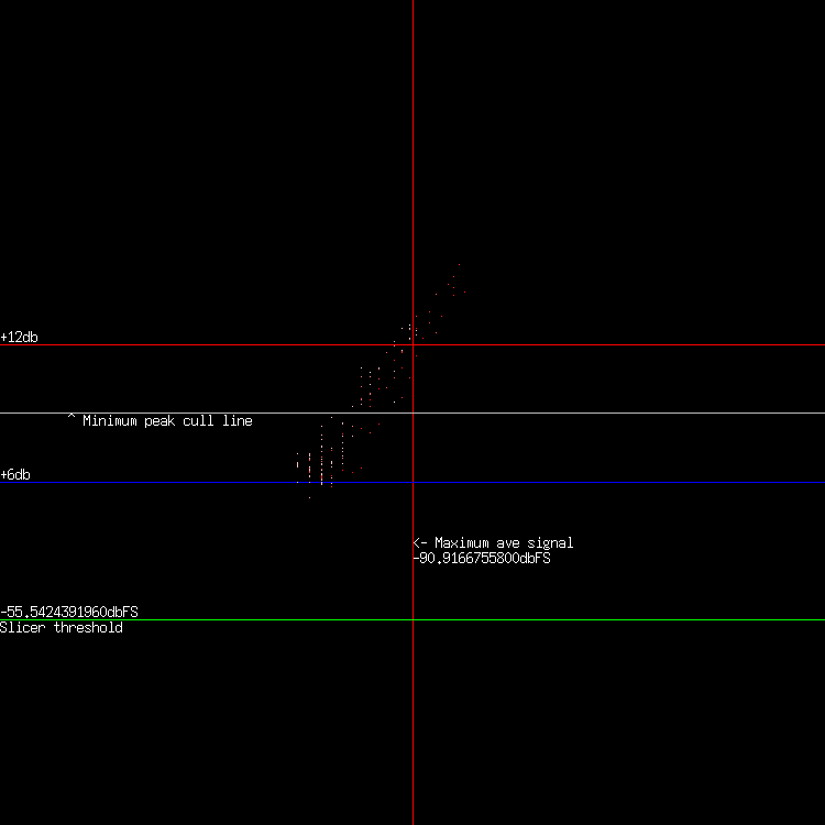

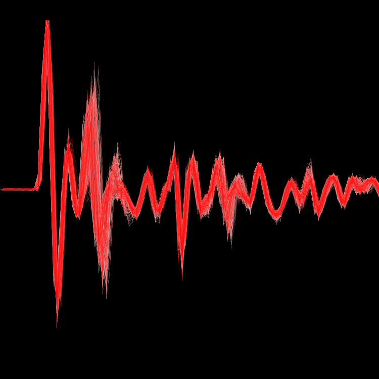

Whatever you did has made the sparks much less consistent. The peak variation is now about 6db. This could be because of a longer spark and/or electrode sharpness and/or slower risetime on the electrode voltage.
Damping the coil may be important for better consistency.
I think something has degraded. It sounds less consistent. I have some other projects I need to attend to and then I'll attempt a cleanup on both the spark gap and the coil. Damping this guy will be interesting. I'm not sure an parallel RC would do the job. I could put a series resistor between the coil and the cap. That may de-Q it enough without inhibiting the spark.

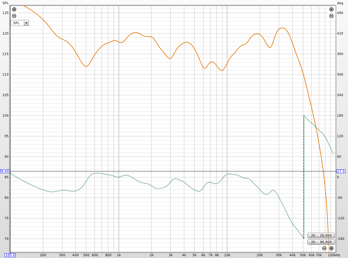

I know the mike is good to 120 KHz and have used it with the Pioneer ribbon to 70 KHz. I wonder if the limit is due to the duration of the arc? Or maybe the physical size of the arc?
I'll check the analog link etc. to make sure there is nothing futzing in the background. It seems good to at least 90 KHz per the meter in Reaper. I have no way to go into the mike preamp directly, unlike the 1/2" and 1" mikes. However it has worked in the past.

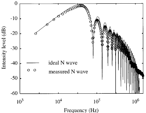

Keantoken's file show the HF null inherent in the N-wave spectra which is a Bessel function.
On the Frequency Spectrum of N Waves
The Journal of the Acoustical Society of America 41, 528 (1967)
I would think so, but I have never seen an obvious agreement between my measurements and the papers. Any nulls always seem to be near or above 96KHz. Most of the time the nulls seem to be related to spark trains and disappear when those are eliminated. I have always wondered if those results are only valid for direct discharge from a capacitor, and not for sparks produced from HV coils.
