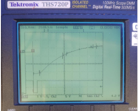

Distance helps, however the active circuitry in the power supply gets a big DC shift with the spark and starts to return but is still offset when the acoustic pulse hits. I will switch to a different power supply and see if that helps. My hopes for this are dimming fast.
This shows the EMI problem. Upper trace- microphone. Lower trace trigger from spark generator
Holds true with two power supplies/buffers. When the spark happens there is a big DC shift that takes a long time to recover. The acoustic pulses are near the center.

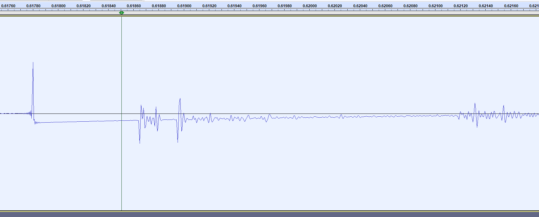

After some more fiddling here is what I get recording. The emi pulse is the first transient. The DC offset starts there. The two acoustic pulses are due to a reflection, the first is the more valid one. I found that despite the full isolation of the channels in the Tek connecting the sync makes for a big dc issue on the other channel. Disconnecting it seems to remove the DC, at least on the scope. Still seems there on the recording setup. Enough for today.
I think this spark generator just makes too much EMI. I have ferrites etc. all over. The coax was to make the radiating window smaller. I have isolated from the AC line. The scope and the mike are both battery powered. I even get stuff on the scope with the input shorted.

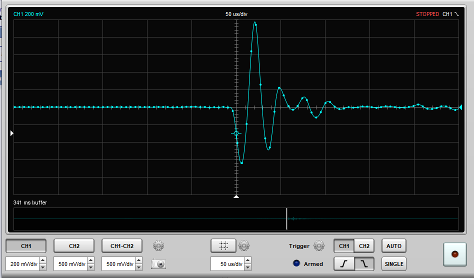

Here is the acoustic waveform I'm getting. Tomorrow I'll try to setup to do a reasonable first pass acoustic setup with the current spark. I still have stuff like mike stands. clear space etc. to deal with and the first shot will be really compromised but its a start.

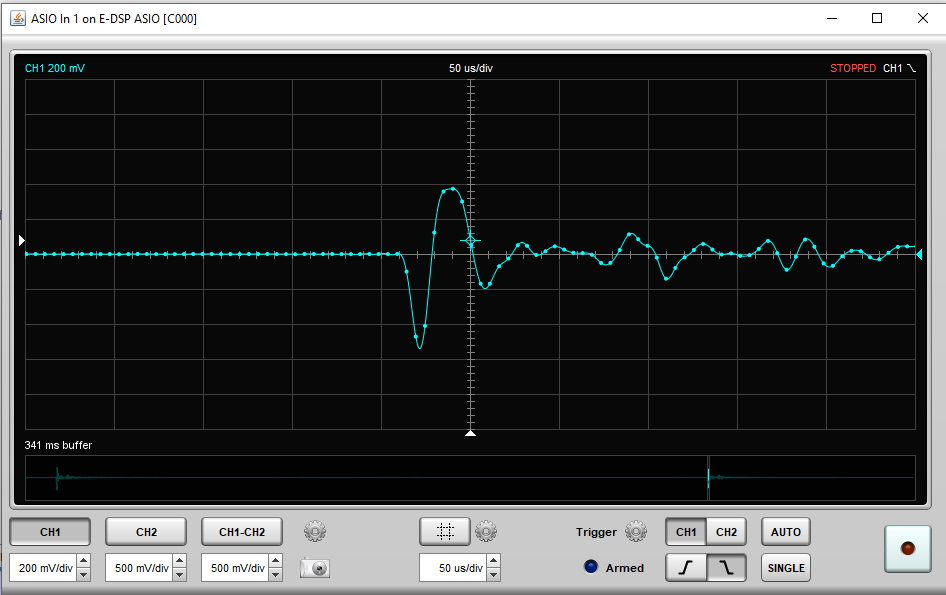

How are you viewing the doublet in ASIO with the correction? This was just to use as a calibration file in REW. If you are using it for a DSP program, you will get that program's integration errors. That is the whole point of performing the correction on the response curve instead of the doublet.
That does look like your doublet would look like lowpassed. There is peaking in the response which is why it still looks like a doublet after integration.
I checked and REW treats the cal file correctly EXCEPT for in the scope function. Not too surprising since translating a frequency response correction to a time correction is not simple. Tek charges thousands for that feature in their premium scopes.
