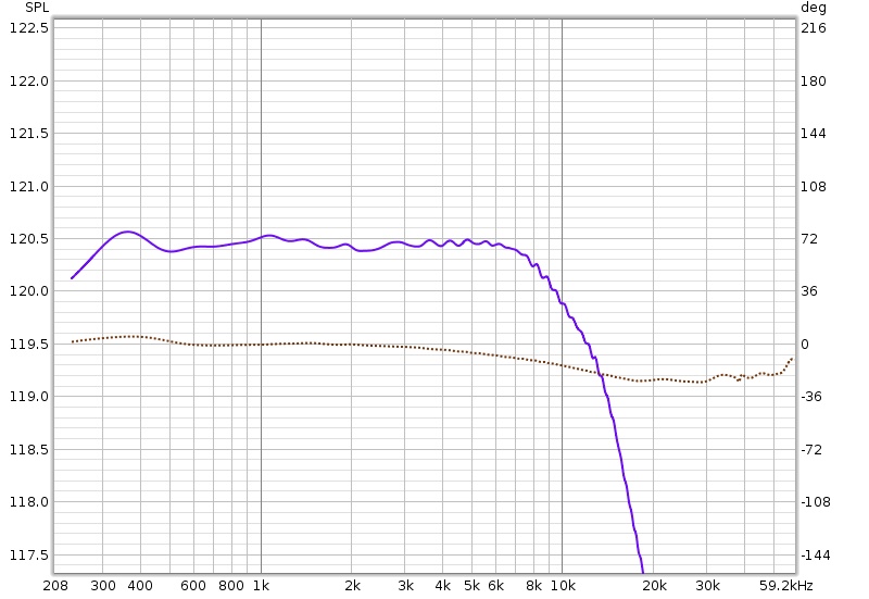

What surprises me is that the phase stays flat while the response dips at 10KHz. Correct me if I'm wrong but this is not minimum-phase behavior.

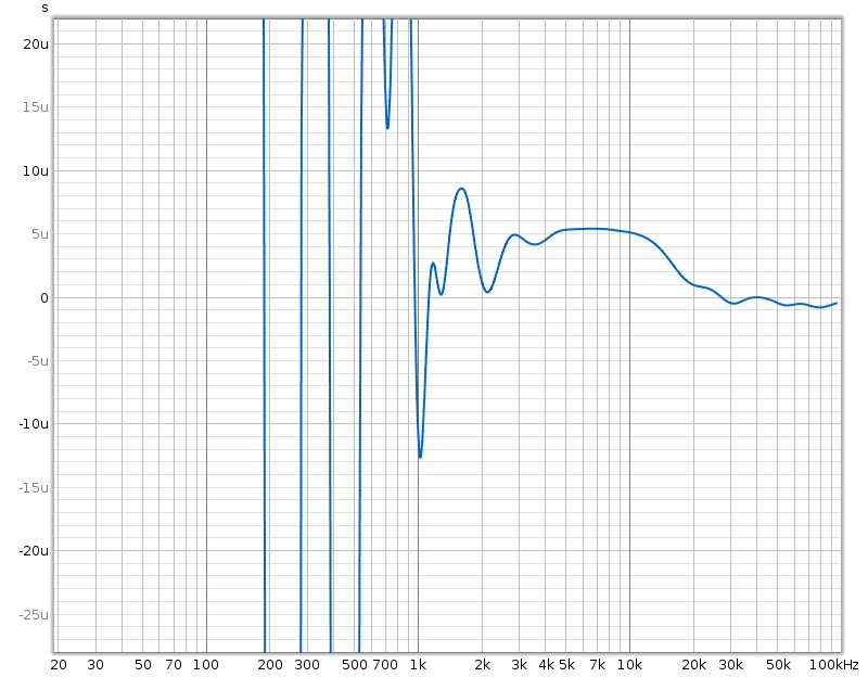

Or maybe it is more accurate to time align the impulse to the HF as in the attachment? Then the phase is mostly zero until just before 10KHz. I wonder which alignment is more useful. Perhaps this is more realistic since no frequencies will be arriving before the impulse.
REW lets me set T=0 to a position on the impulse. I use the group delay plot to set that point at either of the two positions the group delay is flat. When I do that the phase changes. I wonder if some of this just has to do with convention. Some people may set T=0 at the root of the impulse, in the middle, or at the peak. I think the group delay makes the most sense as an indication of where T=0 should be.

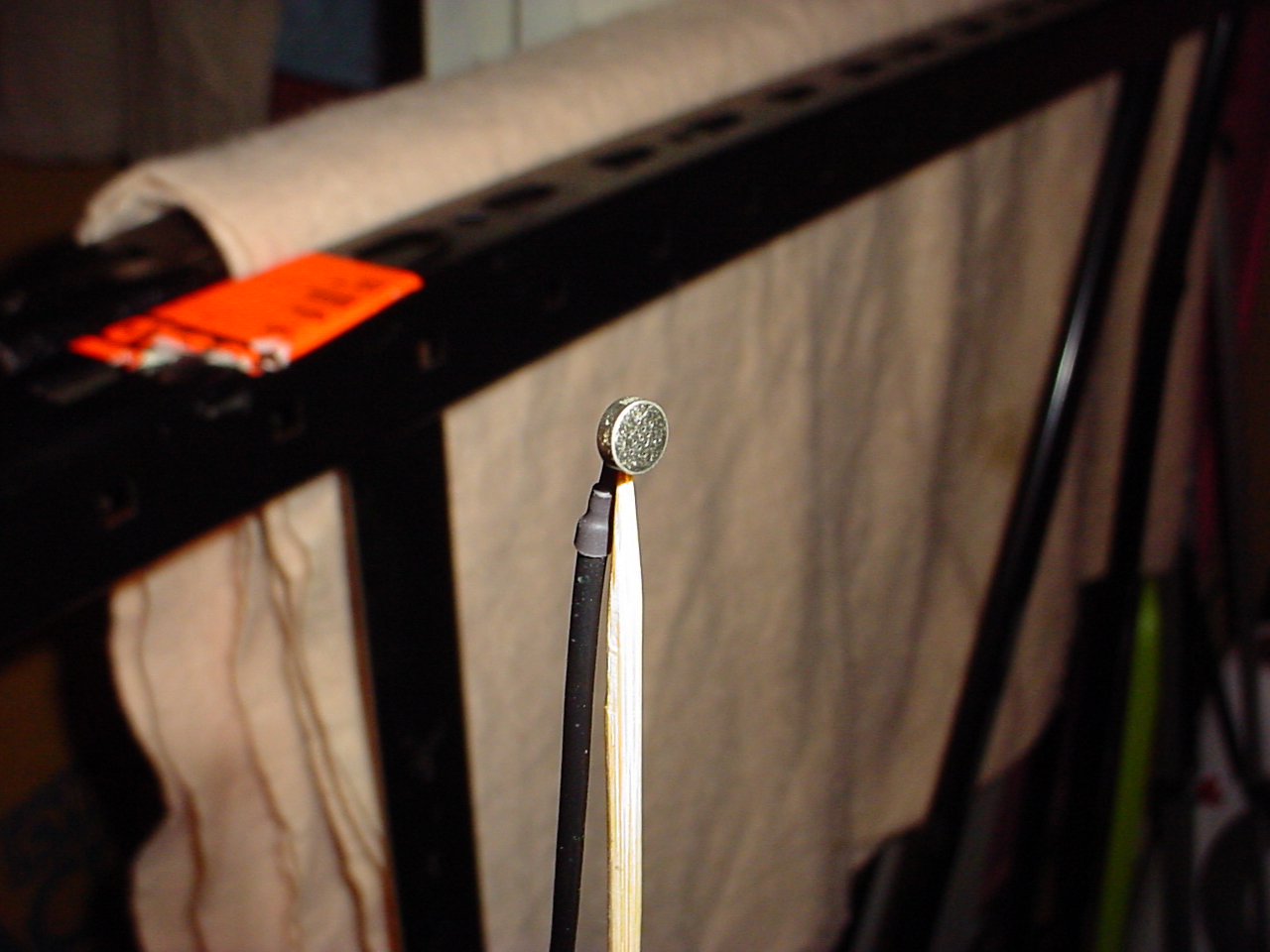

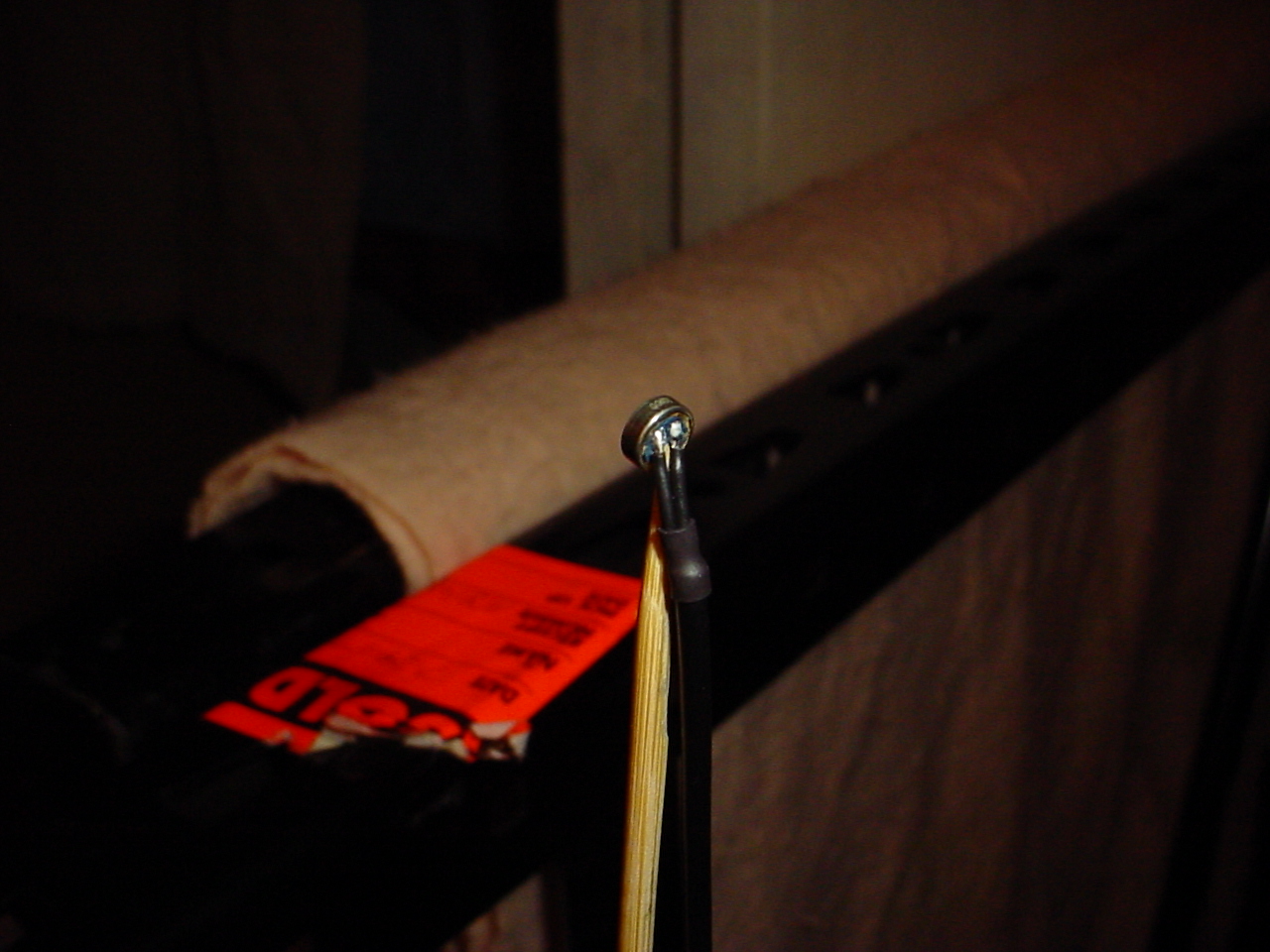

Here is a picture. I can't think of a less obstructive way to hold a capsule.
The literature says you need to support for the capsule coming out the back. Apparently it doesn't take much even with that to affect the response (check the link I provided earlier).
Also most of what I have read indicated that the initial point of change is the correct reference. What is somewhat crazy is that he acoustic center of the microphone changes with frequency. Its not a lot but the kind of thing that the metrologists obsess over. It may also explain what you are seeing with phase vs. time. This link may help even though its talking about MEMS microphones https://www.knowles.com/docs/defaul...icrophones---theory-and-practice.pdf?sfvrsn=4
I've mentioned the acoustic center in several posts. With the damping applied to the trafo, the impulse is clean enough to clearly see the different acoustic centers. Attached. Is this not a useful indication of where the time center of the impulse is?
Once the calibration is applied to a measurement, the acoustic center is corrected in the measurement, so technically it should not matter if you set the acoustic center 10cm in front of the microphone for the calibration, the group delay in the measurement will be flat, just offset by 10cm. The question is where you specifically think the acoustic center is, if it is different from the result given by the FFT. You may set the acoustic center to be the face of the microphone, so you can locate the microphone face 1 meter away, but the FFT may disagree by a few mm.
If I use the bamboo skewer for all my measurements (extremely likely unless something better appears) then the calibration is valid for my usage. And anyone else could easily use the same setup for cents.

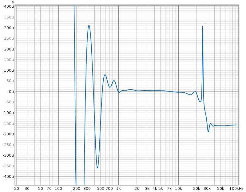

I can even move the FFT window over the spark event E-field, which appears 162us before the acoustic wave hits, so I know that according to the speed of sound, the microphone is 2.19" away from the spark. How much positional accuracy do you want? How much certainty do you have in the speed of sound?
The Knowles paper seems to agree with setting the time center to the earliest group delay.
#264 said:
Note that the phase response of a MEMS microphone is a monotonically decreasing function. This means that the derivative is negative at any frequency and group delay is always positive. Indeed, output of the microphone always shows up after the input arrives, which makes sense from cause-effect relationship perspective. Group delay of a microphone cannot be negative.
What this means is that it makes sense to set the group delay to the the flat HF region. When I do this I get the phase in post #261. The phase is negative and that is expected, but it is lower than expected.
My thinking is that the holes in the face of the capsule may affect the acoustic impedance of that space at wavelengths that approach the width of the capsule. As a restriction they would convert pressure to velocity just before the membrane.

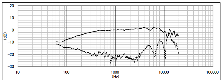

Here is a curve for the Primo EM264 cardioid bare capsule at 11" away. Again a gradual rise in the treble appears in the datasheet but is nowhere to be found in my measurements. My measurement could be hiding the rise, but then that does not explain why the EM272 and EM258 have about the same response.
Thinking about minimum phase.
When REW generates a minimum phase curve from the response, the phase is -90 degrees at the corner frequency of the capsule. This is equivalent to shifting the acoustic center 2mm, and places both group delay plateaus after T=0.
So we have 2 different ways of deciding on the position of T=0 for phase. We can place it at an acoustic center where group delay is flat, or we can place it so that the response obeys minimum phase.
In the case of the EM258 the only difference between minimum phase and acoustic center is a time delay distance of 2mm.

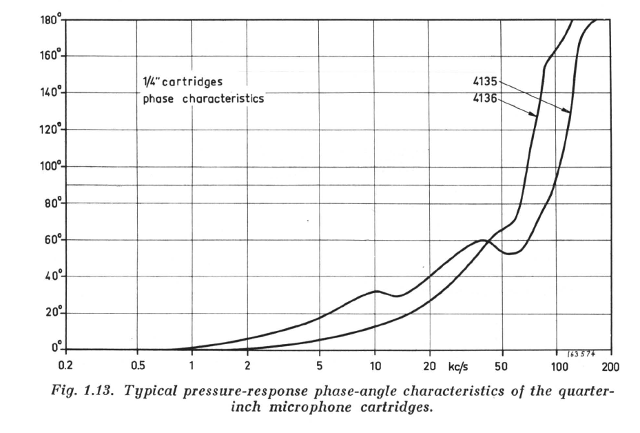

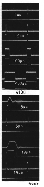

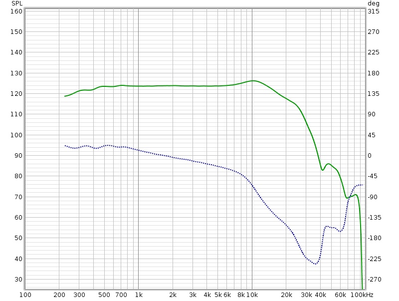

Here are some measurements from the B&K manual. It was created in 1966. The later manuals are much less informative. In any case the Phase and impulse response are from an electrostatic actuator. Still they are valid reference points.
"3. Phase Characteristics and Pulse Responses.
Typical pressure response phase angle characteristics of the quarter-inch
microphones are shown in Fig. 1.13. The fundamental resonance of the diaphragm in vacuum occurs at about 50 kHz, but when air at normal
pressure is present between back plate and diaphragm the center of the
diaphragm is virtually blocked and the first resonance appears at a highe1
mode around 70 kHz.
Fig. A.6 in Appendix shows some examples of pulse responses."

I think the way to cause the least confusion will be to set T=0 so that the phase curve matches the response derived minimum phase curve. Beyond that it seems somewhat academic when the only difference between min phase and acoustic center is a 2mm time delay distance.
That is probably the most useful. There aren't many situations where that distance and time difference would be meaningful.
