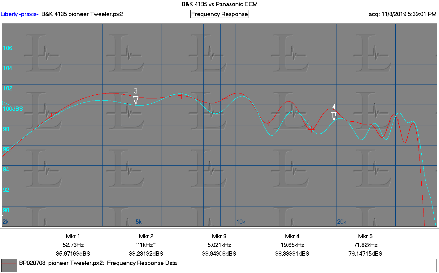

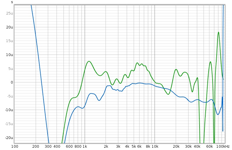

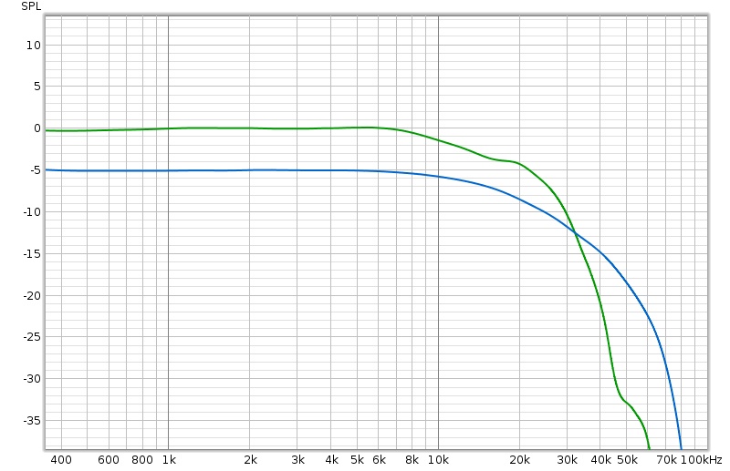

Below is a comparison of my B&K 4135 and the Panasonic ECM that came with Praxis many years ago. The source is a Pioneer ribbon tweeter that hits a wall at 35 KHz. Its easy to see why I use the ECM for most tasks. The wiggles are typical of real world measurements. The tweeter is useable above 35 KHz but not easily. I think there are aspects of its physical size that limit it. And I would need to remove the screen on the B&K, something I only do when absolutely necessary.
I'm not sure what to do next. Everything is sort of at a standstill because I have no reference.
I suppose if I want to replicate Earthworks' results, then the best option would be to get an Earthworks mic or Gefell. But that's not going to happen.

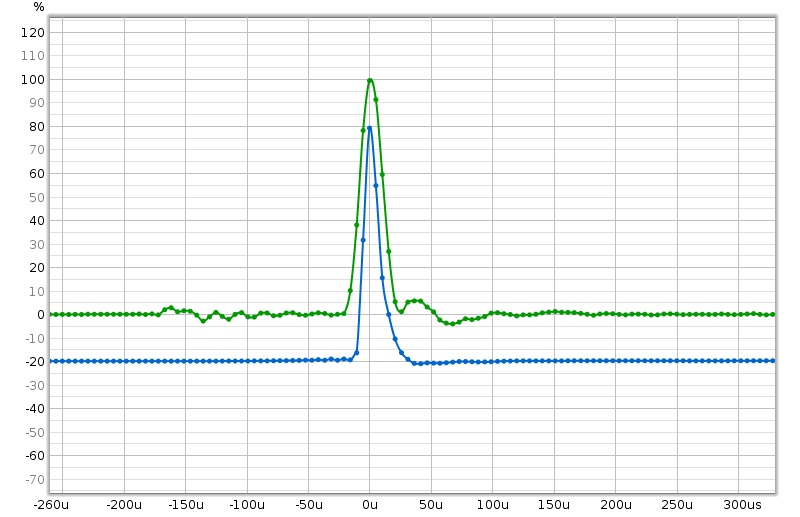

I set my script to measure the offset 100uS before the spark and subtract it from the recording. This seems to help a lot in reducing spectral leakage from windowing, and extends the usable LF response.
Being close to the spark is a significant advantage when it comes to reflections. The distance between the mic and spark directly subtracts from the distance to the nearest reflection, so you get the best results when the mic is close to the spark. For me to get valid data near 1KHz I must keep them close.
This trial was done with the mic about 18" from the spark, using the taser with alligator clips.

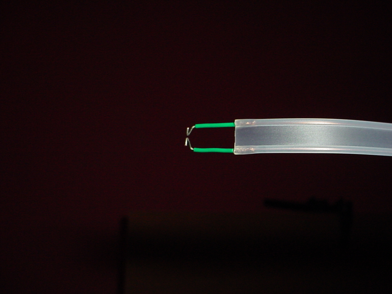

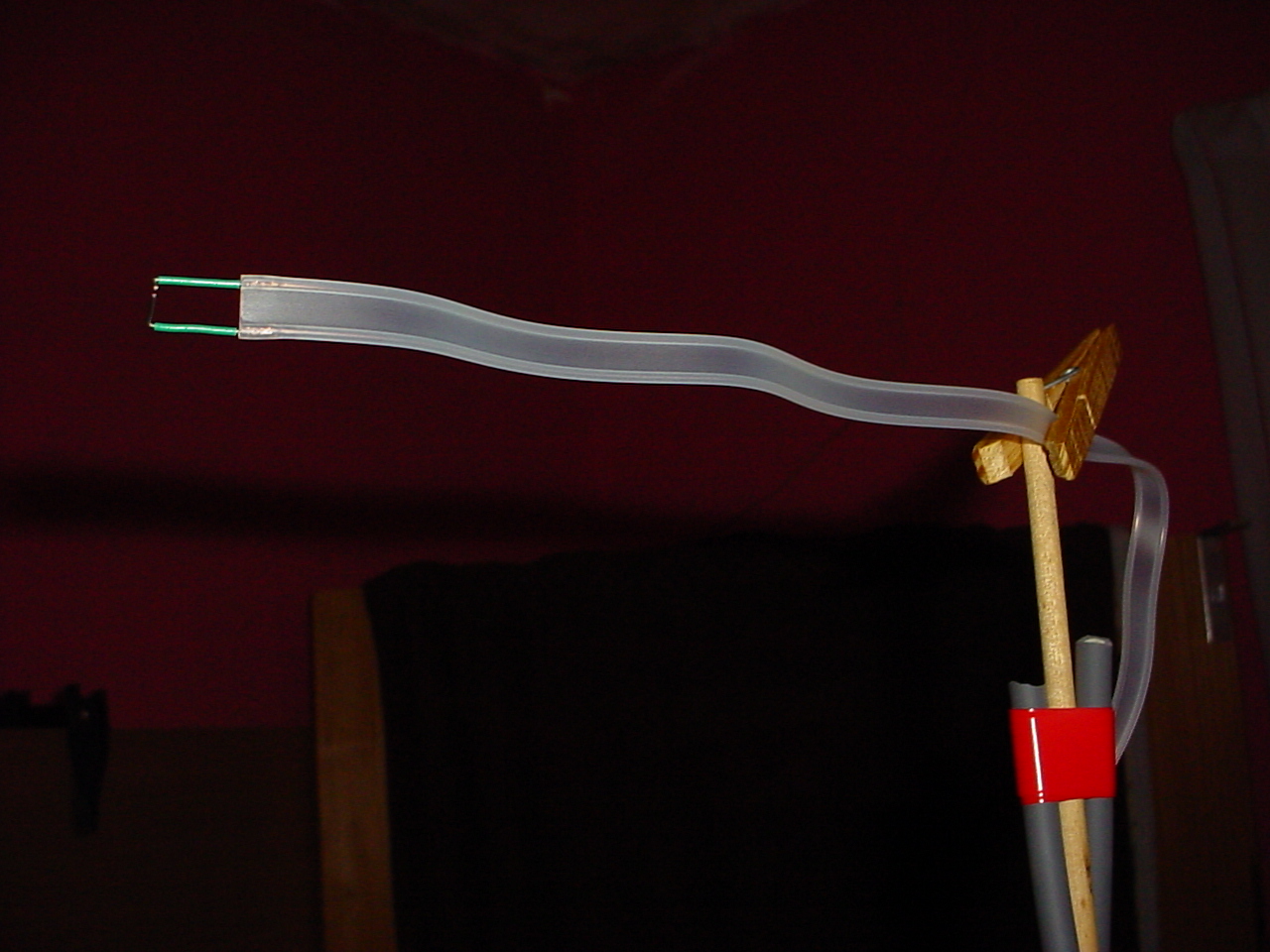

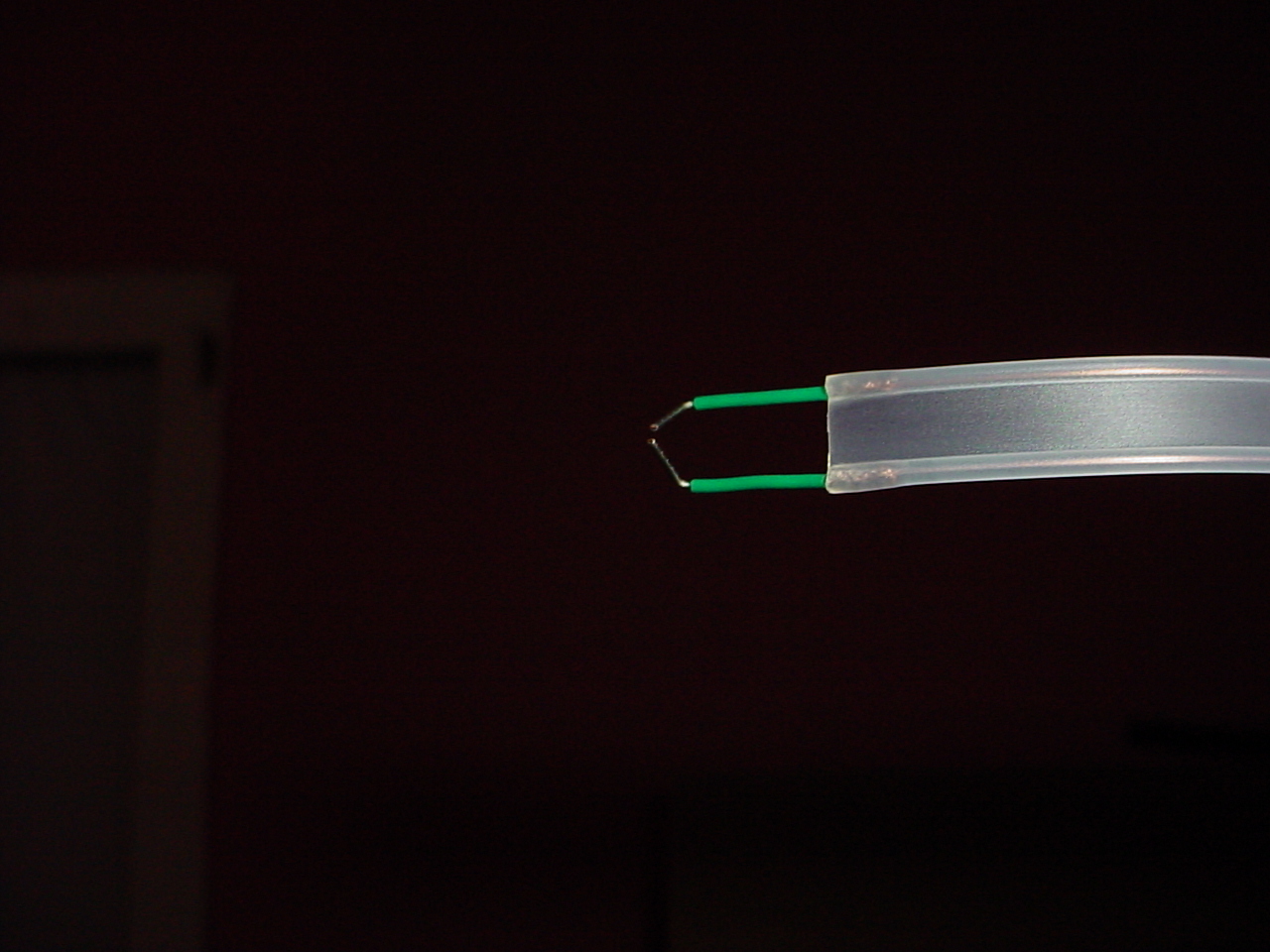

I just got some 300 ohm twin-lead I wanted to try. It seems ideal in several ways. The conductors are spaced well enough for most usable gap sizes. It has very little capacitance. It is acoustically unobstructive in the right orientation and is self-supporting which helps minimize any scaffolding around the spark.
I didn't find any rigid types of this cable for sale but that would be even better.

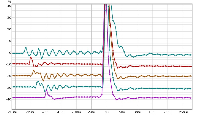

It seems to perform well in terms of spark consistency. But I get the LF anomaly again, and now it shows up as an odd tail on the impulse response. The effect is the same with and without the alligator clips feeding the twin lead.
The electrodes are tinned copper breadboard links with sharp cut edges, so maybe that has some effect. Perhaps the sharp edges allow the arc to continue longer than necessary. I have been using silver plated copper for electrodes so far.

Compare that to this impulse response I get after curving the electrode so they don't fire from the points.
But actually the LF anomaly is present in both. The electrodes may have had a tiny effect but I don't see much difference.

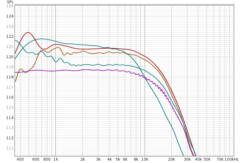

Overall interference is the largest issue with the twin lead, having not added ferrites yet since it will take some cutting. After adding ferrites it will be more of a fair comparison with the other cables. The endgame with the twin lead is to try it with the Olympian which really dislikes capacitance. But I am not optimistic due to trends with interference.
This chart illustrates that this is not a good position to be in, since I can pretty much tweak the setup until I get the curves I think I should be getting, irrespective of reality. The orange and green are the runs from the last 2 posts. The blue response is from moving the mic closer to a much smaller gap, and the red response is after adding a ferrite cable clamp to the twin lead at the base of the dowel.
The blue and red responses dip in the midrange because of interference that happens before the acoustic wave hits. The ferrite clamp reduces this interference so the red curve is less severe, but slight interference can still be seen on the impulse response.
EDIT: looking at the again I see that the the impulse response tails are lifted for the upper traces and dip for the lower traces and this matches the responses better than the interference. So it seems in this case the LF anomaly is coincident with the acoustic wave. This is puzzling but I can try moving the mic further away.

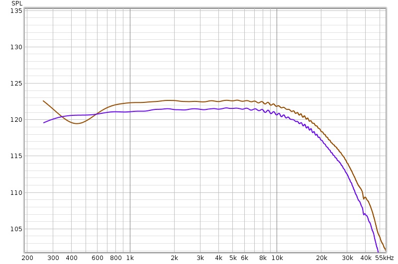

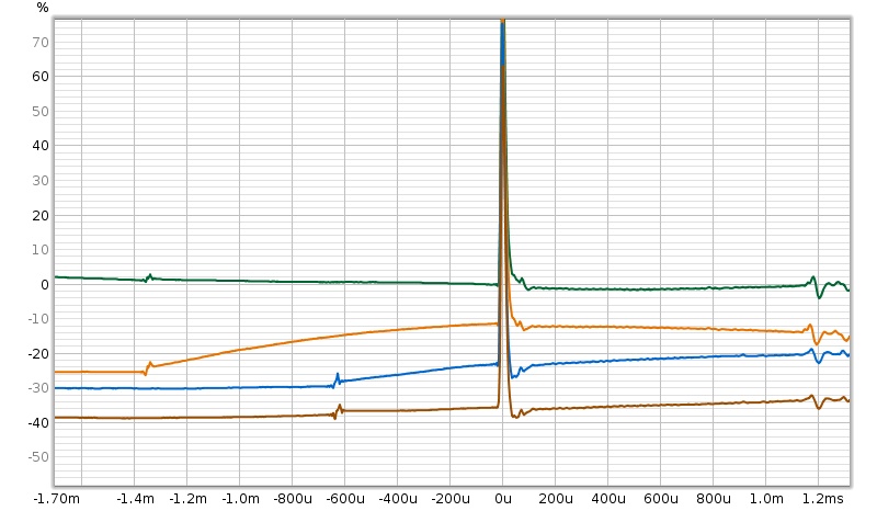

I tried using the Olympian with the twin lead. The only method which really worked to reduce the interference was to use sharp points on the electrodes. This eliminated intermittent loud sparks which would cause a lot of interference.
Now for some reason 20KHz is 8db down, and neither distance nor gap length affects it.

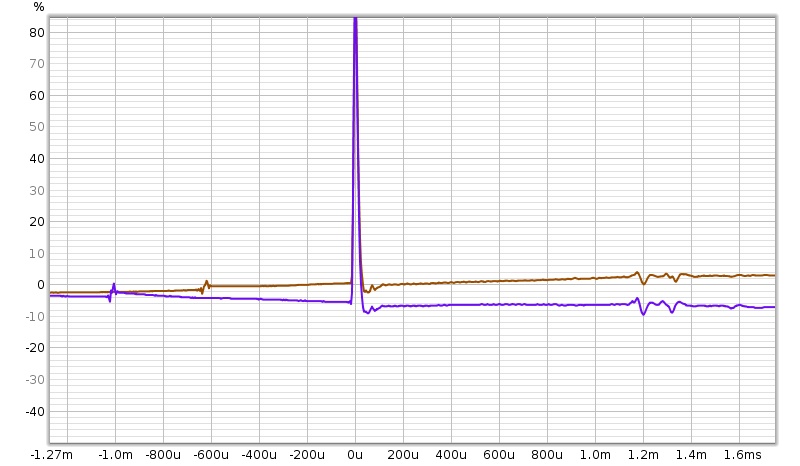

I made the gap very small using sharp electrodes and moved the microphone closer. I found a small improvement by adding a 100ohm resistor across the primary. Then I tried 68ohm, 10 and 6.8ohm carbon comp resistors.
It looks like the low-capacitance twin lead allows the transformer ringing to keep the spark alive for too long, where as some capacitance or resistance previously attenuated the ringing.
I found that a combination of a diode and a damping resistor on either the primary or secondary gave the best results.
From top to bottom the impulse response shows
100ohm primary shunt resistor
10ohm primary shunt resistor
BYM26C primary shunt diode
BYM26C // 10ohm primary shunt
BYM26C primary shunt + 220kohm secondary shunt resistor
The blip before the impulse is the E-field from the spark event which shows the damping or ringing of the transformer. You can see the distance from spark to microphone decreases over time as the tripod settles, but this is not significant.

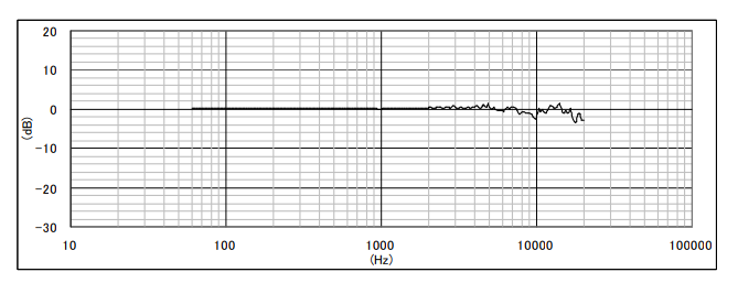

For the last test the mic was 2.5" from the spark. The pointed electrodes as well as reducing radiating surface area reduced interference quite a lot. This is important because with damping, the spark would not fire loud enough to get good results with a lot of distance. Furthermore having the spark close to the mic maximizes distance to reflections as well as minimizing the intensity of the reflections, so has a very powerful advantage.
The resulting response seems very close to the datasheet in the last attachment.
The transformer rings with a period of 20uS, so I think this will affect the BW limitation of the calibration. I was not able to find an inductor to use in parallel with the primary which would decrease this time constant and still fire a spark. That leaves reducing the capacitance as an option, if it will still fire a spark.

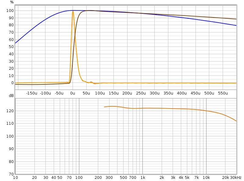

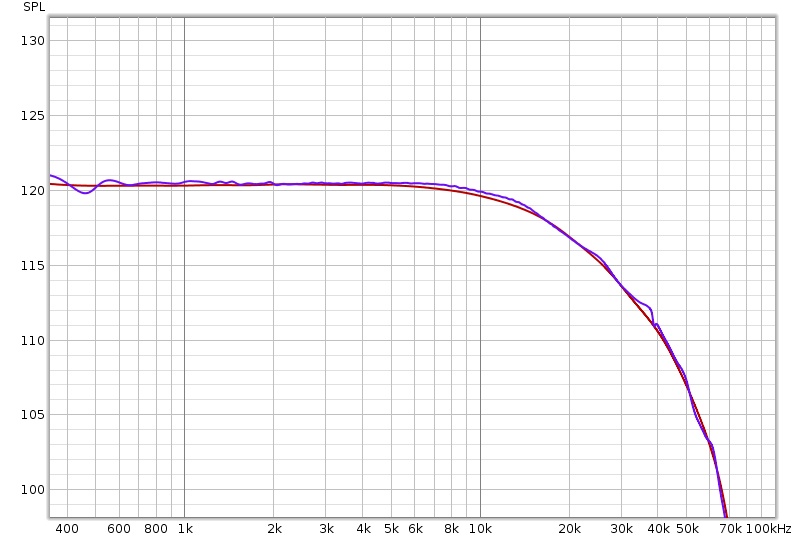

It seems I am working out how to get the whole system working. It is a long list of things that need to be done right, and any single one can ruin the results.
The impulse centering and averaging has extended the usable LF BW to the point where room reflections become the confounder, and the spark trafo damping has restored usable HF response. Use of gratuitous ferrite beads and triggering through a relay for isolation minimizes interference so the mic can be close to the spark. Having the mic close to the spark maximizes reflection distances and minimizes their intensity. Minimal scaffolding leads to a very clean impulse decay.
So here is where I am at with the EM272 and EM258. Some interference is still visible on the EM272 impulse but it has been windowed out.

The curves obtained at 2.5" are almost the same as those obtained at 3 feet, so I think the wave is planar enough.

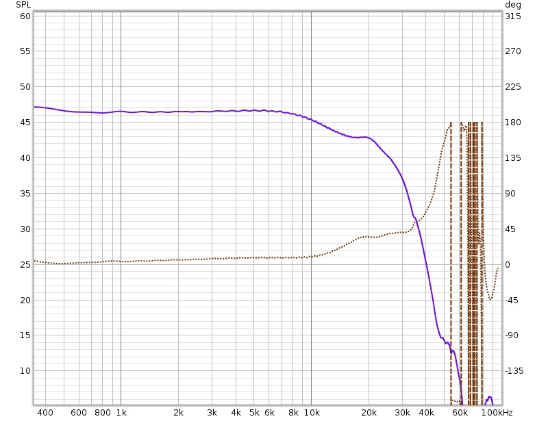

Giving the taser the same treatment with a 3.3ohm resistor across the primary, the resulting curves for the EM258 nearly overlap. So it looks like this could be generalized to various devices, but the taser is the most adaptable source because it can make louder sparks even when damped. Attached the rough curve is the taser, the red curve is the previous result with the Olympian, just with frequency dependent windowing.
It's hard to know when I'm "done" because of lack of experience and the results have been unpredictable in the past. With some of the distortions there has also been the possibility of getting something deceptively close to the calibration curve but actually ridiculous.
Here is a zoom on that curve. Not sure why the phase is flat at 2.6 degrees, or what it should be. All I know is the results are the most useful when I time align the impulse to the group delay of the upper midrange where it is flat. The group delay steps back by 2mm above 10KHz, I assume because the wavelength approaches the size of the capsule.
