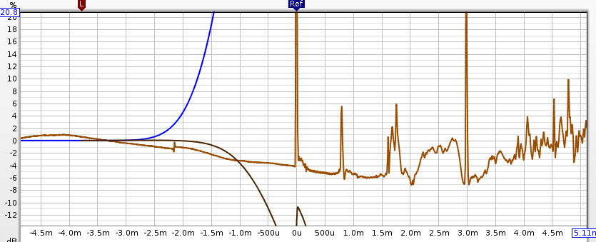

I looked at previous spark measurements, and the Olympian sparker has only a little less 20KHz rolloff than the taser. The heavy rolloff seems to have always been in the measurements since I stopped using the ground plane, but the roughness in the curves helped hide it. Now with the better acoustic setup it is rather obvious. It is puzzling me. The datasheet certainly doesn't show this trend.
Now here is a theory. As the doublet elongates the allpass characteristic increases because the LF lag more and more behind the HF. So what is the chance that we could infer the doublet BW from the allpass phase value? Only issue is how well the microphone obeys minimum phase. Since it is allpass, it may be evident where the microphone's response is pistonic. So how do we get from a 5 degree allpass phase to the corner frequency of the doublet?

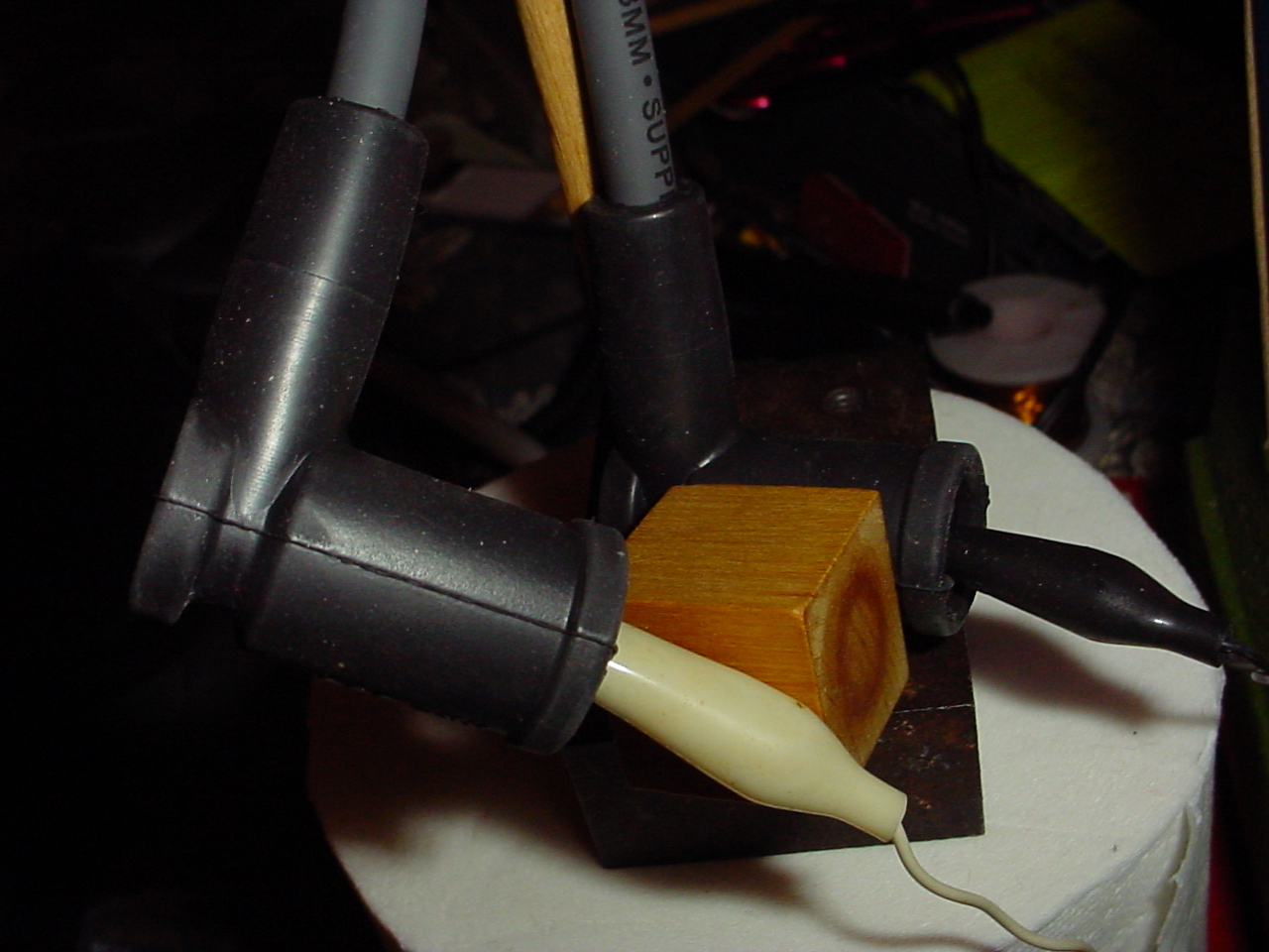

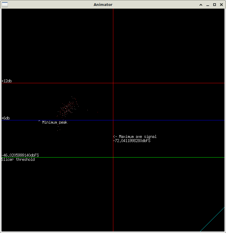

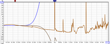

I got a set of spark plug wires and used them with the frankentaser. The most obvious effect of the spark plug wires is that everything before the wires experiences much more transient voltage. The taser points want to fire. They will show corona or sometimes fully fire. To help with this I did something that should not have worked but worked anyway. I took a section of spark plug wire, drilled out the conductor and then connected it between the taser points like a bent tube. I expected the residue of the carbon conductor to encourage the points to fire, but that does not seem to be the case.
See, if I was a real engineer I would never have tried that. I actually got a surprisingly tight spark group from that run.
As far as the effect on the doublet, there is an oddly well defined step right after the impulse. It makes sense to me that the wires may lengthen the glow discharge period if it is affecting the doublet, but that is only a theory as to why this is happening.

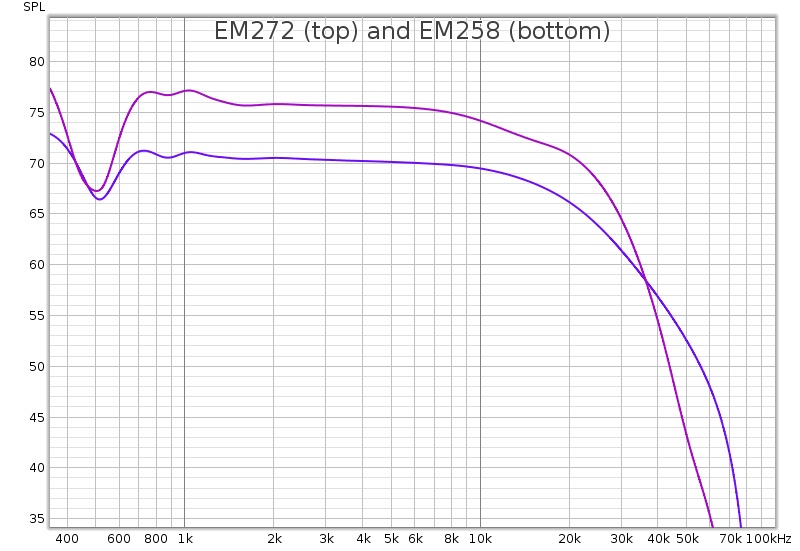

Primo has come out with the EM419 which is the replacement for the EM258. Looks like it uses a new capsule but different Jfet. SNR and max SPL are 1db better, but I have to wonder if this is not just so that customers will happily accept the replacement. EM258 and EM419 datasheets:
http://micbooster.com/datasheets/EM258.pdf
https://www.primocorp.co.jp/product-corp/fileview/49/EM419NM1
It's interesting that they have added a LF spec. +-10 degrees at 30Hz.
The EM419N and EM419NM1 are a bit different with the EM419N having a higher max SPL.
The phase spec relates to using them in ANC applications. (I'm immediately changing a spec once this email is out.) Particularly in ANC feedback you have enough problems with drivers. Having variations in the mikes at low frequencies where there is lots of feedback is not good. It also means a small pressure balance port. All good.
I did wonder if Primo tested their mics with a grommet or in a baffle of some sort. It would be nice to know if that is the case. Realistically the roughness in the curves must come from somewhere.

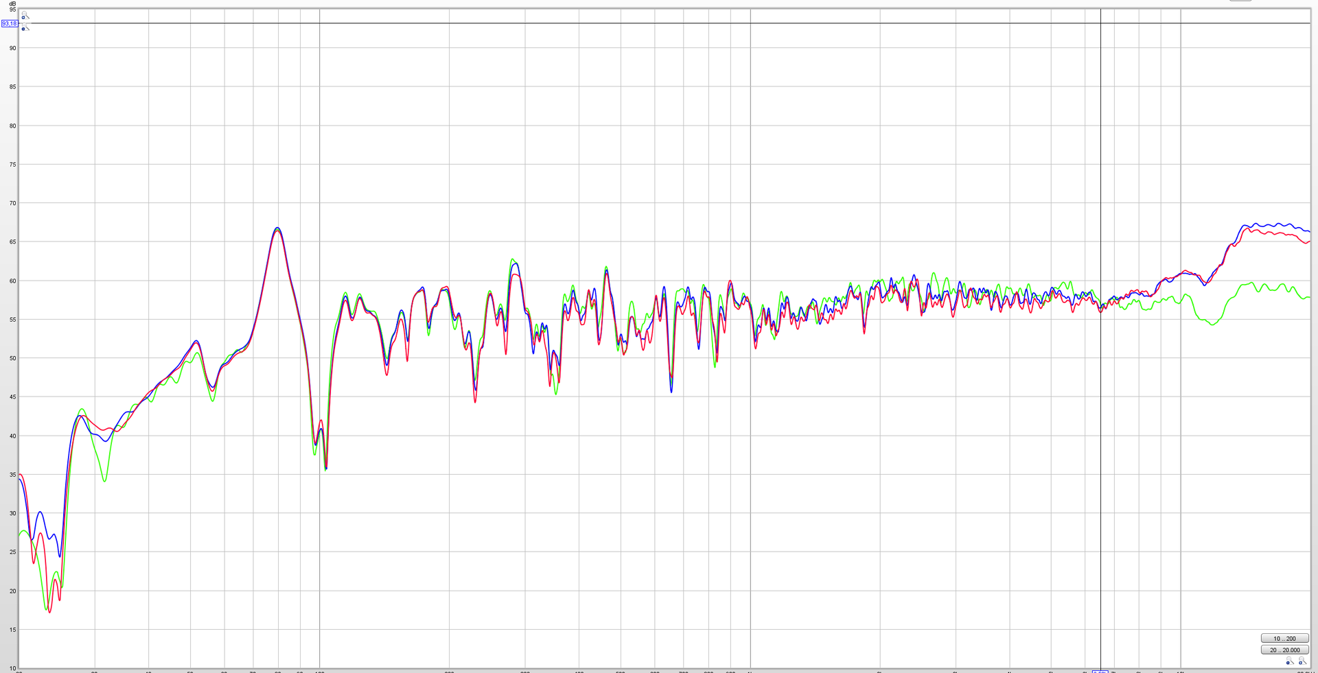

I found a comparison of the EM258 with the ECM999 on a German forum.
* Binaurale Wiedergabe über Kopfhörer., Reviews und lesenswerte KH-Themen - HIFI-FORUM (Seite 8)
This measurement shows the EM258 as having 6db extra sensitivity at 20KHz, not less. You are in the twilight zone.
German forum said:
Figure 3: Green Superlux ECM999, red Primo EM258 right, blue Primo EM258 left. Distance about 50-60cm from the speaker. The Primo capsules were about +-2cm away from the Superlux and placed about 3-4cm higher than the Superlux ECM999. The angle was somewhere between 3-10° for the capsules and 0° for the Superlux. The curves were pushed on each other by eye. I find the frequency response of the capsules to be very similar. Up to 6KHz there is hardly any difference to the Superlux ECM999. After that, there is a treble emphasis. For Impulcifer, however, you could actually use the capsules for room correction, since you actually only need the room influence range <1KkHz.
Translated with www.DeepL.com/Translator (free version)

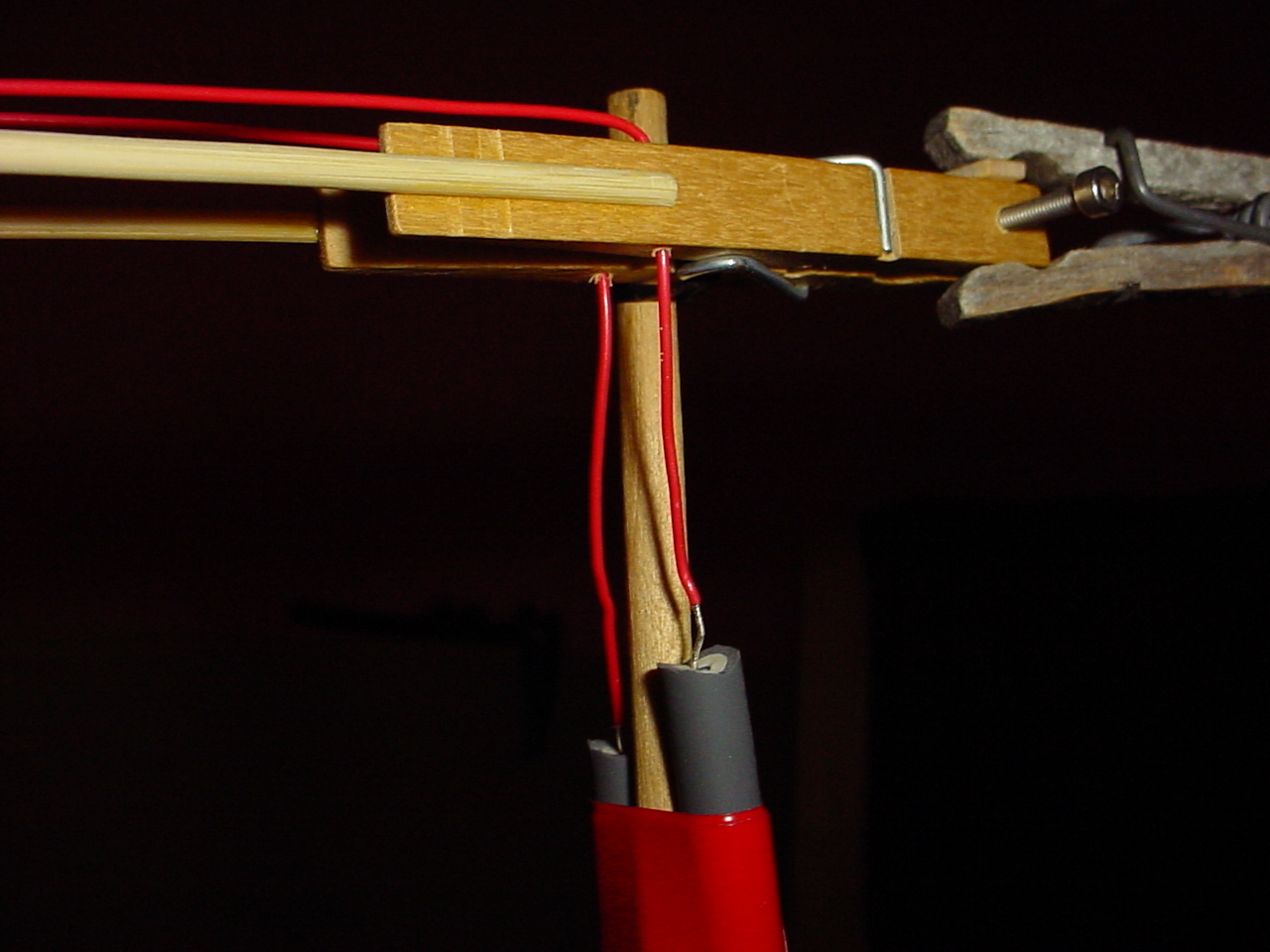

So glad you decided to fit some spark plug wire! As much as I love alligator clips -- and use them extensively myself -- seeing your jumpers, even though only lightly twisted, with their 600 or 1kV insulation had me worrying for you.
This is some really great work you're doing. 😀
(Following closely -- but not closely enough to get this posted before 4 other posts! 😱 )
Regards
Thanks for the encouragement! But the spark plug wires don't make me feel the least bit safer. I just keep well clear of the output side of the circuit. The bit that the wires insulate is the least interesting section of the circuit, and the increased voltage before the wires (due to their high resistance) actually makes it more dangerous (but no more dangerous than a taser is normally).
My thick alligator jumpers use silcone wire rated for 20KVDC, although the fast risetime makes them more susceptible to puncture.

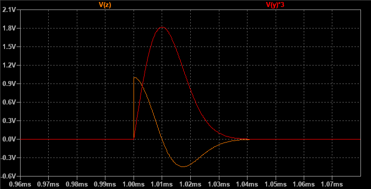

I figured out how to synthesize a more realistic spark doublet in LTspice using a nonlinear capacitor. This model gives -3db at 20KHz when set to a similar frequency dispersion pattern. But there is no allpass characteristic in the spectrum so that may have been a red herring.
Both the spark and the capsule body itself can have the effect of moving the HF earlier in time due to the acoustic center moving forward as the wavelength approaches the capsule size (correct me if I'm wrong). So it's not obvious that the two can be told apart.
The reason for the spark plug wires was actually to see if it would work better than ferrite beads at reducing interference. The wires have a carbon conductor with about 11kohms per wire. What I realize now is that because the spark can't limit the voltage at the beginning of the spark plug wires, the E-field from the spark event actually increases, increasing interference.
And as for the response, it doesn't seem to be any different when using the spark plug wires. I had hoped for some meaningful change but they don't seem to do much.
What the spark plug wires do is reduce the SPL for a given spark gap length, and they also increase the consistency of SPL. So short wires or some other resistance element could be good for spark consistency, as long as interference isn't increased.
