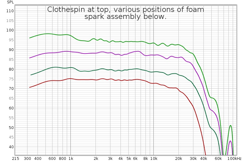

I tried the EM272 with a different spark gap in a few different orientations. I used the foam spark gap from post #58:
Spark calibration of microphones
So this gives some idea of the variation that can come from the spark gap assembly.

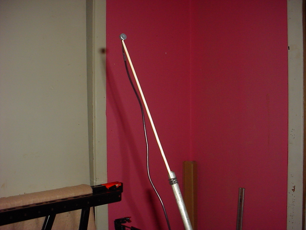

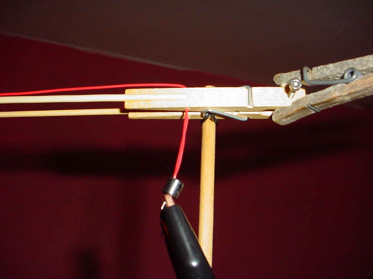

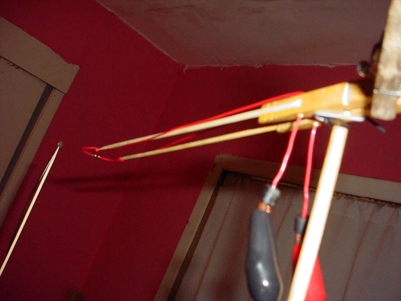

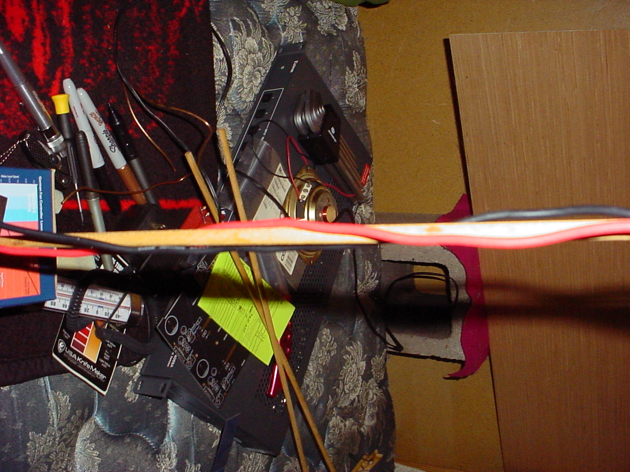

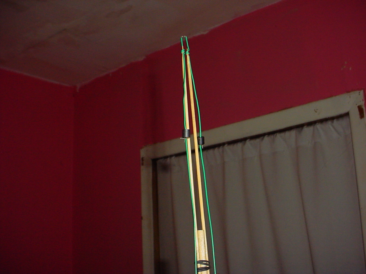

I did get around to trying the most unobstructive spark gap and microphone stand I could think of (attached). I did get a very clean decay in the impulse response, but the LF anomaly is still there. For the microphone capsule a bamboo skewer wedges perfectly between the wires in back to suspend the microphone in a controllable manner. However the skewer tends to wobble and subsonic noise is the enemy of doublets. The amount of rumble coming from the mic when the train passes through town is surprising. It seems there would be an advantage to mounting the microphone so that it is least susceptible to ground bounce.
The spark gap is two bamboo skewers with wire secured by coiling around the tips. This is fiddly but I made it work.

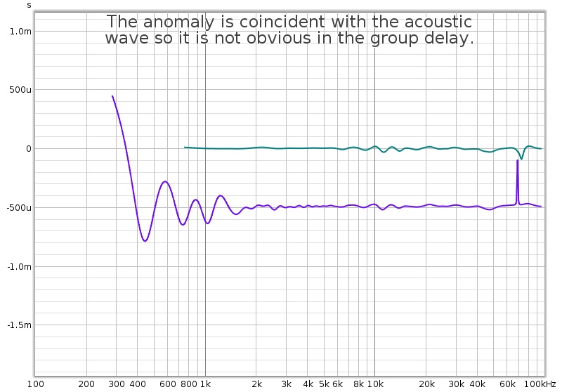

This gave minimal reflections in the first 1ms, but the LF anomaly is still there. What I know about the LF anomaly:
1: It correlates more with spark gap size than anything else. When minimized it does begin to correlate with SPL and distance more.
2: It may change with spark generator even if the gap remains unchanged.
3: It's slope changes. It may be very gradual or it may manifest as a 6db/oct slope. Perhaps appearing gradual is just a consequence of the corner frequency being lower.
4: It appears to manifest as a level shift during the doublet and then gradual return to zero alike a DC filter. This is consistent with asymmetry in the doublet itself or in the capsule electronics.
5: The LF anomaly appears the same through 2 ADCs connected to the same microphone. So the error seems to be narrowed down to the capsule itself, with a slight possibility of being part of the acoustic wave.
6: It is coincident with the acoustic wave and not the spark impulse the mic picks up.
7: The LF anomaly appears to be reduced by shunting the 2-terminal capsule with a 100nF capacitor, but then SNR suffers from ADC noise. It could be this just helps hide it.
8: It sometimes switches polarity between a positive and negative level shift. This would be consistent with nearing positive or negative limits at the time the doublet is recorded. Perhaps related to noise occurring at the same time.

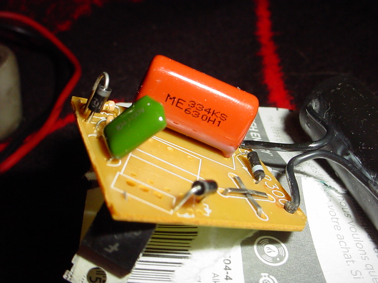

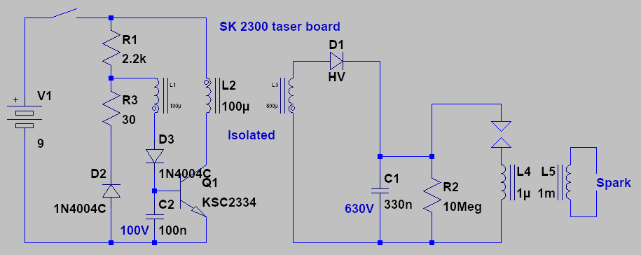

The taser died while trying to tune in the new setup. I made a new spark gap assembly by gluing skewers to another clothespin. The charts looked very smooth without much windowing.

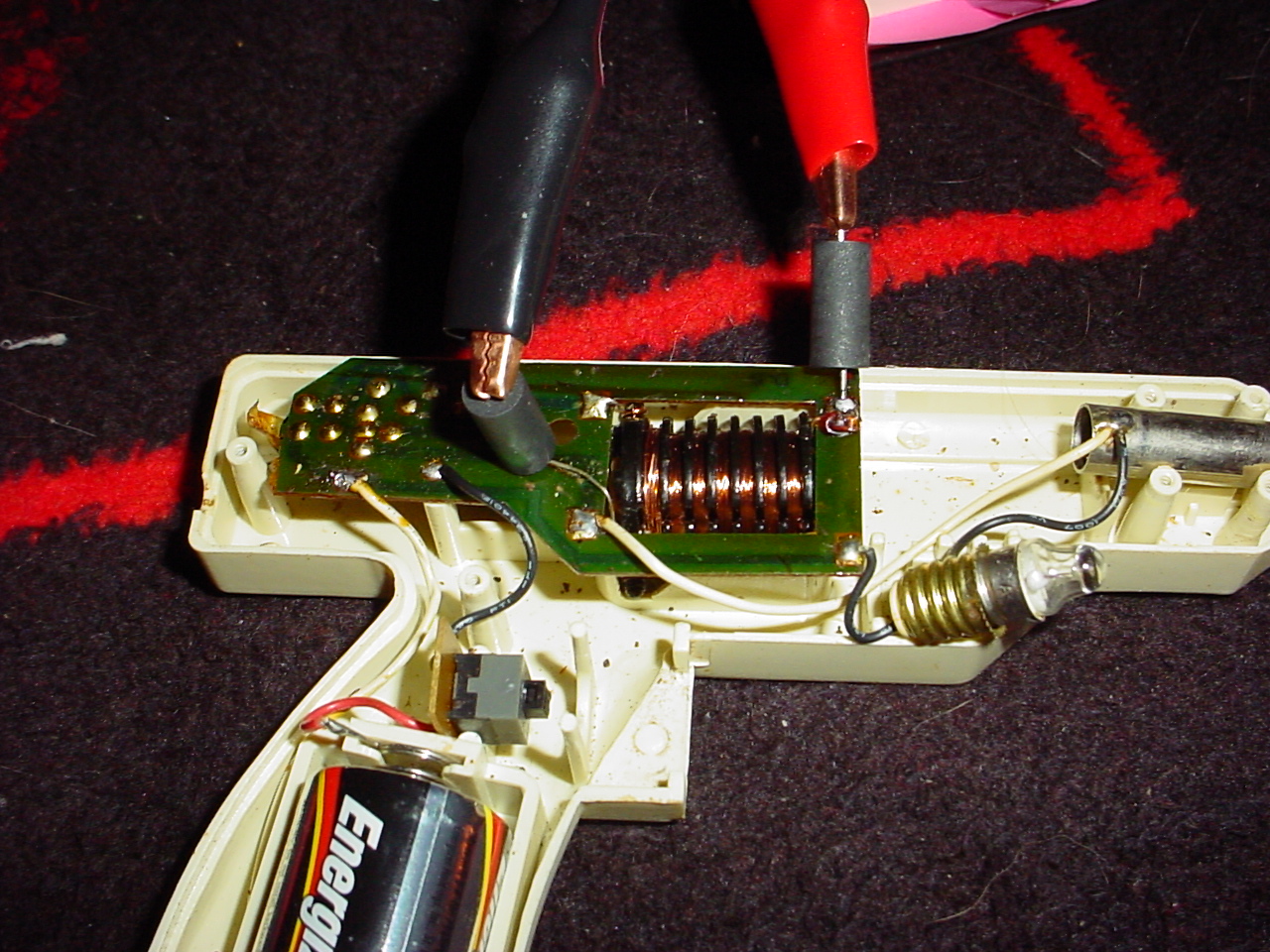

Inside the taser is a flyback circuit charging a 330nF capacitor which discharges into the the primary of the output transformer through a spark gap.
The big problem with the taser source is that the flyback converter is so noisy that the E-field drowns out the doublets in the recording. So I wasn't actually able to get it to work very well.
It appears to be the flyback transformer in the taser that failed, since the transistor tests normal Hfe. I can still charge the 330nF cap by tapping the battery across the flyback transformer, so it looks like it may be the feedback winding that's bad or possibly something I didn't consider.
The output transformer is a long piece of laminated steel with windings around it and potted inside a black cup with clear epoxy.
The noise appears to have come from the leakage capacitance of the flyback transformer permitting everything after that point to float at some fraction of the flyback AC signal.

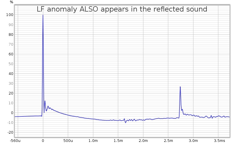

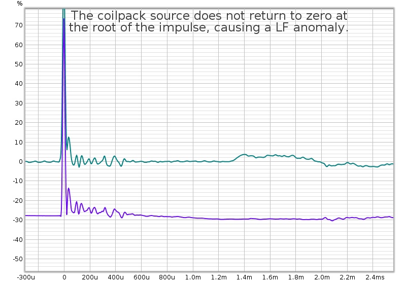

Going back to the coilpack, here is an impulse reponse that shows the LF anomaly is present in the reflected sound and not just the primary wave. So this strongly suggests it is in fact acoustic in origin. This is with about a 4mm gap using the Ford coilpack.
Perhaps this could be glow discharge as the remaining energy in the coil prevents the arc from extinguishing.
If it is that simple, maybe a smaller inductor in parallel with the primary, or a snubber will work.

I'm trying to work out how to get a cleanly produced and recorded doublet. The LF anomaly is confusing because I have never seen this documented anywhere, and there are plenty of references in this thread.

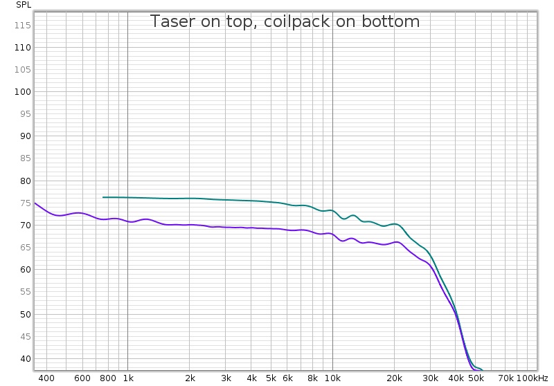

I switched back to the coilpack because the taser failed. Different snubbers give interesting results with the coilpack, but the taser seems to work right out of the box except for the massive interference caused by the internal flyback converter.

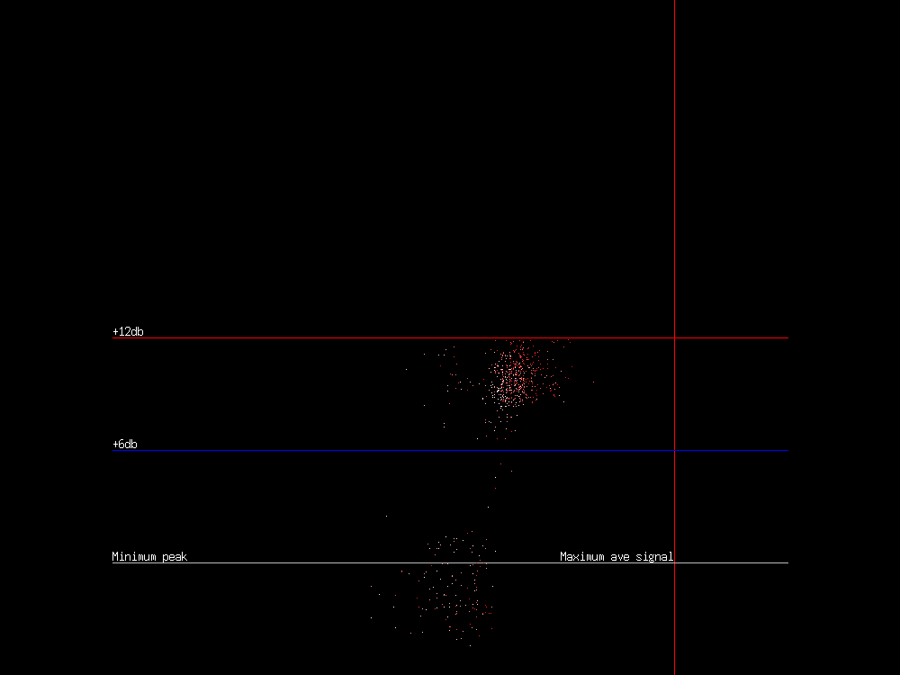

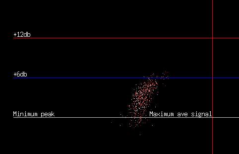

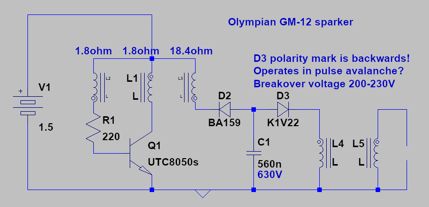

Today I got out the old Olympian GM-12 gas appliance lighter. I avoided using this one because of the interference it causes. It seems to have a fast risetime. For some reason it will spark through the silicone insulation of my alligator clips whereas the taser and coilpack would not. This caused an inconvenience due to the fact that I could no longer twist the wires together to reduce interference. I managed to find a compromise, winding both wires around the spark gap boom and being careful of the distance.
Once the interference is at a tolerable level it actually looks like this sparker is fairly well damped. On the impulse response the E-field has no ringing. However I can't remote trigger because wire of any sort connected to the sparker radiate too much E-field. The ferrite bead application here is crucial.
With this sparker and the new spark gap assembly, I can turn frequency dependent windowing all the way down to 2 cycles with almost no change to the HF response, so this is a very very clean setup.
I've attached the impulse response and chart of a measurement with this setup which you can run in REW or your software of choice.
You can also see that I updated my script with a scatter plot to help with setting the slicer settings. The dots go from white to red over time so you can see here there was some drift in the spark output over the 500 sparks in this plot. Everything below the white line is culled and I would have had better results by reducing my preamp by about 6db.
It looks like I may finally be approaching something usable.

I figured out what was wrong with the taser. The internal charging transformer did not observe clearance limits for 400V output. The output winding was charred from arcing. This must be what was causing so much E-field interference. It was unsalvageable, but I did learn the turn counts. I may try to substitute the taser output coil into the Olympian sparker.
I think the Olympian sparker has more interference due to the iron or ferrite core whereas the taser has a laminated steel core.

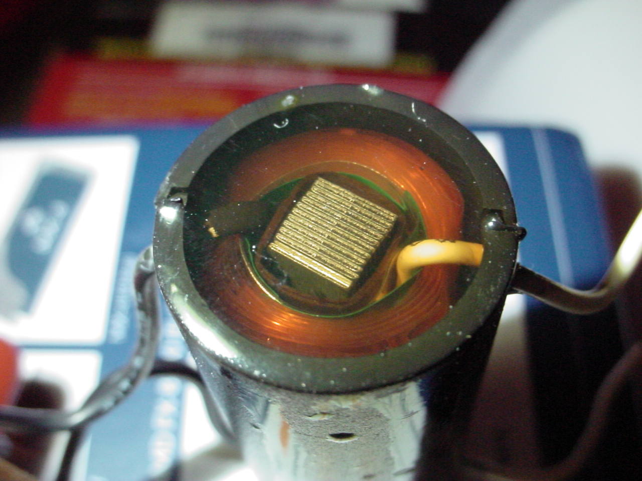

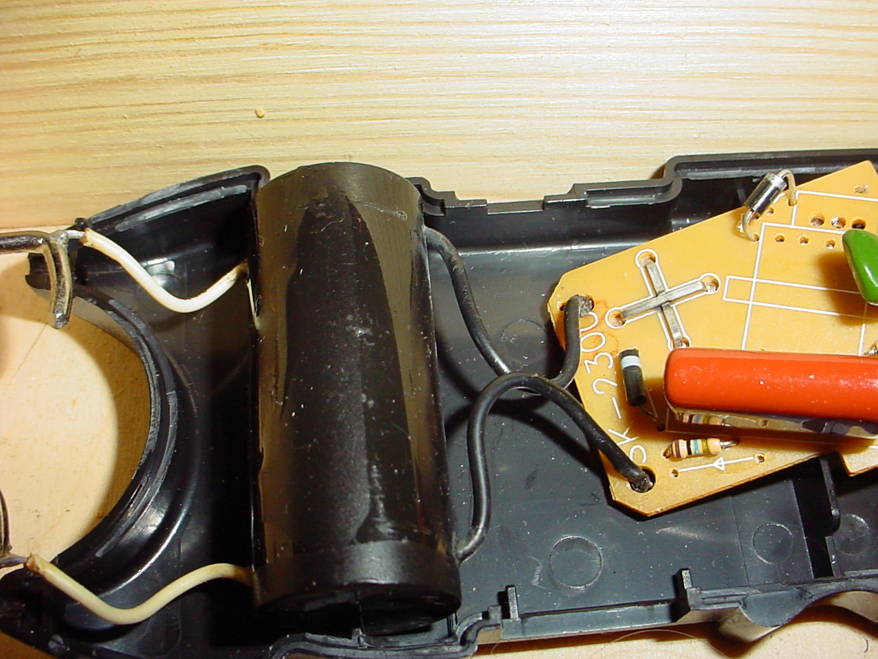

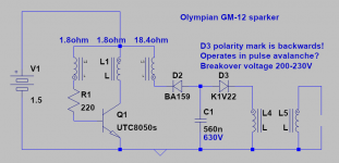

This is what is in the Olympian sparker. It appears the K1V22 diode is used as an avalanche pulser. It's polarity marking is actually backwards so I imagine these were a messed up production run sold at a discount. I've seen only one other batch of diodes with sporadically reversed markings.
Using an avalanche diode does appear to be a relatively quiet way of achieving well controlled lower-energy sparks. The Vishay BYG22a seems like a modern equivalent here. I suppose it won't have the uncertainty that a spark gap does.

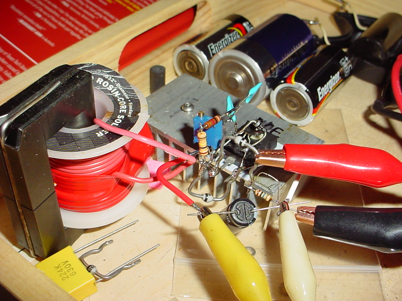

I designed a 2-transistor boost converter to step up a C battery to hopefully something high enough to fire the taser. I got to 427V with a CRT trafo core and some wire on the radioshack solder spool I just used up. It is just a single winding.
The voltage seems too low to fire a spark gap, although it will fire the avalanche diode in the sparker.
I can't get any of my diodes to avalanche. I have some actual avalanche diodes but I don't think I can get to 700V with this circuit. Maybe with the scope I can figure out what is limiting the voltage.

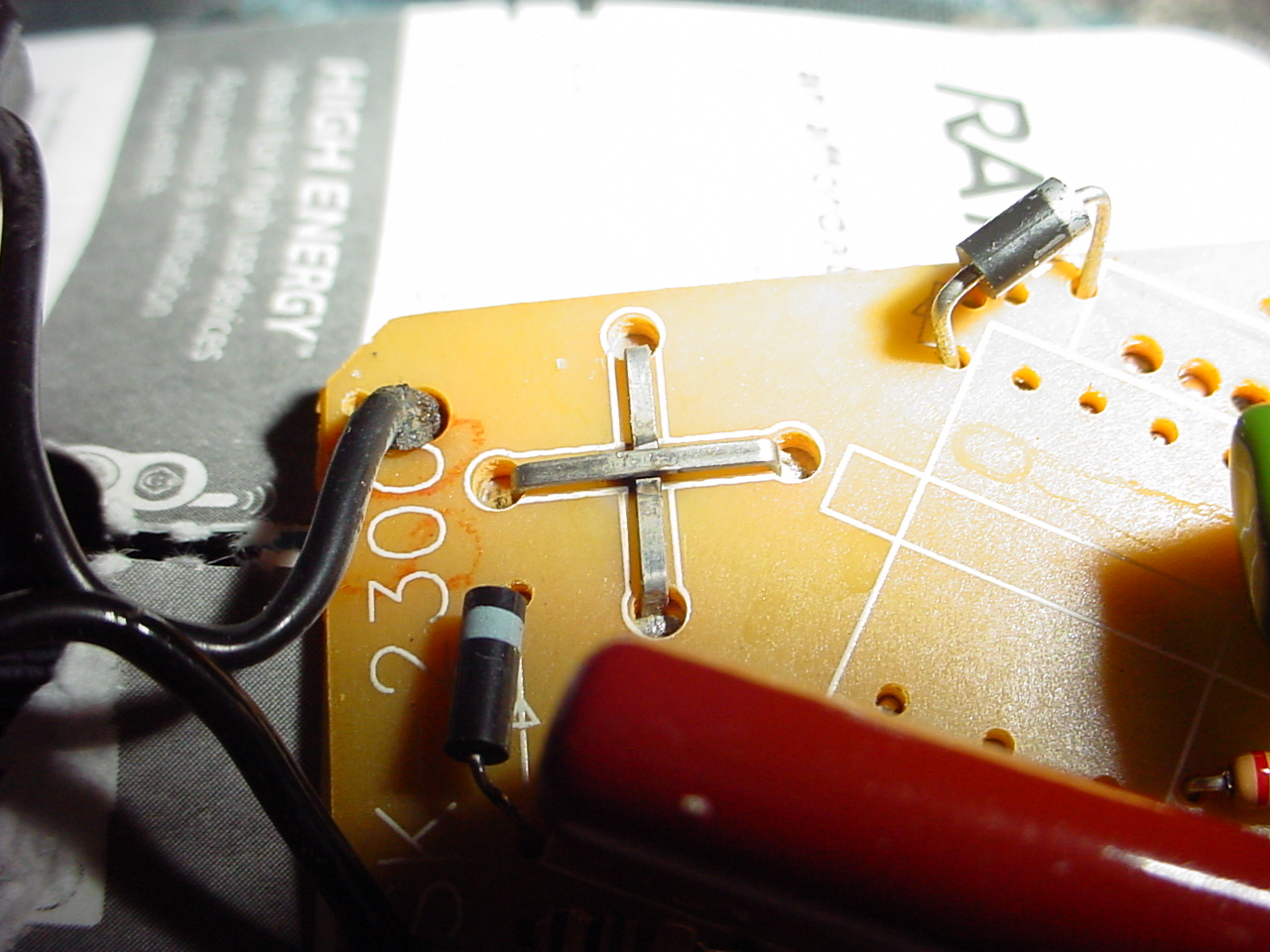

The taser's internal spark gap had worn down, so it was requiring over 850V to fire the spark gap using a 630V capacitor... This was probably why the flyback trafo's secondary started arcing. The capacitor is a champ though.
I fixed my converter and got the taser working more or less like originally, but without the massive E-field interference and with some adjustability in the repetition rate.

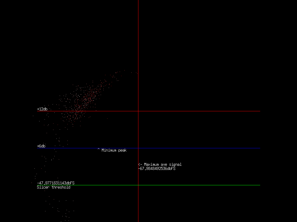

I suspect the lurkers are hungry for pictures, so here you go. Internals of the taser and my P2P converter. I call it the frankentaser.

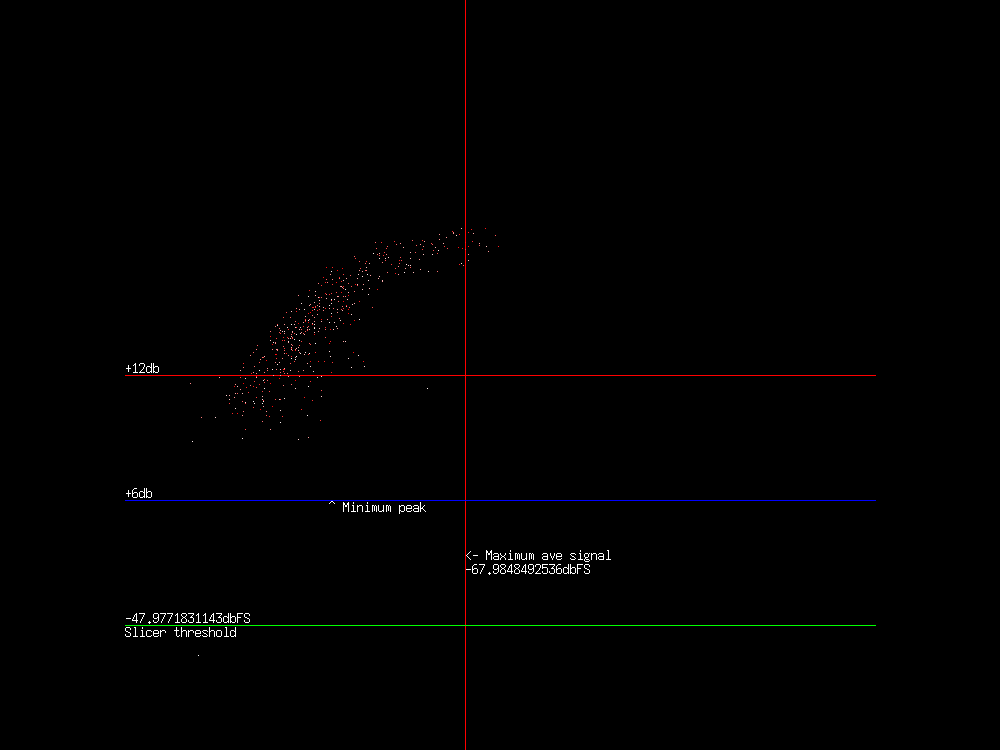

The scatter plot shows the spark intensity is more variable than with the Olympian sparker which has the best consistency. The coilpack is a bit more consistent than the taser, which I think just shows the variability introduced by adding another spark gap to the system.
I added shims to the CRT flyback core to raise the converter frequency and also reduce the noise. Maybe a lot of the noise was actually from core saturation? I think a CRT flyback generally has fewer primary windings and runs at a higher frequency than what I had so that checks out.

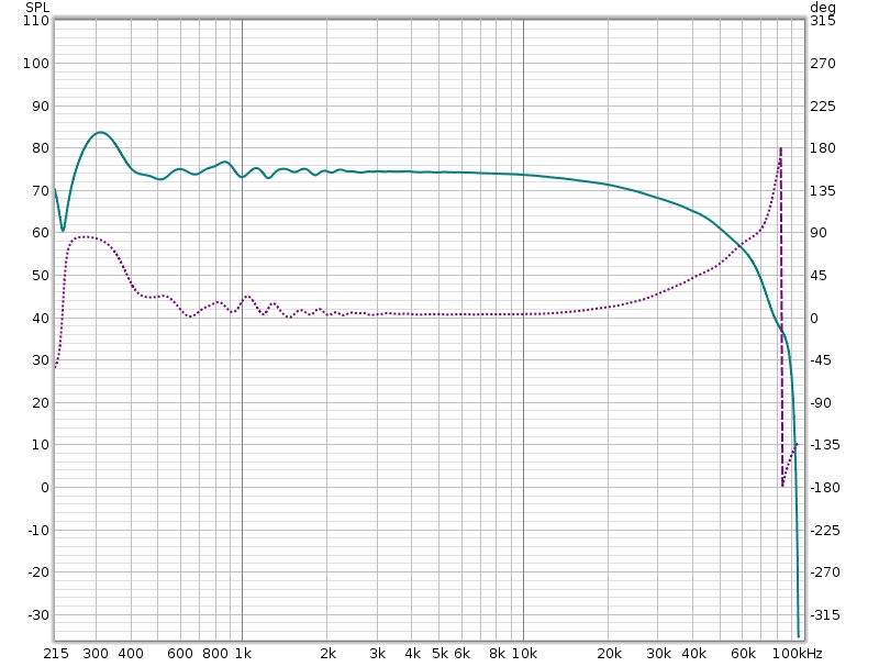

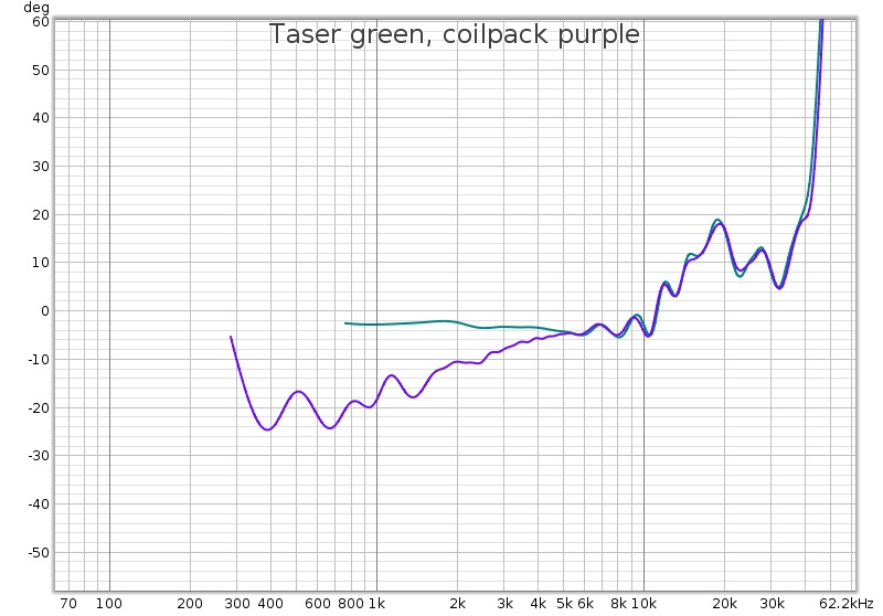

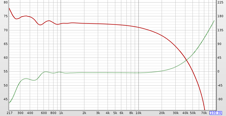

Here is a test of the EM258 with the frankentaser. Everything is very clean, phase shows a 4 degree offset or allpass characteristic, which decreases as I reduce the SPL, so I think I am in the territory of distortion-induced error or imperfect doublets. The allpass behavior seems to show up as the impulse being smeared to the right.
Another sign that it is distortion-induced error is the fact that if I get any louder, the LF anomaly suddenly appears as the impulse under or overshoots the falling root. This corresponds crudely to a peak of about 200mV. So I will note that I should not set my preamp below a certain level if I am recording sparks near 0dbFS.
I'm not sure however why there is 4-5db drop at 20KHz. This seems to be specific to the taser as a spark generator. I can try reducing the capacitor but if the spark had enough energy to limit at 20KHz it should be obvious in the SPL. It doesn't correlate with spark length although I should confirm this with more tests.
If anything the spark spectrum seems to correlate with the HV transformer used. This suggests to me that it is stored energy in the HV coil that may be the main factor at 10-20KHz.
