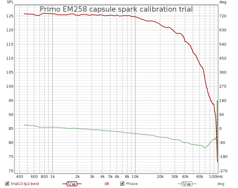

I received an EM258 microphone capsule. This is a lot like the Panasonic WM-61A but with a lower noise floor and probably somewhat worse frequency response.
When I measure the EM258 and EM172 response at the same time with a speaker, normalize to the EM258 response and then apply the EM172 calibration to the result, the resulting response is very flat up to 20KHz where the EM258 response begins to fail as a reference. I had been worried that my spark calibration was giving too much of a peak at 7KHz but comparing with the EM258 does not show any issues with the spark calibration. So I think I am on the right track.
Here is a ground plane impulse response derived from a spark doublet.
I would like to duplicate as best possible your measurement process. More details on the software and process is what I need most.

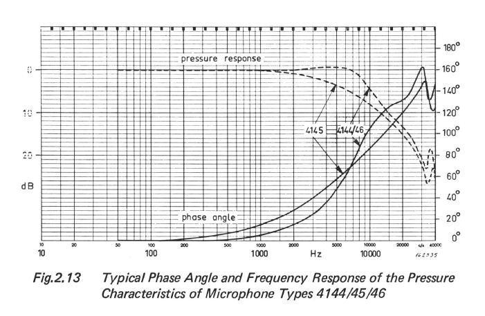

There are several valid questions from the plot. The higher end response doesn't look like what I have seen. The Phase plot should show a resonance near the top of the response curve and then a sharp rolloff in the frequency band.
The plot below is typical except for a 1" microphone. 1/2" and 1/4" will move everything up. Non-metal diaphragms will also have different resonances & tensions. However a lot of this is the physical construction physics.
Typically the capsules are pretty affordable and I'll try to source one or two and compare with my references.

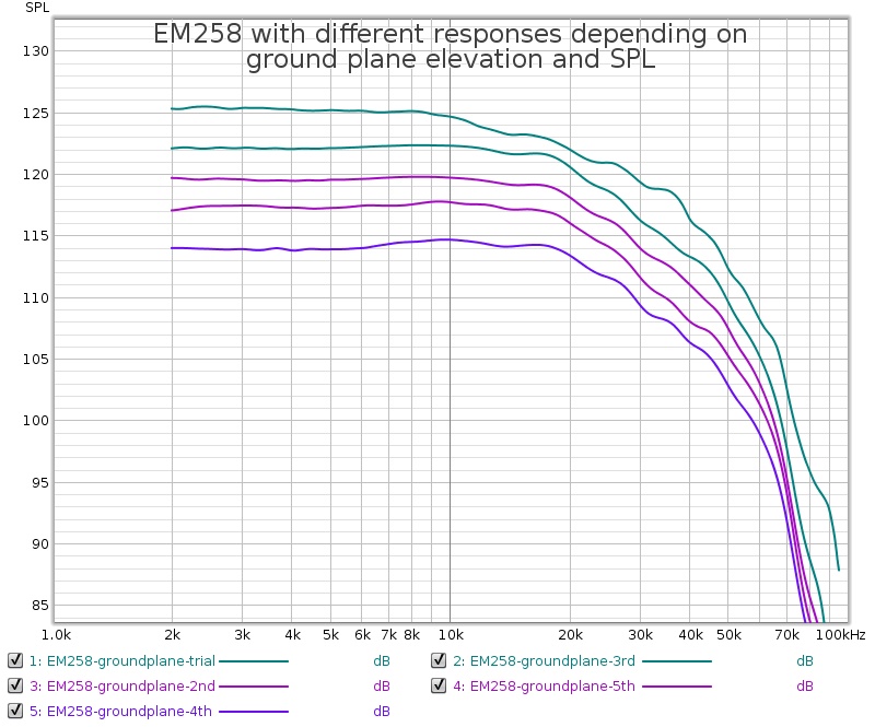

That is very relevant, because I was actually struggling with that part of the response.
1: Lifting up the capsule a few mm from the ground plane causes a very gradual tilt downward in the treble, 1db or so but it changes the look of the chart quite a lot.
2: The bump near rolloff is present but seems to respond heavily to SPL. At higher SPL the bump disappears and becomes more like the gradual rolloff in the chart I posted. Electronic overload seems to be a likely explanation since most of the SPL is at the corner frequency in the acoustic doublet where the observed compression is seen.
Both these effects are seen in the chart in my last post. Attached is a chart with the previous response on top and several other runs below. The response bump gets bigger when I reduce the gap length and/or reduce SPL. I suspect it may interact with interference.

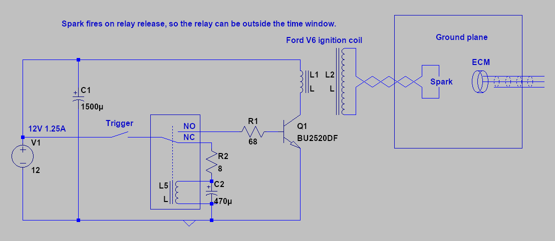

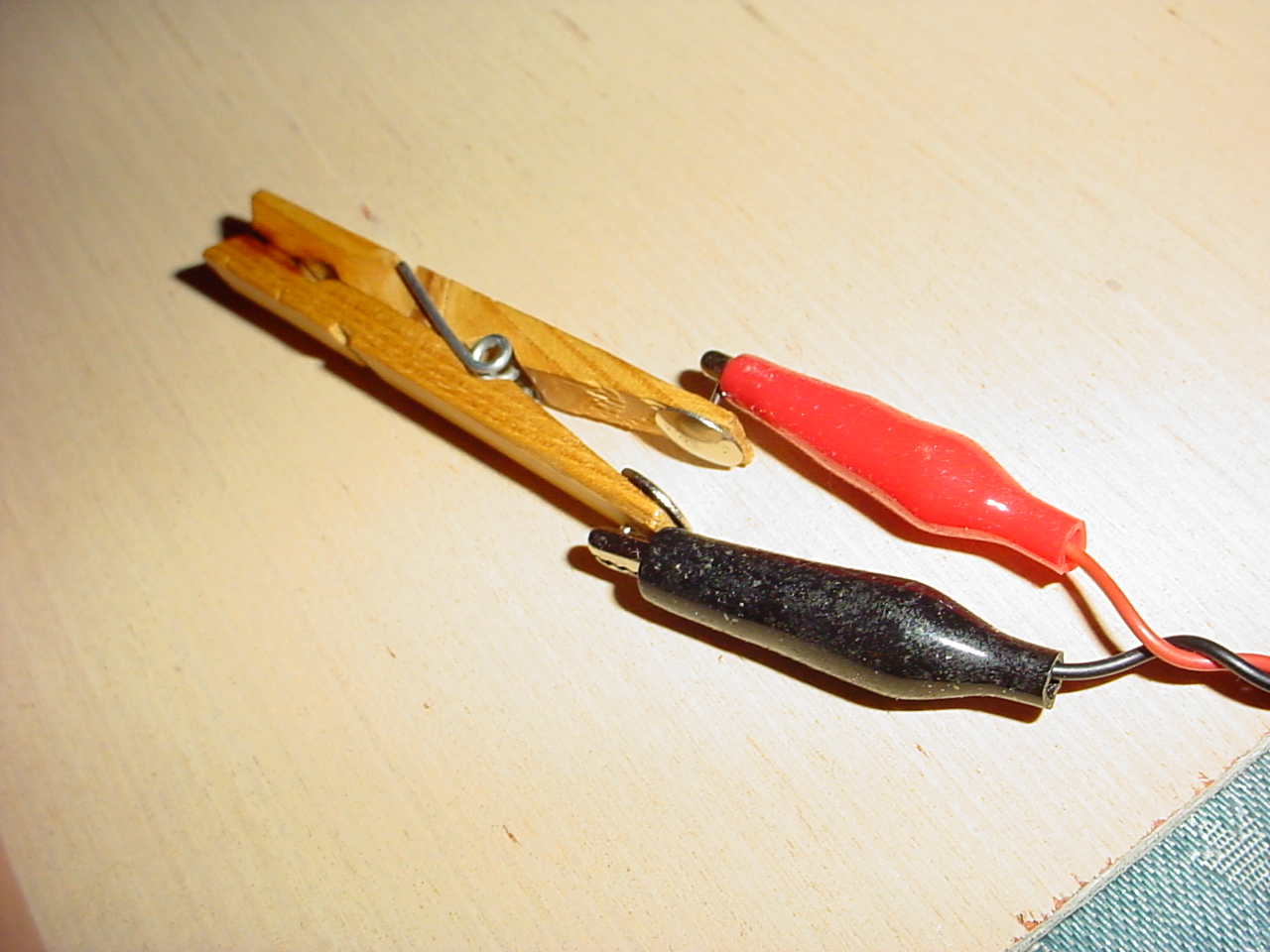

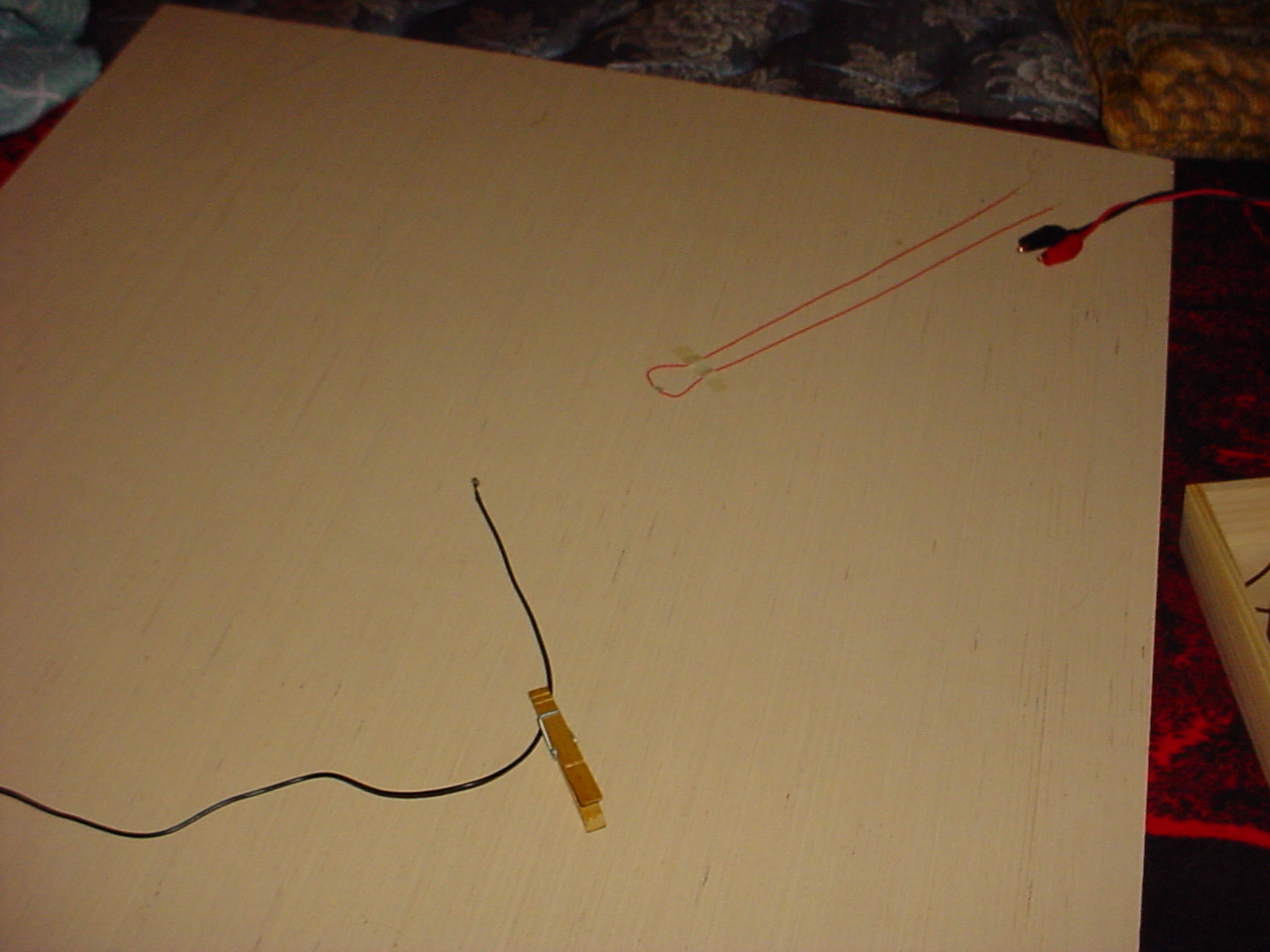

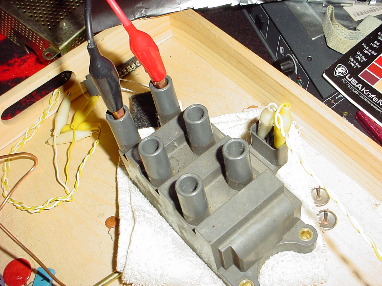

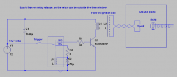

Here is a schematic showing what my spark generator looks like right now. Before I added the relay the most reliable method of not getting spark trains was to manually close the contacts which were two thumbtacks in the tail of a clothespin. The relay makes more consistent sparks with much less frequent spark trains due to switch bounce. Perhaps a reed relay would be best suited for eliminating switch bounce. I wonder if a reed relay could be triggered by the heapdhone output on my computer? Clearly I am stuck in the stone age with this, I'm hesitant to connect the computer to an ignition coil.
It repeats about every 70ms, so I can collect a large number of sparks and average them to reduce noise.
Also pictures of the ground plane setup.

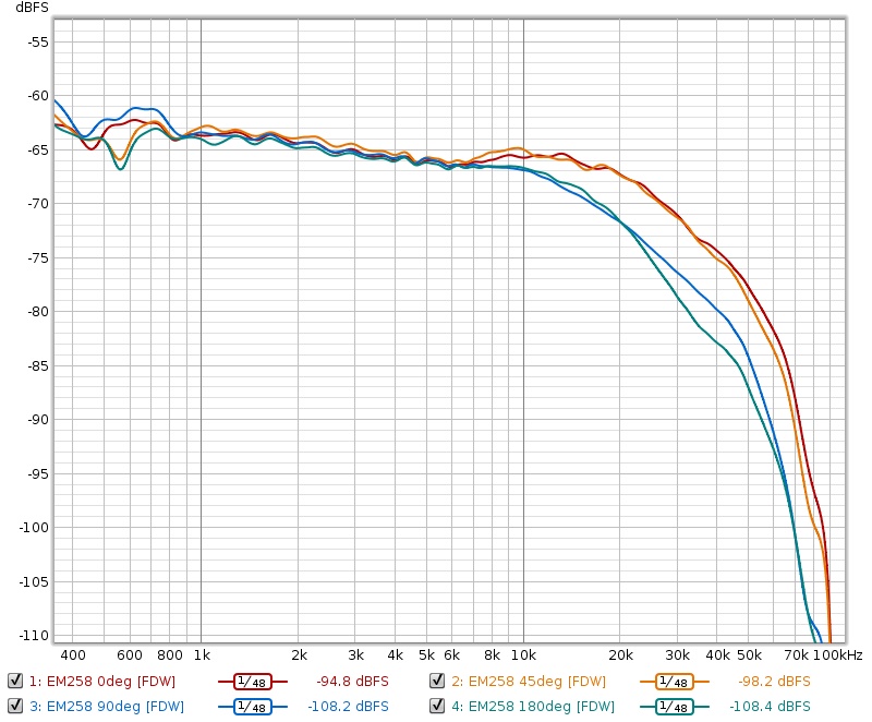

I tried a few different angles for the EM258. Information is in the legend of the attached chart.
The gradual rise below 5KHz seems to behave like some viscous relaxation or diffusion. It seems to correlate more with spark gap length than with SPL or distance. It is very puzzling.
Multi-recording averages have to be time aligned carefully, as any uncertainty in the timing manifests as multi-sample smoothing in the resulting impulse response and may artificially reduce the upper BW.

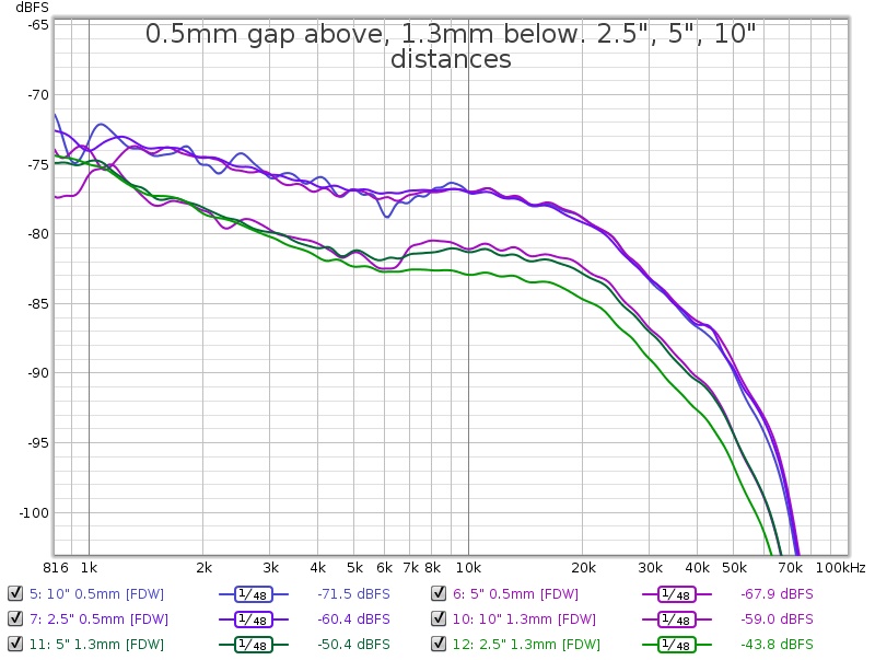

Here is a chart at 2 gap sizes with 3 measurement distances for each gap. Measurements are intentionally overlayed for each gap size.
It can be see that the frequency balance does not change with distance, ruling out acoustic overload as a cause for the midrange rise. The frequency balance does change with gap size, with the larger gap producing more midrange content.
At the highest SPL, compression is apparent at the frequency range where SPL is highest in the acoustic doublet. It's not obvious exactly what is overloading.
Too many tests in the overload region actually causes the ECM itself to drop in sensitivity. I had to come back the next day for the sensitivity to return. I don't know why this may be. Stored charge on the Jfet gate? Temporary depolarization of the diaphragm?
There is no obvious sign of electrical interference as it normally precedes the acoustic wave.

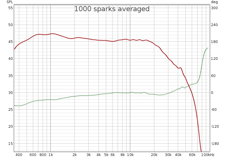

Here is the chart from 1000 sparks averaged together. This was taken with my window AC running.
I also ruled out the 3-ply wooden ground plane attenuating HF by replacing it with an acrylic sheet. It seemed to make very little difference.
So the only thing that really significantly affects the midrange rise is spark gap length.
