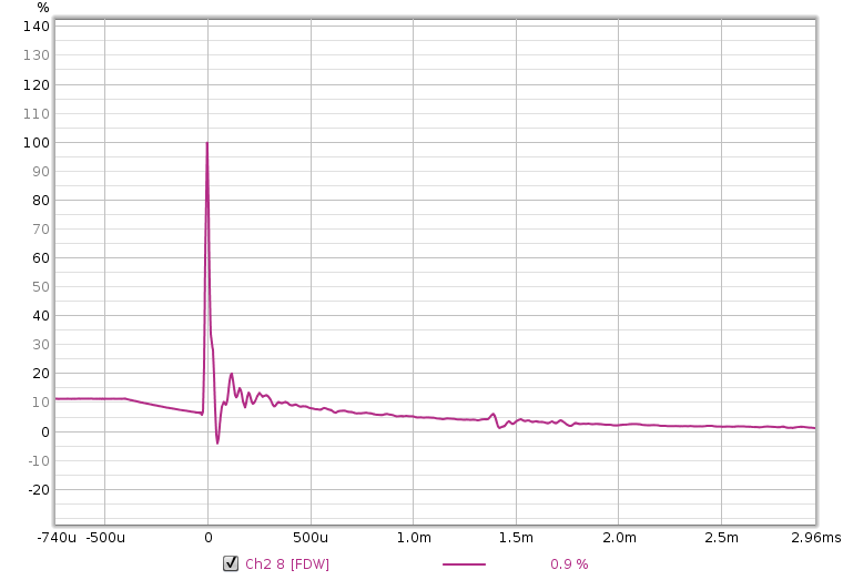

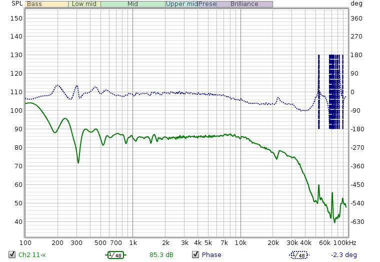

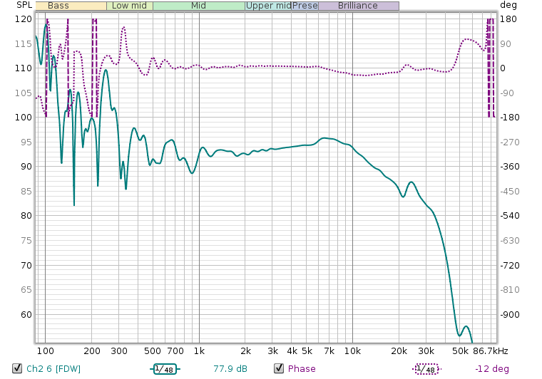

Since the taser is a louder source and less prone to spark trains, I decided to try a free air measurement. I have suspected that the ground plane measurement is still having some effect on the treble. I never get such smooth treble curves in free air measurements. Maybe the ground plane disrupts the circumferential resonance mode of the 10mm capsule.
Tuning was the same story. Reduce spark gap and get the microphone closer in order to get rid of the LF impulse.

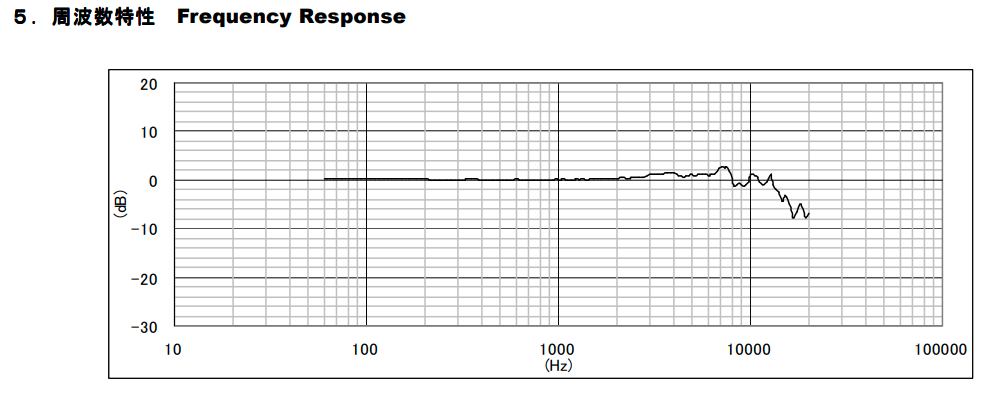

Here is the resulting response. It does bear more than a passing resemblance to the datasheet curve.
The tripod setup could stand to be improved.
It seems the coilpack is out as a spark generator. The taser always seems to give better results, although for a sensitive microphone like this it can be too loud.

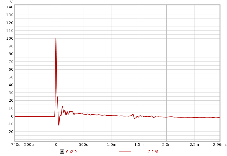

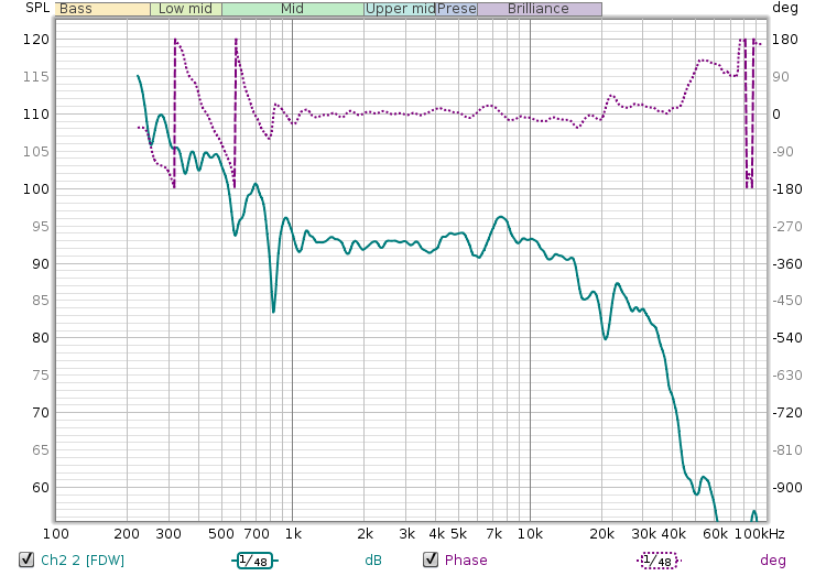

Or, maybe not. I moved the spark further from it's tripod which was causing a reflection. I wonder if Primo's calibration setup had this variation because of their own microphone booms?
Throwing a towel over the tripod has almost no effect. Perhaps the ground plane method really will give the best results here.

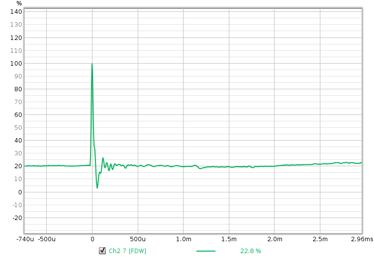

Here are some impulses derived from recorded doublets using a 200Hz lowpass filter. The electrical interference is specific to this EM172 capsule and may apply to similar capsules.
The green impulse is a fairly pristine example.
The red impulse suffers from a LF impulse, which is mostly correlated with spark length in my setup. It is coincident with the acoustic wave. It appears as a voltage shift at the impulse and then a settling afterwards. This mainly happens when the spark length is too long.
The pink impulse is an example of interference from the spark gap in addition to the LF impulse. The interference appears before the acoustic wave since electricity is faster than sound. This mainly happens when the microphone is too close to the spark or the loop area of the spark gap is too large (or one of any number of other possible EMC issues).

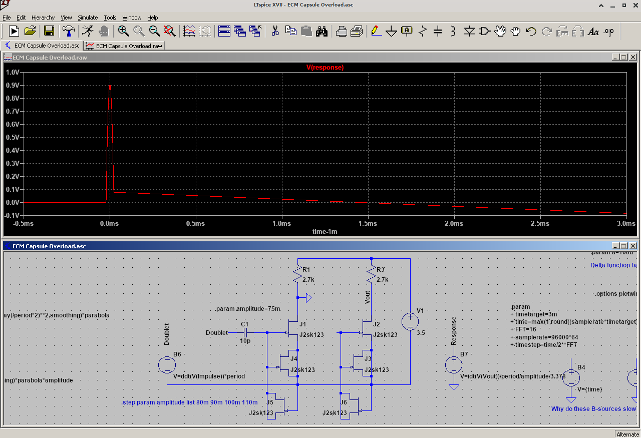

I've made a simulation which might explain the LF impulse. Overloading the internal Jfet of the electret capsule causes the internal diode or gate to conduct, which then turns off and leaves a stored charge on the gate node which slowly drains off.
Compare this to the second attachment above.
Maybe this should have been obvious, but I have not kept track of the voltage sensitivity of my computer mic input so have no baseline for overload.

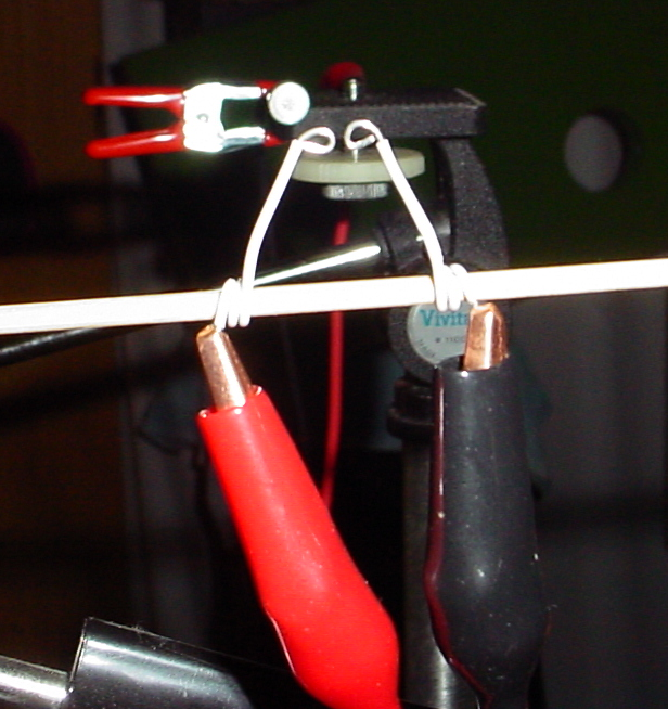

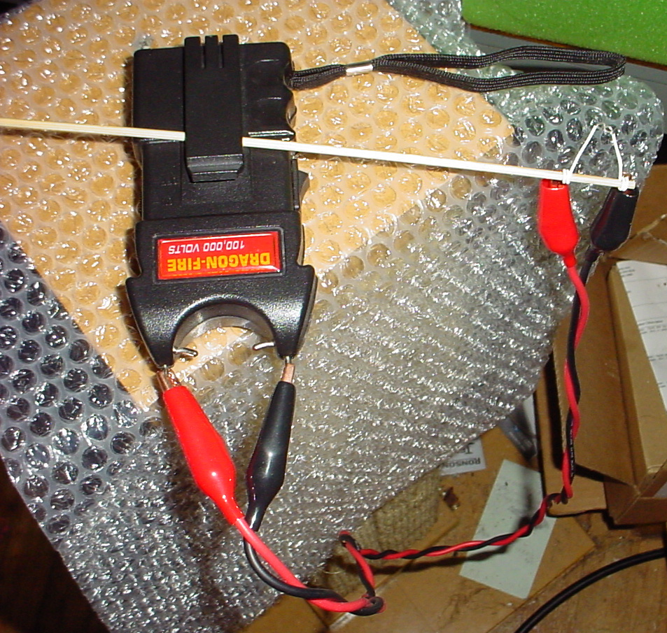

Here is the quickest way to get the best doublet.

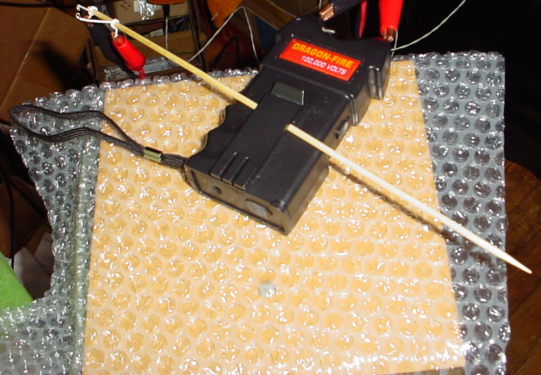

Taser connected with HV alligator clips to a spark gap on a stick. Get the taser going, hold the spark in front of you and walk toward the mic with the mic and spark gap in your line of sight.

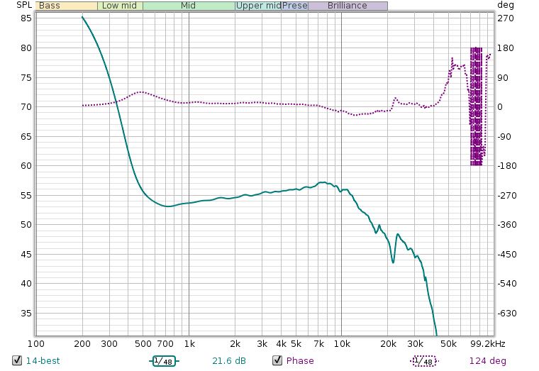

That way you get a range of doublets and you can find the optimal distance with the best SNR.
This spark gap puts one lead closer to the mic, but it could be the polarity of that lead is less likely to cause interference. At any rate I was able to sift through doublets and find the Goldilocks Zone.
The weird thing is that I'm no longer getting the 7KHz hump in the mic response. It's disturbing just how much variation I've seen in that hump through various spark generators. Maybe I just need a good way of aiming the mic capsule.

I should add that you may want to repeat the process multiple times to home in on a good spark length.
The taser cannot be used directly because it emits a fair amount of ultrasonic and midrange noise, and it's shape ruins the doublet response. So the alligator clips allow it to be held away from the mic.
The LF limit does not appear to be set by noise in my case. There is LF noise caused by the spark regardless of SPL or distance from the mic. Now I'm wondering if materials around the spark gap could be electrets or piezoelectric.
