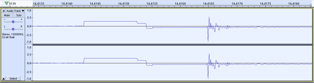

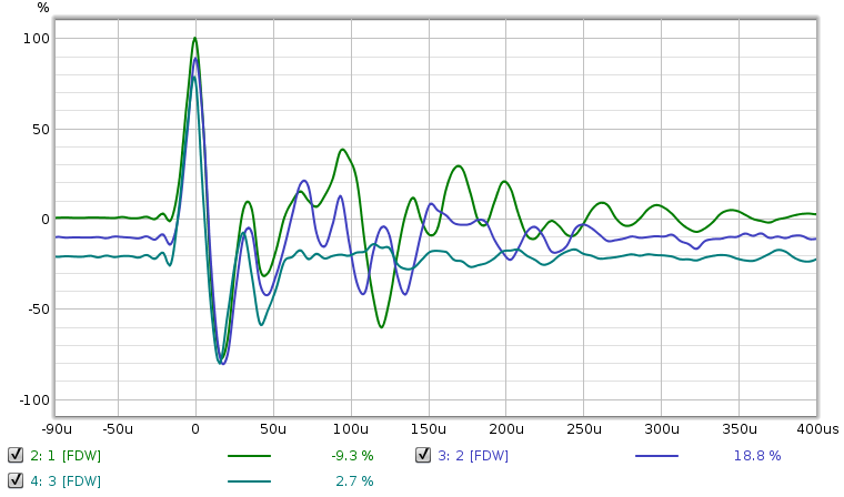

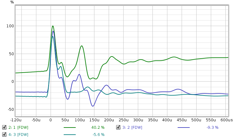

Here is the doublet traces to go with the previous charts. Red is without the Lf impulse, cerulean is with. I did note in scraping Audacity for doublets that the better ones usually had less intensity at the same time as being more symmetrical. But this is not a strict rule as some louder or less symmetrical doublets had good response.

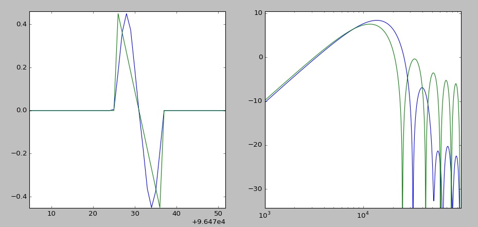

I tried another thought experiment. Take the compression half of the pulse (I found all my original data) invert and mirror it to make a perfectly symmetrical pulse, and compare it to an ideal N-wave of the same nominal length. The result seems to just add to the confusion because the real pulse looks better. The shape of the first lobe looks to hold up through a lot of experiments making me lean toward an empirical fit.

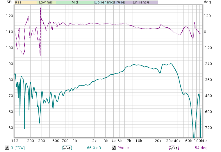

Well here is something unexpected and interesting.
Using the foam U-bend electrodes, I tried recording some more doublets. One reason I switched to the baffle experiments was this electrode started giving me inconsistent results. I was getting comb filtering starting at 10KHz.
Because of the way I stripped the ends, the connection wires broke off at the insulation, leaving very sharp points there. While testing and not getting the long sparks I expected, I noticed blue puffs coming from the broken wires. Corona discharge! The black foam makes it easy to see. I rearranged the alligator clips and it went away. And I think the comb response was due to the corona discharge behind the spark at about the wavelength of 10KHz.
I think another contributing factor may be that I've fired these electrodes so many times that perhaps their surface has worn in, becoming micro textured and changing the spark nucleation. To fix the problem of sharp points and textured surfaces, tinning with solder seems like a good idea. However I don't like the idea of vaporizing lead solder, so I don't think I'll tin at the spark.
Another thing I noticed was the sparks were feathery and I could see 2 or 3 spark trails. And then occasionally one solid, bright spark. So maybe it is actually possible to visually observe when you are getting spark trains and not single sparks.
I added a <1mm spark gap in series with the electrodes, and that did not seem to help much. Which is to be expected since the extra gap is small and pointed and the main gap is larger and smooth. The small gap therefore cannot block any significant leakage from the main gap. So my setup was built to do the exact opposite of what I wanted, but I tried anyway just out of sheer cantankerousness I guess.
However a strange side effect of the extra spark gap appears to be electrostatic interference because the gap is no longer voltage balanced. I thought that I was seeing the electrode voltage in the interference, jumping at each spark in the train, but the mic is 11 inches (814uS) from the spark and the time scales don't match up.
Some observations:

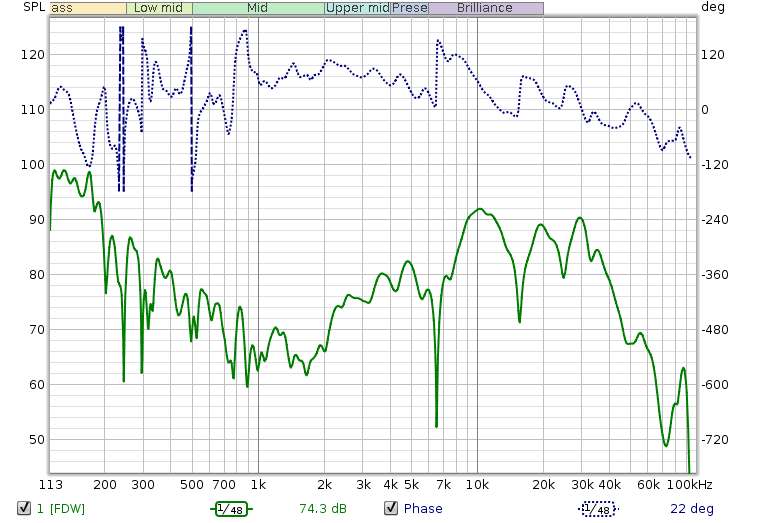

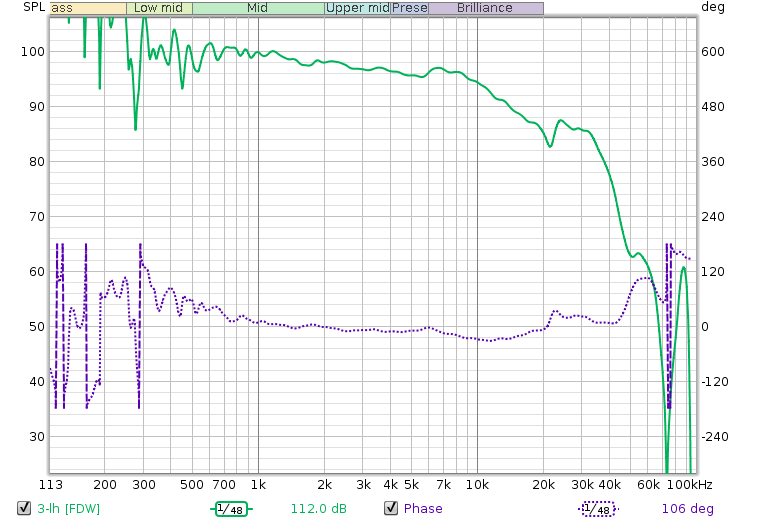

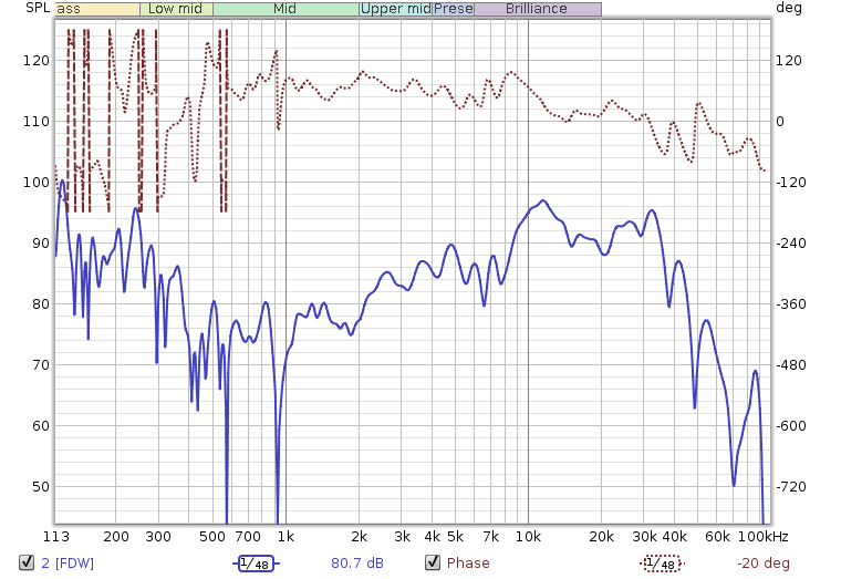

With no resistor, I get 100uS spark trains which result in 10KHz comb filtering (this was not due to corona discharge as I suspected).
With a 10ohm carbon comp resistor in series with the gap, the spark brightness is diminished and I begin to see a series of peaks and nulls in the ultrasonic spectrum. It seems the resistor lengthens the doublet period.
With a 1ohm carbon comp resistor, I get about the same spark intensity but without spark trains.
Green: no resistor
Blue: 10ohm resistor
Teal: 1ohm resistor, with mic placement changed to ground plane. (response of previous mic position is reflected in the similarities in the blue and green traces)
The ground plane mic placement is unmatched for midrange flatness and SNR, but for some reason I get a gradual downward sloping response and rolled off treble using this method.

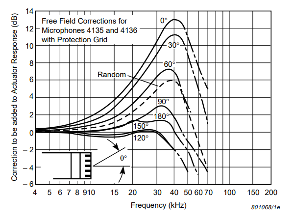

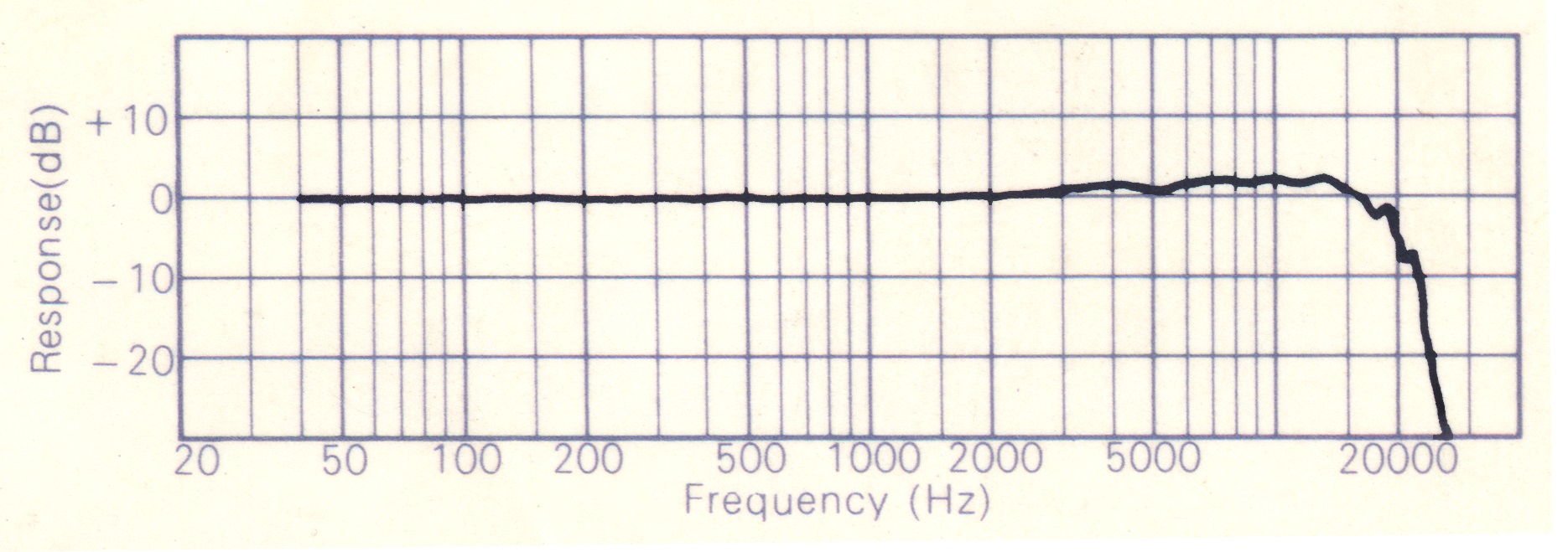

It may be the response. What is the axial relationship between spark and diaphragm? The attached chart will show you the affect of on axis to off axis for a 1/4" diameter mike (or cylinder). Your response looks a lot like the pressure response would. On axis there will be a high frequency boost. If you can, copy the correction curve and merge it with your measurement. I have pressure to on axis correction tables for 1" and 1/2" but not 1/4" yet. On quick visual inspection the mike looks pretty close to 40 KHz.

I try to take measurements on axis but this was a little off, so 20KHz response is a bit worse.
I definitely don't see that trend with this EM172 mic. It rolls off at 10KHz anyway, so it would be hard to spot. It is a 10mm electret capsule.
https://www.micbooster.com/documents/EM172Z1 July 2015.pdf
The effects in your chart seem to be 2 or 3 octaves too high to be causing the response in my mic.
A 1.5db/oct filter is effective at bringing the response back to normal. When I lift the mic off the ground (mattress) by 5/8", it then needs a 3db/oct filter. I'm guessing there is some kind of absorption interaction with the reflected wave.
Using a granite tile instead of the mattress results in all sorts of issues with reflections.
EDIT: The response curves in post #68 are for the raw doublets, before lowpass conversion to impulse response. The step response traces are equivalent to the impulse response of the system.

I'm starting to get a little confused, Demian the plot in post #70 is labeled as a correction to be applied if calibration is done with an electrostatic actuator. The Earthworks write up has the Gefell data sheet with the same note. The spark test is a real acoustical event (as they say). I made a strong effort as in their article to eliminate all reflecting surfaces at the source and at the mic and got very good agreement with the direct incidence frequency response after using the correction for the N-wave nature of the acoustical output of the spark. I have no idea how Earthworks generated the 200kHz BW spark source.

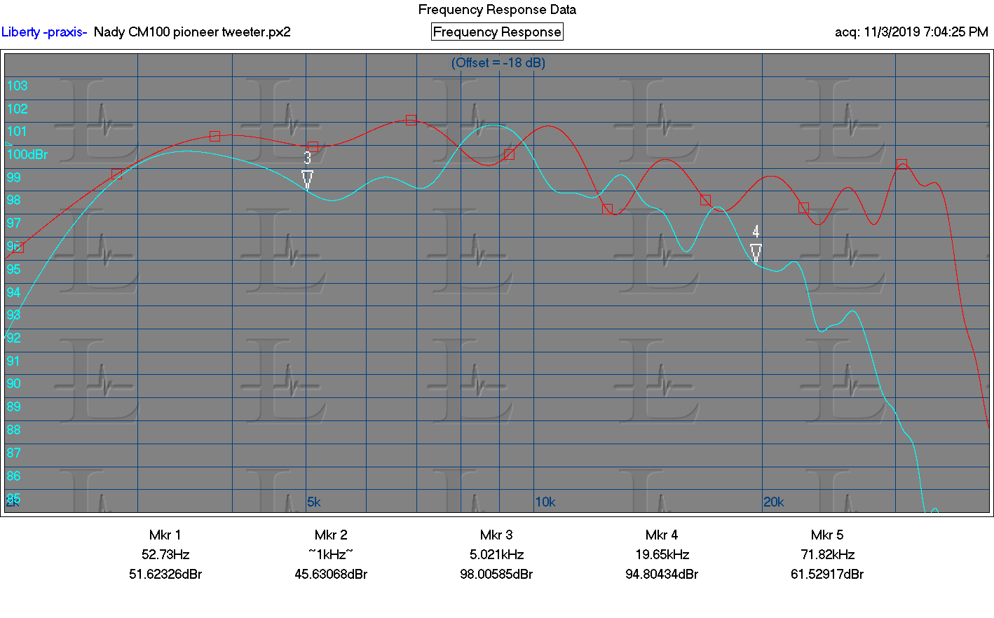

I made some on axis and off axis measurements with a Behringer type mike (Nady) and the response followed the chart quite well, below. Its an important issue when people are using these instruments incorrectly and then making judgements from them.
The Earthworks claims are pretty questionable if they say 200 KHz. However the microophones are only good to 50 KHz, which is consistant with the WM-61's they were using when they started. They seem to have something about their spark generator and gap acoustics. B&K says you MUST remove the grid to get close to 100 KHz because there are resonances behind it around 100 KHz. Also how can you verify 200 KHz? Maybe with a 1/8" mike. I had one but it was defective and B&K wanted $2K to repair it.
