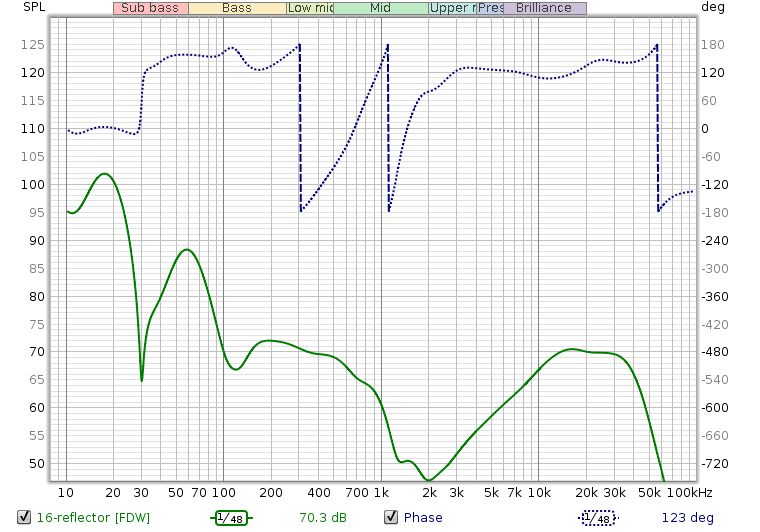

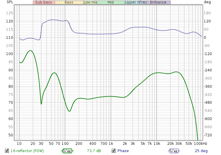

In my measurements I don't see obvious nulls from a bessel function. If they are there they are filled in by some other signal or they are out of my measurement BW. There are a few nulls, but not spaced in the correct intervals for a bessel function.

I put a poster size whiteboard behind the spark to check how similar the primary wave is to the reflection. First picture is the spectrum of the primary doublet with a 5 cycle frequency dependent window. Second picture is the reflection. The stuff under 2k is the residual LF impulse from the primary wave. Inconclusive... But I'm leaning more and more towards the LF effect being overload of something.
In my measurements I don't see obvious nulls from a bessel function. If they are there they are filled in by some other signal or they are out of my measurement BW. There are a few nulls, but not spaced at the correct intervals for a bessel function. It could just be my close up low energy sparks have a higher useful BW. However this is not as viable with other microphones that don't have very good shielding like the EM172.

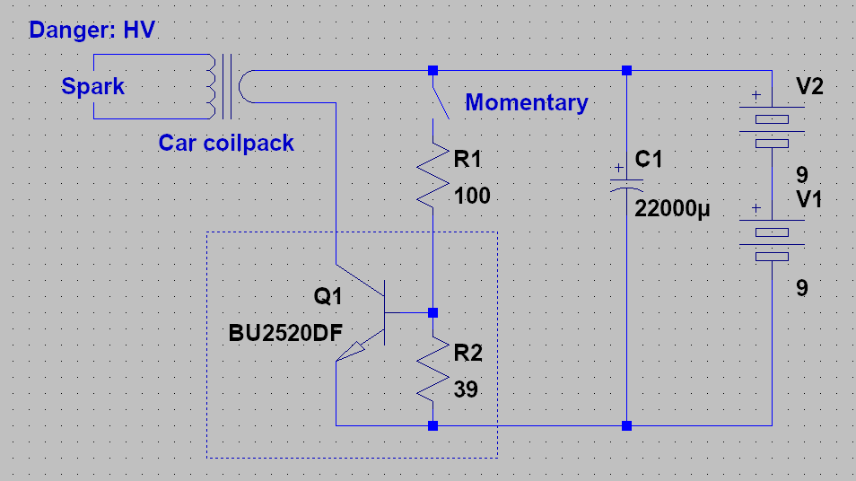

Coilpacks have 3 coils, from left to right. There are 4 inputs, one common and one separate for each of the 3 coils. What you may not see is that the alligator clip to the inputs is bridging the first and second coil inputs, so they are in parallel.
The metal mounting hole inserts aren't connected to anything, many coilpacks don't have them. Grounding the circuit may make things worse as the HV output would not longer be balanced, and this could increase electrical noise.
So in that picture the primary and secondary coils are in parallel.

Sorry, but if you're driving two primaries with the same signal, what you're getting out is two matching signals, not 'balanced' HV.
The common lead of the primaries should be the HV return -- purdy sher 😉 -- at least that's the way it would be used on the engine.

The output coils are isolated from the primary circuit. The output current takes an isolated path through both spark plugs from one end of the coil to the other. Well I suppose it takes a path through the engine block to get between spark plugs, but there is no such connection in this spark generator.
It is balanced whether or not I use two coils in parallel.

The resonance of the secondary of the coilpack appears to be at 250KHz. Primary resistance is 0.5ohms, secondary is 10kohm. I don't have an amp I would trust to drive this.
I found another transistor that works better for triggering due to the internal pull down resistor:

No internal diodes as far as I can see. Schematic of my setup attached.
These GM coilpacks have standard 0.5ohm and 10kohm primary/secondary resistances. (IIRC primary resistance was revised to 0.7ohm or something like that).
It will usually fire a spark on both contact and breaking. So this coil does not rely on flyback effect to generate the spark.

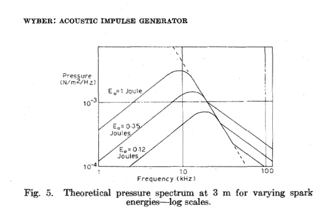

Wyber found that too, the problem is that the physics of the compression and rarefaction halves of the wave are totally different and it is not possible to get a sharp edge on the cooling half. There is also the problem that extending the "flat" part of the spectrum reduces SNR. I see they went way below Wyber and I can't read how they dealt with that issue in terms of getting the mic that close to the spark, ambient noise, etc.

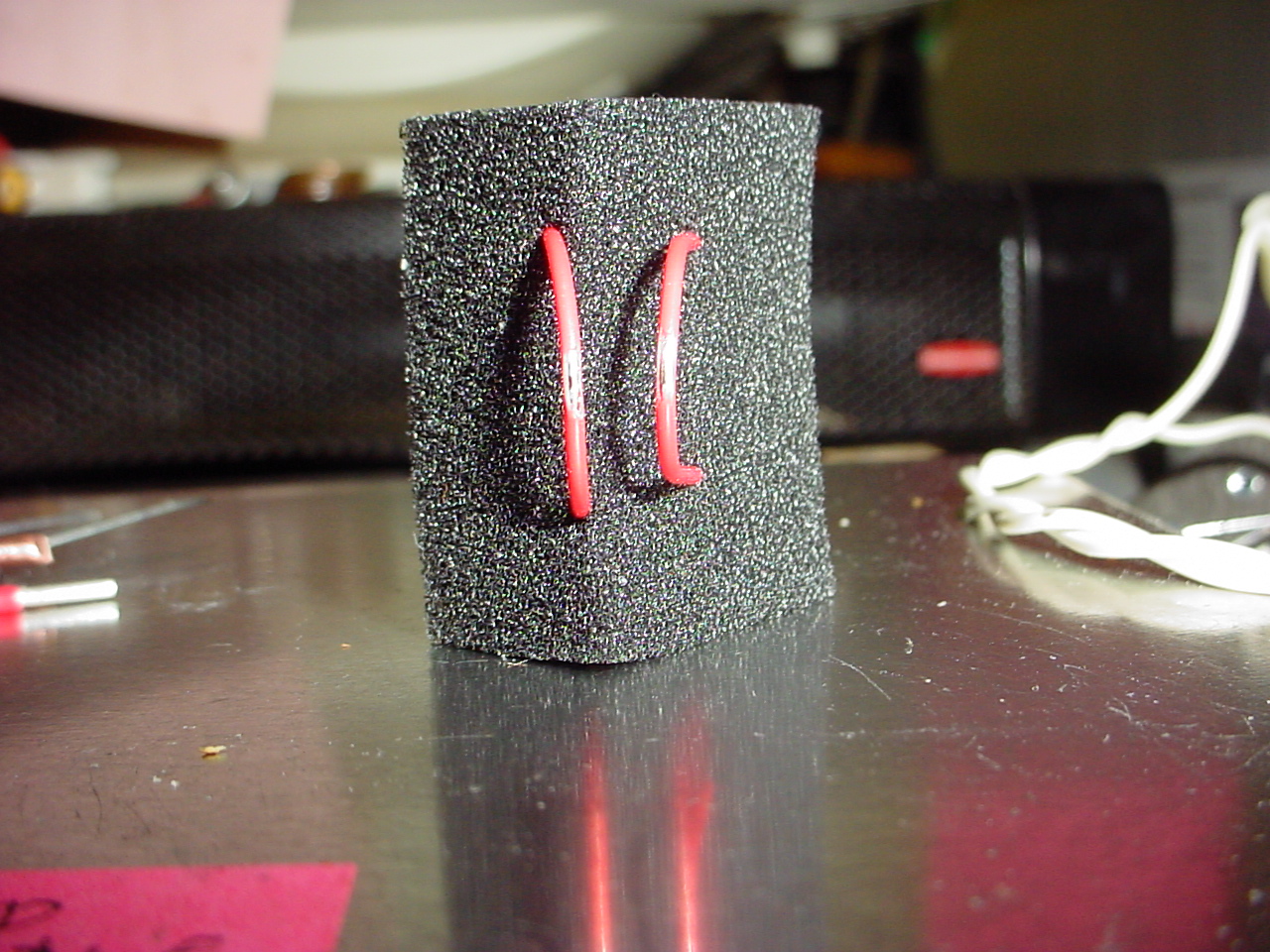

Here is the spark gap I came up with that seems to give good sparks with good consistency.
The spark fires from the sides of the wires which gives a "pointless" electrode surface with minimal obstruction or horn effect to the shockwave. The U shape of the wires seems less prone to vibration and is damped by the foam. The foam is turned so that an edge faces the shockwave to minimize reflected energy. I suppose a corner would be better in theory. I use it with the U bend pointing toward the mic.
The wires are only partially stripped where the spark fires, but it works and is more convenient. Eventually I will see if stripping it fully makes a difference. This is Teflon insulated silver plated wire, nearly impossible to strip.

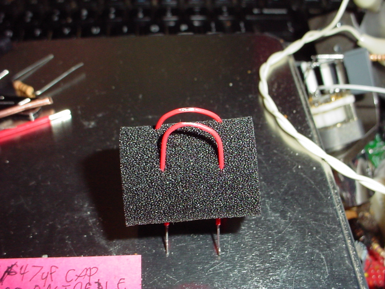

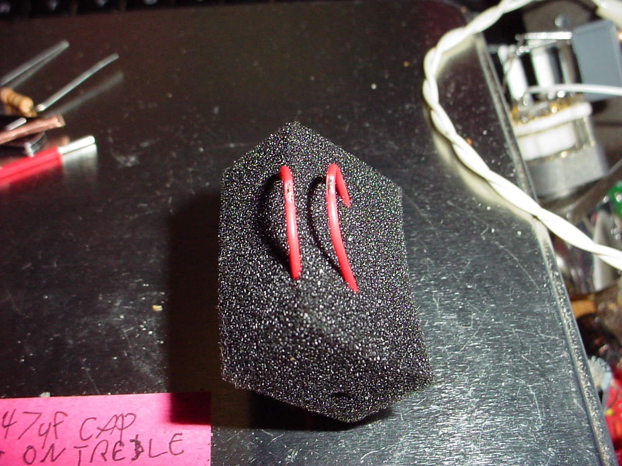

Right now I'm experimenting with U electrodes on the side of a cardboard box. The problem with a discharge near a surface is that the spark tends to jump across the cardboard. So I put electrical tape under the electrodes which helps but still about half of all sparks cling to the surface.
I also suspect that the spark is exploding dust in the air or on the surface of the cardboard which is causing the LF content which is very inconsistent.

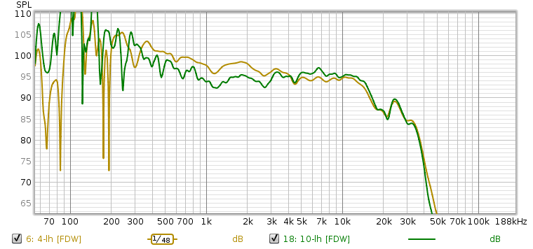

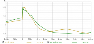

Do you have any time domain pictures? I'm also not quite getting why a point source is not best?
I don't trust my EM172 with time domain since it rolls off at 10k. It is also hard to aim the 10mm capsule.

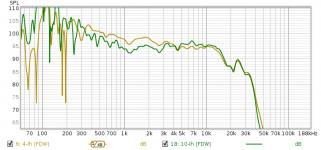

I am trying the cardboard box as a baffle because it improves SNR. I am looking for the setup which minimizes the LF impulse in the doublet response. The spark generator seems to prefer a specific gap size with a specific trigger resistor to get a better chance of having a good SNR in the resulting doublets. I choose doublets which have greater difference between 10KHz and 1KHz content (should be something like 21db based on the datasheet curve). Environmental noise and the myterious LF impulse both impact SNR, so there is an advantage to finding an optimal spark and then increasing the SPL with a baffle rather than increasing mic gain or disturbing the sparker tuning. It's very specific to my rig.
Models of the edge diffraction in Edge show +-1db from 1KHz up, so I don't see the baffle as a primary source of error.

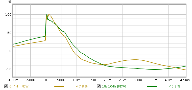

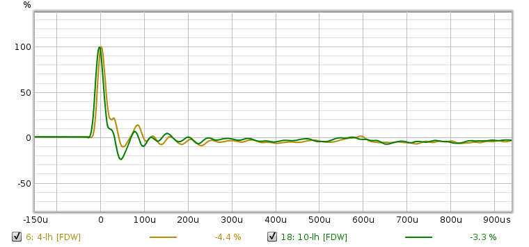

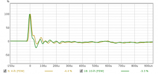

Attached is an example of a measurement with the inconsistent LF impulse (yellow) compared to one without it (green). The peaks and dips are the same, but the inconsistent LF impulse causes some of the doublets to have excessive LF response. Green is closer to the EM172 datasheet curve. There is also step response.
Floating electrodes in theory make the best point source, but the foam doesn't seem to cause any serious differences in response.
