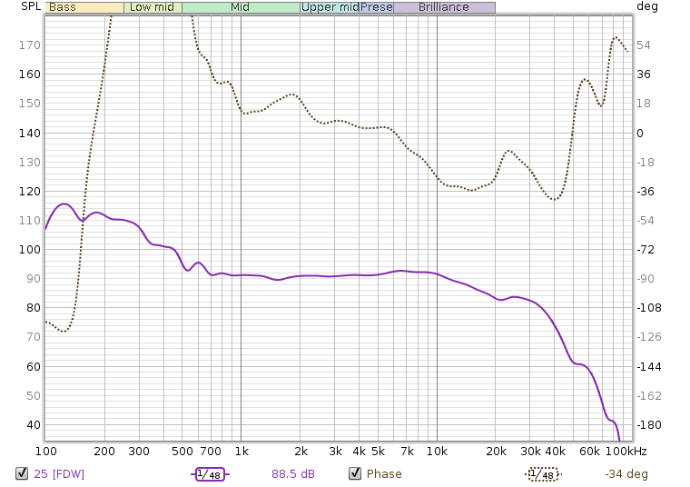

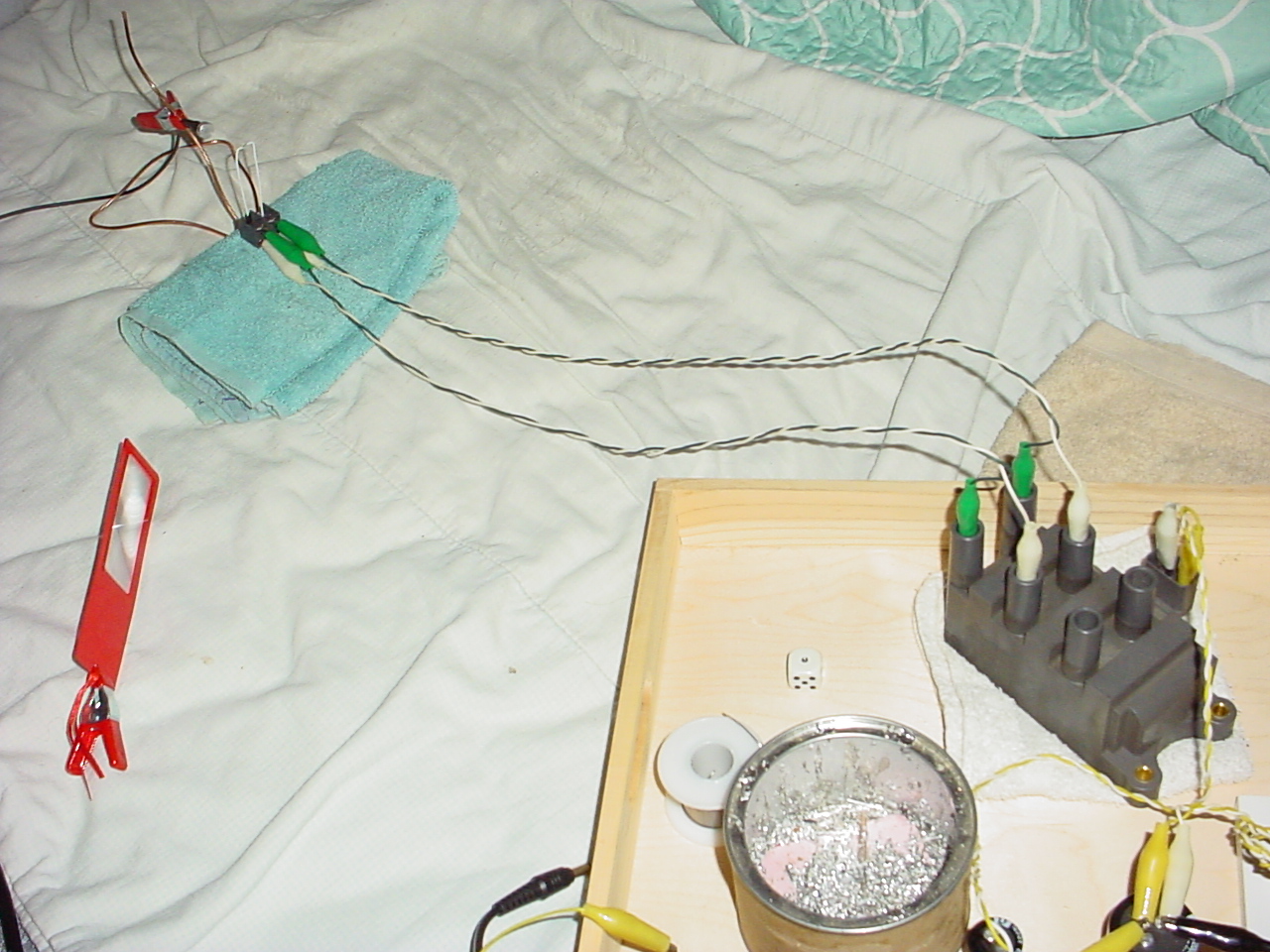

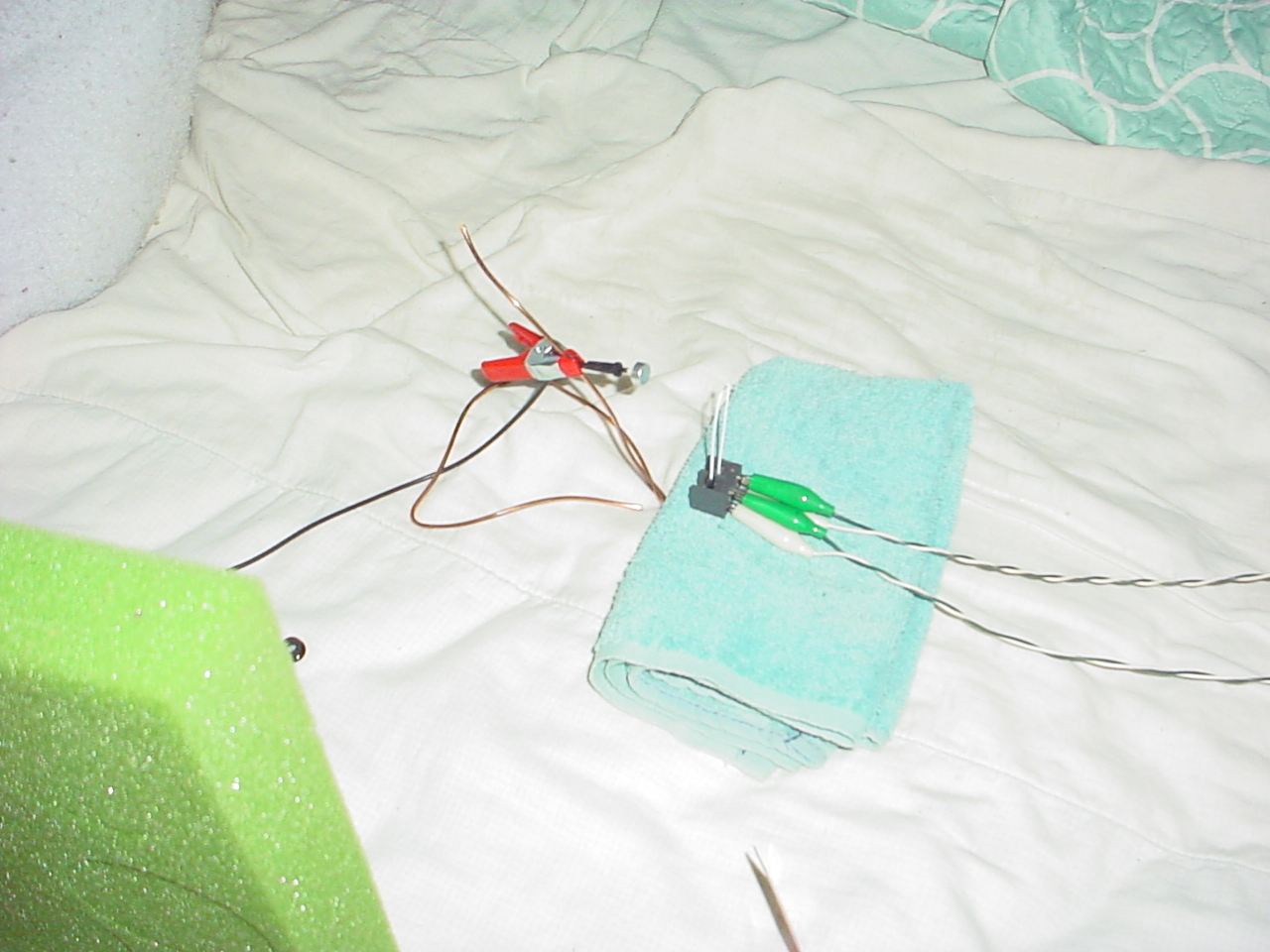

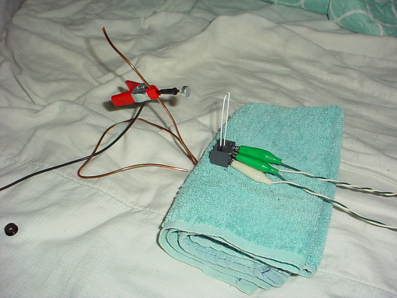

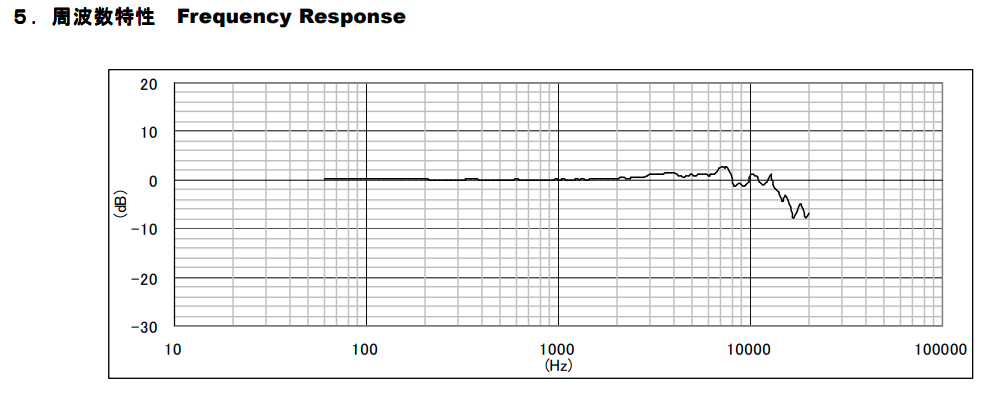

I actually seem to have the best luck just putting the sparker right next to the microphone (1.3") and using a very weak spark with no capacitance. I'm just touching some alligator clips together to trigger, and I suspect the arc drawn between them when the coilpack is loaded by a capacitor is one factor in the spark trains. I did think of using a powerful magnet to quench the arc, but haven't tried it yet.
The result does bear a significant resemblance to the datasheet curve.
The signal level for the close weak spark measurements is about the same as the far strong spark measurements, and the latter tend to have more of the LF problem. It seems to be correlated mainly with spark strength.
I know it is not noise because I can see it in the impulse response as a level shift after the impulse. After the impulse the signal is at a voltage offset and it slowly settles back into the background hum. The shift always follows the impulse in polarity. I can affect it by swapping coilpack polarity, but this does not change the polarity of the shift.
Another indication it's not noise is that it has a clean phase curve. Noise would not.
You would also need to think about near and far field reflections and your window functions etc. I agree thats an odd result. I have several schemes I have been planning to test with two calibrated B&K 1/4" mikes to see what i learn. I have some stuff in the way right now but hopefully soon.
Considering everything under 2KHz is bad anyway, I do not need much space around the setup to keep reflections outside the FFT window. Here is my setup.

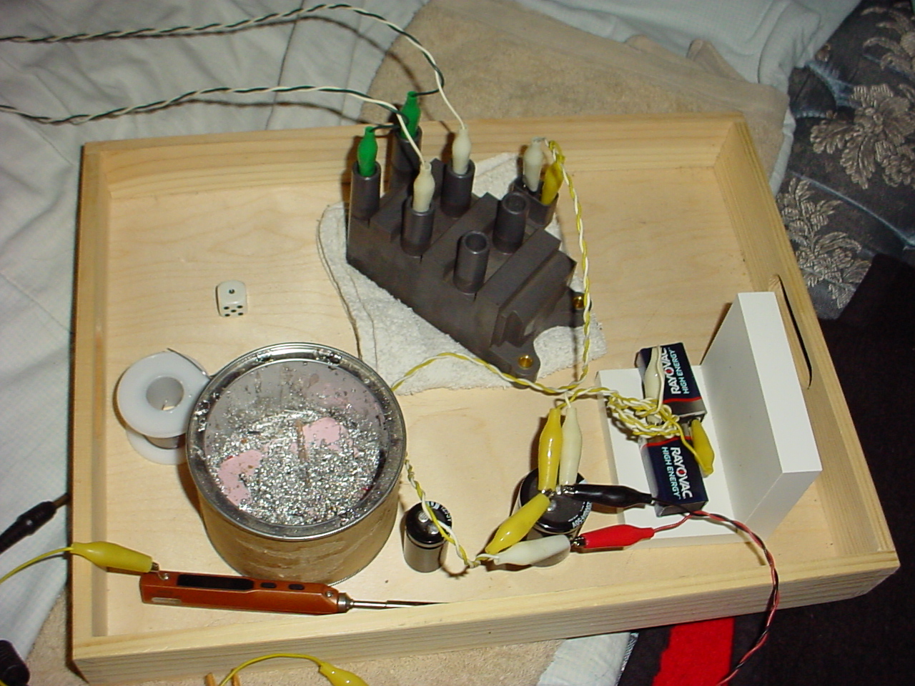

The coilpack is $23 on Amazon. But never use it on your car!

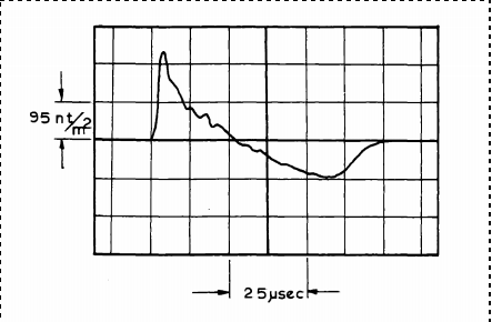

Has anyone succeeded in generating the spectrum from equations 31 and 33 from the reference in post #19? I believe equation 33 is wrong, and cannot produce the spectrums shown in the plots. The cosine term does not have the same roots as the bessel function it replaces.
Substituting the cosine term with this works:
(sin(2*pi*t*time)/(2*pi*t*time)^2-cos(2*pi*t*time)/(2*pi*t*time))^2
I'm not a math genius, I got the idea here:
j1(x)=0 - Wolfram|Alpha

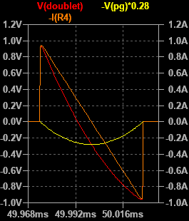

Anyways, here is why it seems there is an impulse characteristic hidden in the doublet. Here is a simulator plot next to a picture from one of the references. Orange is a perfect doublet, yellow is an impulse, and red is both together.

One comment, I usually ignore the low end because most omnis are fairly ideal pistons down to their low limit. I've played a little with medical pressure transducers, one in particular from GE that is dead flat to DC and goes up to 3500Hz or so. It also is calibrated (gauge or absolute). It works as a low frequency microphone but at very low sensitivity.
