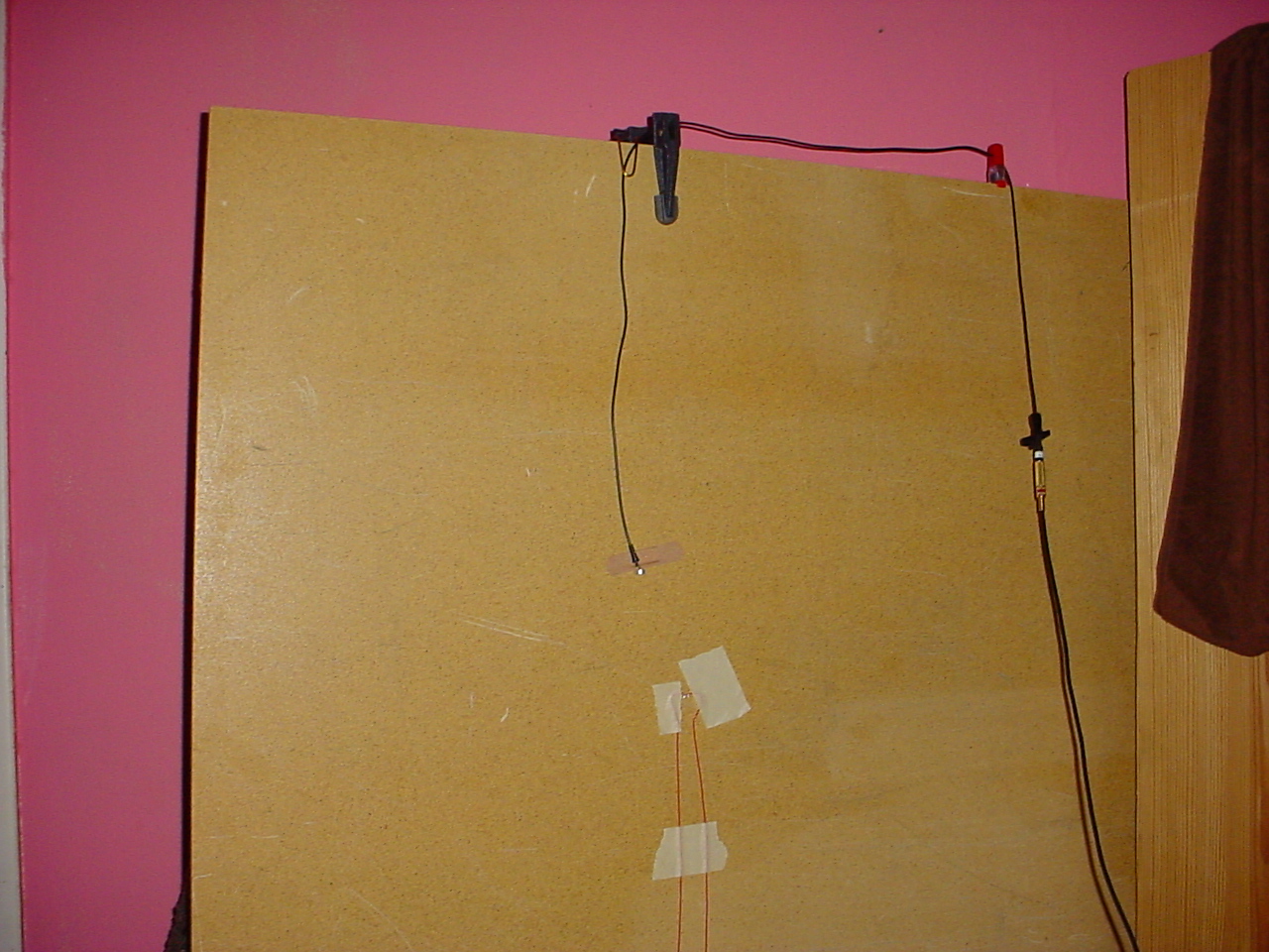

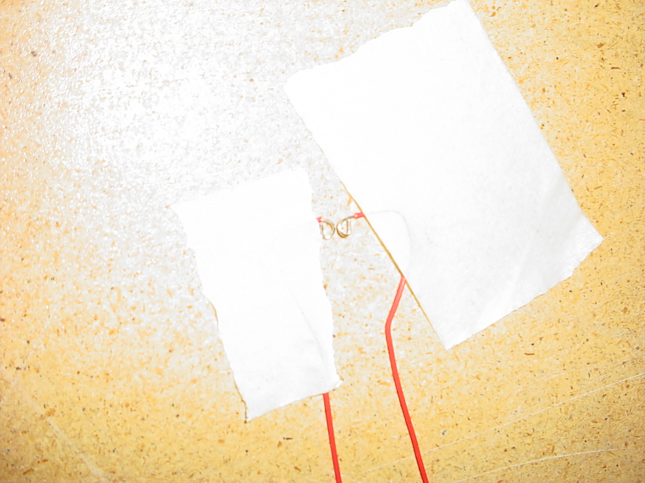

Okay, rate this ground plane.
Pretty good. I do not have a sense of the scale. And there may be a reflection from the C Clamp but you should be able to see that on the impulse waveform at the appropriate time/distance. You should then be able to window that out and focus on only the free space time. It will behave as a free space because there are no local reflections. Yo can actually raise the spark off the surface to get a sense of directionality.
Do you know what voltage you are getting for the arc? its always confusing to look at peak voltage and peak current. On the surge generator it was 6KV at 3KA which translates to 18 Megawatts. However that only present for a brief instant. (BIG noise when you do arc.)

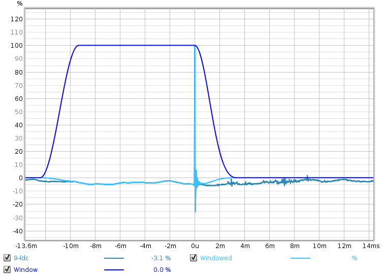

The spark is about 14.5 inches from both edges. 1 inch is 74us so the edges are 1.073ms away.
I have REW set up to do a 15 cycle window. This means that for 10KHz, the window is 1.5ms (750uS before and after) and for 1KHz, it is 15ms and so on. This gives more accurate LF information than a fixed window, while excluding reflections at HF according to a fixed octave resolution.

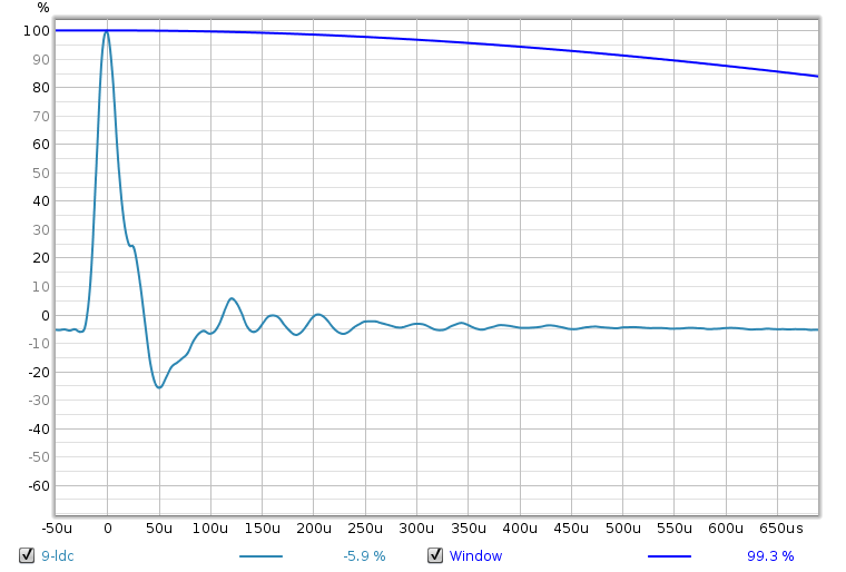

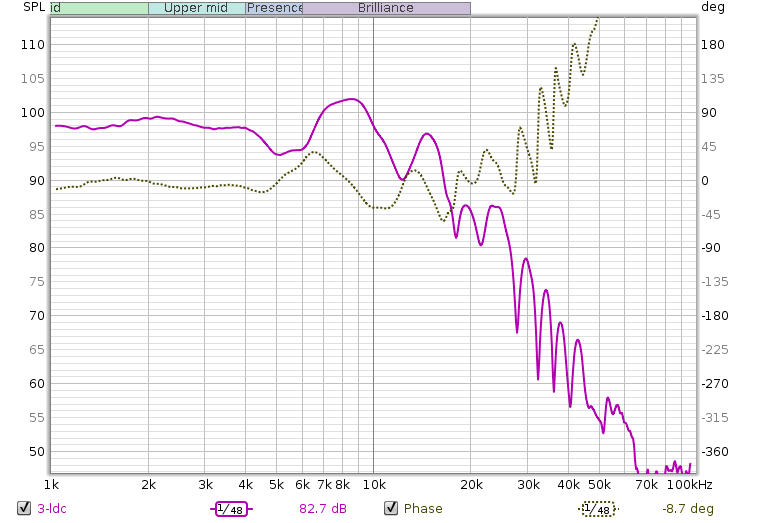

Here is a taser with the ground plane (now it's a baffle I guess) spark but with the mic 3 foot 9 inches away on a tripod to get the loudness low enough for the mic.
Unlike the ignition coil sparks, there definitely seems to be repeating nulls in this measurement which fits with the research that higher power sparks have less BW. But really I'm not sure the the taser is powerful enough that the BW limit should encroach on audio frequencies.
The window here is set to 1ms, which is one inch shorter than the distance to the baffle edges.

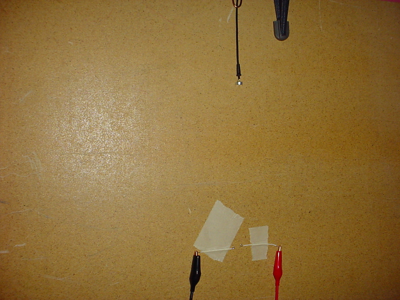

I switched to smaller alligator clips and positioned them more radially and that made a big difference. I already made the same change on the ground plane version of the measurement without results. I think this is just because in the ground plane measurements the clips were not positioned where their reflections would hit the microphone.

When I started with the ground plane setup and the taser, I had a significant LF impulse ruining the response. The length of the gap affects the LF impulse disproportionately. The mic distance has a slight effect in comparison. I suspect that the LF impulse is related to SPL overload as it is coincident with the acoustic wave, and increasing mic gain in the computer doesn't improve it. Therefore the spark length matters most because increasing the gap increases both joule energy and the acoustic efficiency of the spark.
S as I reduce the gap length and move the mic closer and closer, the LF impulse diminishes and the curve is accurate to lower and lower frequencies. The mic is about 5.5" away and the gap is <1mm. Since the taser has more energy, it needs a smaller gap to match the coilpack.
When the mic is this close however I run into another issue. Electrical interference shifts the signal before the acoustic wave hits, at the moment the spark fires. I was using my smaller alligator clips as they make less reflections, but they are magnetic steel. I switched to my larger alligator clips which are copper and also twisted pair, and this interference mostly went away. So it could be magnetic noise or it could be related to something else I shifted when doing this. Maybe even antenna geometry of the leads.
So the obvious step forward would be to finally ditch the alligator clips.

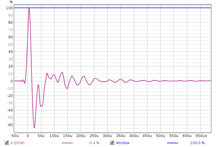

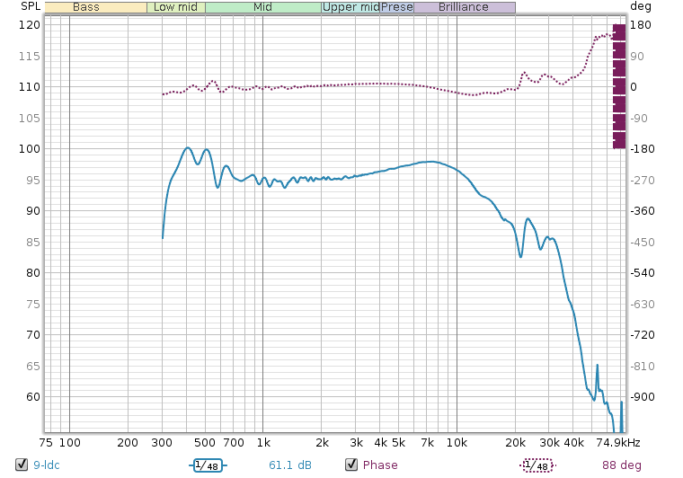

Here is a test. Response, window, impulse, and then doublet.

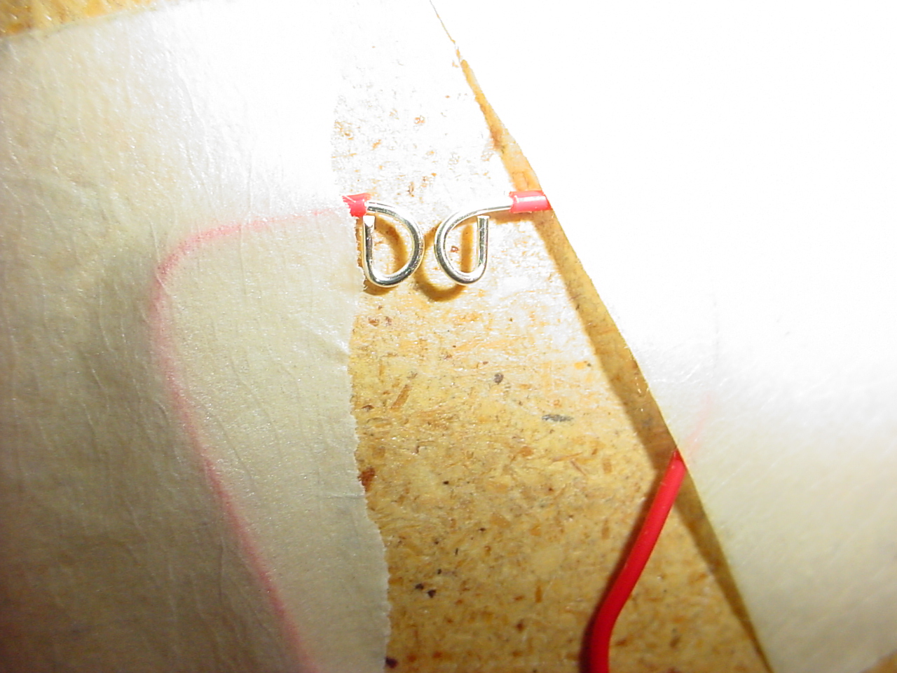

Photos.
Some things I would improve about this setup:
1: The wires are spaced apart to prevent arcing before the gap. Ideally these wires would be like the 20KV wires on the alligator clips, and twisted together in the same way to reduce interference from the huge spark current. I don't want to destroy my alligator clips to do that though.
2: The tape is a bit sloppy, creating some resonant cavities in theory.
3: The mic is not exactly parallel with the spark, but maybe not so important for a <1mm spark under 20KHz.
