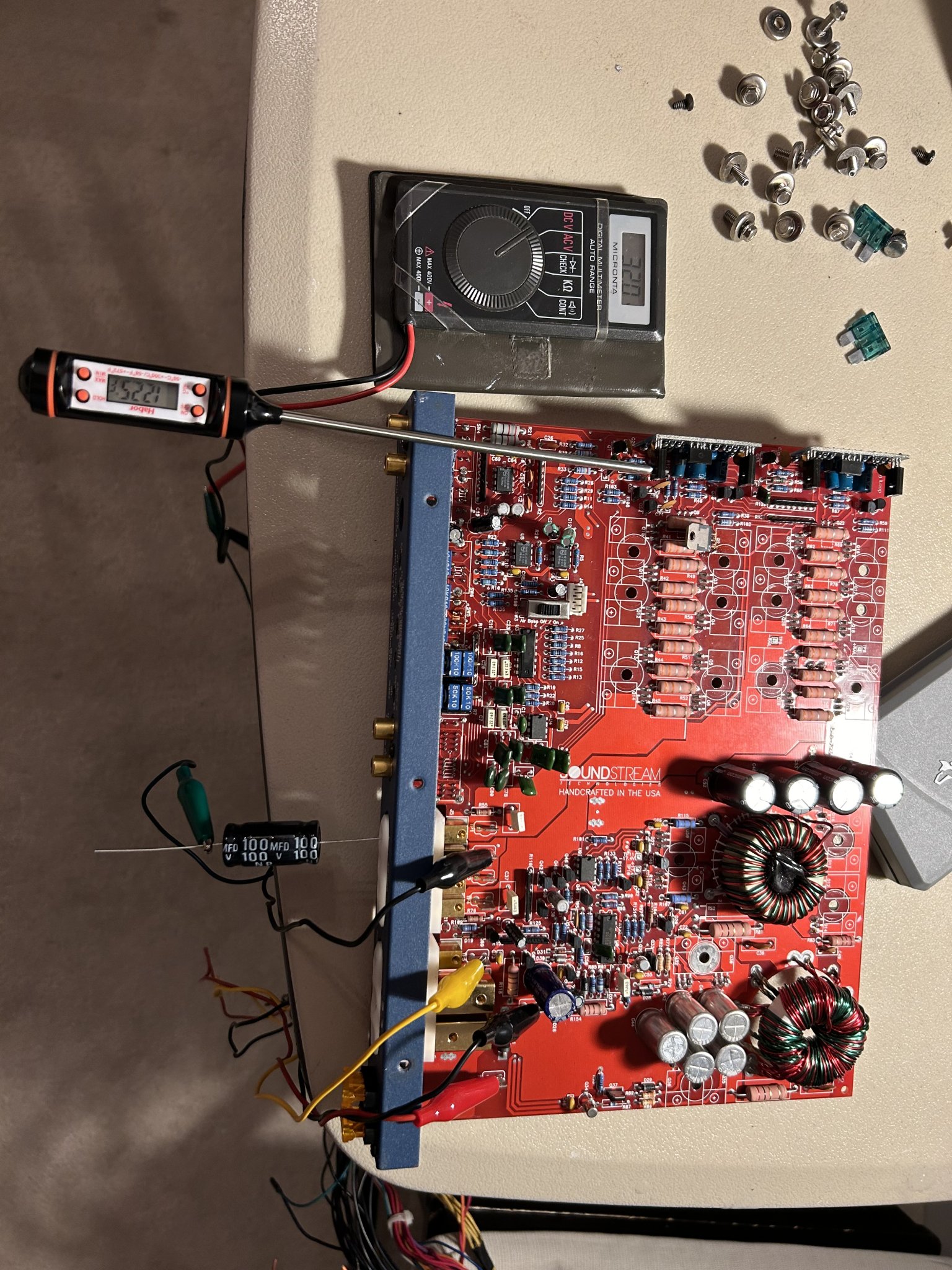

Soundstream Rubicon 502 with DC voltage in right channel
The voltage increase was immediate. I was alternating the leads of the DMM between the left and the right channels and after about 3-5x going back and forth it then showed the 32Vdc. On the previous check seconds before it was -8mvdc.
If I am to leave it running Im guessing I should put the circuit board back on the heatsink. Also the last time I let it run over 30secs it began smelling like burning plastic and I had to shut it down. The transistors on the driver board start heating up and giving off that smell.
Now that Q2-Q6 have the base and collector shorted it immediately goes to 32Vdc. I tried turning it on/off over 10x hoping it would stop being shorted and therefore not have the 32Vdc but it didn’t happen. If the same pattern as before holds true then reinstalling and then removing Q2 should stop the short temporarily to perform your audio test. My fear is blowing another speaker. As you may recall the bipolar capacitor is not filtering out the 32vdc so it wont protect my speakers.
I haven’t bought an oscilloscope. Do I need one now?
Something interesting happened. I reinserted Q2 turned it on and off and removed it and turned it on. The 32vdc didnt appear at all but after 30 secs still had to shut it down because of the overheating transistor on the driver board. After shutting it down the base and collector pins were shorted.

Yes the caps are large. 100uf 100v caps. If dc passes through them even for a few seconds they will fry my speakers. I tried again with the bipolar cap and gave it 20secs until the driver transistor got to 180F. Still was putting out 32vdc through the cap. Im attaching a pic of my test setup in action.

The output transistors dont heat up. Its the one transistor on the driver board that the thermometer is touching in my pic. This didn’t change after swapping the driver boards so it’s not the transistor nor the board.
Thank you Perry. If this helps, I traced the transistor on the Driver Board to find what it's connected to in the schematic for the amp. The transistor is a C3789. Here is the datasheet:
https://datasheetspdf.com/pdf/769778/SanyoSemiconDevice/C3789/1
The Emitter is connected through a 49ohm resistor to the driver Board Pin #1 (Vee). This pin is then connected to the amp's -rail voltage.
The Collector is connected directly to Driver Board Pin #2(Drive-). Which is then connected to the base leg of all Q10-Q14 transistors (the complementary transistors to the shorted group Q2-Q6).
The Base is connected directly to Driver Board Pin #3(Base-). Goes nowhere according to the schematic.
