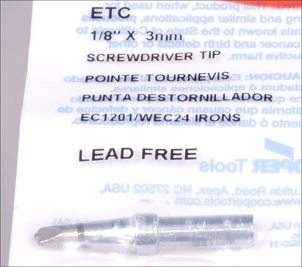

That’s a nice Weller but over my budget and I guess too new of a model to find any good deals on ebay. Im going for 63/37 because it’s what I found on ebay for a good price. Talking tips… any particular type or size you recommend? I noticed the barevids youtuber uses a bevel tip. Most irons come with a conical tip. I use this tip cleaner. https://a.co/d/9sQhvrS

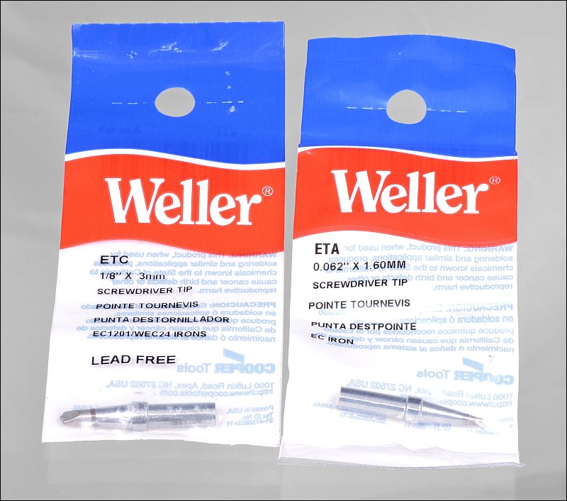

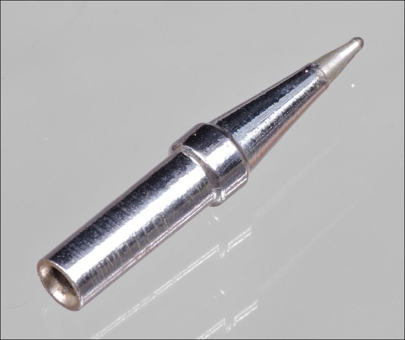

Tips with sharp edges can damage the board. I used the 'screwdriver' tips but they have rounded edges. Look at the ETC tips below. The bump on the tip is nothing more than solder from when it was tinned.
With beveled tips, it's sometimes difficult to get enough surface area in contact with the solder joint, even with additional solder. Of course, it's all about personal preference.
Conical tips with a sharp point have the same problem as beveled tips. The ETA tip in the photo is the finest point I used. I generally used the ETB or ETC tips (mostly the ETC), even for SMD work.
That looks like the right cleaner but the stuff I had was beige. Look up the MSDS for it. It will tell you what you have.

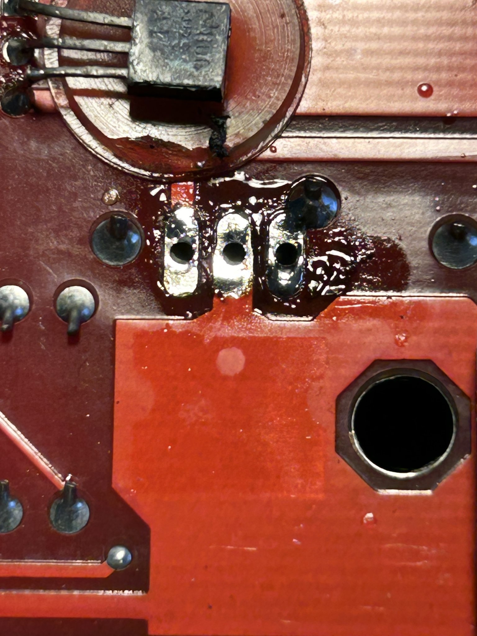

A strange thing happened after I removed the first one, Q2. The base and collector pins are no longer shorted on the board for Q2-Q6, but also the removed transistor is not shorted. For kicks I reinsterted the Q2 transistor snug but without solder and I no longer detect any shorts on Q2-Q6. Could the short have been caused by the heatsink?

It's risky to test off the heatsink. It's done all the time but you have to be very observant/careful to ensure that none of the heatsink mounted components overheat.
You need to remove all of the old compound and replace it.
Just use good judgement on the screws. Use a nutdriver, not a ratchet. The screw will stop turning fairly suddenly. Just snug it a bit more after that.
Use dry paper towels to get it off. That should be good enough. All you need to do is get it clean enough to ensure that there is nothing that could prevent the transistors from laying down perfectly onto the insulator. You need get the transistors clean enough to make sure that there are no strands of wire hiding in the compound.
Common sense is your friend.

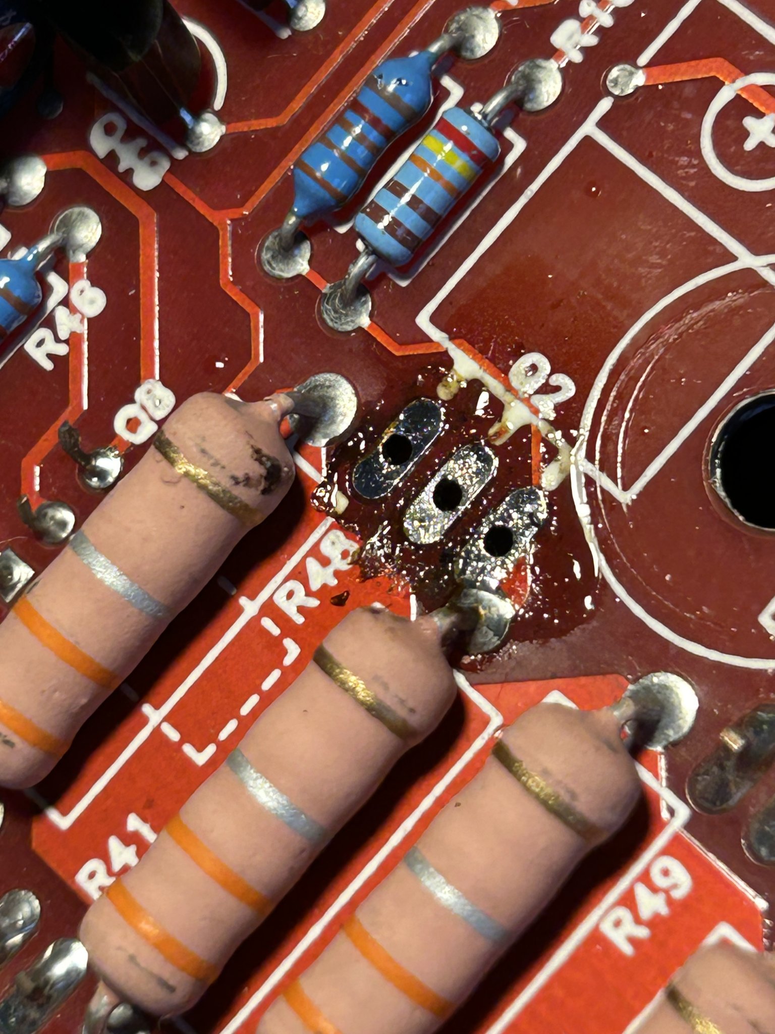

I decided to bench test it with a low power supply and without the heatsink and without any signal on the input. To be safe I installed 5amp fuses and only connected it for no more than 1min to avoid overheating. The right channel still has 33V DC. The strange thing is that before doing the test Q2-Q6 were not shorted. Now after the test they returned to having the base and collector pins shorted. What could be causing this intermittent shorting and DC voltage in the right channel?
I don't know. Try pulling the same transistor that cleared the short the first time.
As far as the heating is concerned... The semiconductors can heat up in a few seconds, even with a current draw that won't blow the 5A fuse. Watch the temperature as long as it's off the sink and the amp is powered up.
Im so stumped here. Immediately before starting I reconfirmed the shorts in Q2-Q6. I then proceeded to remove Q2 and the shorts are again gone on Q2-Q6. I checked Q2 and there are no shorts on it. I again installed it snugly but without soldering. Enough for the legs to have contact with the pads and still no shorts. Where do I go from here? I feel like leaving Q2 snugly in place and applying low power without the heatsink.
