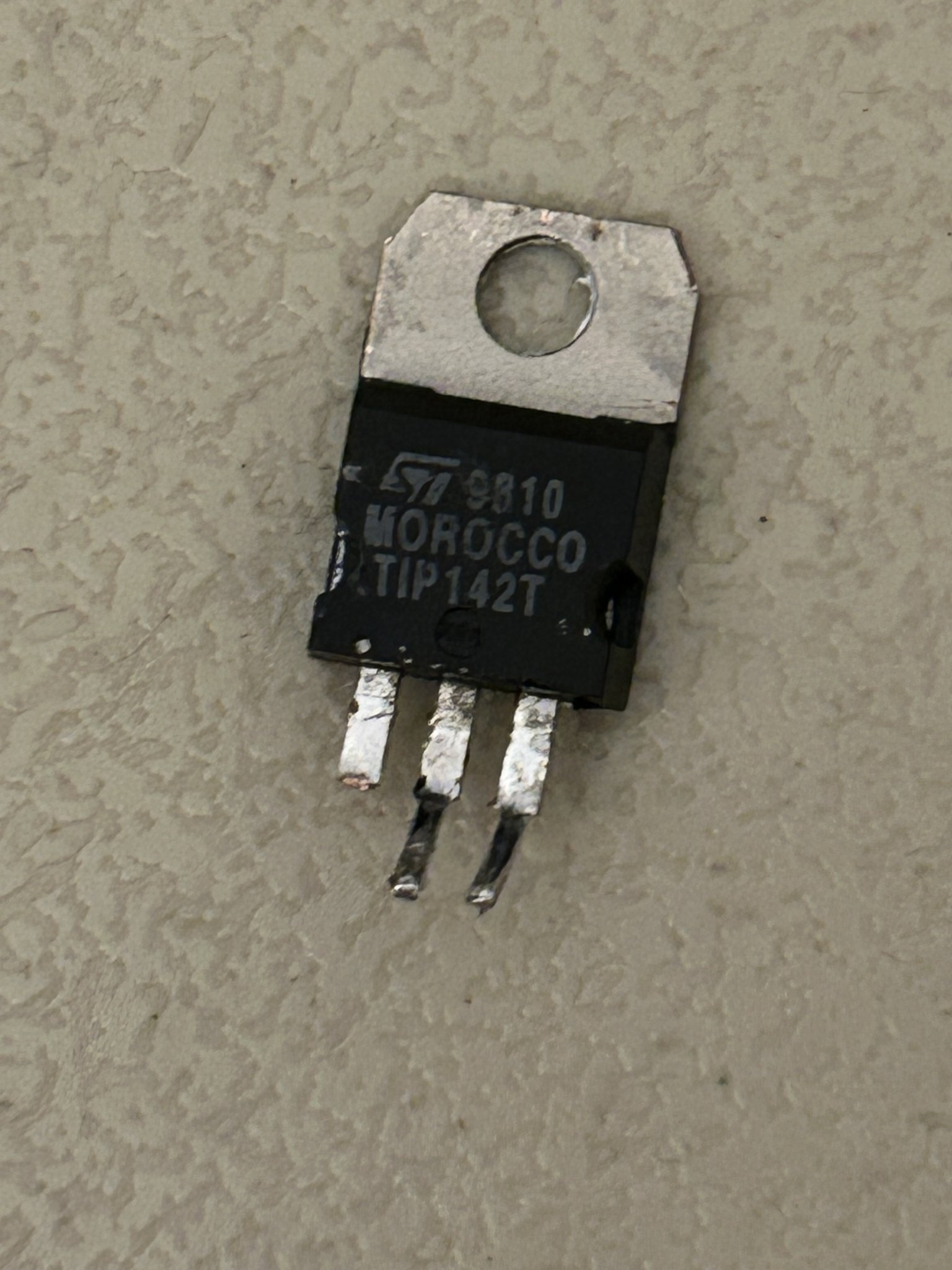

oh no! Look what I did. 🤦🏻‍♂️
Removing the driver boards was extremely easy thanks to your method Perry. Much easier than removing the output transistors. I swapped the boards and the problem didn’t move but instead stayed on the right channel. In order to test I soldered the broken leg of the output transistor.
Removed Q2. The base and collector pins of Q2-Q6 were not shorted anymore. Immediately after powerup there was no dc voltage on the right channel. After about 15-20 seconds the 32Vdc started. I shut down the amp and now the base and collector pins on Q2-Q6 are shorted again.
