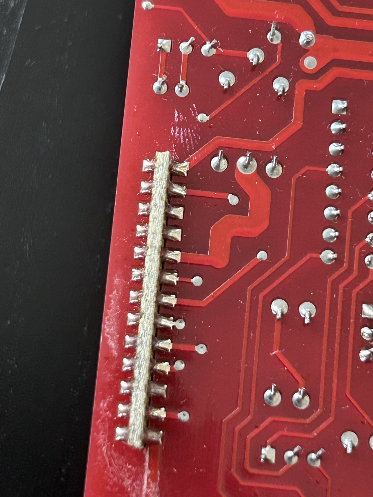

Thanks. Here is my extensive test process and results:
1. checked for solder bridges.
2. Removed Q2 transistor
3. checked the resistance of Q2-Q6 pins 1 to 3 (1=base,2=collector,3=emitter).
a. 1 and 3 immediate and steady 3.17k
b. 1 and 2 increasing or decreasing but didn't wait to see how high it would go.
c. 2 and 3 same as (b)
4. powered on amp and obtained 33Vdc again on right channel. Immediately shut it off. Was powered less than 5 secs.
5. Checked the resistance of Q2-Q6 pins 1 to 3 (1=base,2=collector,3=emitter).
a. 1 and 3 increasing from 2.1k to 3.17k as it approaches 3.17k it gets slower at increasing and then stops there. Repeats each time I touch it or swap leads.
b. 1 and 2 shorted at .2
c. 2 and 3 Same as (a)
6. I decided to continue the experiment and so I reinserted Q2 without soldering and with no heatsink and made sure the contact was firm on all pins.
7. powered on amp and obtained 33Vdc again on right channel. Immediately shut it off. Was powered less than 5 secs.
8. Checked the resistance of Q2-Q6 pins 1 to 3 (1=base,2=collector,3=emitter).
a. 1 and 3 immediate and steady at different high values seemed dependent on the values of (b) and (c) below
b. 1 and 2 slowly increasing sometimes to 260k and stopping other times to infinity. Took about 3-5mins. The higher it went the slower it increased. Other times decreasing from 2000k. Couldn't make out a pattern. Never shorted.
c. 2 and 3 Same as (a) but seemed to max out at 80k except if I tested 2 and 3 immediately after 1 and 2 was completely at 260k then 2 and 3 would read 80k immediately.
In conclusion Q2-Q6 go back and forth from shorting the base and collector pins for no discernible reason.

Plenty of flux. Saturate the braid with it. Lay it along the length of the driver board and pull off all the solder you can. After that, again with enough flux, snip the end of the braid to expose clean strands and work the end of the braid into any connection that's not clean. The braid will absorb better from the end and works better than from the side. Keep snipping to have fresh braid as you get the last solder.
Don't stress the solder pads when doing this. They can be fragile, especially for those with only fine traces connected to them.

Excellent advice. Thank you so much Perry. I found this interesting thread.
https://www.diyaudio.com/community/...-card-rebuild-or-possible-replacement.210777/
What are your thoughts on the rectifiers being bad or the solder joints on the driver board. This amp was recently shipped to me and I was told it was working prior to being shipped. If he was being honest could shipping have loosened a bad solder joint?

Perry great news. I think I found the issue. Dc voltage is gone from the speakers and all the output transistors read infinite resistance across all legs. I gave a healthy dose of Deoxit spray to all the switches and moved them back and forth a lot. I had done this a little at first but I guess it wasn’t enough. I assume that the changing resistance of the base and collector legs was caused by the weight of the pcb balancing on some of the switches and as I moved the pcb around the table top it would slightly affect the contacts inside the switch. I attach the pcb to the heatsink and try audio next. The switches on these old soundstreams have definitely proven to be problematic.
I don't think that's possible. If you're going to test it, insert a bipolar capacitor in series with the speaker to protect it from DC if the problem returns.
I ran another test that the amp had previously failed. I switched the amp to bridged mono mode and tested for Vdc on the bridged speaker connections and it’s working fine. Thanks for the tip on protecting the speakers. I would think high quality amps would have this protection included in the circuit. How do I know the capacitance to use? Do I just add in inline on the positive terminal? Can I leave the capacitor in place permanently as part of my install in the car?

Well I don’t know how it’s working but I won’t complain. Like I said earlier, all I did was clean the switches. I even still have Q2 only inserted in place. I will solder it and install the heatsink next. Im having a hard time finding a small or inexpensive dow corning 340. The cheapest I found from a reputable dealer was 100g from Newark for $30 shipped. Amazon and ebay have sellers with 1oz for about $12 but the container is not from the manufacturer and I worry it could be fake. Any other places I can look besides octopart?
