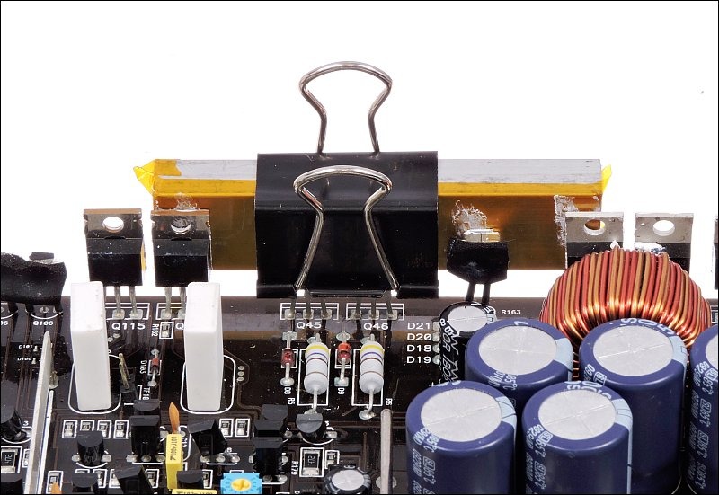

Don't you have a ready source for the 3/8"x1" aluminum bar stock that I showed? Binder clips are definitely readily available. The Kapton isn't required for a single transistor. Just keep it insulated from anything else that's conductive.

Use a dot of heatsink compound on the back of the transistor before you clamp it. Remember not to let the level touch anything if you don't have an insulator behind the transistor.
