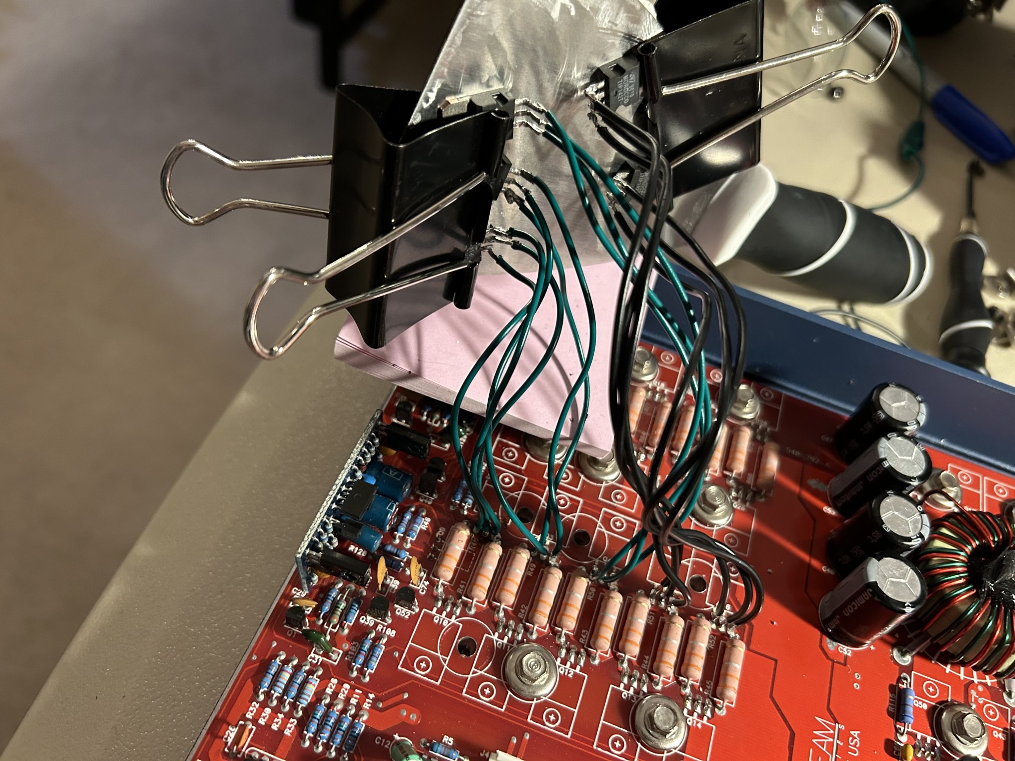

Im trying to minimize the amount of times I heat the transistor pads. I already noticed a tiny corner of one of them lifting. So I think I'm going to wire the transistors up externally and test by adding one at a time. How much volume and for how long can I push audio through the right channel while it has less NPN vs PNP transistors installed? They will be heatsinked at all times.
Also you previously recommended a small resistor on the base leg. Do you still recommend that test?
Didn't you already test the transistors individually?
Did they ever produce DC output when off of the board?
The resistor is only going to be used when the fault can be reproduced.
Weren't you already using wires? That would have prevented the pads from being soldered and re-soldered. When desoldering the wires, you'd heat the wire only and not touch the pad.
The determination on how hard you can run the transistors is determined by how cool you can keep them. That said, you previously didn't need to run audio through them at all for the DC to be present (correct me if I'm wrong).
Playing them now (at a low level) would only be to be able to monitor the status of the amp without having to constantly look at the lamp or meter.
Yes I tested each transistor in each location individually, both with and without audio/speakers. No DC ever presented itself in all my tests. As you may recall a couple tests even went over an hour. When compared to my previous DC issues which occurred immediately or within seconds of powering up this is much improved behavior. Since removing them from the board and testing them "hard-wired" they have never presented any DC. But I have never tested more than one at time hard-wired. I thought adding audio would in some way push more circuitry in the amp and therefore could potentially trigger the DC voltage. (In the past DC occurred without any audio input or output)
As for the pads, yes I did use one set of 3 wires for my previous tests but it still required heating up the pads as I moved from location to location. I minimized it by testing all transistors in one location before moving to the next location. Again only one pad is slightly lifting and it belongs to Q2 which was my desoldering for dummies learning transistor and unfortunately got a lot of heat.
I'm off to add some transistors!
Im at 3 transistors and working good so far. I did notice a difference between the left and right channel. The dc voltage across the emitter resistors. The left channel is all -.5mv across the npn and pnp transistors. But on the right channel which only has 3 npn transistors installed and 5 pnp its -.7mv and -.3mv respectively. Does this tell us anything?
Well test is complete with all transistors and no dc occurred. Im going to keep running it for a few hours more. Here is a pic of the frankenamp. I decided to use a spackler instead of the level.
Also the emitter resistor voltage corrected itself with all the transistors. Each reads -.5mv.

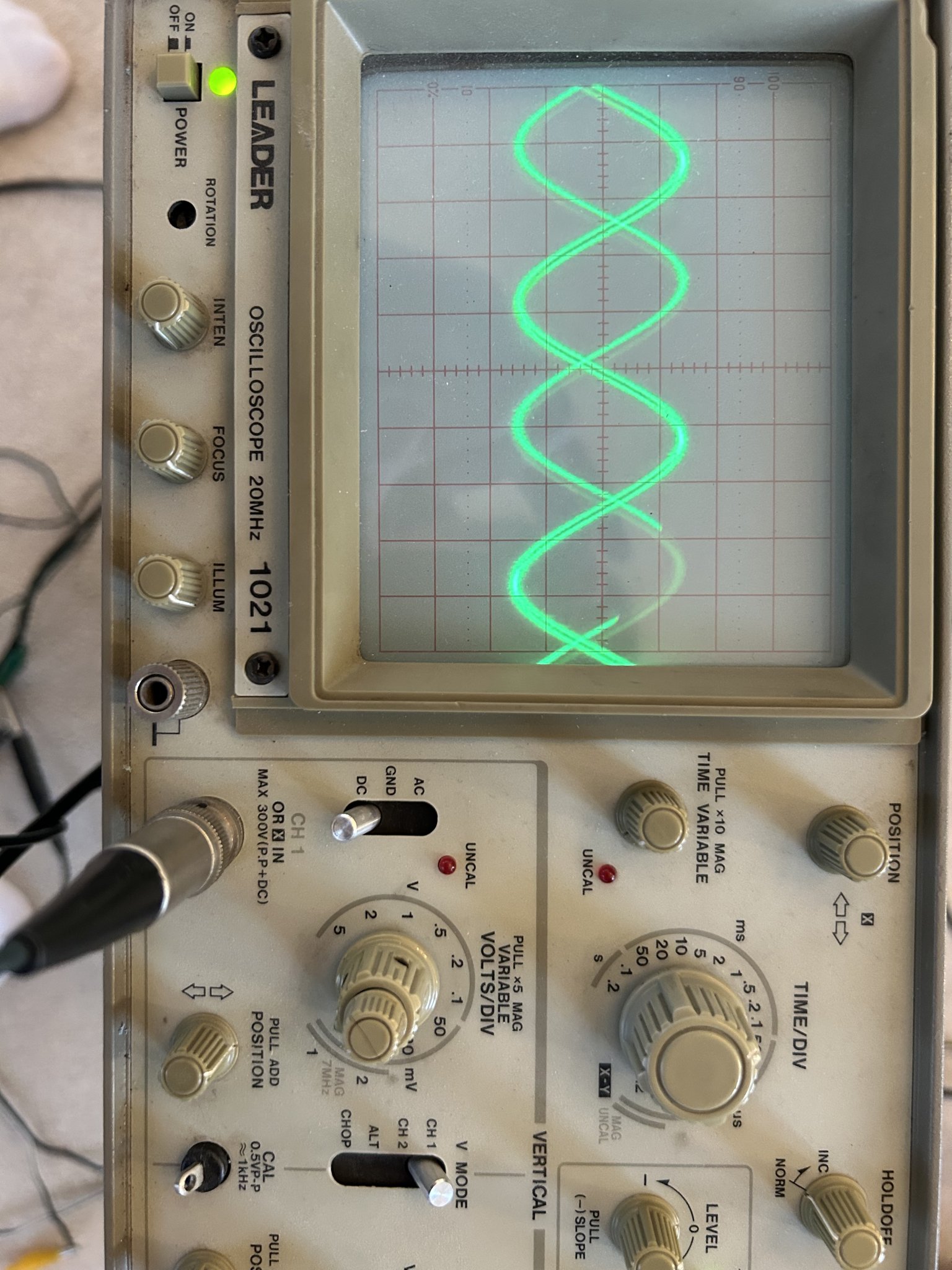

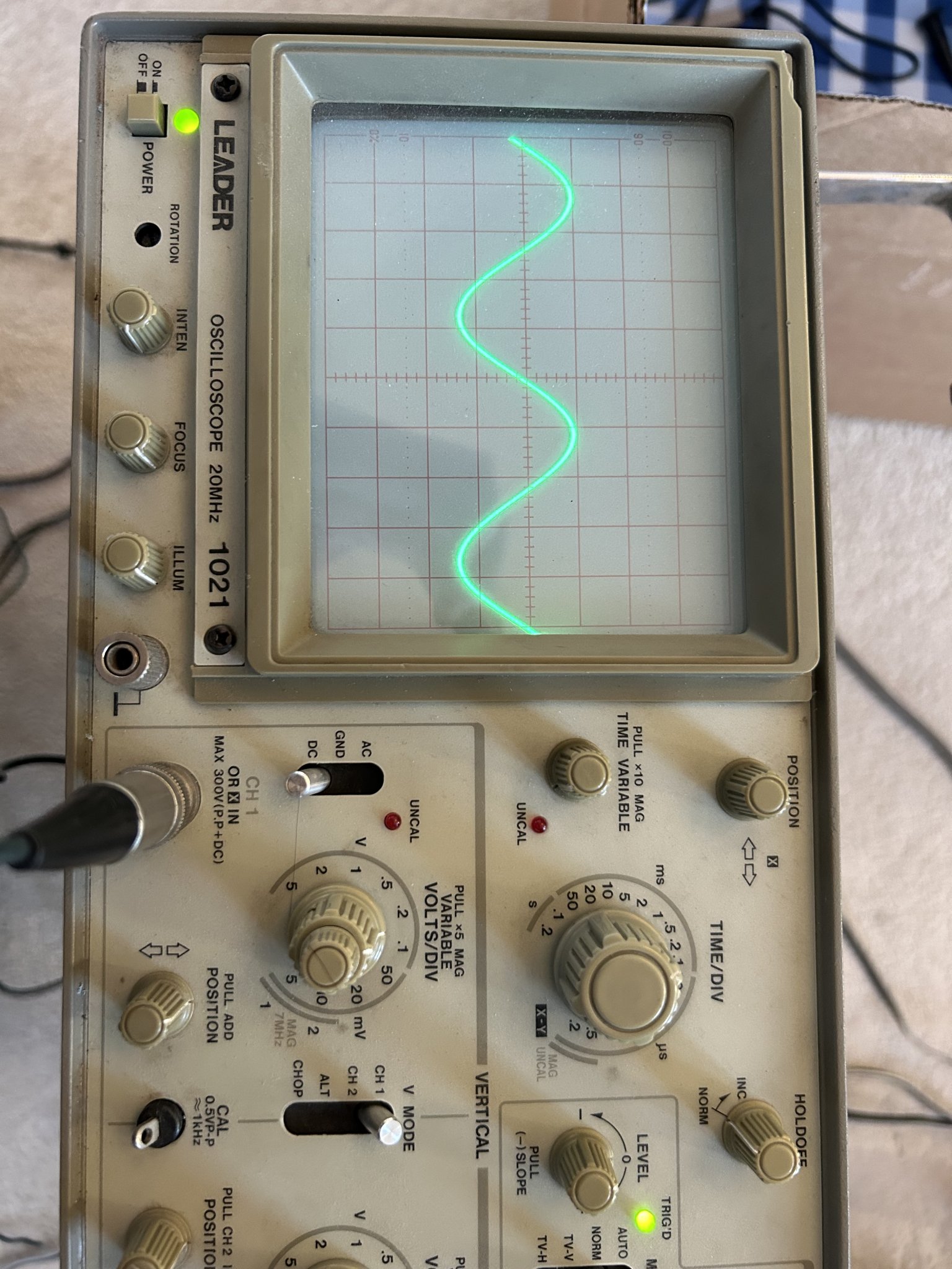

On a side note Im the happy owner of an oscilloscope. Need some help testing it please. I think the trigger isn’t working well. Ive attached two pics of a 1khz waveform at different volumes. The higher the volume (and higher volts/div) one triggers well and is stable but the lower volume one (with less volts/div) is glitchy or jittery and jumps back and forth pretty much creating two waveforms.
Did you adjust the trigger level when you had a smaller waveform on the display?
Look at the left of the displayed waveform. When you rotate the trigger level, the starting point of the waveform moves up or down if the trigger control is working.
Was the trigger LED lit when you had 2 waveforms?
