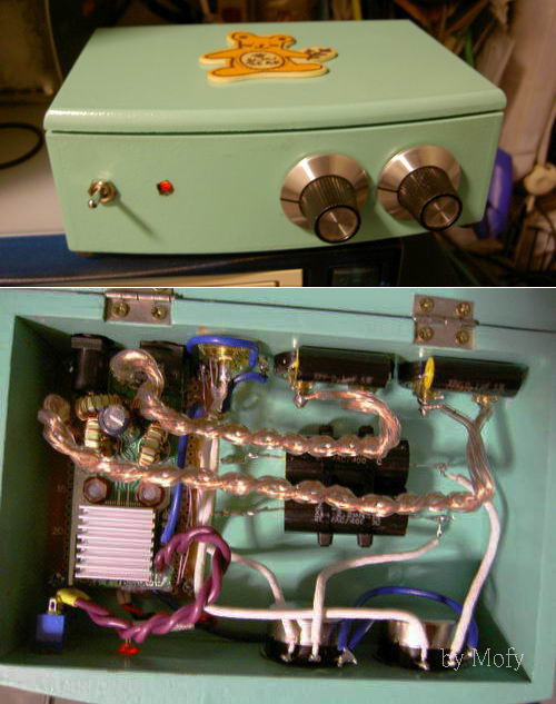

mofy said:I have modified my second T-amp.
more bass and more details 😀

Mofy,
I like the way your amp looks - clean inside and kind of whimsical and comforting outside.
I really dig non-conventional chassis solutions. The look of standard black boxes can get so uninspiring.

Thanks for everyone in here. It really helps me more.
hi, KT,
I like cute and small size style. But my first mod version has used black box too.
That one won¡¦t satisfy me. So, I finished second version 😀

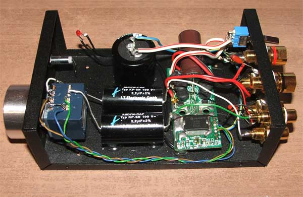

finally... thanks to one great guy, my SI is now officialy modified. I am sure, it is the first modified SI in Lithuania. lol. Here are the pics.
Now it sounds GREAT. a huge improvement. however, the highs sound a bit annoying and sharp. I suppose it due to the fact that the caps are new... and need some time to reveal. I wonder how long🙂

irss said:finally... thanks to one great guy, my SI is now officialy modified. I am sure, it is the first modified SI in Lithuania.
Congratulations on the fist Modded T-amp in the country!
But you need to unplug it RIGHT NOW!
If I read your photo correctly, you have put the input caps Before the pot. Yikes! The need to be after the pot. The way it appears to be connected you will get massive DC offset and ruin your amp and maybe your speakers. Won't sound very good, either.
Please check you wiring and report back. If the amp is wired up the way I think it is, you will be able to measure DC volts on the speaker terminals.
Sorry to panic you, but I don't want you to burn it up, and it looks wrong in the photo. Pleeeease check.
At first glance, it seems he wired it funny, but under closer inspection, you can see that his wiper lug for the pot goes to the cap. Good catch, and your helpfulness is always appreciated.

I looked at the photo again. I'm sure that it is wired wrong. You can see the input wires coming from the RCAs to the caps, then to the pot, then to the board. That puts the pot on the wrong side.
However, I can't tell from the photo (need to look harder) if the stock input caps were removed. If there were not, then no DC offset - but --- no benefit from the new caps.
hmmm...so, if it is wired wrongly, there should be a problem with the sound. but, there is no problem. i am lost completely🙂
btw, original caps were removed.
Yeah, I looked closely - you can see the caps have been removed and bridged, as well as R01 removed. Good.
The way it is connected may work, but I'll bet your chip gets plenty hot. Please have a look at the DC offset to see if it is not high. You can do that with any DC voltmeter. You should not see over 1/10 volt. Anything more indicates a problem.
Let me know.
Let me know.

holy cow you're right. it is wired wrong-way-round. Hopefully he hasn't damaged his drivers.
