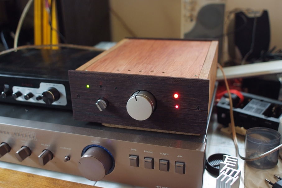

- and a short intro: I'm from Croatia, have next to no knowledge of electronics and only barely know how to solder. I'm not really a Hi-Fi enthusiast (don't have the finances🙂)... But, I like making things 🙂
I discovered and bought my T-amp about two months ago, and decided to mod and recase it...
I just finished my mod (SI T-amp plus PSU recasing) two days ago, and this thread gave me lots of good info...
In short, to answer your question, yes, I did it... I put a PSU I had at hand into the box with mine....
Another goal was to use as much "recycled" components as possible (you know, there's a recession going on 🙂)....
So, what I managed to find was an old external (powered) disk enclosure - it had a perfect PSU - 12V, 3A, and I decided to use that. Another plus was it already had extra connectors for a fan and some LEDs.
The wiring is awful - and most of the wires are also recycled from old DVD players, VCR's, etc... 🙂
The only things I actually bought for this mod are the LEDs and the speaker binding posts (about $7-$8 total....) I had the wood at hand....
The pot and the switch on the front are from an old tape deck I got at a yeard sale for about $4 - and the pot turned out to be an old Alps 50K x2 - just what the doctor ordered!
I also decided to add three inputs - two RCAs and one 3.5mm jack socket, just for variety's sake. The small switch on the front left is the input selector - and the green LEDs show which of the three inputs is active...
The big red LED is for the PSU, and the smaller red LED below it is T-amp's - I cut the original red LED, soldered some wires to the remaining LED "stubs" and "extended" its position to the front of the case.
In short, it was an easy beginner project. The only exception was removing the input caps and soldering bigger ones of better quality - just some caps I found locally, nothing special - I had a more experienced friend help me do the "sensitive" soldering stuff (removing the original SMD caps and soldering new ones). Even so, he managed to remove also the solder pads. Being versed in electronics more than I am, he managed to find the traces and solder the new caps' wires to appropriate points...
In short, I'm quite pleased how this turned out - it's my first DIY audio project (well, kind of.... I didn't make the amp myself - it's the stock SI T-amp, purchased from an online store for about 35 EUR).
In case you're wondering - my "Frankenstein" is that boxy woody thing in the picture 🙂 To the left is some Chinese amp I got for about $50 new in the local store (brand is some "Dynavox" thingie...). The bigger one below is a WEGA 120 amp (rebadged Sony, I'm told....).
Denis

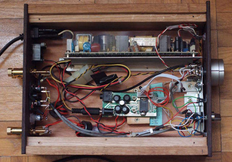

Here's the internals: don't laugh, please - I'm new at this 🙂
The PSU, like I said, comes from an external disk enclosure. Really old - it had a parallel port connection to the PC 🙂
However, it was the right size, and provides the right voltage and power (12V/3A).
I decided to avoid soldering where I could - therefore the 12V socket and jack remained intact - and the molex connector is quite visible in the photo 🙂 Laughable, I know....
The important thing, I guess, is to try to isolate the PSU from the amp - mine already had a metal (aluminum?) plate on the underside, which I turned towards the amp - see the photo... I guess it could help with the interference.
I find that putting the PSU in the box makes things less complicated. There's just one main power line that goes to wall power socket and the main switch on the back panel turns on both the PSU and the amp. I decided against a separate switch for the amp - it would make things much too complicated (two switches to turn on/off) - and I'm lazy 🙂 But, I did leave TWO LEDs: one is for the PSU, and the smaller one is for the T-amp.
As for the possible PSU to use, there are many old/broken DVD players, VCRs, etc, which usually run at 12V - so some of those PSUs can be used - 2A is a minimum, I guess... Mine has 3A. Buying a PSU on ebay is also a possibility. If you're cheap (like me), you can always find something in old electronic stuff (DVD players, VCRs, external computer disk enclosures, etc...). Besides, it's satisfying to know that you're not contributing to increased garbage footprint... Reuse, recycle.... make something new and useful from something old and discarded...😀
