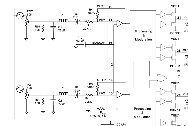

Here's some data on what I've managed to pull from one of my Sonic Impact 5066 boards. This information should not be taken as gospel -- it's my best attempt to decipher the workings of the board.
Sonic Impact 5066 Parts Description, correlating to tripath datasheet

R01t = 10k (103), Right channel in, connected to ground
R1t = 1k5 (152), Current limiting resistor for LED
R2t = 20k (203), Ri - Inverting Input Resistor, Left Channel
R4t = 36k (363), Rf - Feedback Resistor, Right channel
Bottom:
R02b = 10k (103), Left channel in, connected to ground
R1b = 20k (203), Ri - Inverting Input Resistor, Right Channel
R3b = 8k2 (822), Rref - Reference Resistor to pin 6
R5b = 36k (363), Rf - Feedback Resistor, Left Channel
R8b = 10 (100), Output Zobel, Right Channel
R9b = 10 (100), Output Zobel, Left Channel

3) Replace R4/R5 to 20k resistors. This sets it to the "ideal" 12V/V listed in the datasheet (Vinnie R states that he does this mod on his Clari-T mod of the Sonic Impact). Currently, the gain is set to 21, this mod would reduce it to 12 (I think.. I'm not an EE, so if this is incorrect, someone please let me know).

1) 4x 20k and 2x 10k 0603 surface mount resistors (0.1%):
http://www.digikey.com/scripts/DkSearch/dksus.dll?Detail?Ref=442911&Row=357674
http://www.digikey.com/scripts/DkSearch/dksus.dll?Detail?Ref=442911&Row=365300
The 20k resistors will replace R2t, R4t, R1b and R5b, while the 10k will replace R01t and R02b.
2) Removal of C4 on top and C3 on the bottom from the board. I'll bridge these traces and then mount the input caps offboard. I'll be using 5.1uF Solens for this.

Motherone,
You have left out the input blocking capacitors. It has been suggested that they are limiting the low frequency response. They have to be connected to the 10K resistor setting the input impedance and connected to the input pins of the 2024.
This makes me think there is one on top and one on bottom. I am going to dig in and try and locate them. Bypassing them with a larger valur cap may flatten out the response below 200 Hz.
George
Panel,
Thanks for your reply. I agree with you that the input caps are most likely the source of low-frequency rolloff on the amp.
C3/4 in the post above are what I believe to be the input blocking capacitors. I'll be replacing those with Solen 5.1uF caps to see if it makes an appreciable difference.

The C3/C4 are the input caps. Polarity can be verified, the side that connects to the 20K resistor is the high voltage side.

George,
Thanks for that piece of info! I totally missed that they spec'd it out on the datasheet. I think someone (Thorsten?) had posted in another thread that multilayer caps are terrible in signal chain due to smearing. I obviously have no idea on this, but it's food for thought.
I also agree that C3/4 look much too small to be 2.2uF. If you have a capacitence meter and can measure it, I'd be much obliged.

Input Schematic
Here is the input schenatic for the Sonic. A bit different from the Tripath app notes.
This should help in bypassing any or all of it.
