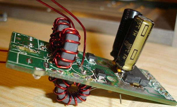

Hey dude! I'm a novice myself but picking it all up from this generous lot...and a LOT of tinkering (you should see my experimental board....
Anyway.... to keep things easy replace C10 with something bigger (more capacitance) but within the size parameters. Make sure of the polarity too..the striped side should be facing away from the chip. You can get panasonic FM's or FC's to fit nicely and they are very low ESR. I managed to pick up some NIC NRSK's 1000uf that are only 8mm diameter!...possibly the lowest ESR available!
Next you want to feed the positive 12V to the positive off-board cap and then onto the underside of C10. When you replace C10 leave a length of lead hanging out to solder too (again, to the positive side closest to the chip) the negative follows in paralell to the negative cap terminal and then onto the board where the old neg was attached. Done!
There are a multitude of ways you can do this but the closer the caps are to the chip/board then the lower the inductance created by the traces as they enter the chip...see one of my boards as to how close you can get em! Those are 0.1uf caps soldered to the bases of two 680uf FM's...then directly to the pins...inductance? What inductance?

Hi Roger, as Panno said, he sourced the cores and was very kind to send me a few (knows his stuff!). Unfortunately I (my darling daughter) dropped one and broke it so I tracked down the little rings in the UK (RS-fairite type61). Are they exactly 10uh? No idea, I can't measure them! But they sound just great! Having said that I 'm going to take one with me to the local electronics store and measure it this weekend, although this wont test the load characteristics.

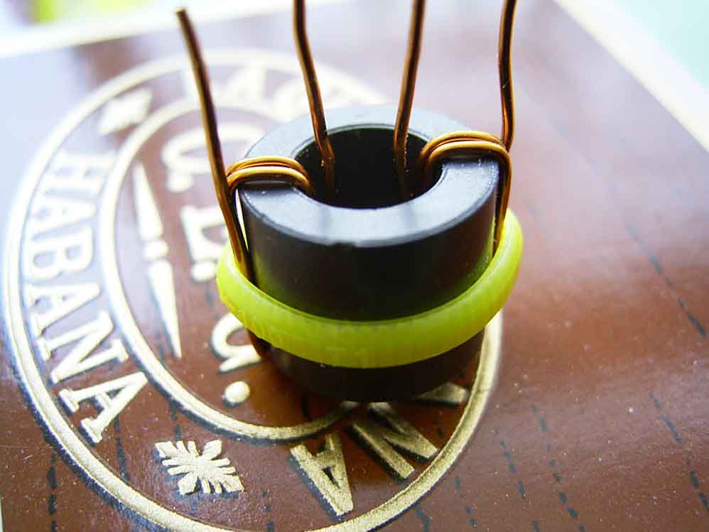

Hi Lee, Maplin are very useful for testing inductors..I took my attempts in and they were way to high, unwound them till I was down to 3 turns for 10uH and 4 turns for 20uH. Can't see them being any good, haven't tried them yet as I have just finished building an Autocostuire 2020 amp, and it worked😀 ..
I will buy your suggestions from RS, what gauge wire did you use?
Barry.

WOW 3 turns for 10uh? & 4 fir 20!!!! what cores/wire did you use?
I just have 0.71mm magnet wire on mine...tried silver but could only get it in 1mm and it's too difficult to get a tight winding.

I used the ferrite rings from the power cable of the playstation. I only had 0.56mm winding wire and it was just a test to get some idea of how different cores affect the value.
Ahhhh, those have a lot of ferrite in em! No wonder they give high values.
like the dual windings, I'm thinking along the same lines....you can just about get 24 wraps on the cores I use. It's just fitting them to the board that's a pain. I'm looking at my own board design at the moment, probably be rubbish but it's a good educator never the less.
Are you a Cigar man?.......
The higher the permeability of the core, the fewer turns you need. A type 77 would need very few turns, 3 or 4, for 10uH. The problem with type 77 (and many others) is that is not really suited to the frequency range of Tripath switching, though it might work well for amps or SMPS with a lower frequency.
