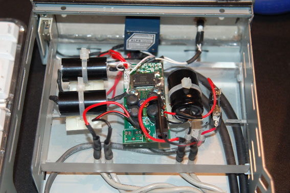

Hi all,
More about wiring!! I just finished modding my SI t-amp as according to panomaniacs and audio1st’s stealth mod, using 2,2uf Solen MKP for input. I also replaced c10 with a 330uf Panasonic FC (I didn’t find anything of greater value that fitted in), and a Panasonic TSHA 10000uF outboard. Question being, as seen from the photo (I hope) the big cap is mounted in parallel with the DC input. Is that correct, or does have to be in series? I also added a Fuse (fast 2A) before the cap, as my external PSU does not have a fuse on the output side. Any problems there? 😕
The modded amp is placed in a case from an external CD-RW. The back trunk is still empty, planning to put a PSU there next.

Re: wiring and more
berthej said:Question being, as seen from the photo (I hope) the big cap is mounted in parallel with the DC input. Is that correct
Looks good to me!
Why not! Wont do any harm!
panomaniac said:I looked at the photo again. I'm sure that it is wired wrong. You can see the input wires coming from the RCAs to the caps, then to the pot, then to the board. That puts the pot on the wrong side.
However, I can't tell from the photo (need to look harder) if the stock input caps were removed. If there were not, then no DC offset - but --- no benefit from the new caps.
Pano, you were right. It was wired wrongly. However, because it was not me who modified the t-amp I had no clue about the problem. Friend of mine did not realize that the proper wiring order was of great importance. Good that he did not blow his drivers...🙂 In any way, he did a great job.
The only concern I have is that the cap may not be as close to the chip as all you guys recommend. Am I wrong...?
again, thanks to you all. Now I'm starting to wonder how better would charlize or Amp6 sound...🙂

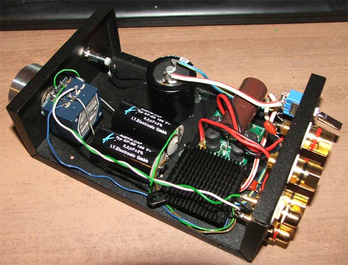

Photo review
Irss,
You have left lots of room for improvement. First you need to insolate the RCA jacks from the chassis if they are not. Then remove the wiring connected to them. Form twisted pairs to connect them directly to the volume control, keeping L/R wires separate. This includes a separate ground connection for each channel. Disconnect the ground jumper on the volume control and run a separate ground for the other channel back to the same ground attachment point on the circuit board. This will improve your high frequency channel separation quite a bit.
If the heat sink is not grounded it should be so it doesn’t radiate noise.
