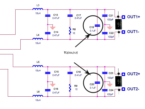

[QUOHow about those caps across the output terminals?? Is it recommended to replace those?? If yes, then with what?? Again, my apologies if I missed a post answering this question...TE]
I replaced them with 0.1uf M Cap poly's and removed the on board C19 & C20. It seems to really open up the detail. It is early days with this last mod and things may change, it sounds good at the moment.
PS make sure you twist the speaker cables from the board to the terminals..
Barry..
C19/C20 are the Differential Output Capacitors. They are meant to drain off some of the RF.
Tripath calls for 0.01uF. That should have an impedance of about 800 ohms at 20kHz and 16 ohms at 1MHz. Some Tripath based boards use much larger caps. I don't know what the Sonic uses.
The terminal output caps could make a difference, as they are larger. A lot of people have reported better results without the caps across the speaker terminals, or the use of better caps.
The output filters of Class-D amps is wide open to research!

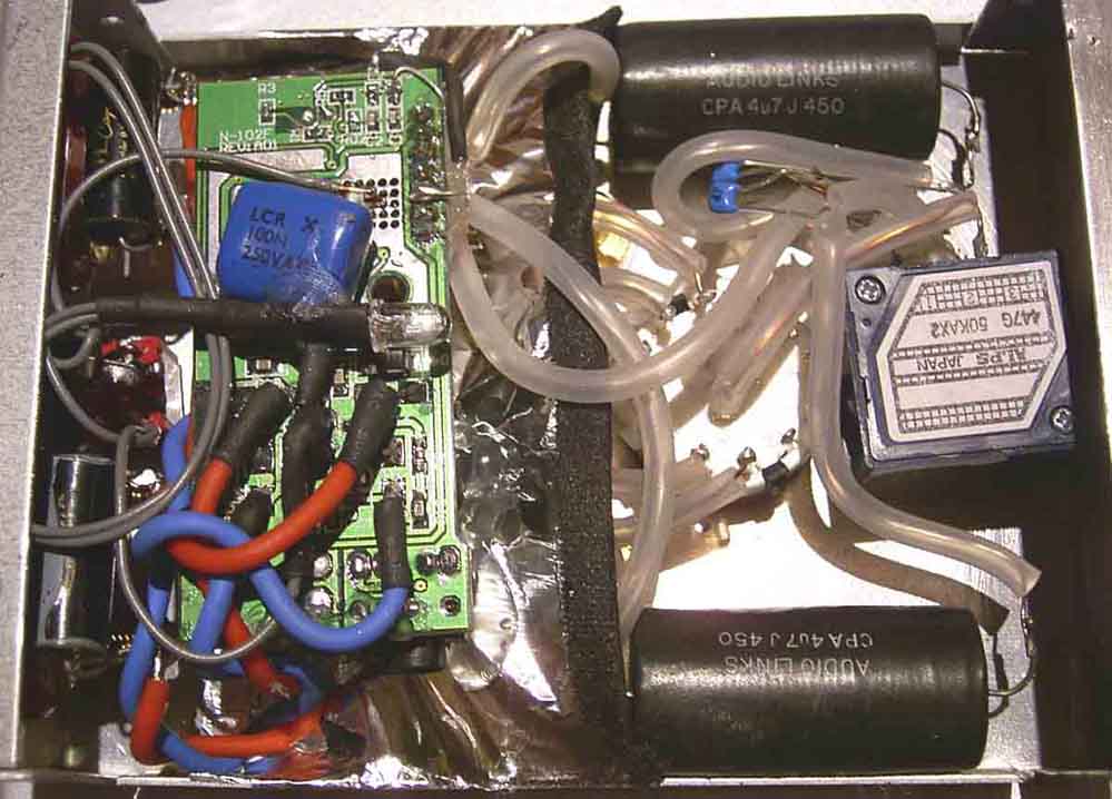

I also have a little (easy) question regarding my t-amp. I just want to replace the input caps to foil types with 2.2uF. Since they are *big* i was wondering if i could just unsolder the input cap of each channel, bypass it with wire, and then wire the new cap between the pot and the board. Basically this would leave the input circut intact, but the decoupling cap would be right "after" the pot in the schematics. (A bit like the "stealth-mod" from Panomaniac but easier)
Thanks a lot!
Input cap question
nilsomat,
That is the way I did it. I feel it is best as the film caps are supported by the pot on one end and the larger connector pad on the other. However for this to work you must remove r01 and r02 other wise the amp will not turn on.
Roger
